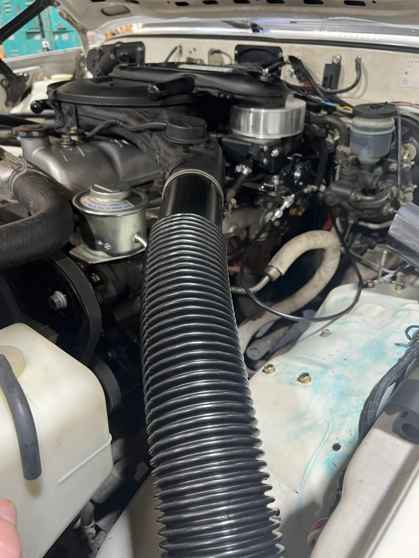

UPS dropped off a pretty new @Racer65 intake hose just as they arrived

IKR, I even want to put one on my FJ62….
I’ve got the 3FE in my 5 speed FJ80 and it’s a wonderful system. I’d not replace it for a Sniper but I would never add it to a 2F now that a Sniper is available.
Make sense?

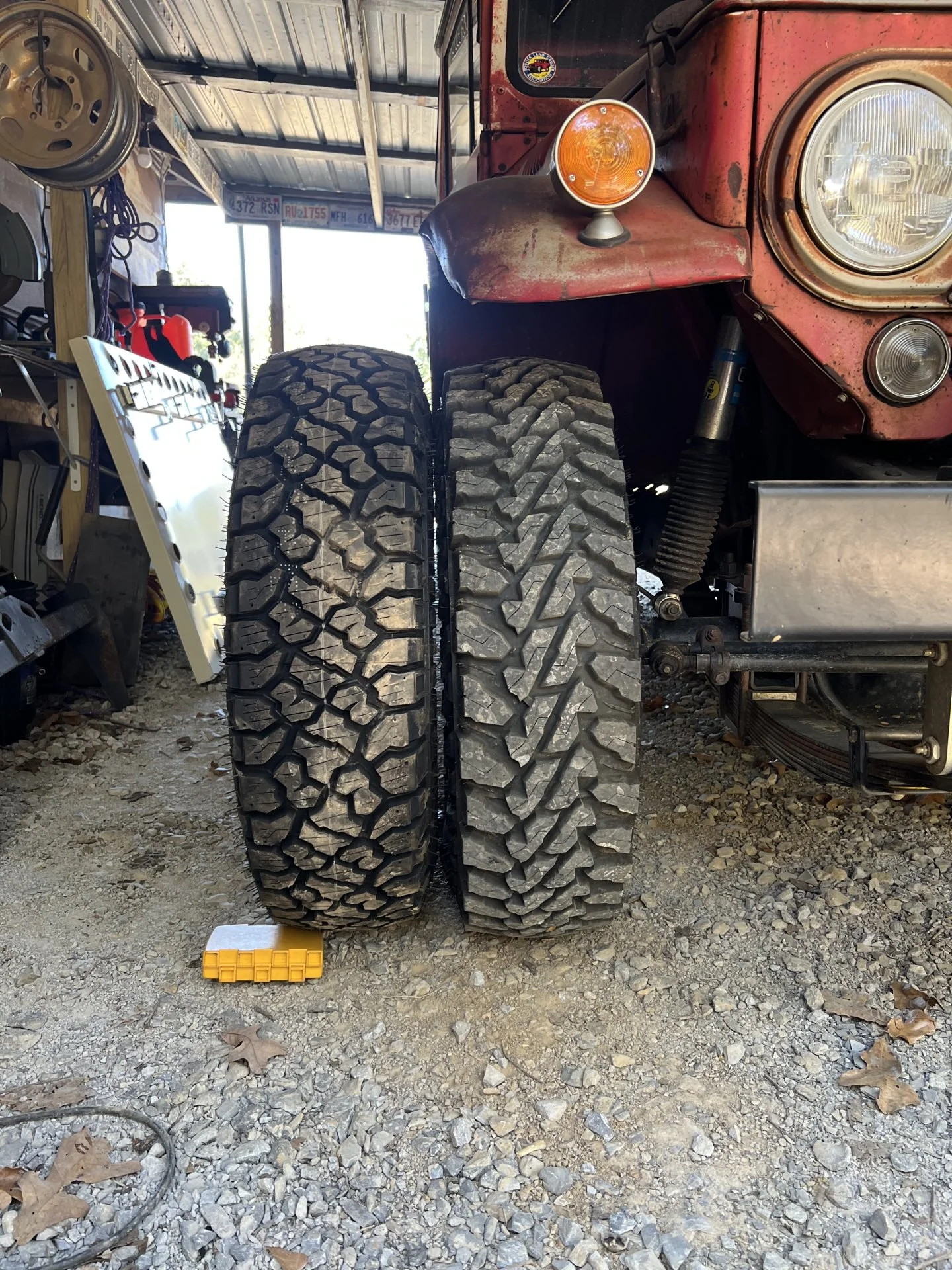

I love those tires. Do you by chance have any shots from head or or straight behind? Curious to see how skinny they actually are.
The more I read about Snipers, the more I want one versus a V8 swap.
Why not both? 😀
(More seriously: I plan a sniper on a @FJ60Cam Mosley 4.4L 2F with a F valve cover and my formerly Mark’s/Downey header in my 66 45LV replacing a SBC.)
A bit less power but way more cool to have a stock-looking drivetrain under the hood.

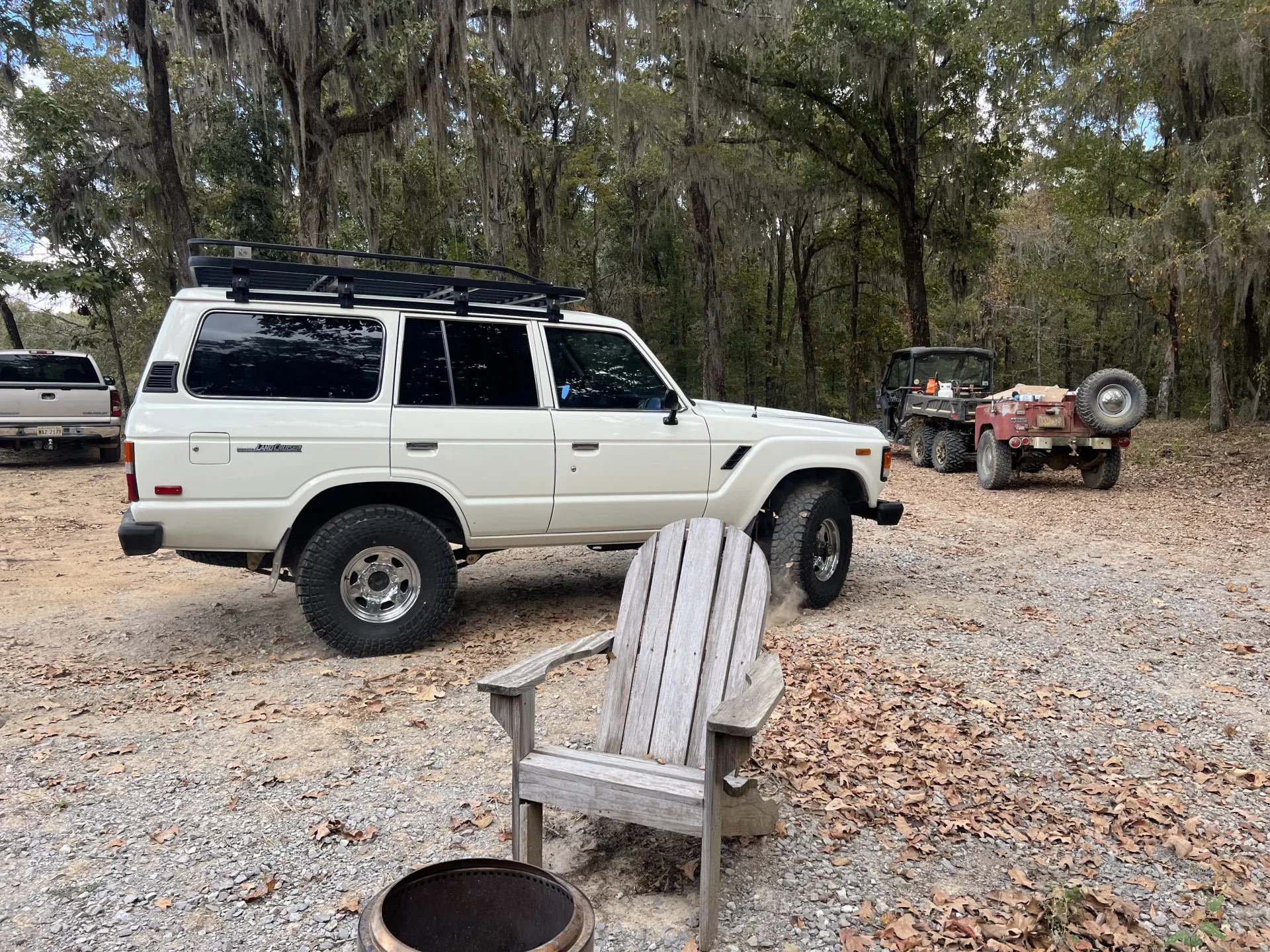

The ole girl fired up nicely and the first test drive was a grand success before I jumped in the OddBall 80 and hit the road for some R@R at the Cruiser Crawl
