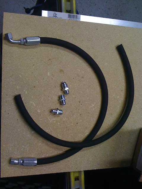

Assembled the hose this weekend at Chris' house after starting the deconstruction of his new 40. On the 40, we were able to get the fenders and bib off, then drained the motor's fluids and took the accessories off. All in all a productive day!

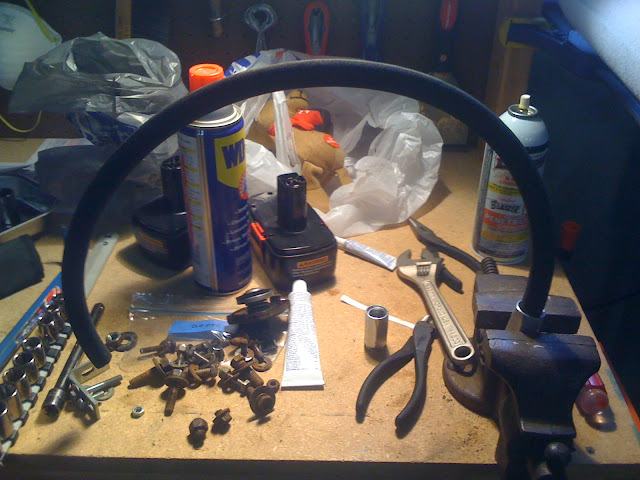

Hose assembly is easy with a vice. Thread the barrels onto the hose, then thread the nipples onto the barrels. Couldn't be easier.
Final product. I got two hoses for the price of one!
I used your tip to cut the line with a cut off wheel. Tried at first with a razor and realized that the banding was going to make that impossible. Worked like a charm as long as you make sure the cut is square. Thanks man!:cheers:
