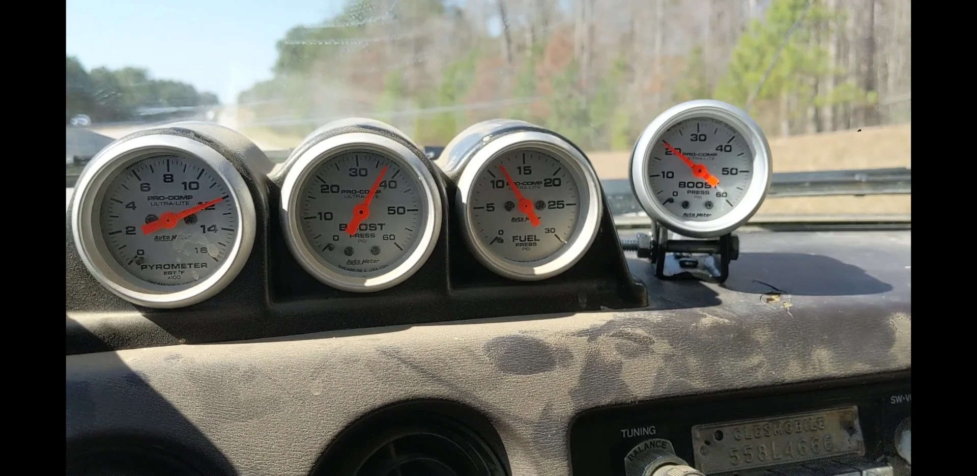

Wired the high pressure wastegate shut and this is as good as it got at about 3500rpm in 4th.

Big: PR = (20 + 14.7)/14.7 = 2.36
Total: PR = (37 + 14.7)/14.7 =3.52
3.52/2.36 = 1.49
Small PSI: (1.49*14.7) - 14.7 = 7.2psi
Big turbo is making 20psi and the little turbo is making 7.2psi for a compounded 37psi total.
With your small wastegate wired shut (meaning it cannot open now, right?) it would suggest this may be as hard as the small can be driven with the current fuel settings (and timing). I know this is subjective but does it feel more powerful than last week's 26 total psi?

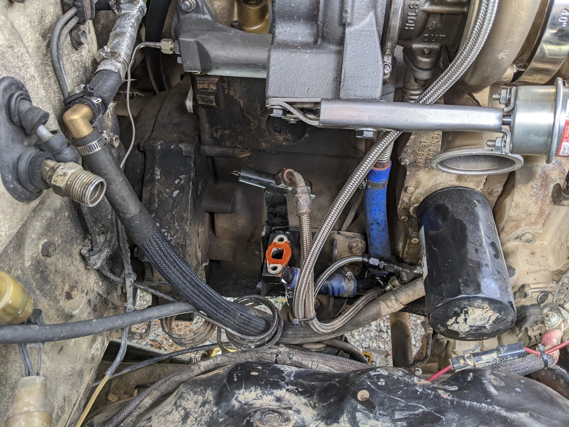

Changed the lp turbo drain gasket as it was leaking pretty good.

With all that, went for another rip and got this screenshot. Not apples to apples as the last pull, as this was only about 3000rpm, but it does not appear to have a big pressure drop in the intermediate charge pipe.

Torn down to replace the lp drain gasket.

Today's test drive screen grab.

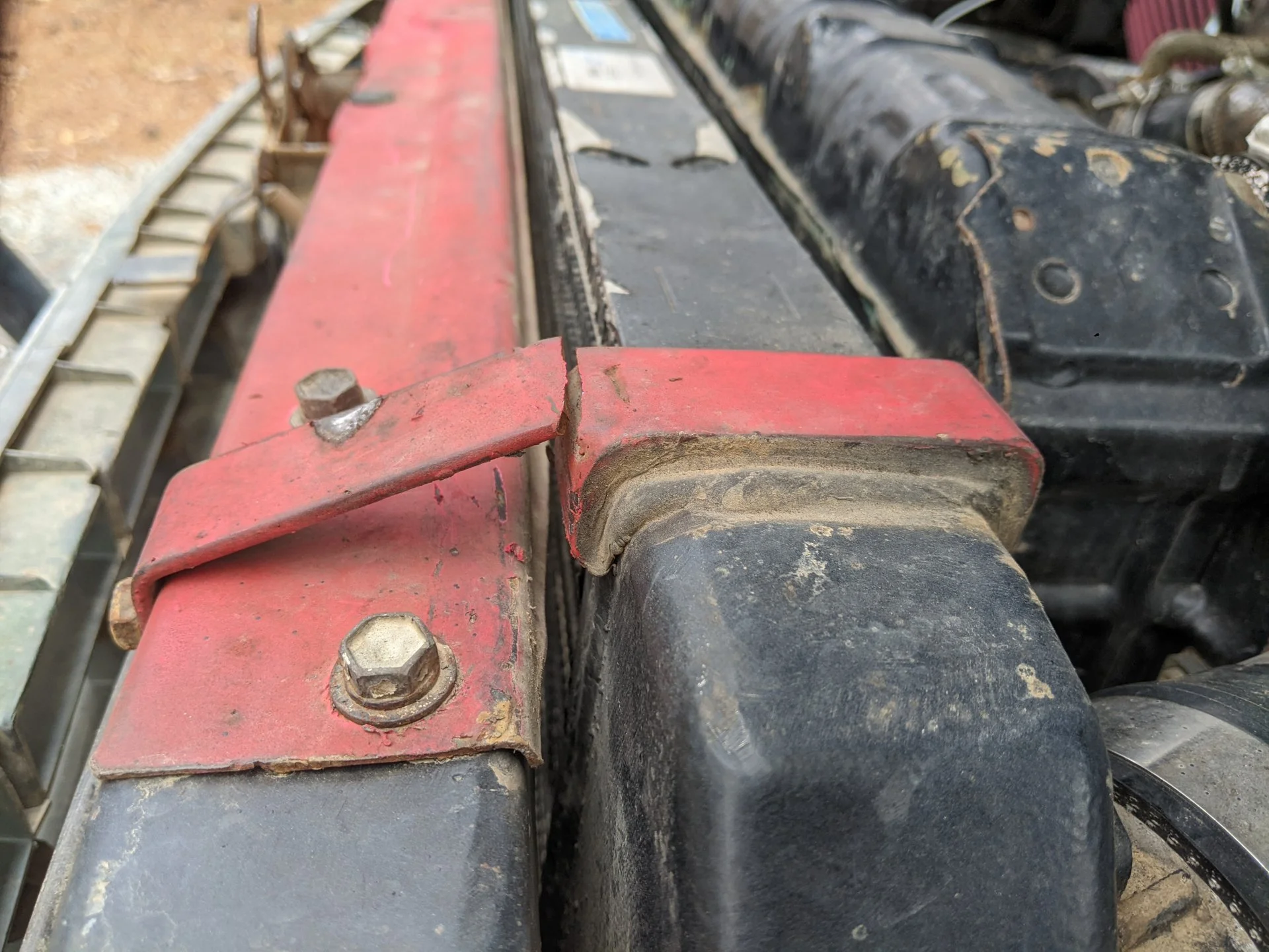

Have a new whine that started on the last pull. Not sure what it is, but when inspecting I found one of the intercooler top hold down brackets broken. Weird because it's been on there for years.

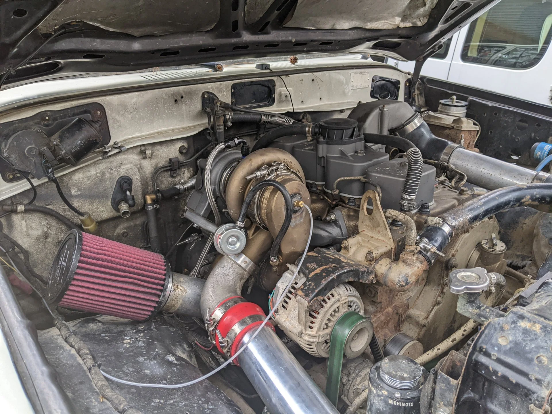

Dude, I think you're doing everything right, but I think this may be your real problem. It's too restrictive.
When I had the snorkel box on my truck, I could not get it to go above 14 or 15 psi. When I deleted it, I could easily hit 30. This was before the compounds. I just think that you're not able to move enough air with that.
Measuring pressure at the inlet like I did today disagrees with you. That's why I did that. Even with 16psi feeding the hp turbo at 3000rpm that should compound above 40 easily. Can't push it higher than 37 at the manifold currently.
It's possible that the air cleaner is a restriction now, but it wasn't before.

Big: PR = (16 + 14.7)/14.7 = 2.09
3.52/2.09 = 1.68
Small PSI: (1.68*14.7) - 14.7 = 10psi
Big turbo is making 16psi and the little turbo is making 10psi for a compounded 37psi total. So same total boost as before but EGTs are down and the little turbo is doing more work.

Before getting the new injectors it might be worth modifying your atmospheric input, I have to agree with @The Phoenician , it looks pretty restrictive at that point.
Do you have rough dimensions of the custom connector to the atmospheric turbo?
Just in terms of fluid dynamics, short 90* fittings and other pieces that neck down add quite a bit of theoretical length to the system. is there any way you could add more radius to the part that you tapped for the port? something like this?
I just see those hard angles right before the big turbo which are definitely making quite a bit of turbulence before entering the turbo. Since its mild steel it shouldn't be too hard to radius it a bit which will improve the airflow, its amazing the difference laminar vs turbulent flow makes in pressurized systems.
I work as a duct system engineer, and have seen some funny results from turbulent air.
Sure, it's possible. I'm just not convinced the juice is worth the squeeze to do that yet.
The restriction point is at that bottom point of your mspaint. To improve that, which would be ideal, would require a full rebuild of the part. If I decide to do that, I'll make the upper portion more sweeping to appease y'all :lol:
