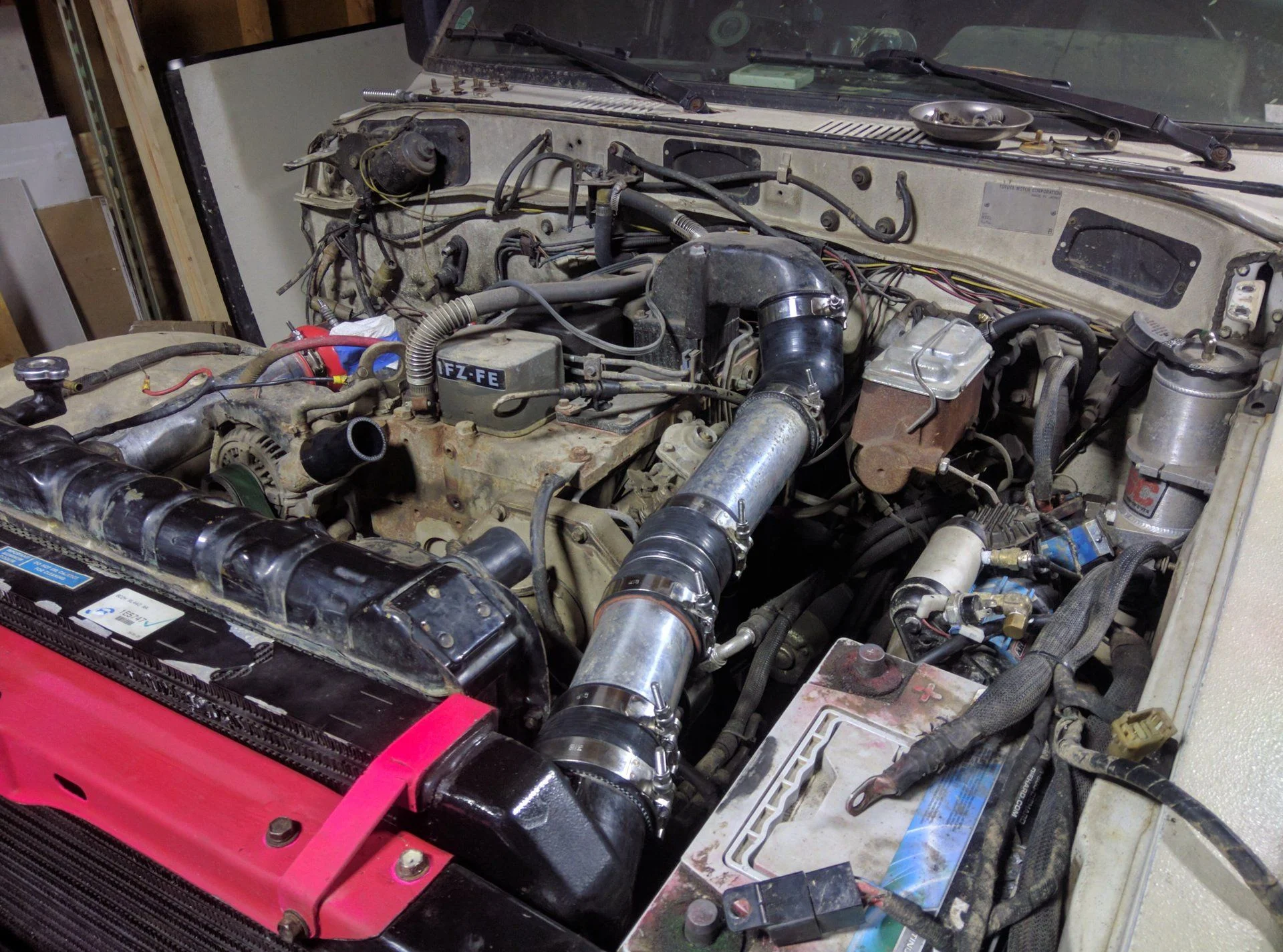

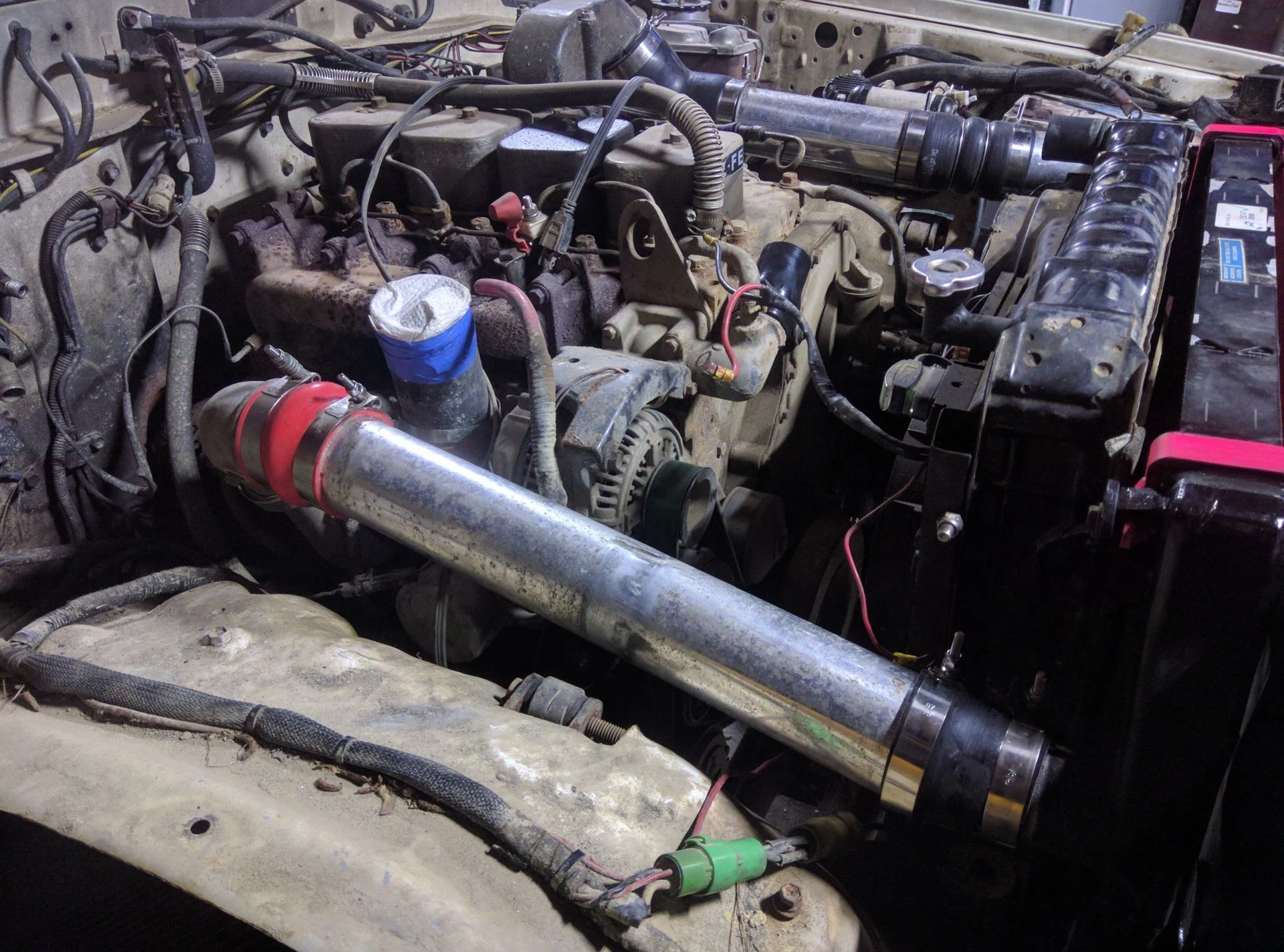

Got the intercooler lines plumbed tonight. Pretty happy with how they came out. Need to get back to the battery boxes soon.

What's the reasoning for the middle hose in your intake pipe between the IC and motor intake? Looks like that could be a single tube?
It could be a single tube if I had a section of 3" piping bent at the right angle. Using what I had in the garage, that's what worked. The big boot in the middle takes up most of the difference in angle between the IC outlet and the motor intake.
Ok, couldn't tell you needed an angle. I figured you had a reason.
