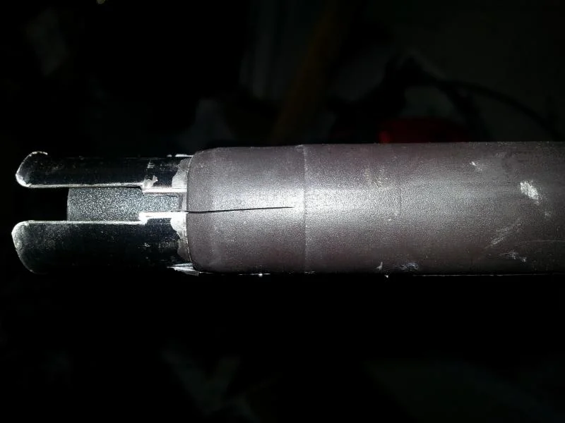

I have the body style that came after yours, the 2.0T. Make sure you replace the ignition coils, they are known to fail and ruin the catalytic converter. I'm doing mine right now.
Here what was causing cylinder number 4 to misfire in my VW.
Just replaced the coils and the spark plugs with some Denso products. Just make sure to check it, it's an easy fix.
TDI swap fixes that issue ;p
That is true, I love my diesel land cruiser, but I also love the speed of my vw and once that bug bites Johnny, he'll love it too.
Thanks for the heads up brother! The check is just to pull them out and see if the boot is split?
