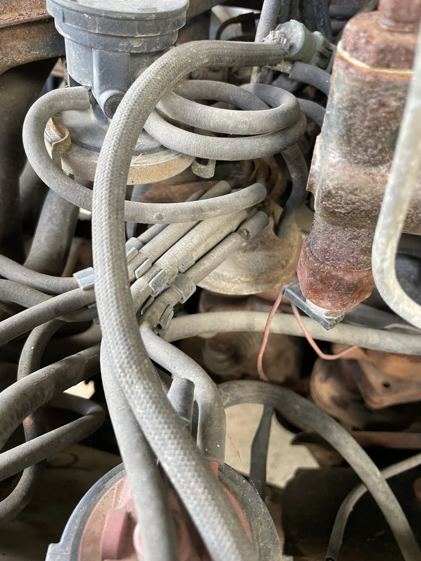

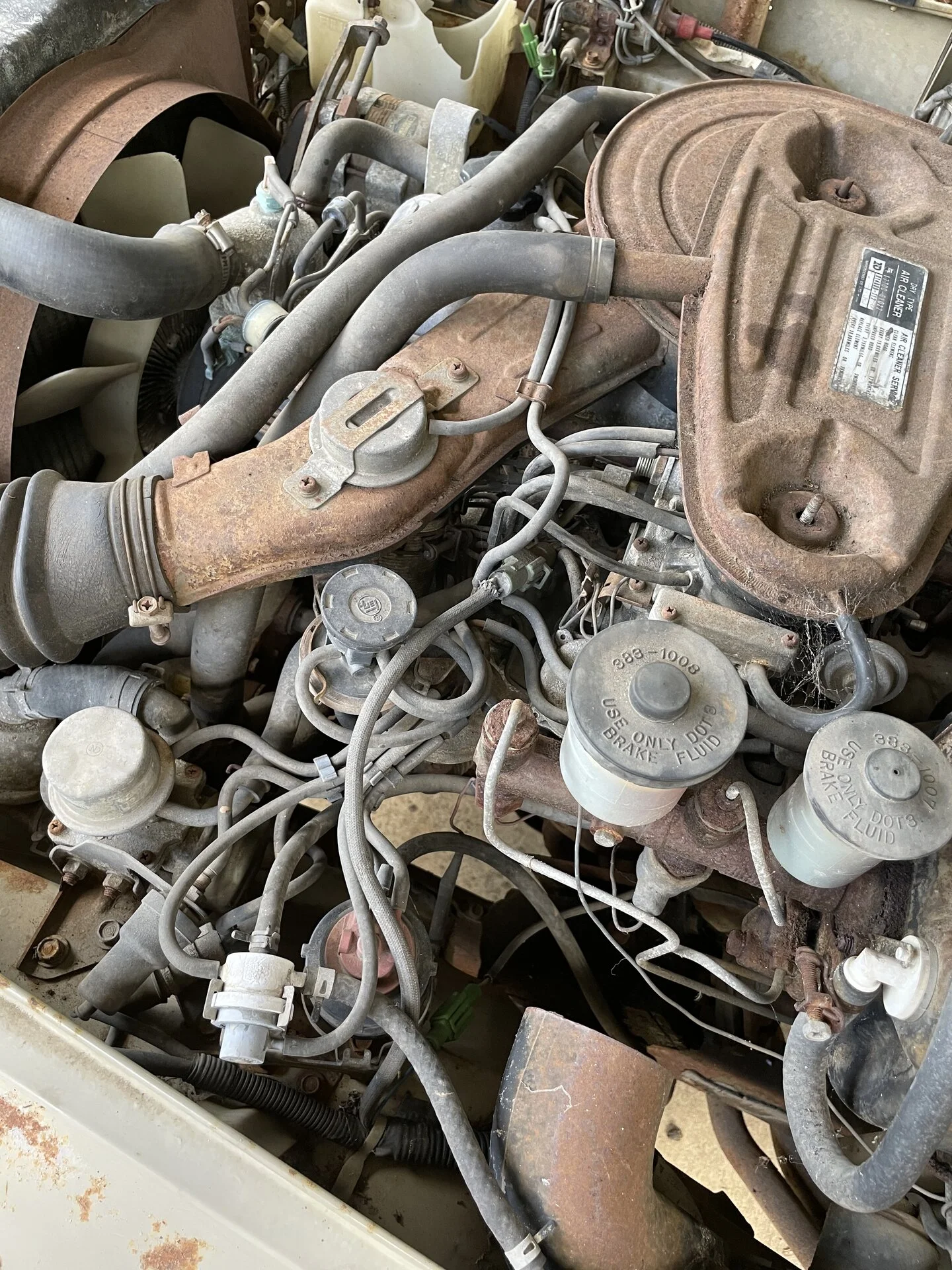

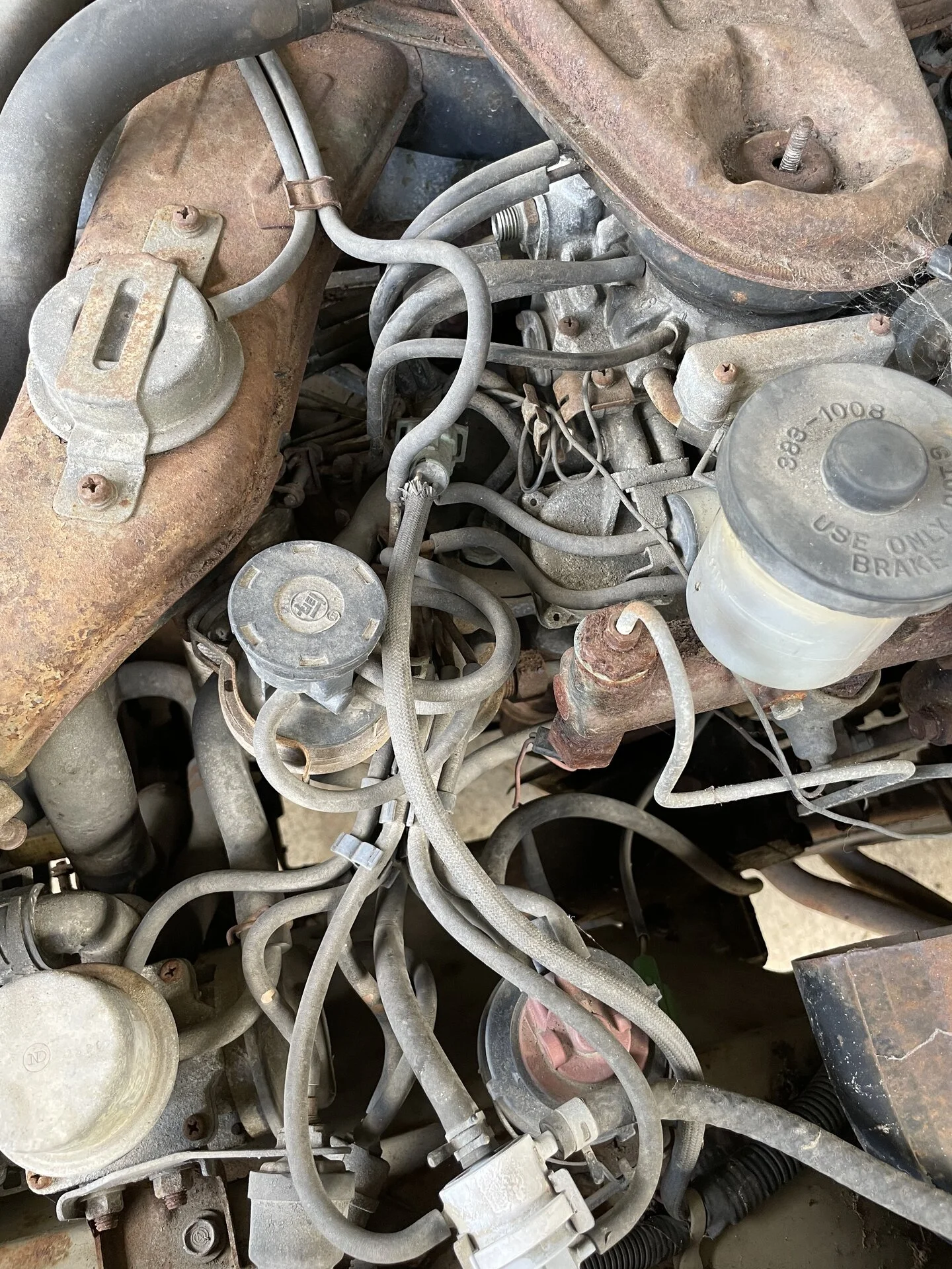

Posting a pic of all the vacuum hoses on Blue Plate for future reference
Your Charcoal canister, if you haven't resolved yet, I think is diagrammed in one of the toyota manuals, maybe the emissions manual...
On my '74 one of the hard lines just disappears into the frame rail to vent to the atmosphere. Later models they vent into the air filter housing. If I understand the charcoal is supposed to absorb hydrocarbons and the "gassy" smell from the tank venting.
And heater hoses running into something with an AC plug would be an engine heater, from Montana, where it's often well below 0 degrees Fahrenheit, and oil get thick.... Plug it in to warm it up for 20/30/60 minutes before starting. (Having grown up in Alaska, joining ih8mud has shocked me on how many people don't understand what these are for...)
I found the hole where the charcoal vent tube is routed through the fire wall and stuck it through after @fjc-man pointed me in the right direction.
Yeah I figured the plug going into the heater hose line must’ve been some sort of pre heater for frigid climates. Will probably do a delete on that when I change all the hoses which is on the honey do list.

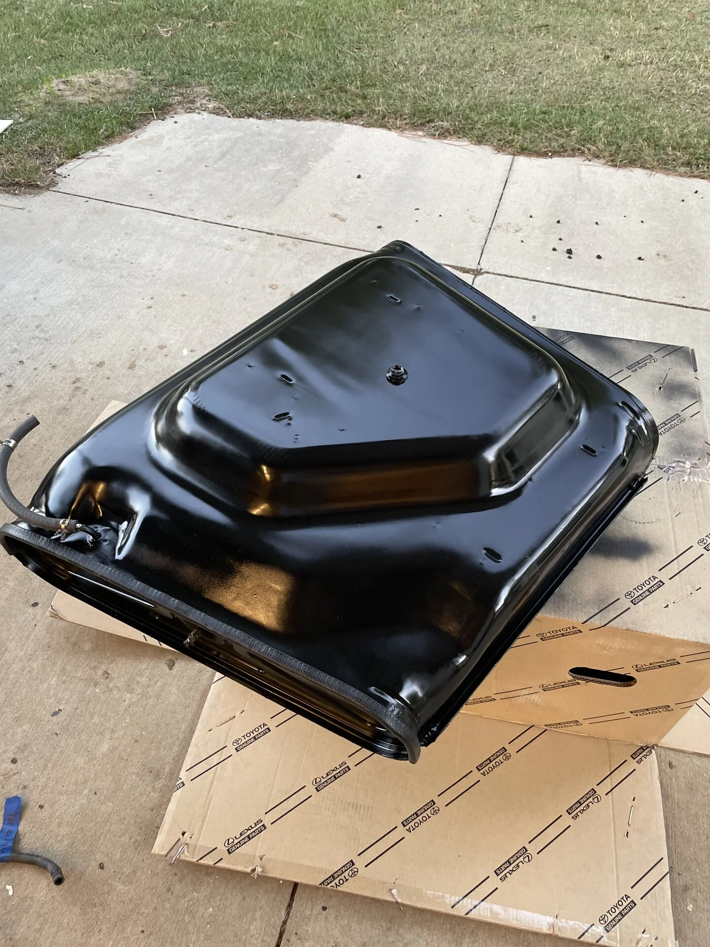

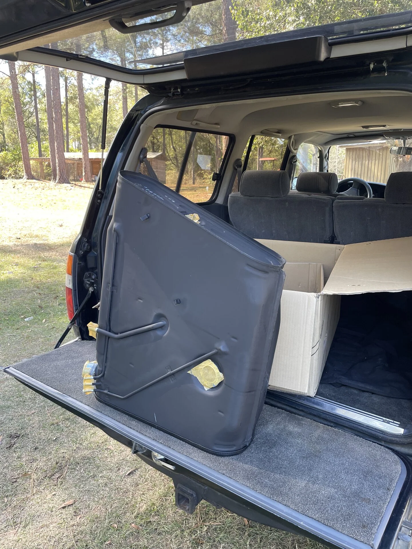

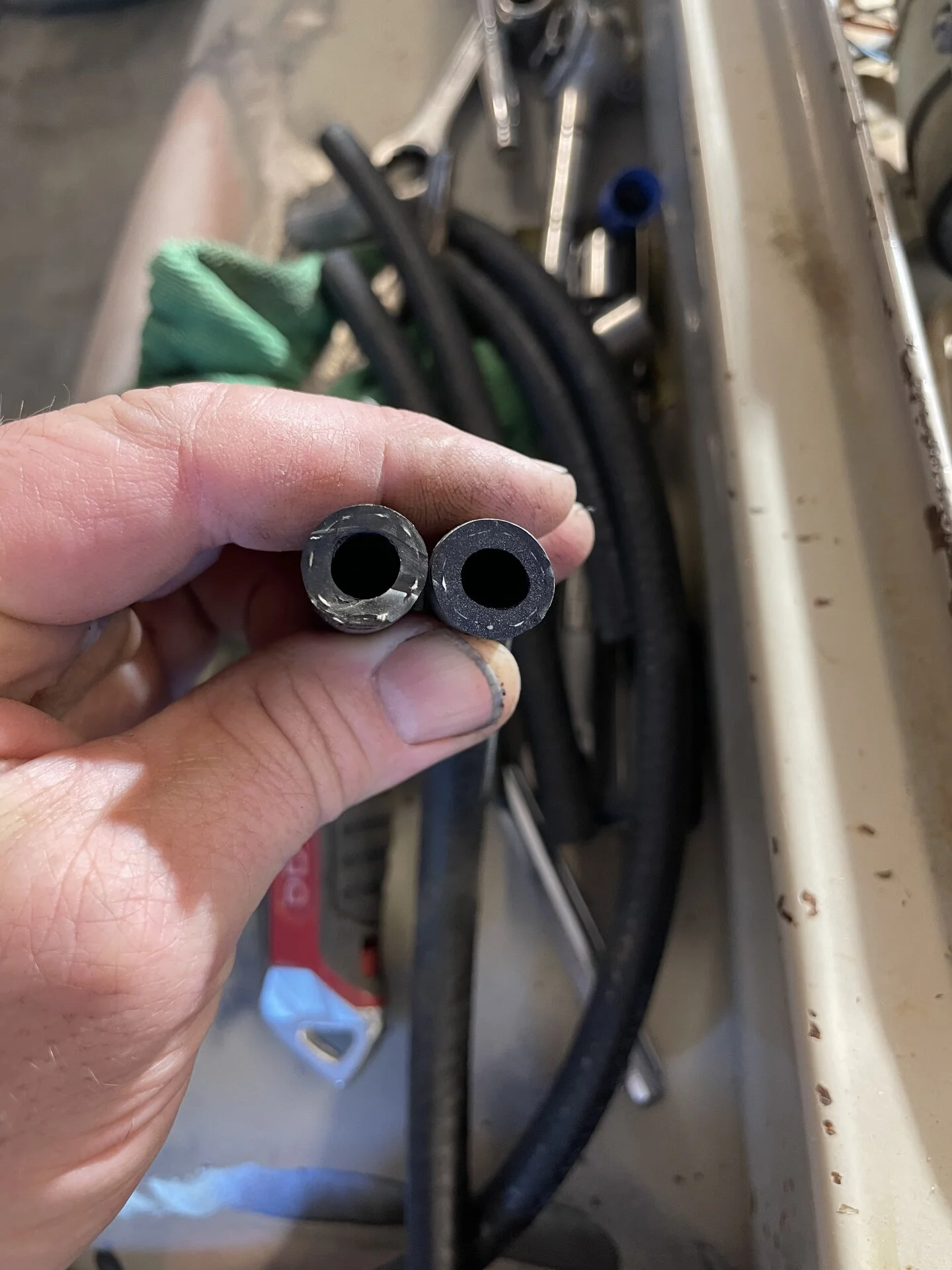

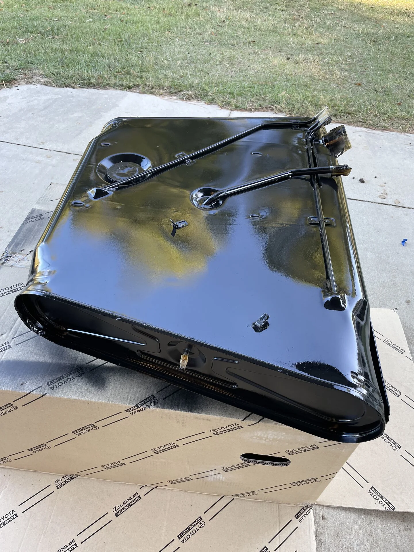

I received the new oem fuel pump from @ToyotaMatt and got that installed. It took me longer to scrape off the old gasket than to install it and came with new bolts and gasket. I ordered a new Toyota gas tank from the dealer today and will pick it up tomorrow. I will install it this weekend. It was $$$ but I don’t want to keep guessing on the condition of the old tank and will try to ospho and clean the old one up as a spare. I also didn’t want a poly tank as I’ve heard nightmares about leaks and fittings on non Toyota tanks. All in I will have replaced the entire fuel system and hoses on Montina so shouldn’t have any worries after the new tank install. I need to get it up and running before I dive any deeper into the blue plate ‘79.

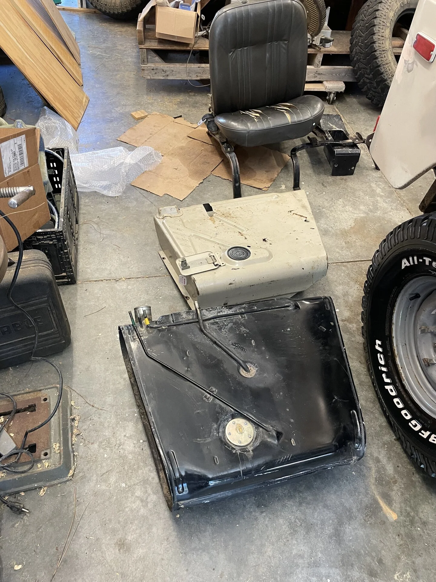

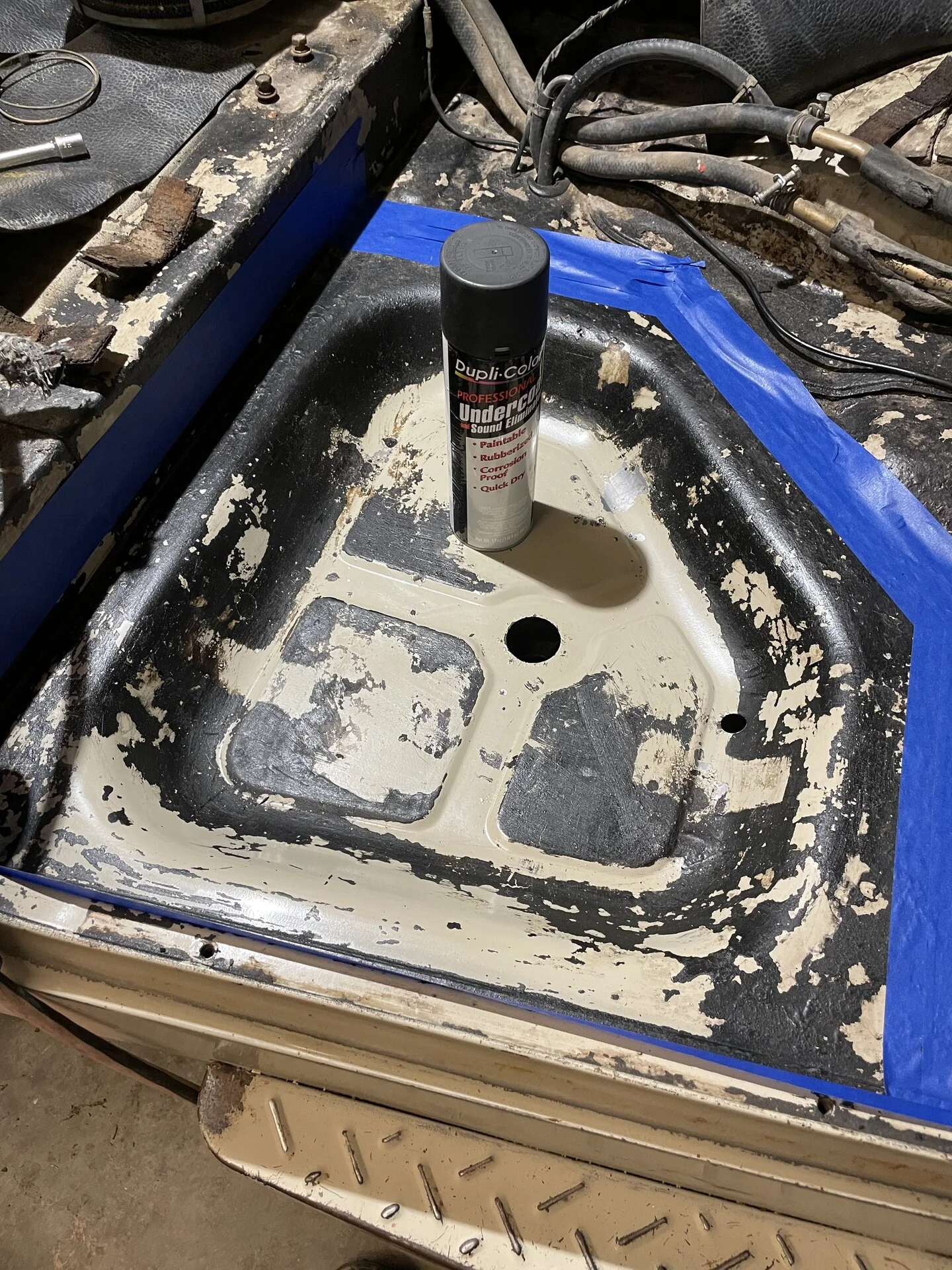

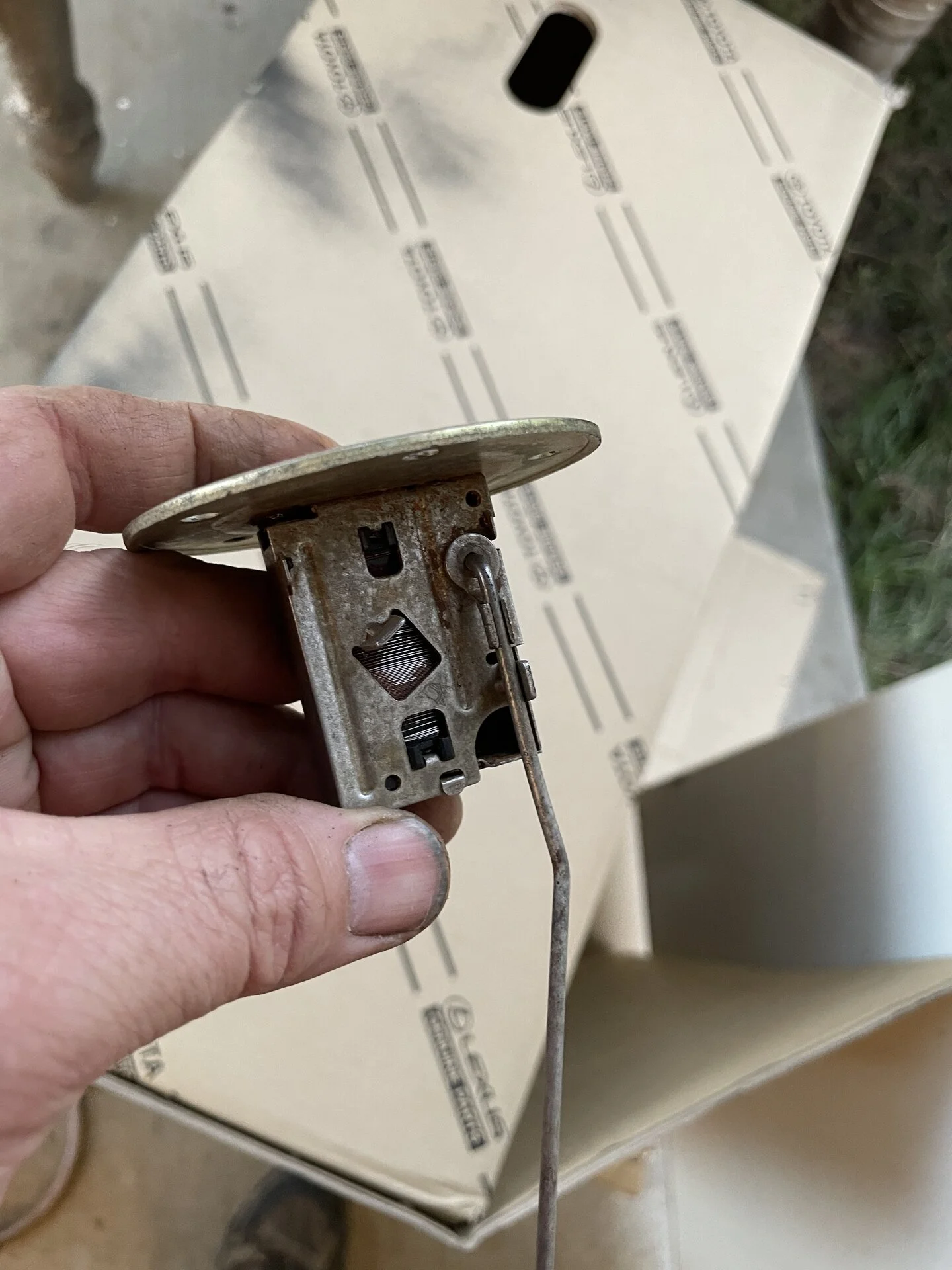

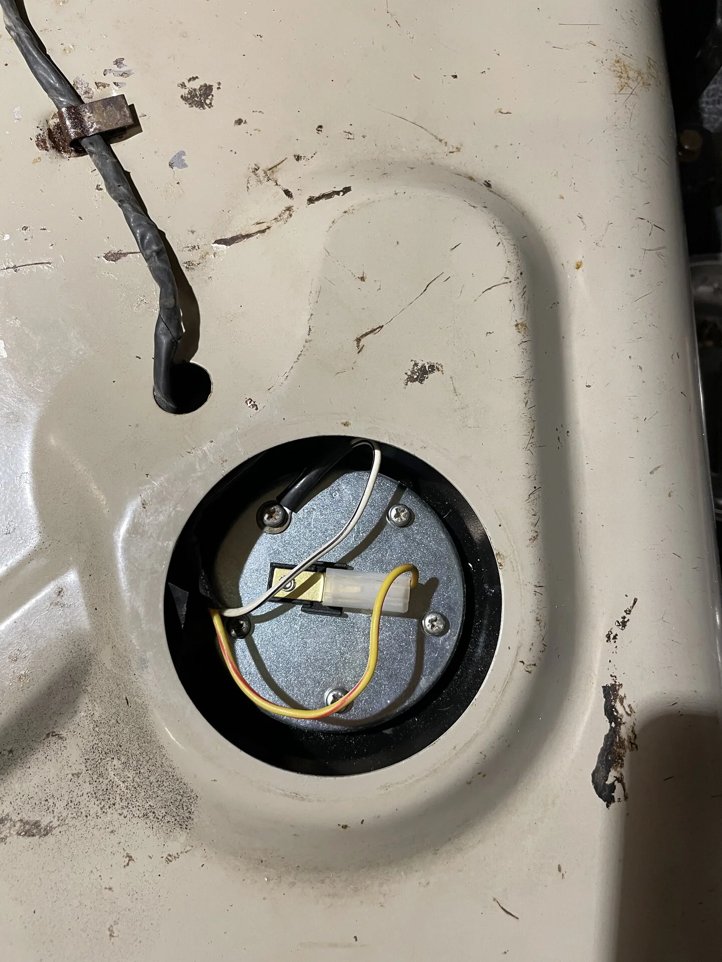

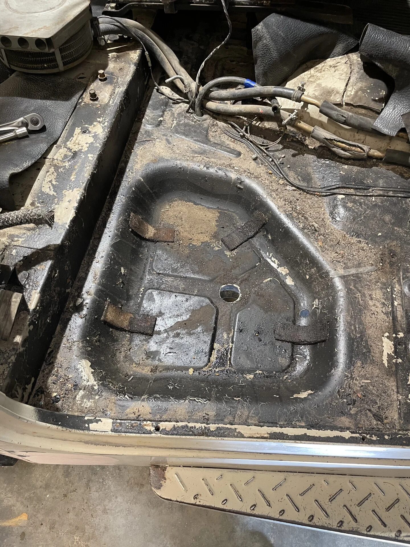

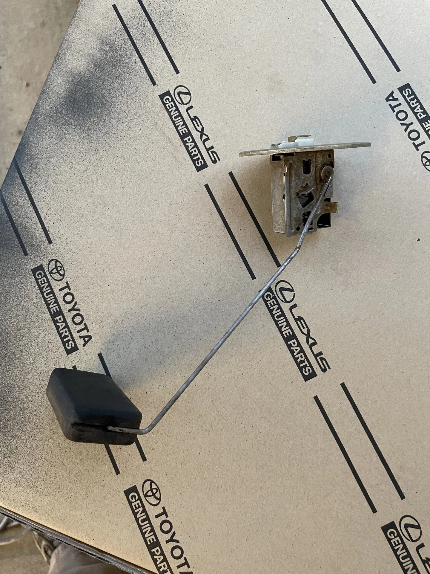

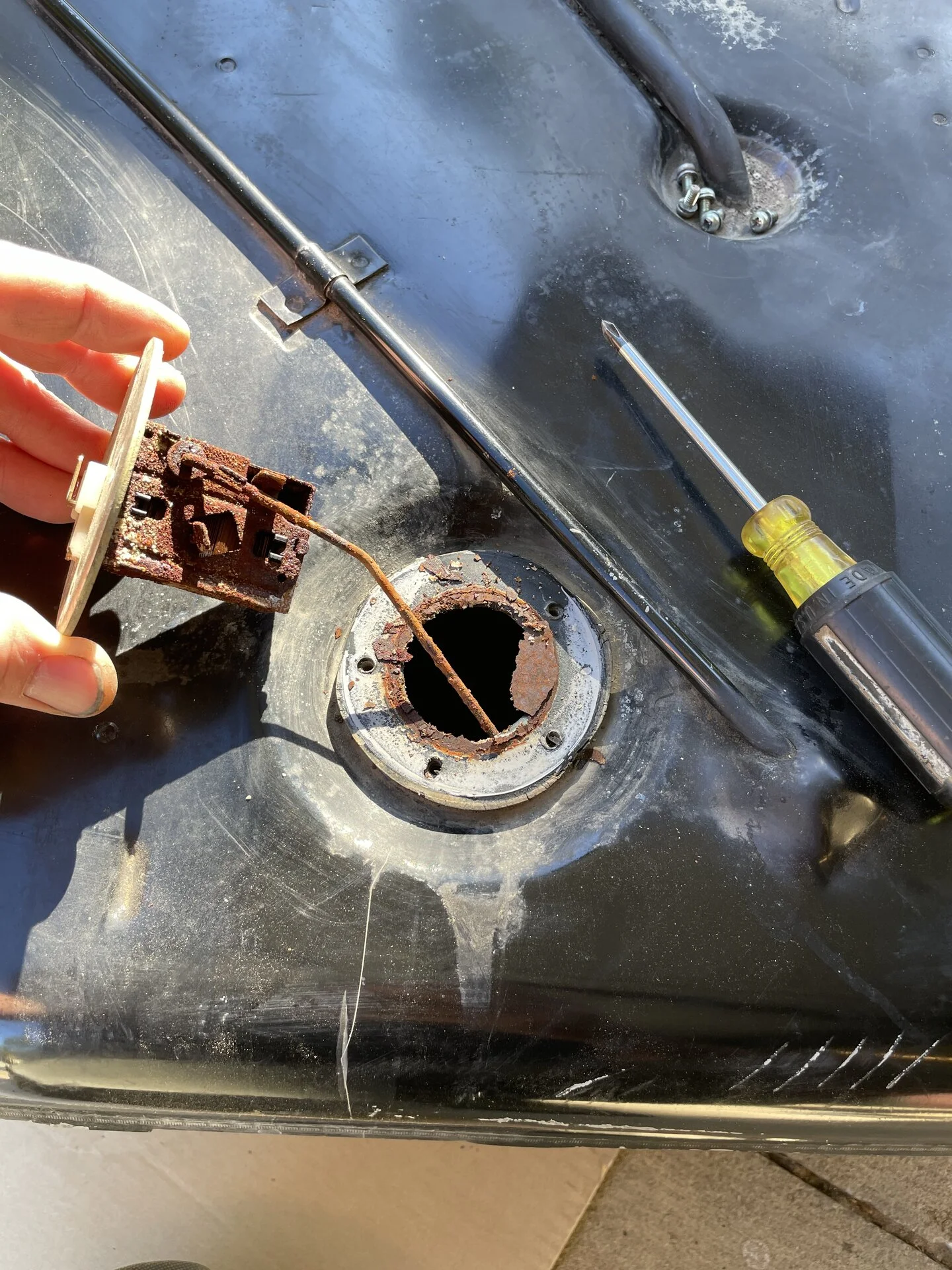

Installed the new Toyota tank. Cleaned up the original sending unit. It actually still works when I hot wired it outside the tank. I used throttle body cleaner and a wire brush. I’m still waiting on the aftermarket unit from CCOT to come in and will use that one. The dogs love hanging out in the cruiser while I work on it.

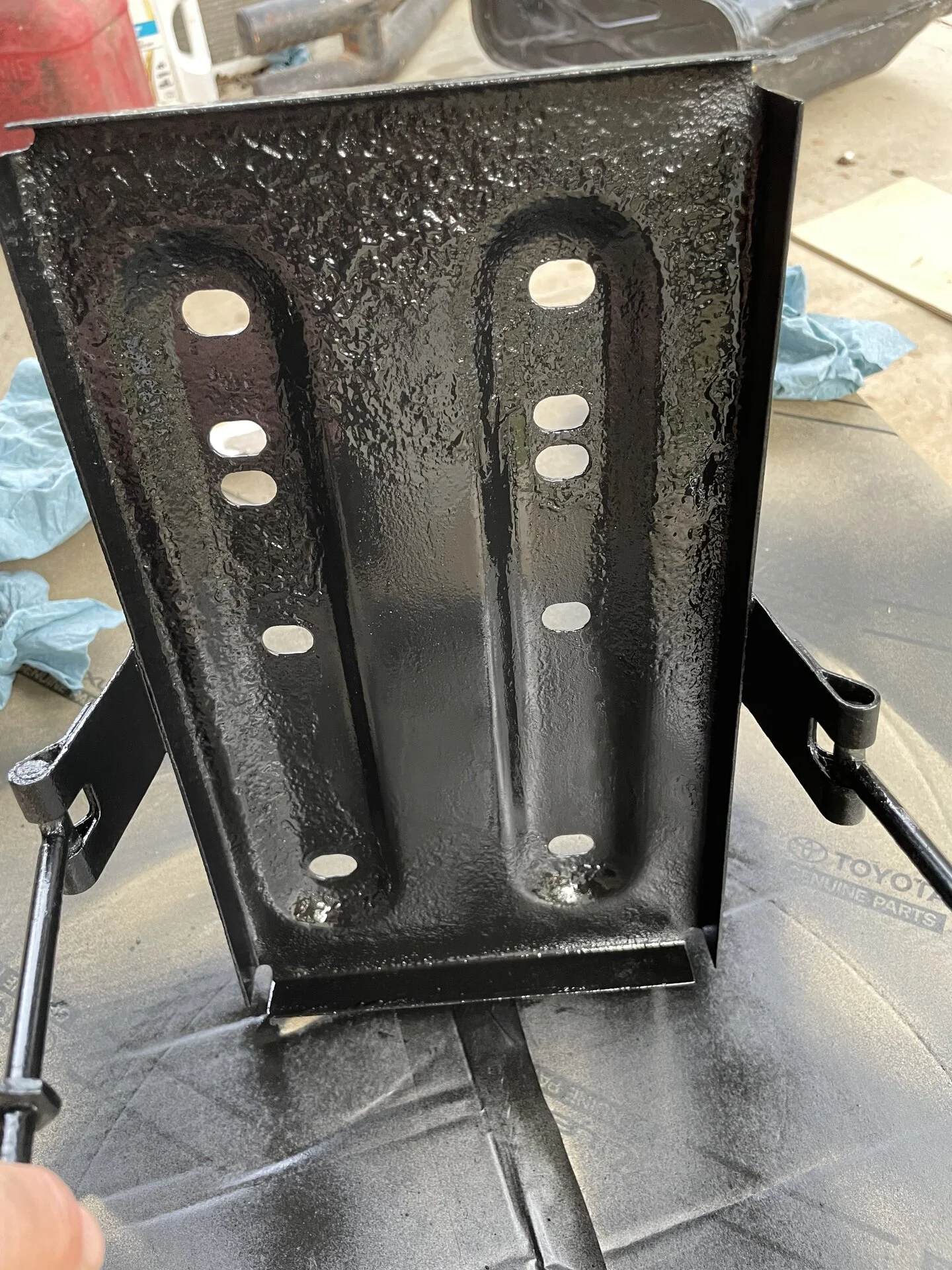

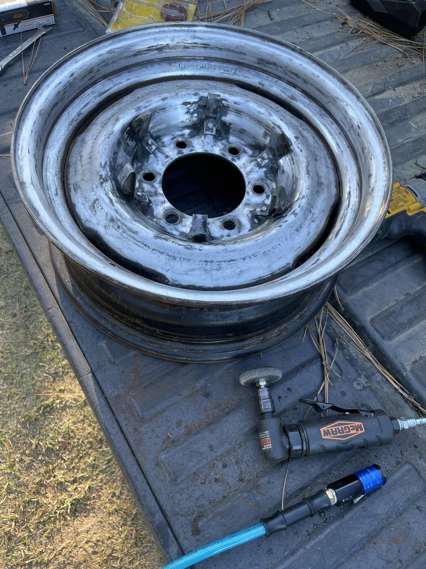

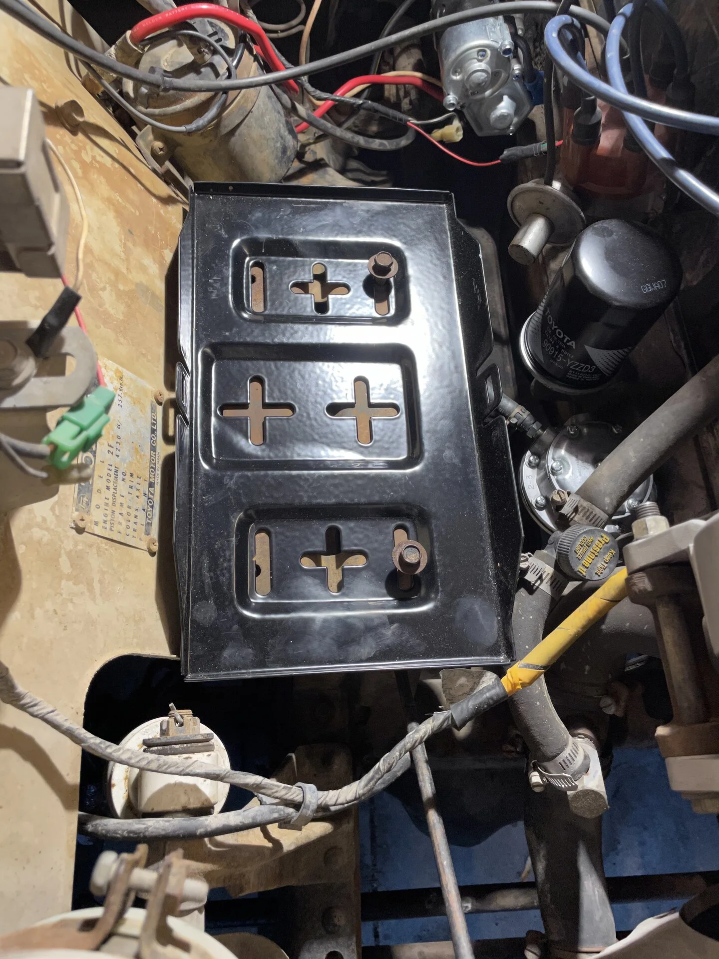

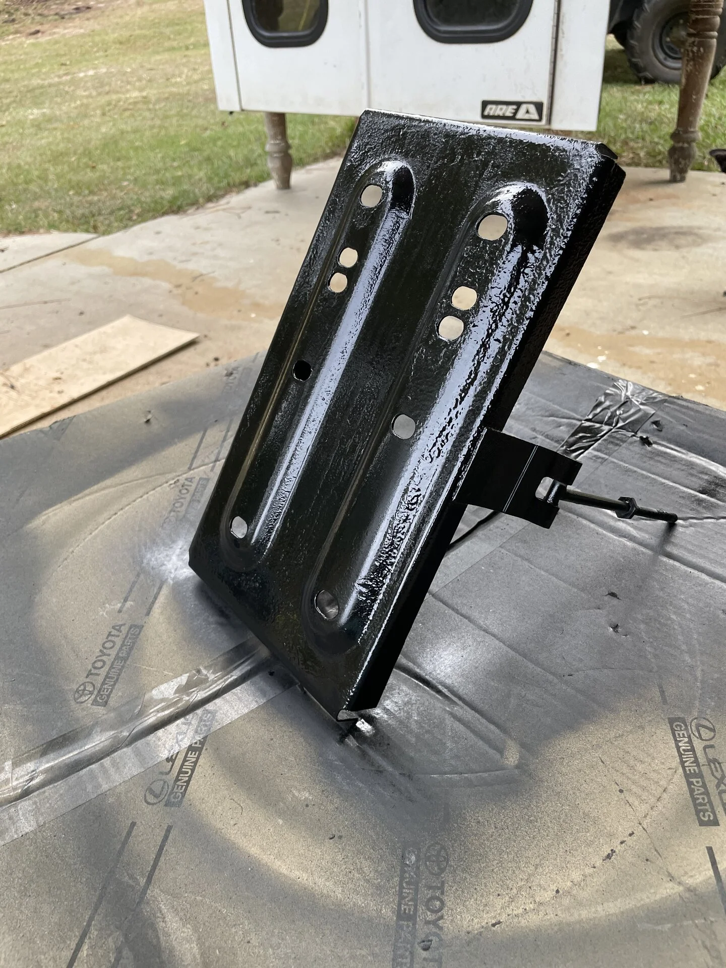

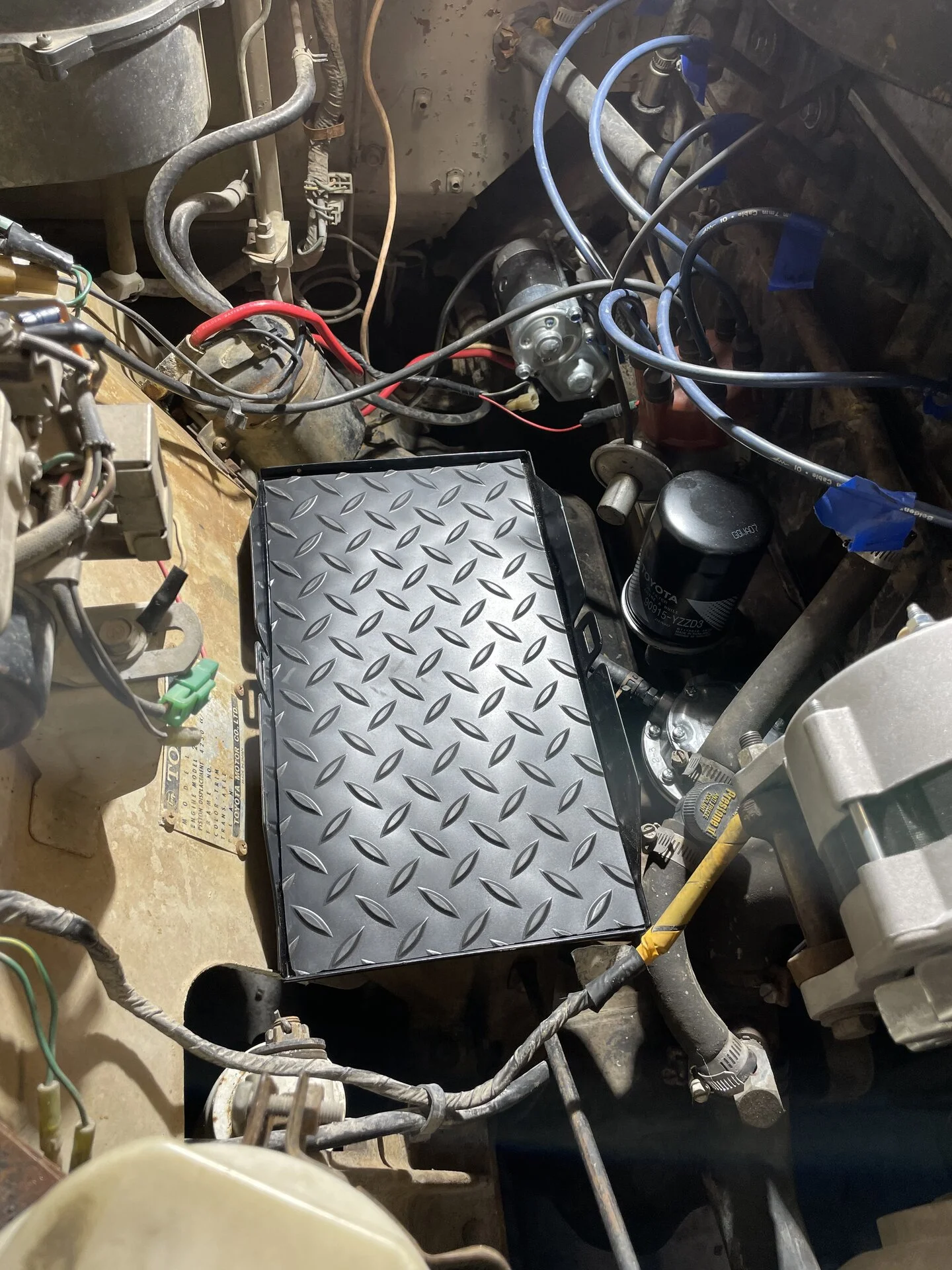

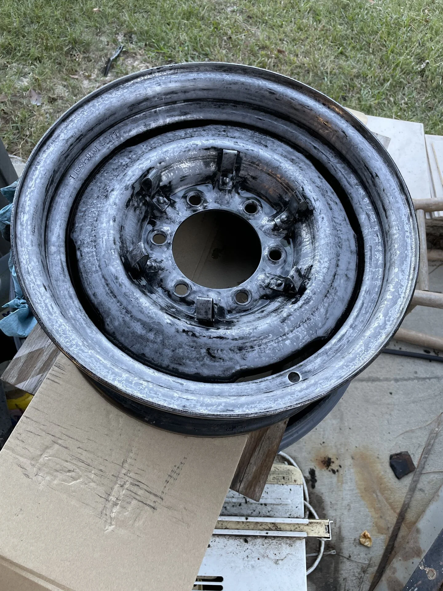

Painted the spare rim and the battery tray. I used Rustoleum etching primer and their gloss nardo gray paint (2 coats) which was close to the factory color. Battery tray was stripped, ospho’d, primed and painted with rustoleum gloss black. It had a lot of rust build up. Also using rubber undercoating on the tray. I’m still waiting on the new sending unit so I can fire Montina up since the new gas tank install.
First coat:
Second coat:

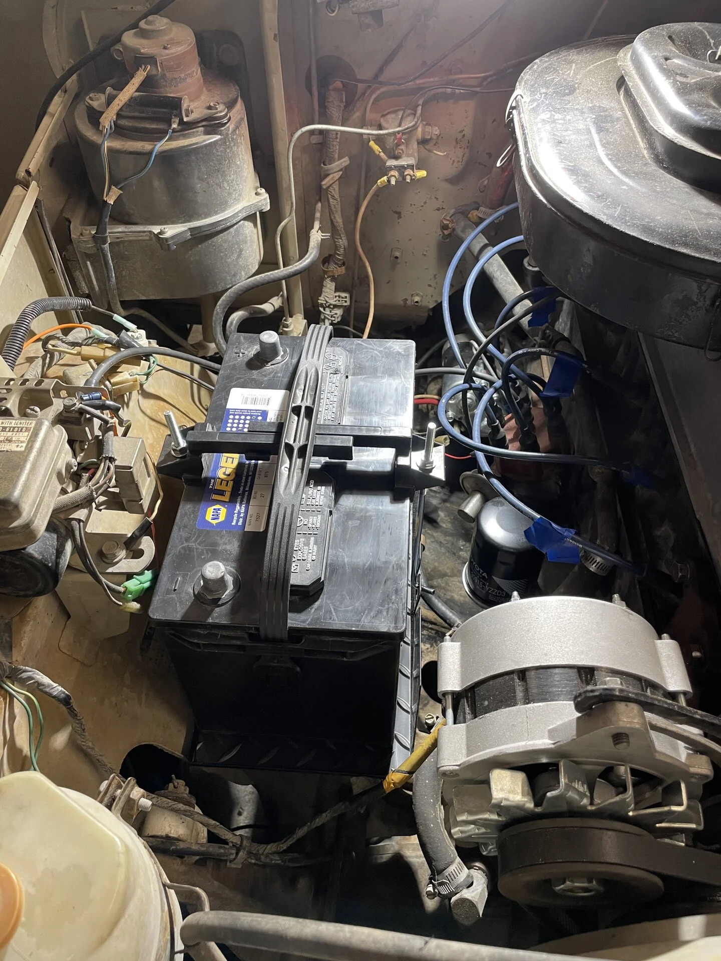

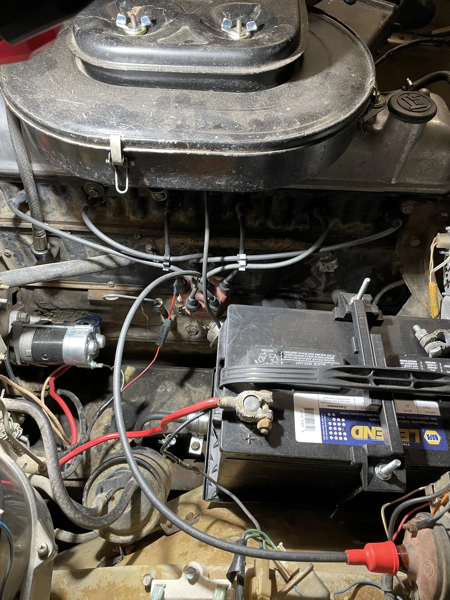

Took Montina out for a spin around the block for the first time since I got her. She did surprisingly well. No more stalling with the new oem gas tank, fuel pump, and fuel lines. See if you can spot the deer in the third pic. It’s rut season here and a nice sized buck ran out in front of me and wasn’t bothered by the engine. I even hit the horn and he wasn’t spooked. He had something better on his mind, lol.
She does have a significant exhaust leak from the header. Will need to replace the exhaust manifold gasket soon. Anyone have any suggestions of what brand to use with headers?
