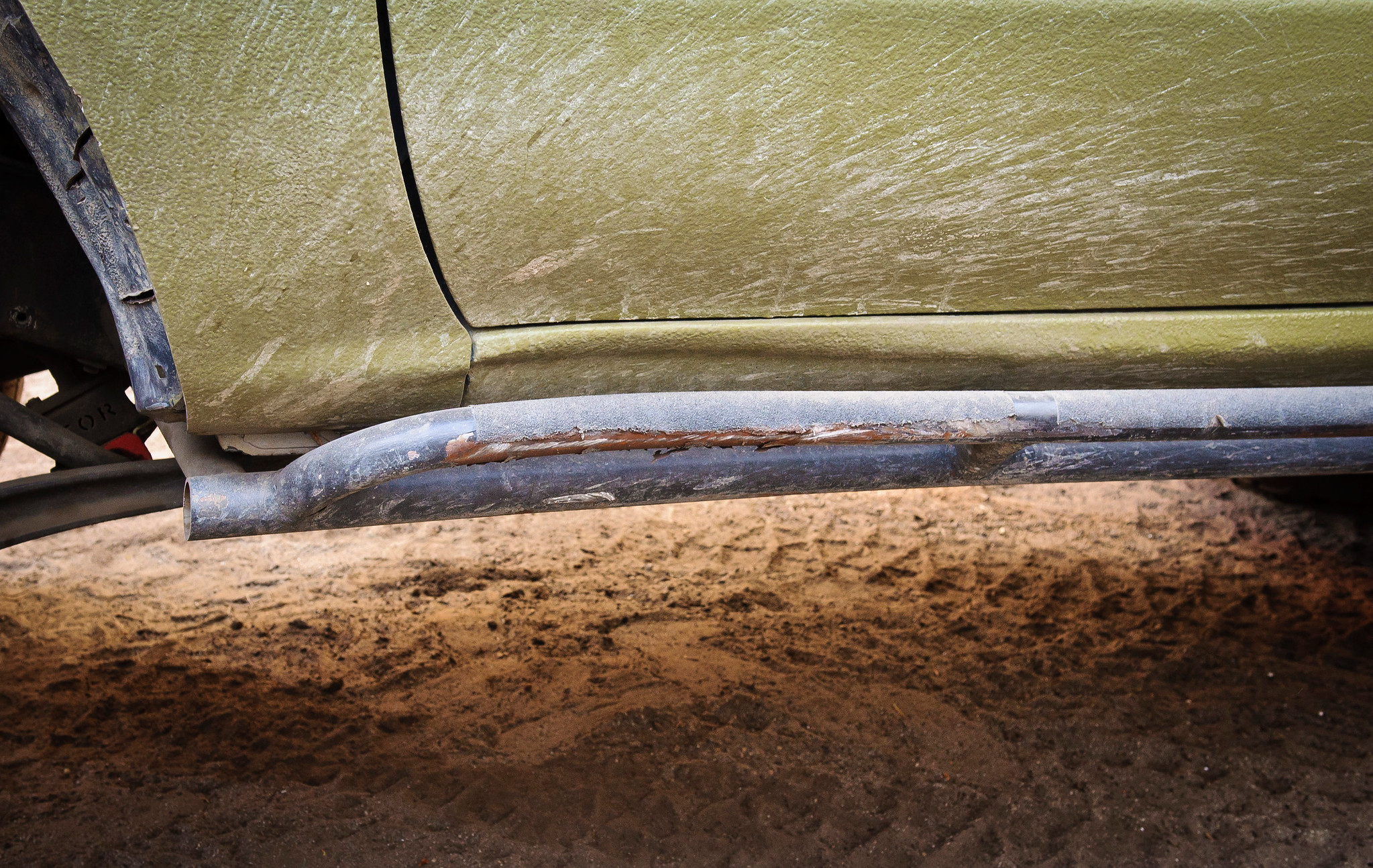

It really is the tits. I love that it doesn't get damaged like regular paint. It sorta just bends with the metal during impact.
Bent rocker panel when my slider was pushed into it:

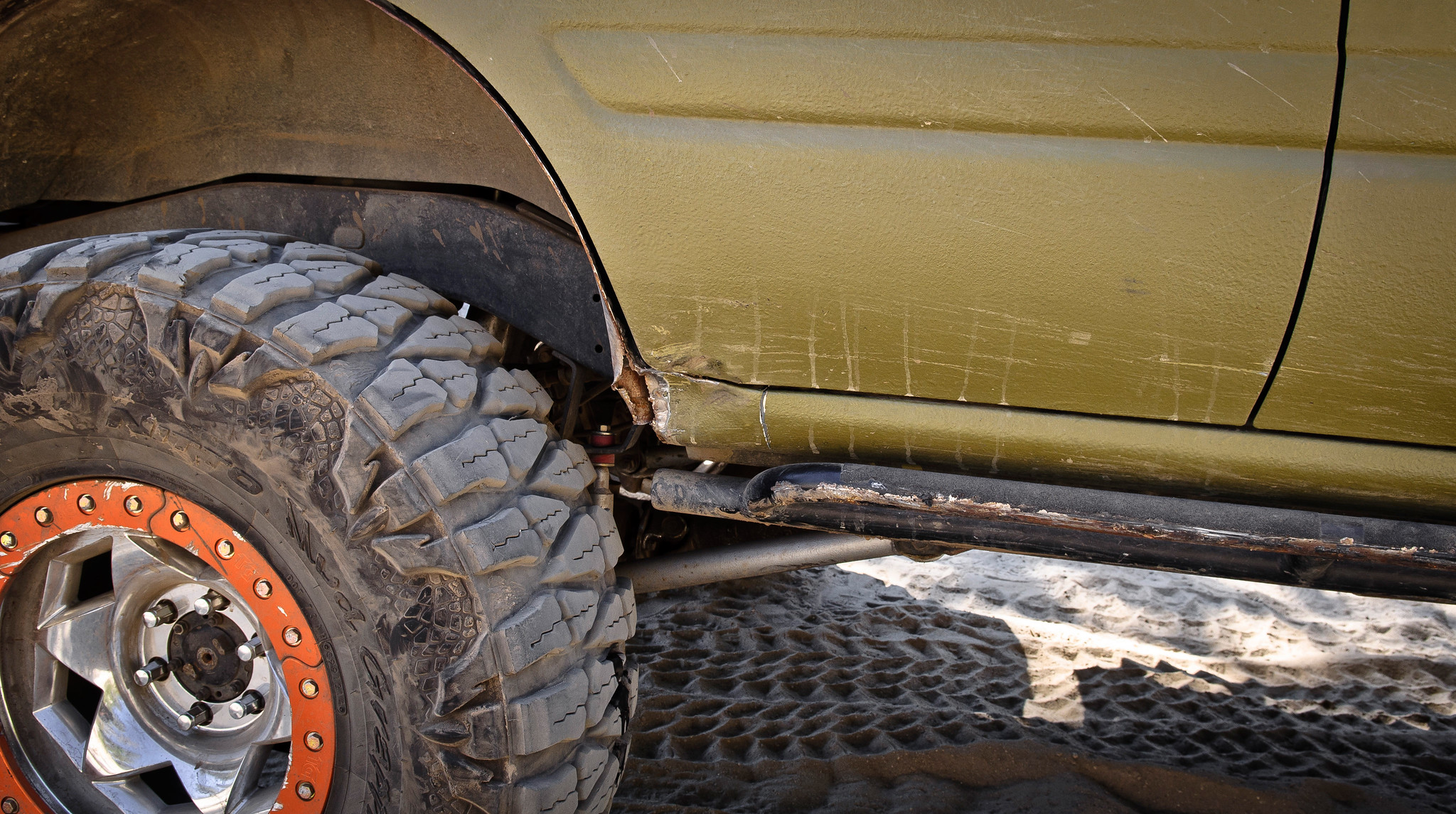

Holds up well against boulders too
Once I'm done with all the cutting and trimming I'll need to touch-up the paint again. Was thinking of doing a two-tone with Pyroclastic.
Thanks for the pics. Trying to decide if I should order one color or make it two tone
