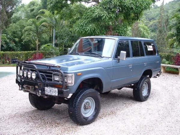

Sharing pictures. 15 years ago, my LC 62 textured paint job
full
