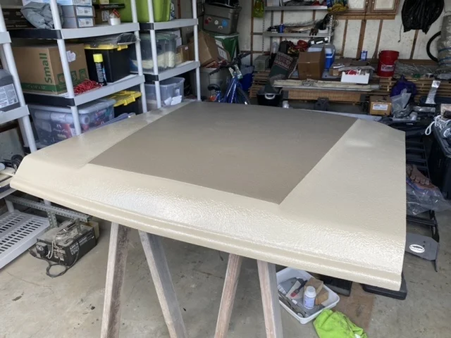

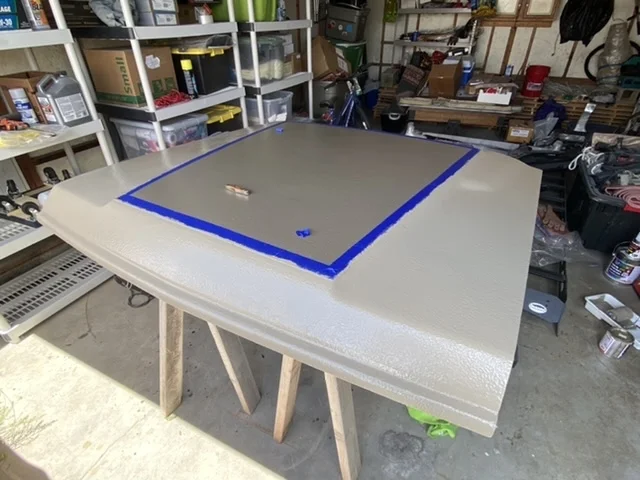

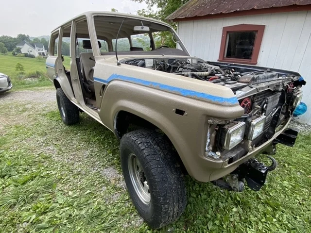

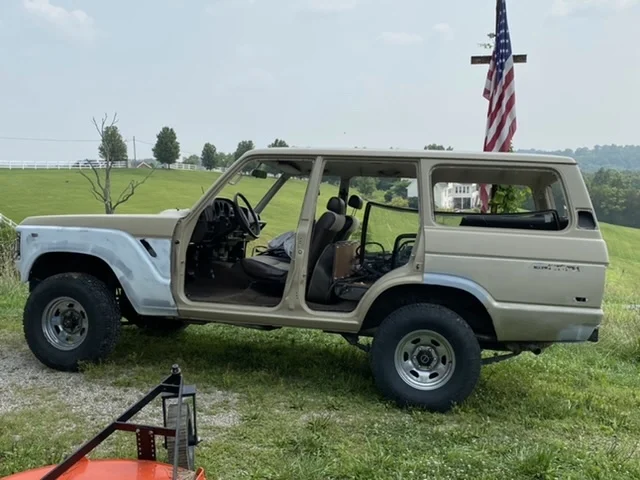

I’m cutting out rust and starting to weld in patches today. Took my hood down to bare metal, fixed a couple of very minor dents, spicy primed, sanded and rolled on the liner.
This is a driveway resto/mod. Considering that, I am extremely happy with my first results. My hood turned out great. One quart of desert sand/one quart of dirt bag.

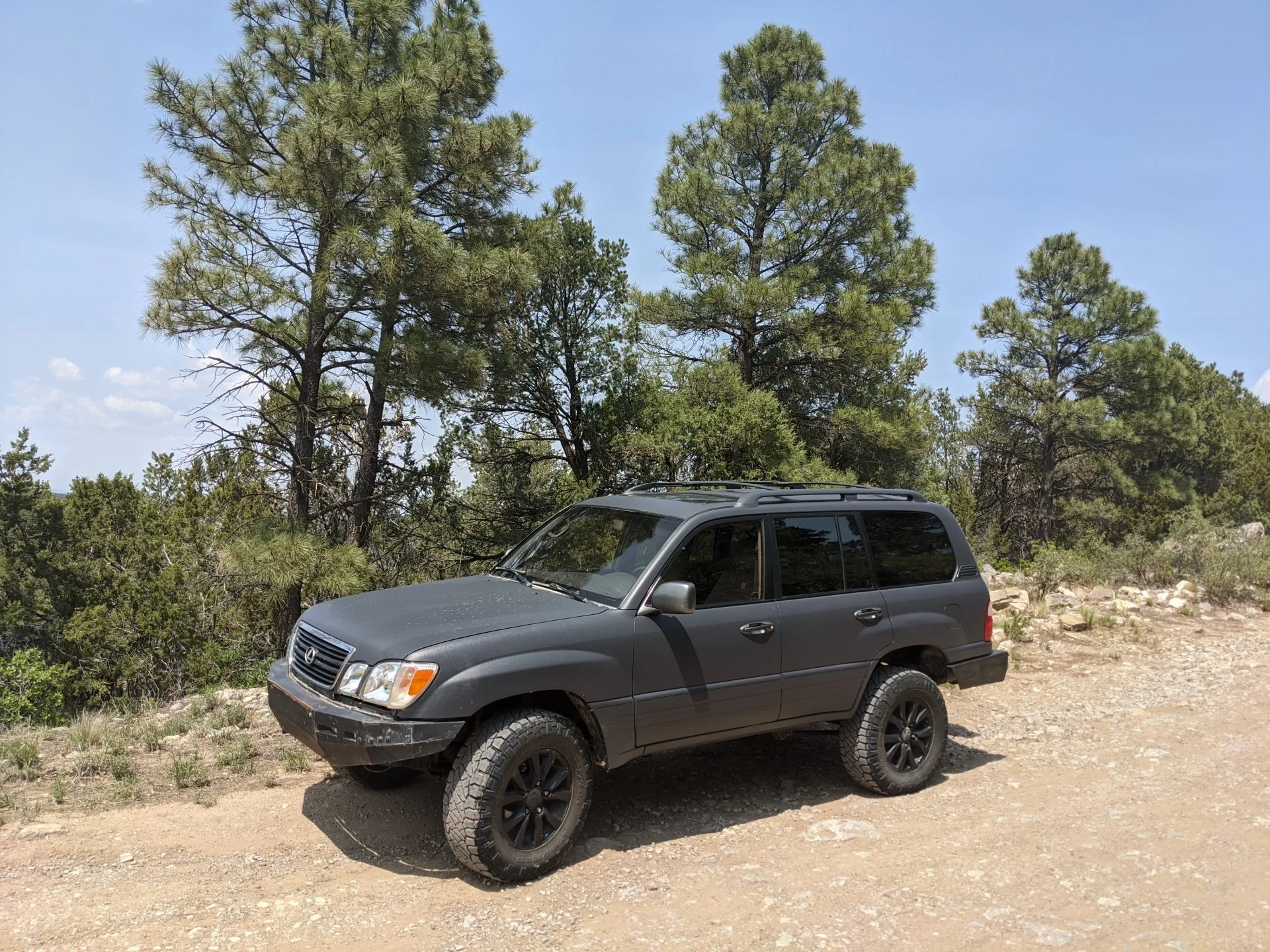

Coming along nicely from the pics. I'm considering gray below the trim line and white above. I have quite a few dings, dents and rust to address first.
Thanks, man. Gray and white would look excellent.

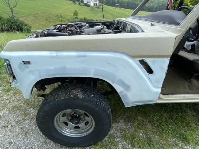

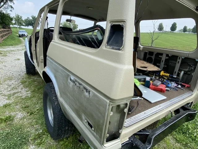

did my first welding yesterday. An absolute blast... just took a bit to learn the finesse needed. Working on my DS fender today. I’m going to paint fenders/apron/tailgate/lift gate off the truck. When my glass guy comes and uninstalls the glass, I’m monstalining everything above the body line in desert sand. Then sorting out the rust in my rockers and quarters... before adding “dirt bag” below the body line.
the Monstaliner has been great to work with. It’s a great product.
doing all of this (with exception of the glass) myself has been a learning experience to say the least. It’s kicked my but. Thank heavens for this forum!

I used flex core because that’s what I had access to (my neighbor offered it and I took him up on it). I blew a full holes through the panel right when I started. Beginners mistake. But as I got rolling, no more holes.., and I backfilled the holes I made with the welder. Honestly, not pretty, but it’s strong and grinding it, plus a little filler made it look just fine.
I’m sorry, I’m on my cell and am not sure what truck you have, but if you have a 60/62, Wolf Steel has good patch panels. You’ll find plenty of posts on those. Trail Tailor has panels too. I would wager that his are better.
anyway, back on topic (smiling), as long as you kill that rust, You won’t regret the Monstaliner. I’ll post up more pics as I get panels painted.

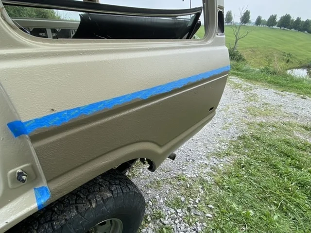

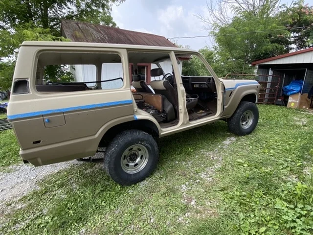

After getting all of my welding and body work sorted out, today, I applied “desert sand” above the body line, on the roof, door frames and rockers. The humidity here gave me fits today as the Monstaliner began to cure immediately... had to top it off with a little acetone every time I opened the can. And I still ran a little short. Went ahead and ordered another gallon for touch-ups and for painting my doors above the body line.
Tomorrow, it’s “dirt bag” below the body line all ‘round’!
This “restoration” has kicked my butt, but totally worth it.
It’s almost time to put her back together!

First coat of “dirt bag” applied below the body line. Ready for the final coat.
