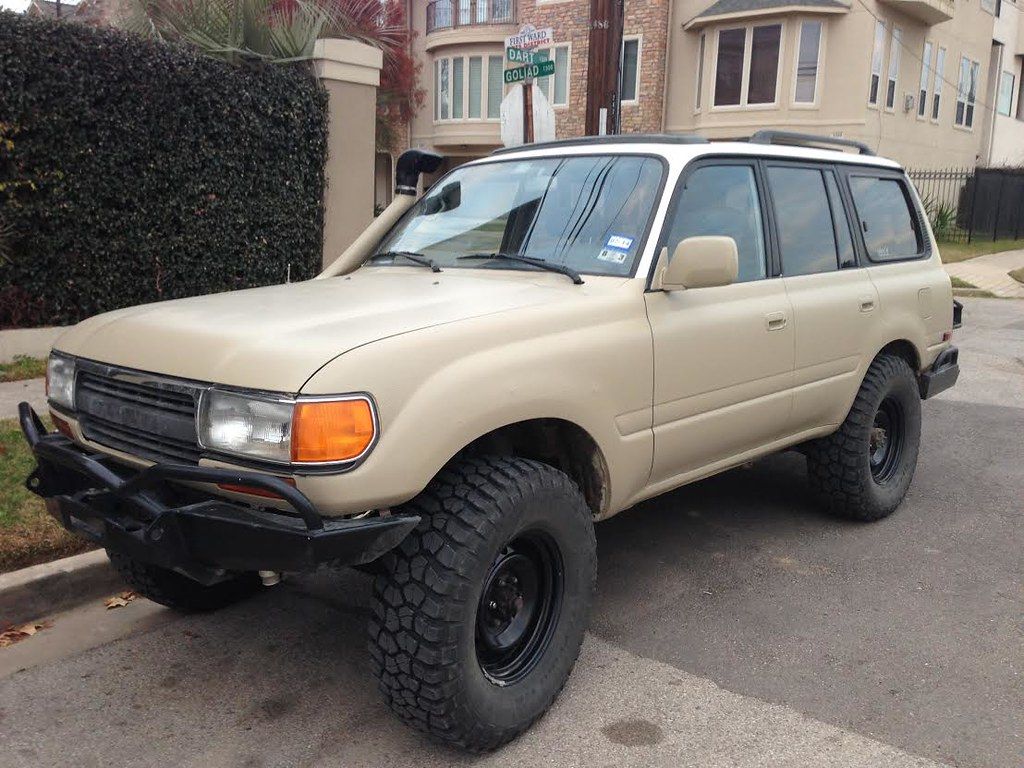

I ordered 2 gallons of Desert Sand roll-on, but ended up only using 1 since I decided not to do the roof.

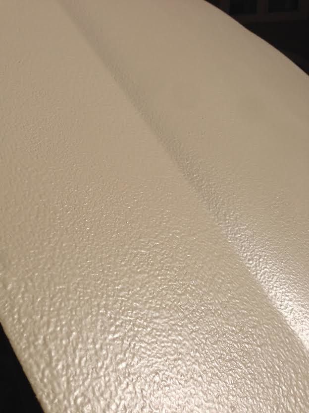

MaTm that looks really good and good to know that you used only 1gallon on your 80 (sans the hood). How thick of coats did you put on? And how "aggressive" is the texture? Can you post up some close up shots.
I put the layers on as thick as I could without globbing.
The texture is not aggressive and it looks like it will be easy to clean.
Here's a close-up. I hope it helps.

MaTm- That looks great!
MaTm, very nice job congrats!
Thanks guys very much.
I'm really happy with the way it turned out. It was a simple and straight forward process.
