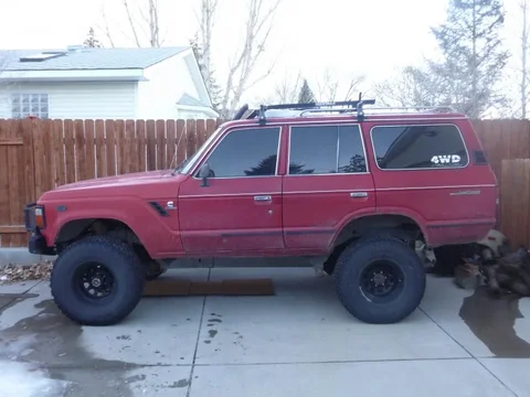

Here's my new FJ60 Project:

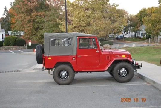

And a FJ40:
And another:
