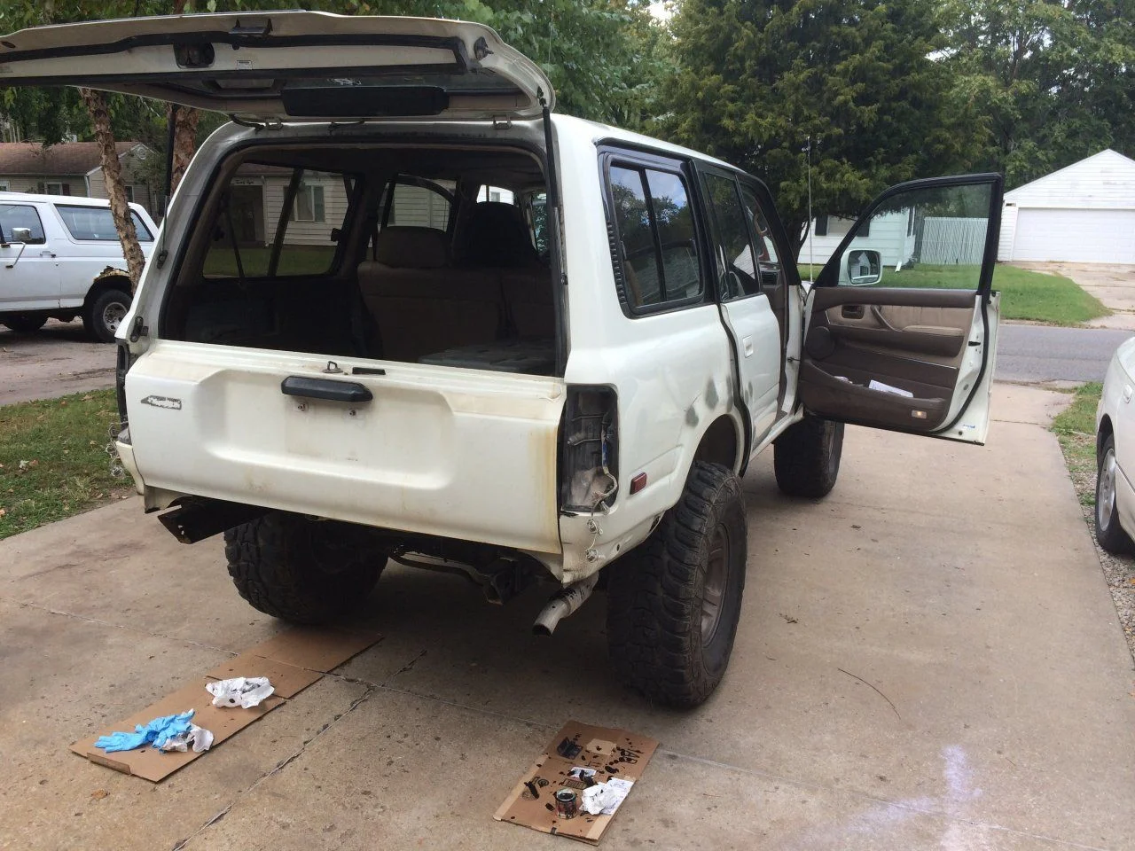

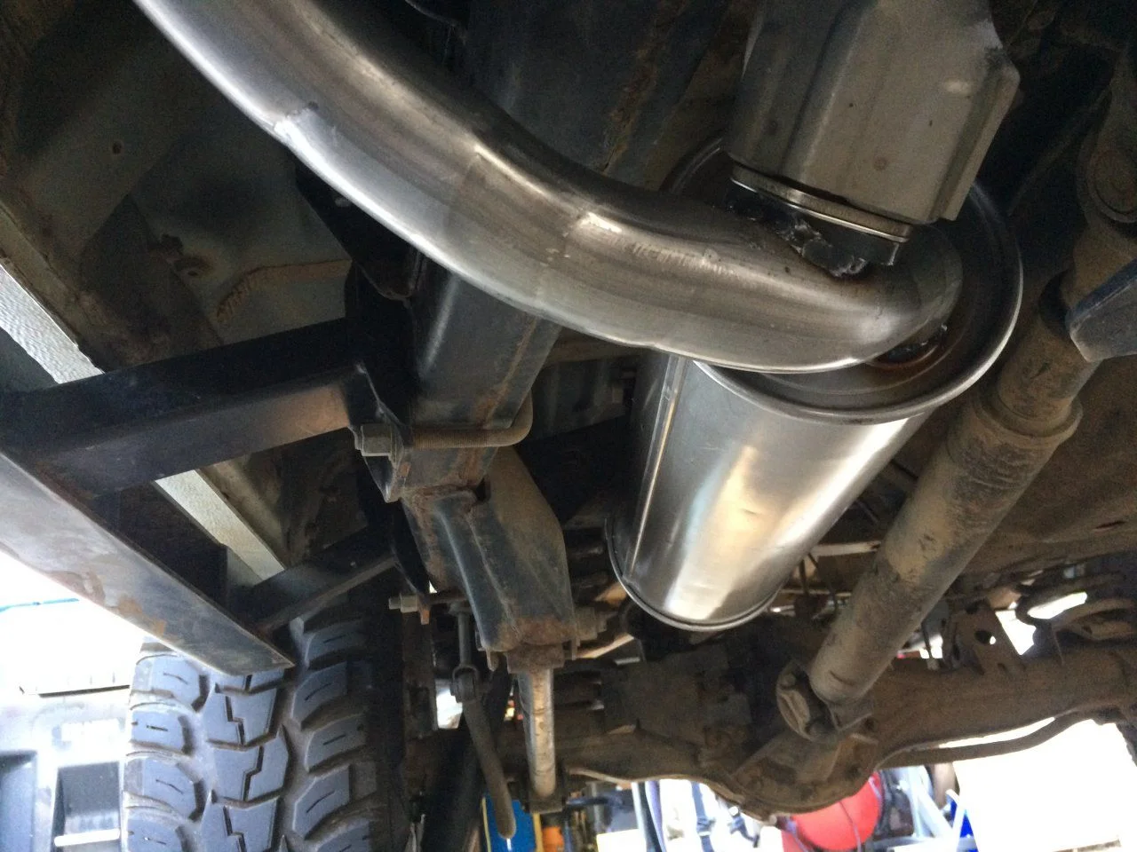

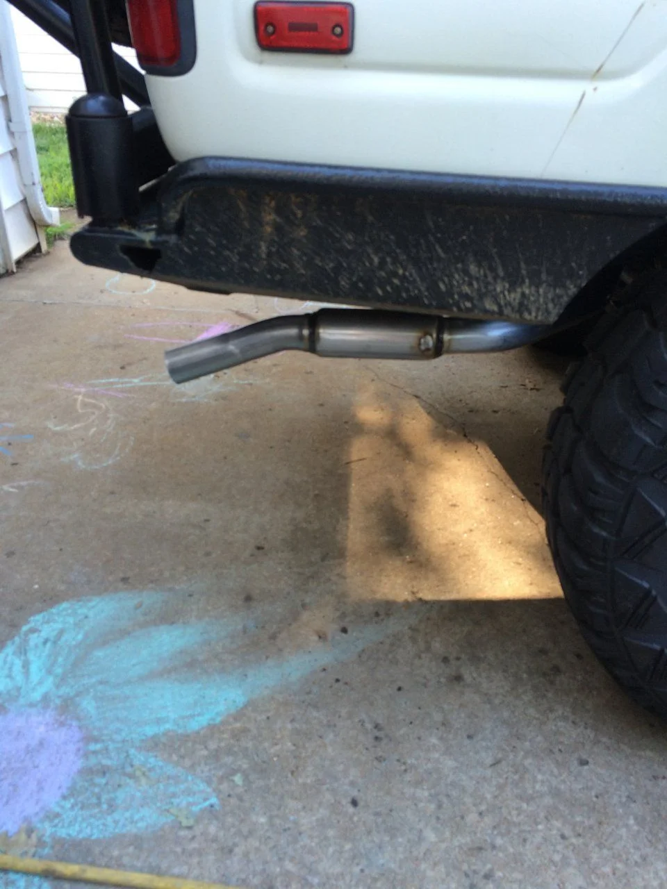

Replaced the exhaust from the cat back. All is done with the exception I have to fab a mount for the rear. The 4x4 labs bumper interferes with the factory mounting point. I have a new rubber mount coming and I will fab a mount that goes up through the hole in the labs bumper and uses the stock isolation point. The exhaust is the Bosal kit from Rockauto, coated in Rustoleum high heat clear coat, stainless hardware used to connect everything. For $200, if I get a year or two out of it I'm going to be happy.
So, what is your impression of that exhaust system?

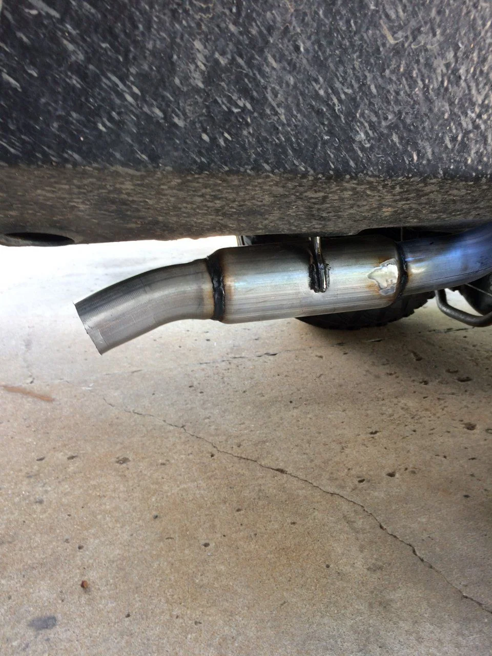

End of the road for the runner. This picture doesn't do this obstacle any justice. The approach angle is steep enough that the later decent crushed in my already shortened tailpipe. The combination of wet tires and very steep angle caused the runner to keep slipping off of its line. Even though we could have winched him up if we had to, we decided to park the runner and continue up in my rig.

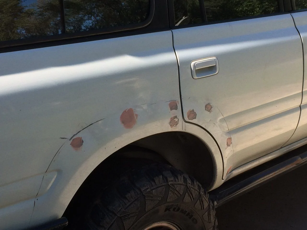

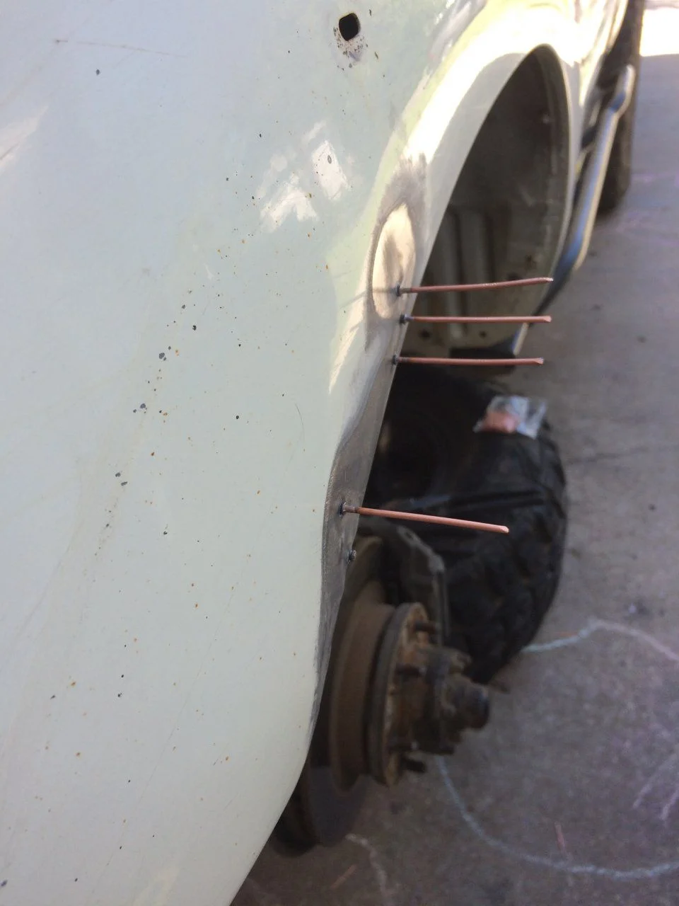

After the trip I decided it was time to give the truck some much needed repairs to the coachwork. Starting with all of those fender flare holes....

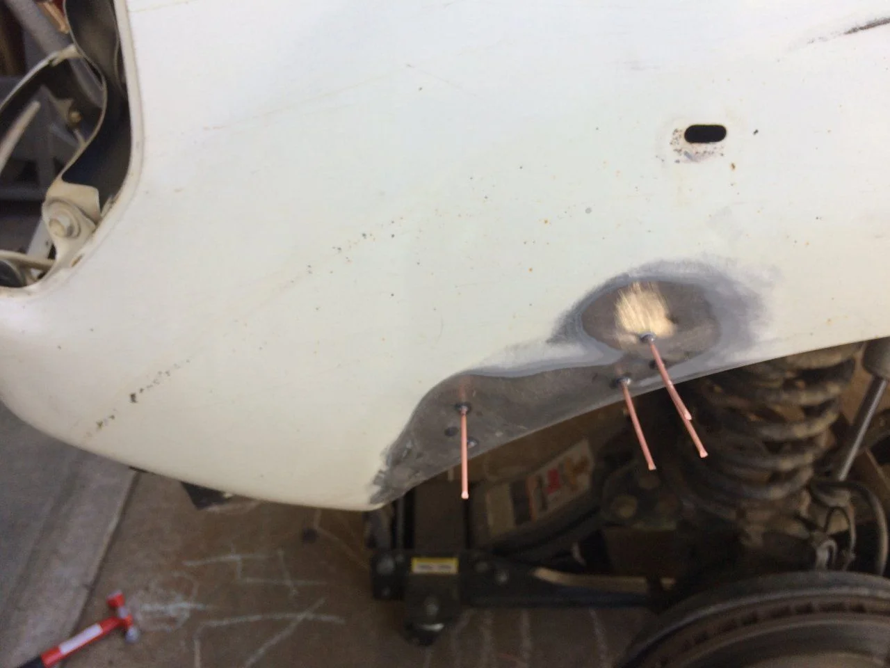

After that I used the stud welder to draw the DS fender back into position. The previous owner, a friend of mine, smashed it into a ditch while driving the truck through a field at night. Its not perfect, but its far better than it was ....

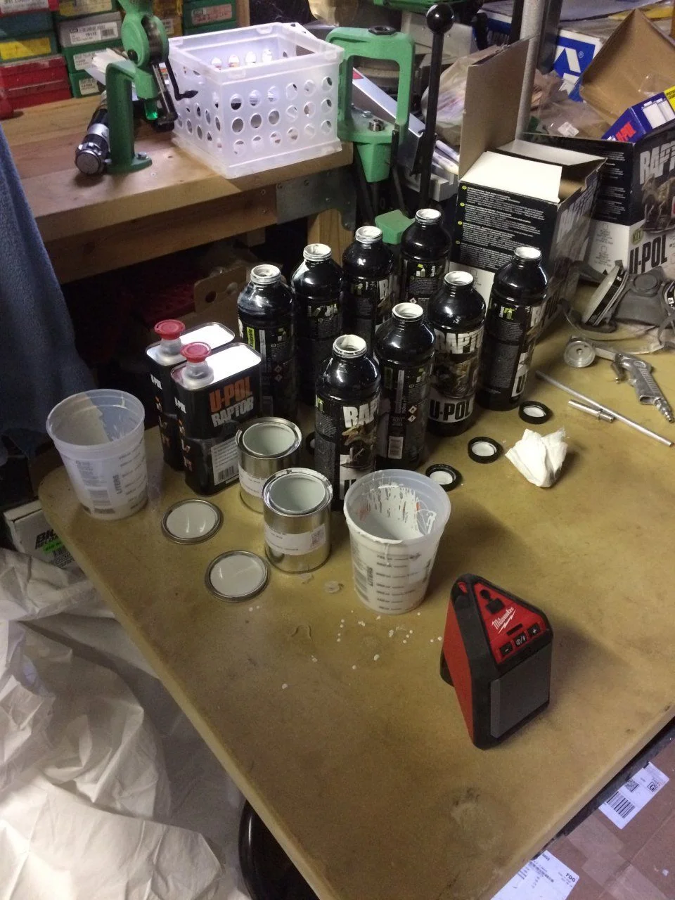

Amateur chemistry class ...
