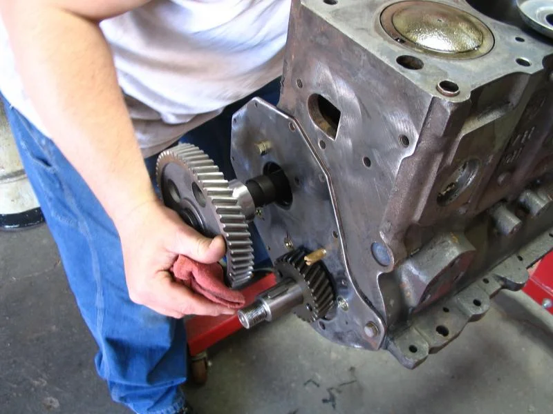

Aaron,
Looking at the pics, the cam gear clip is not clearly visible.
Since the cam was just replaced, did somebody definitely install the retaining ring?
Looking good now...
Aaron,
Looking good now...
Jim what does it look like?
Aaron,
It was on there when the cam was installed into the engine...
