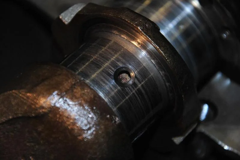

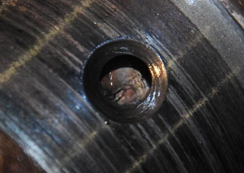

So in these two previous pictures we see the bearing debris that is blocking the oil passage in the crankshaft from the #4 main bearing journal to the #6 throw:
attachment.php
attachment.php
