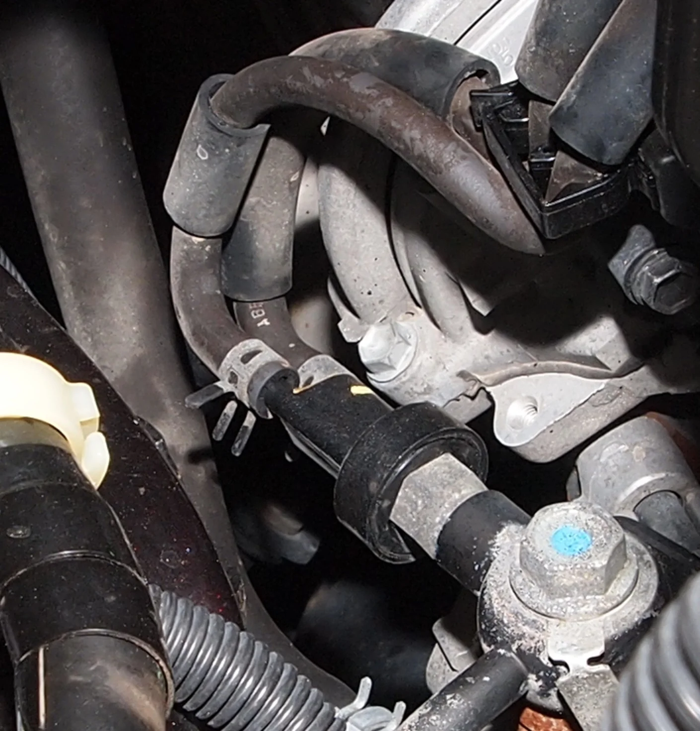

If your saying oil in air pipe, which is what connects air filter box to throttle body. Your idle up control valve may be leaking. This is a valve thread onto vane pump (power steering pump). It has two vacuum lines connected to it. One vacuum line from it, connects to air pipe. The other in 98-05, connects a EVAP pipe on top center area rear of intake manifold, in 06-07 it connect just behind throttle body. You'd likely find power steering reservoir low and oil dripping from vacuum line(s).
About the only other place oil could get suck in to air pipe. Is from RH PCV vacuum hose. But I've yet to see that one suck oil from head cover.
Ditto in what @2001LC said. I had this happen to me and until I figured out what was happening it was a mystery why my power steering oil was vanishing every other day.
Very likely cause is the ICV - idle control valve. Right now to your right side valve cover, under the air box. Hope this helps.

@awesomeissquid Look at the ICV first its a $60 part from dorman when I swapped it. I was getting all of the symptoms you were getting. Although I did not have oil in my 8th cly. But i didnt even check for that symptom. However I was getting the lots of white/blue smoke during start up and also had oil in the airbox. Also this happend on my 1st gen Tundra with same 4.7l engine. This issue looks like a blown head gasket. And for the longest time it sure looked it until I stumbled upon the IVC valve being the cause.
Not sure if you drove it a lot but I drove mine from Jax to Atl a 500 mile journey and for sure had power steering oil by the time I came to Atlanta. I noticed that the PS oil was needing to be refilled every 2-3 days. But this leak can be different in your car.. but check out the IVC and see. I am 85% positive it is the cause.

Btw are you getting smoke like my videos from the tail pipe? And have power steering fluid in your air box and intake? Those are basic signs of a IVC issue. AND pull the vaccum lines from the IVC and see if both of those are wet with PS fluid. This is likely the most tell tail sign that the IVC is bad. Here's a video that does into more detail
In terms if installation. It's a very easy swap out. Probably a few on YouTube showing you how it's done.
PS. Look like you can do a quick verification
Since this is not an electrical component you really cannot check it. As you said it's a replace and verify type of part.
PS. Look like you can do a quick verification this thing is called multiple names. Power steering Idle Air control valve is one of these names.
