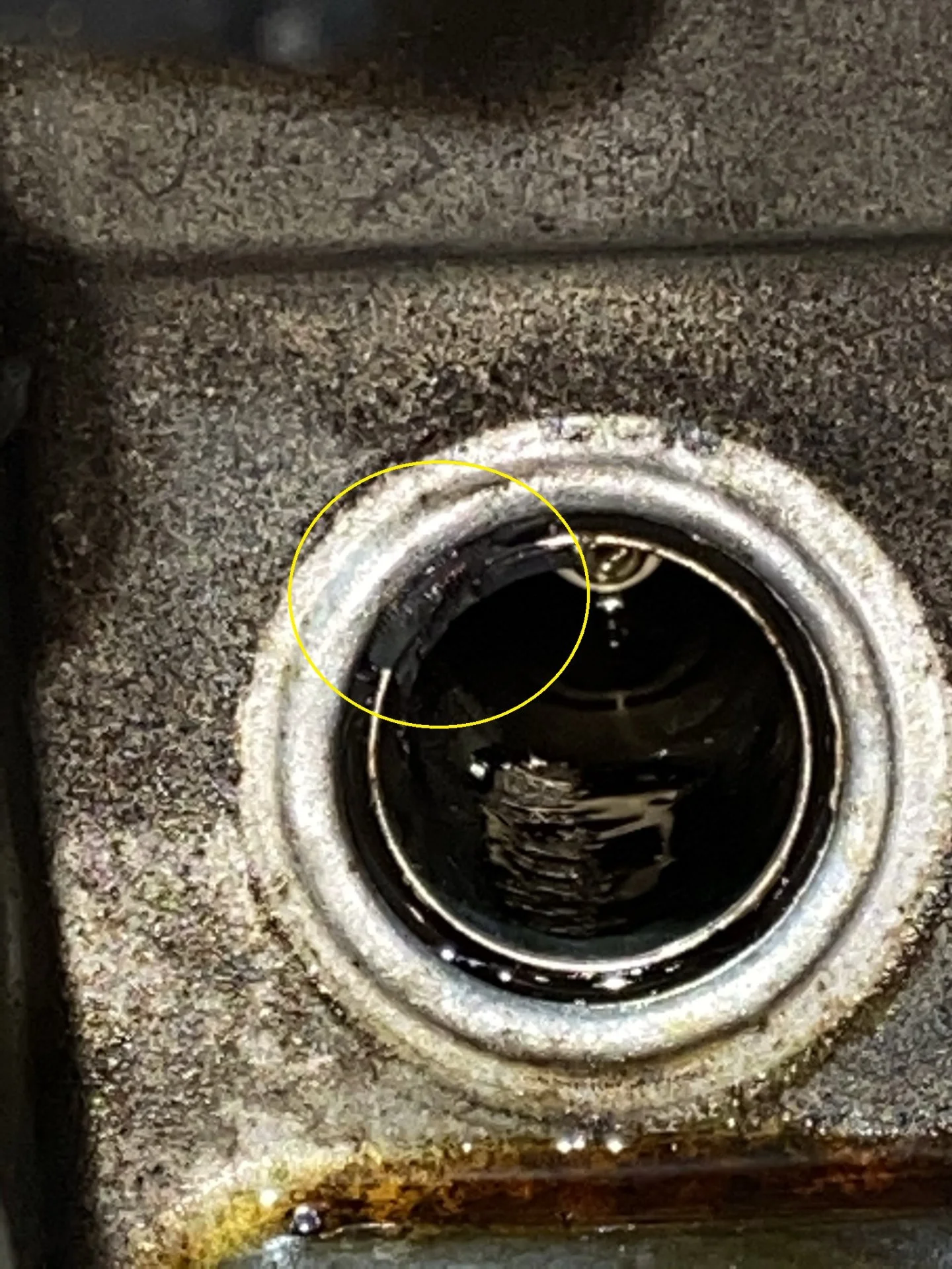

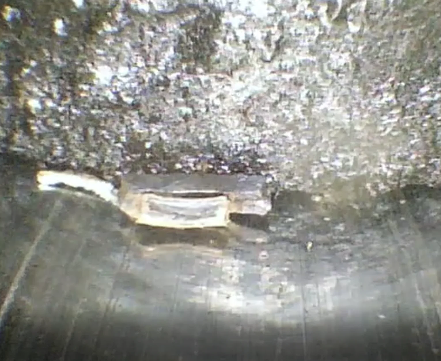

I actually did scope the cylinder in question back in 2020 when I bought the truck and replaced the spark plugs. I found broken timesert threads in the cylinder with impacts visible on the piston head and scoring on the cylinder wall: Thread - Tapered Seat Spark Plug Horror

Here is a view of the threads I found on top of the piston.
Image from original engine with assumed blown piston in cylinder #8

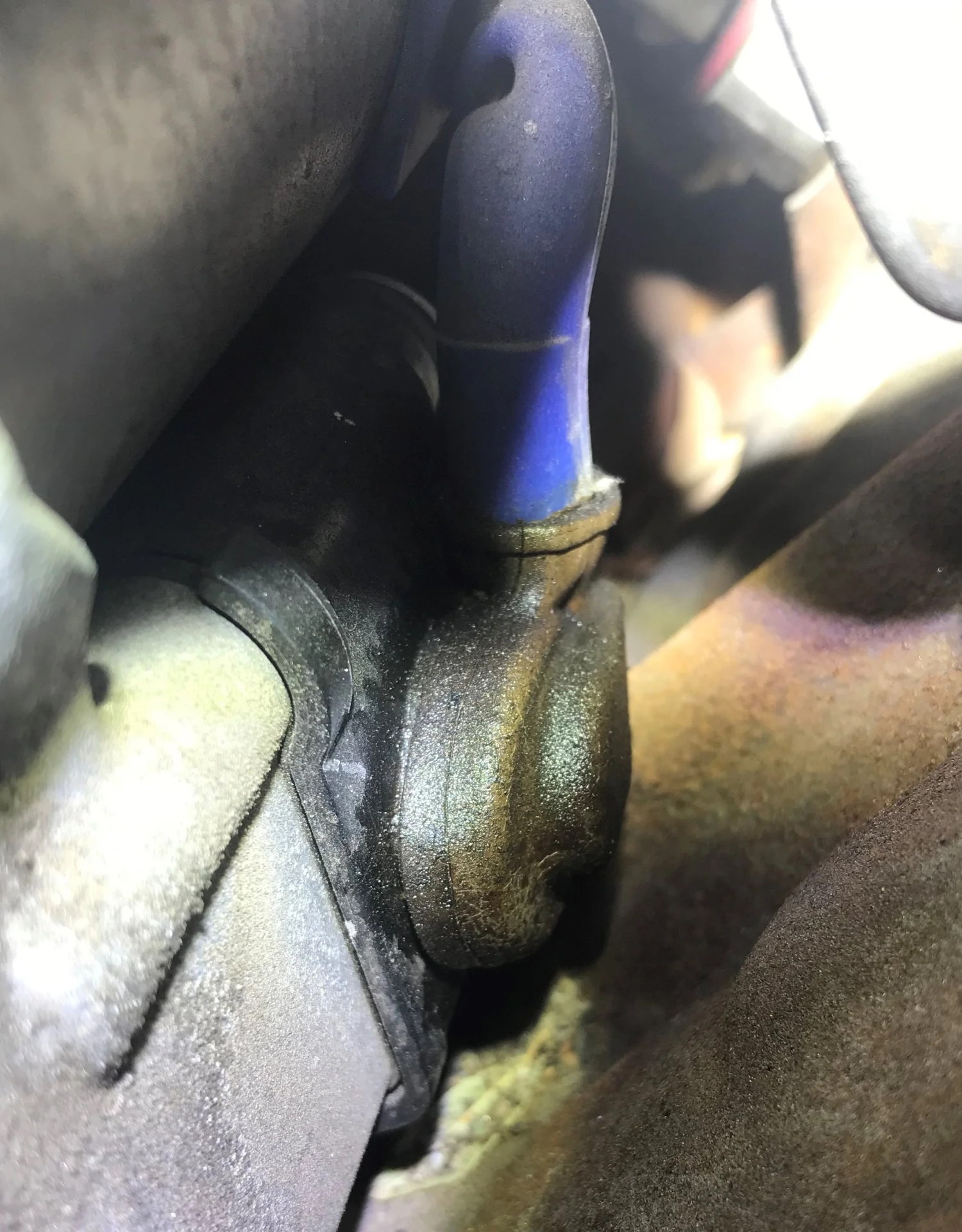

Here's the Tube seal caught on spark plug tube I mentioned above. Seal is sliced and pushed out above tube. Can't see well, but color is blue, OEM ore not blue.

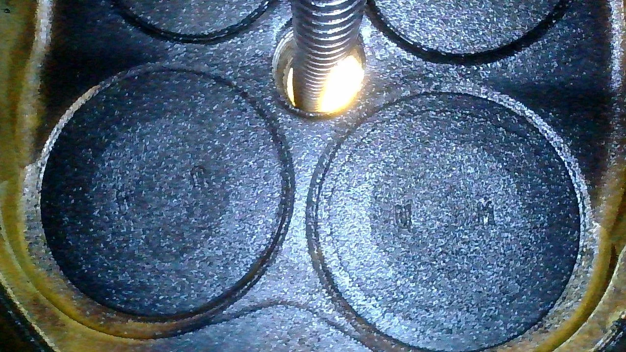

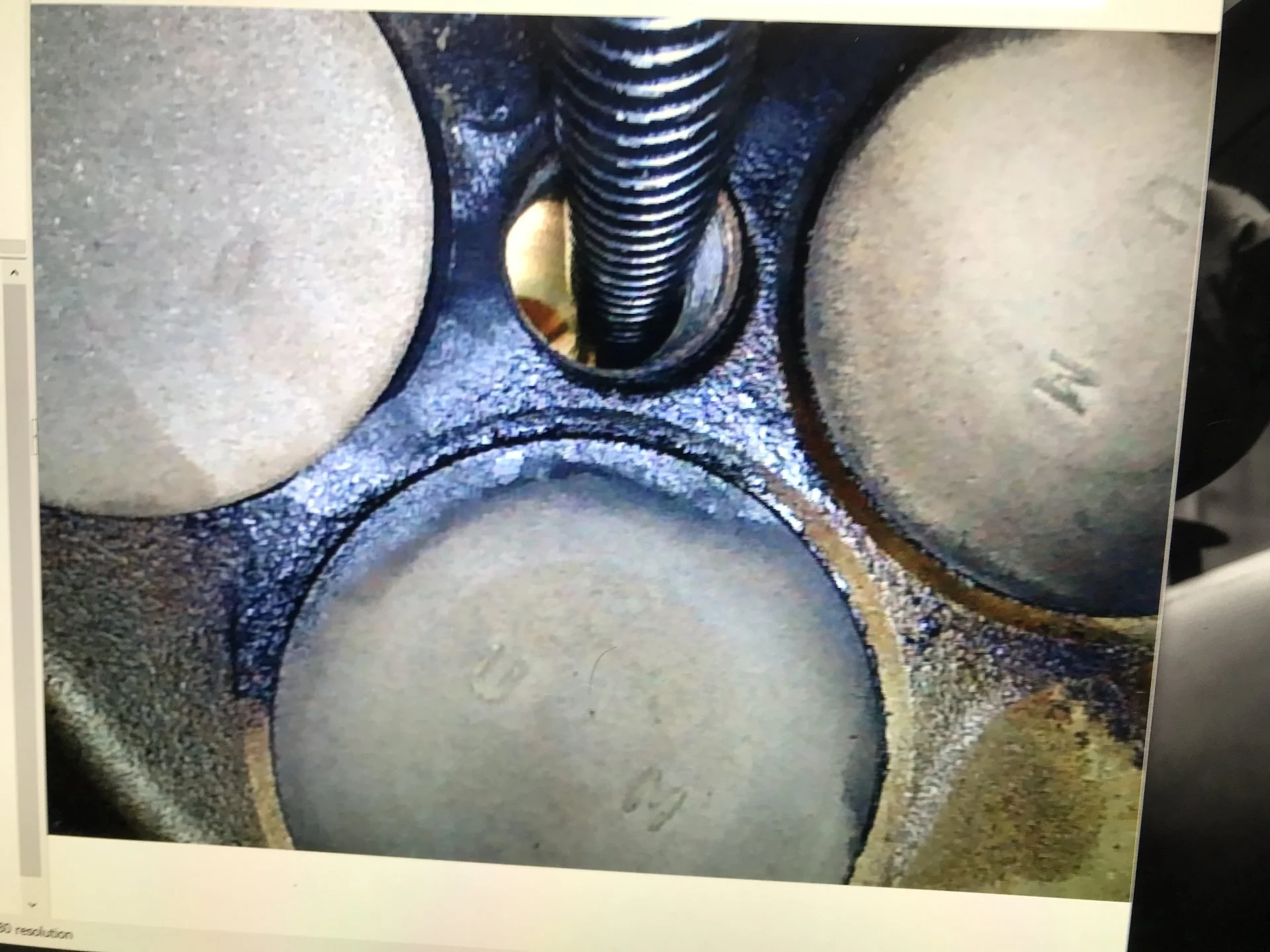

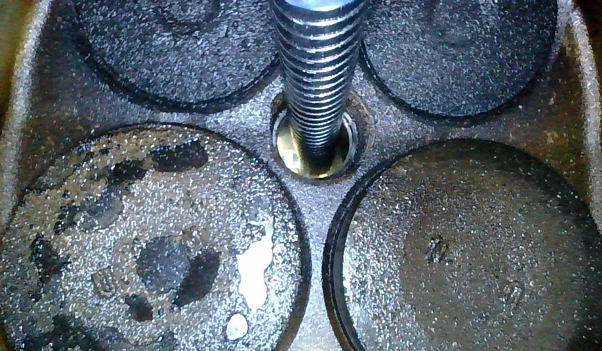

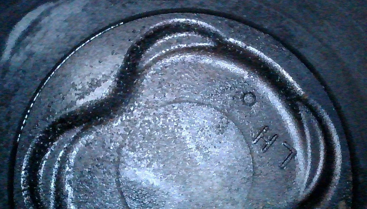

Scoping the new engine. Seeing a bunch of carbon build up. One or two minor scratch makes on two cylinders but can still see the crosshatch. Thoughts? Photos from cylinder 5
Images of replacement engine pre-purchase.
Those are two of the worse ones. The rest have some carbon but not seeing any scoring. All cylinders seem to have very good crosshatching visible.
Realizing I can’t really do a compression test by hand. Got two cylinders to 90psi but couldn’t get it any higher. On the third I got it to 60psi. Lost track of counts and didn’t have the energy to keep trying. Going to find out more info about the warranty and thinking about taking it back home to connect it to a battery to compression test that way.
Looks good! Not perfect but good. May look even better after you run the engine a few 100 miles.
BTW: What scope are you using? Looks better than my for sure!

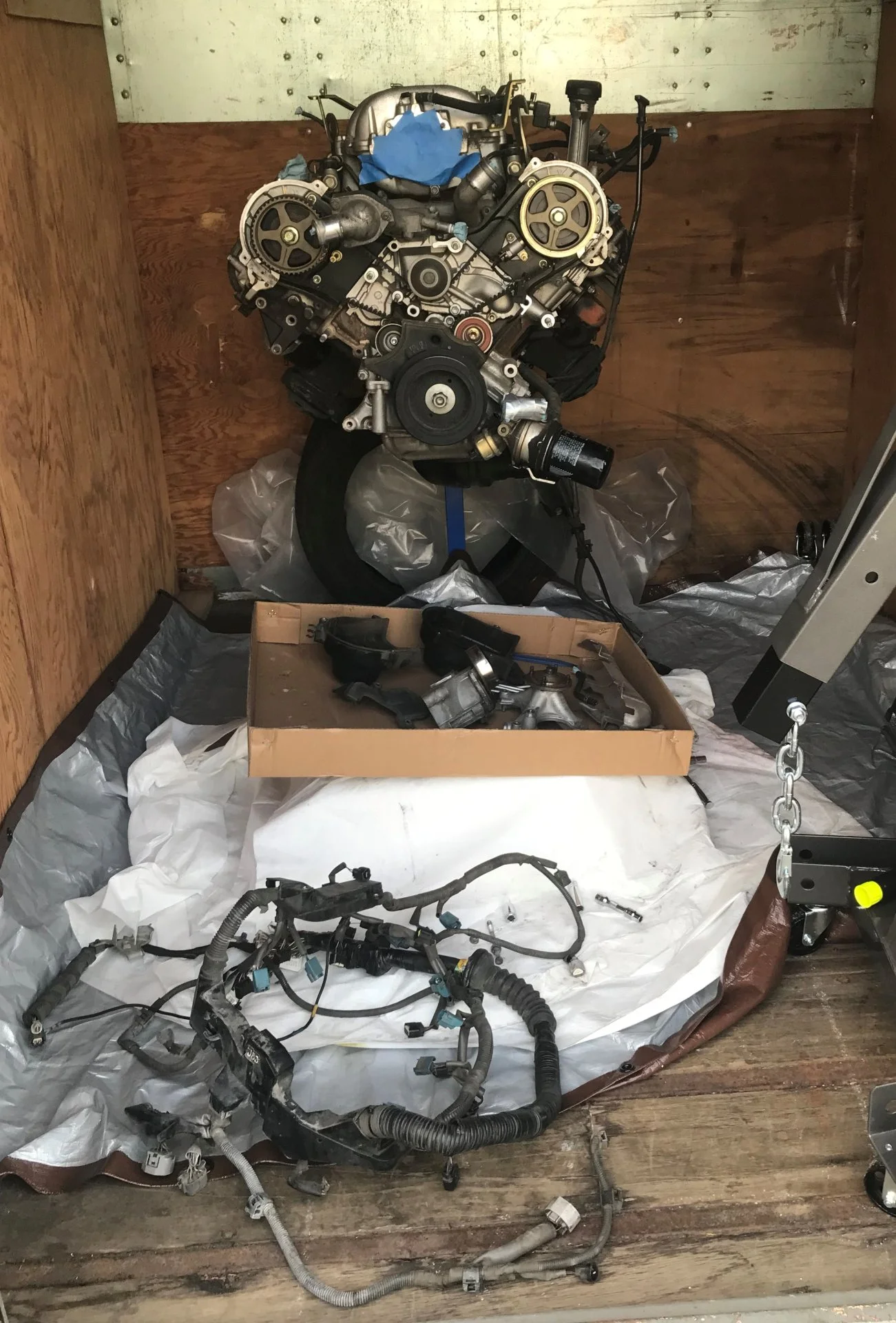

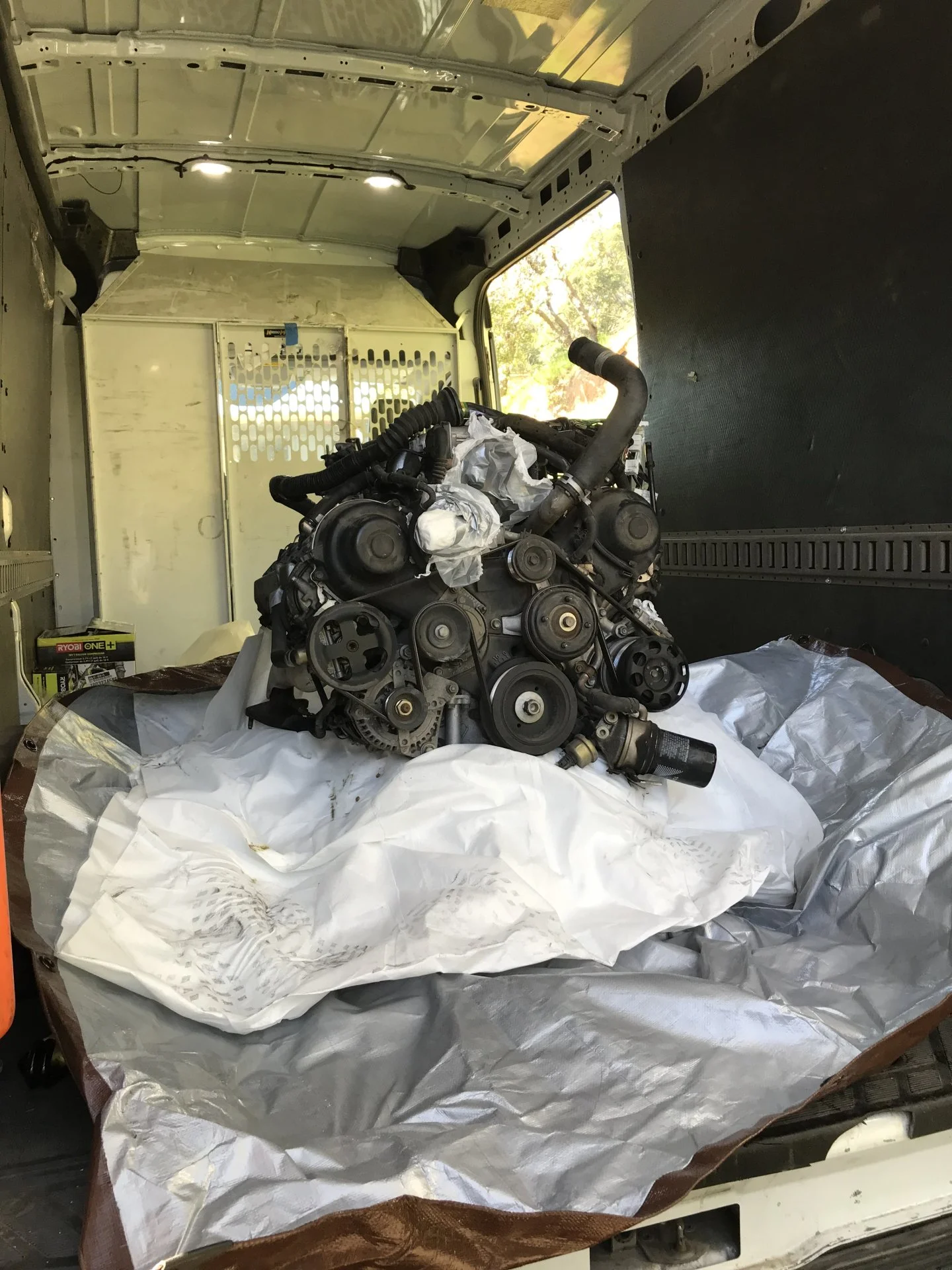

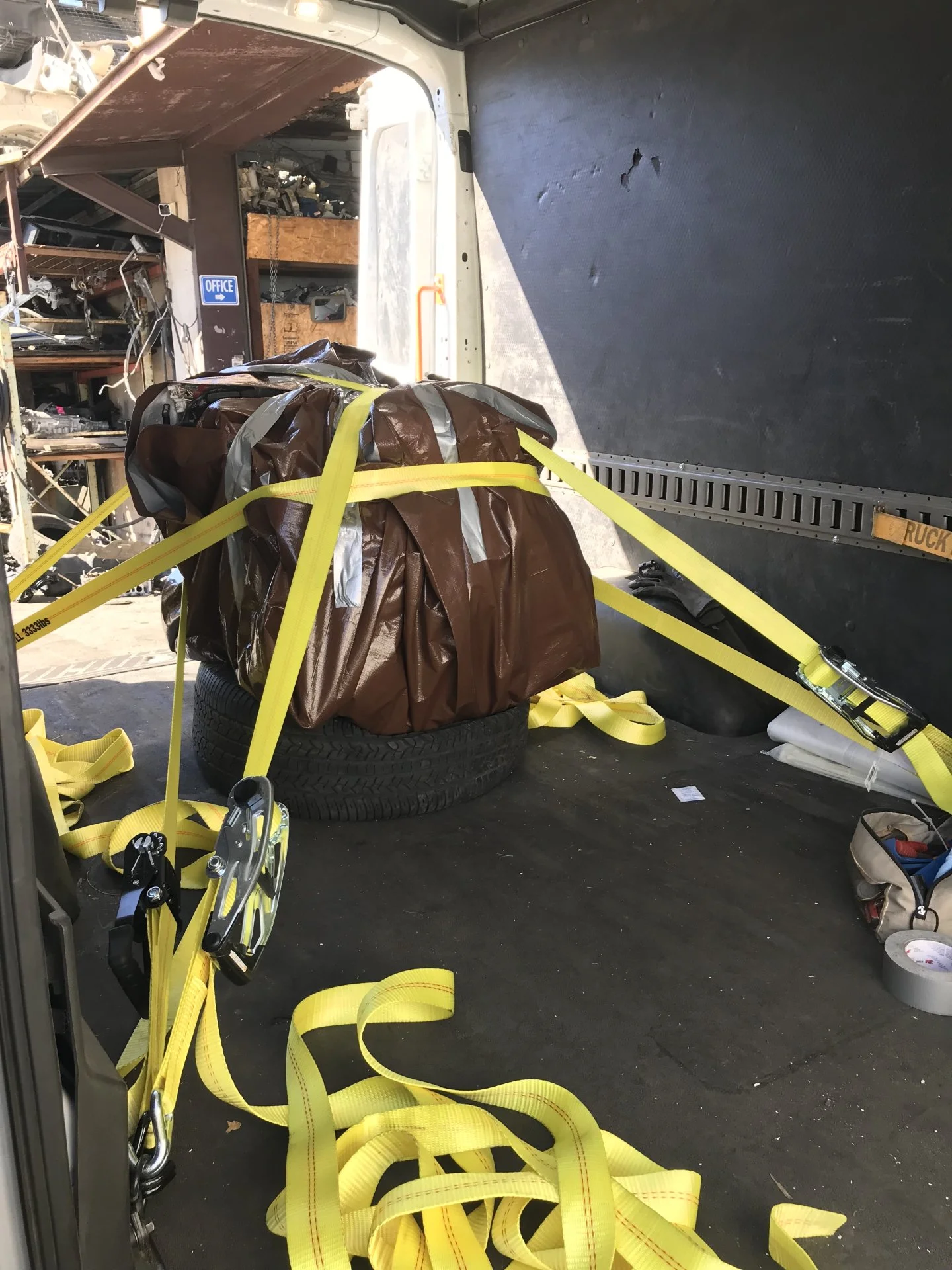

Well went for it! All wrapped up and packaged.
Got the engine with all accessories for $2k. My dad and uncle are pushing for me to pull the heads off to remove as much of the carbon buildup as possible and to get a better look at the piston heads so we can see if any of those or the rings need to be switched. Going to ponder that over the weekend. Now the fun begins with figuring out what to replace and what to swap over. Fun times for sure.

Ended up getting back way later than I thought I would last night so today was spent setting up. Picked up an engine stand and engine hoist. Then just as I was getting ready to unload the engine I realized I needed bolts for the bell housing. They are M12 with a 1.25 thread pitch if anyone needs it. After picking those up it was too late for any other work so more to come tomorrow.
Picture of the nice present all unwrapped.

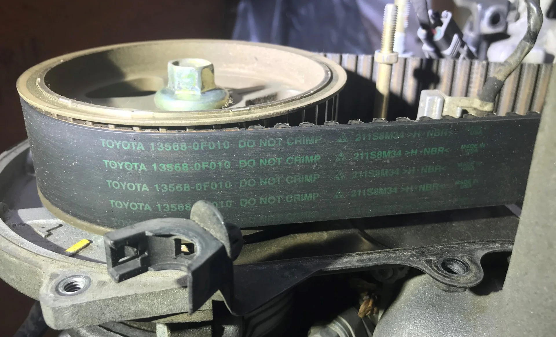

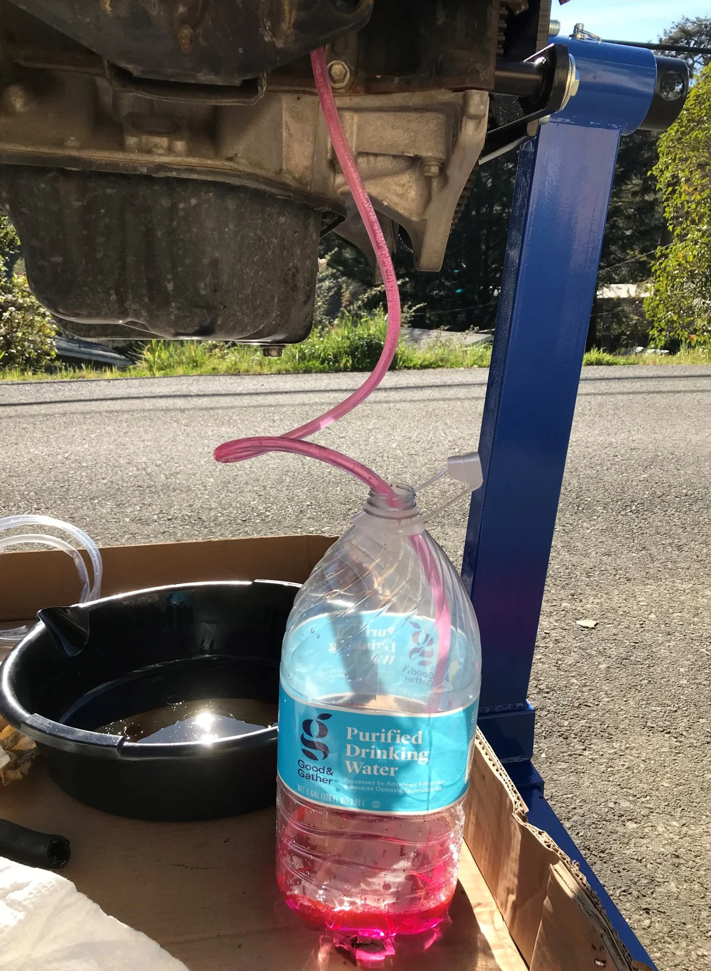

Spent some time with the replacement engine tearing it down and inspecting it some more over the past week. Drained the block of any remaining oil and coolant. Oil looked like oil and the coolant looked like a fresh pink color which makes sense since it was shown as replaced at the dealer 2yrs/26k miles ago.
Here it sits minus the wiring harness, some of the timing belt covers, and some other stuff. Planning to sell the wiring harness, throttle body and any other unnecessary parts after this is over. Timing belt is a Toyota branded one.

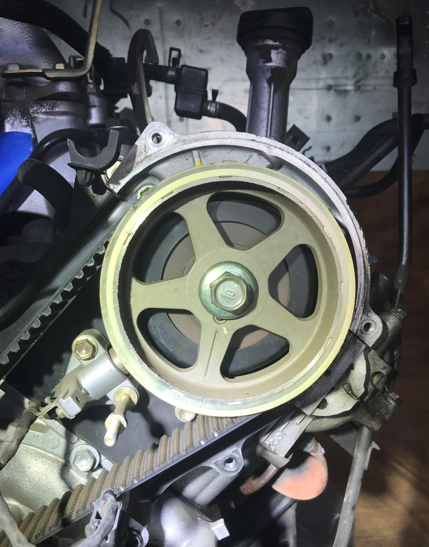

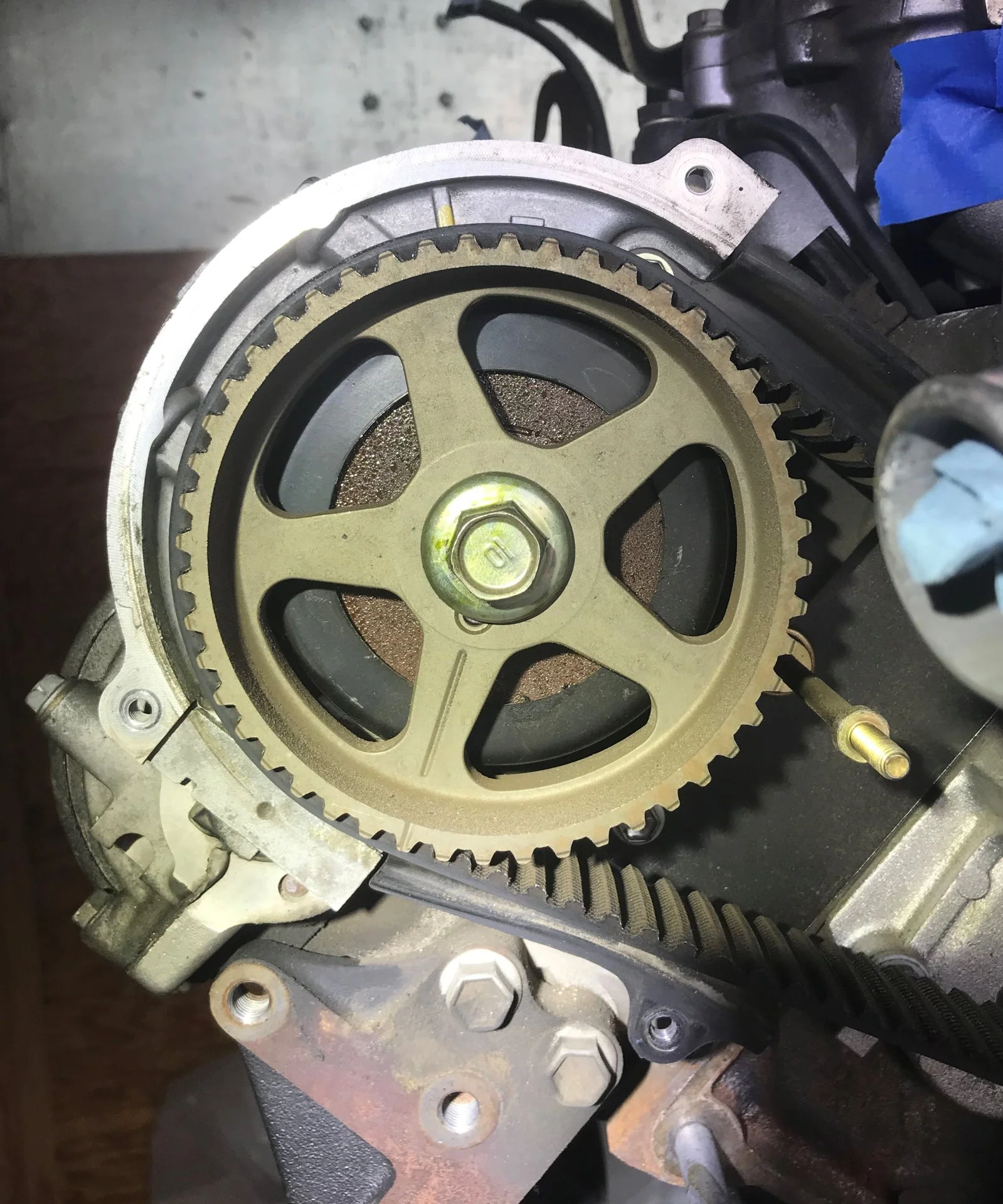

Found the RH cam seal leaking a bit, but the LH side looked pretty good. Will take care of that one when I pull the heads.

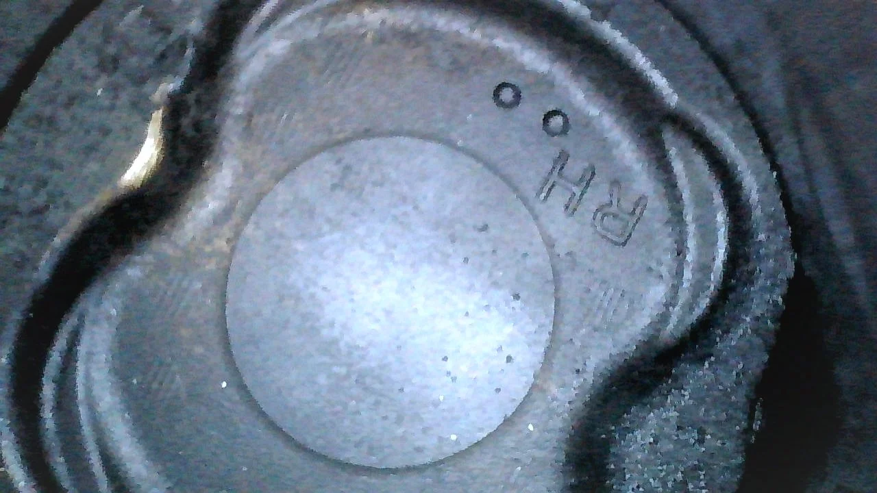

Made some progress on testing the current engine that is in the truck and oh boy is everyone in for something special.

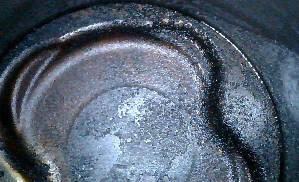

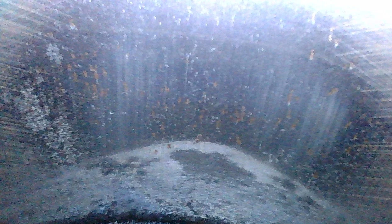

Started by pulling all the coils/spark plugs and removing the drive belt. Then went to town with the borescope to document the condition of each cylinder, piston, and the associated valves. Here is the view of the cylinder 1 and 5 piston heads and the cylinder 5 valves. All the others (besides cylinder 8...hint hint) looked pretty similar.
Images from original engine with assumed blown piston in cylinder #8.
Cylinder 1 Piston Head
Cylinder 5 Piston Head
Cylinder 5 Valves
Everything was really caked in oil which makes sense given it consumed like 5 quarts over the ~150ish miles as I tried to limp home. As a bonus, cylinder 5 had some intense polish marks 180 degrees opposite each other. I'm assuming this was from the engine running low on oil at one point causing extra wear. If anyone wants to chime in if this is right or another cause I would love to learn more.

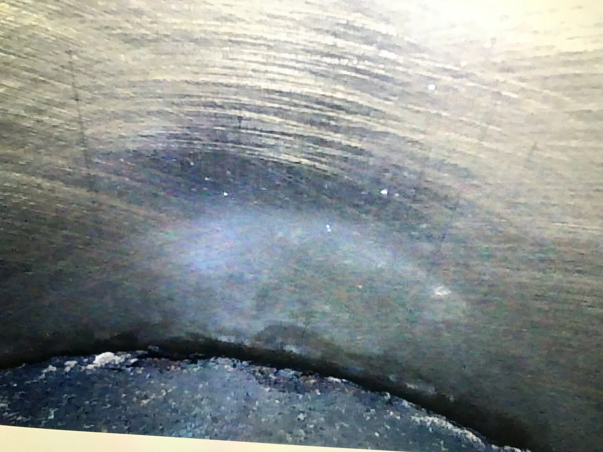

Cylinder 5 Polish Mark 1
Cylinder 5 Polish Mark 2

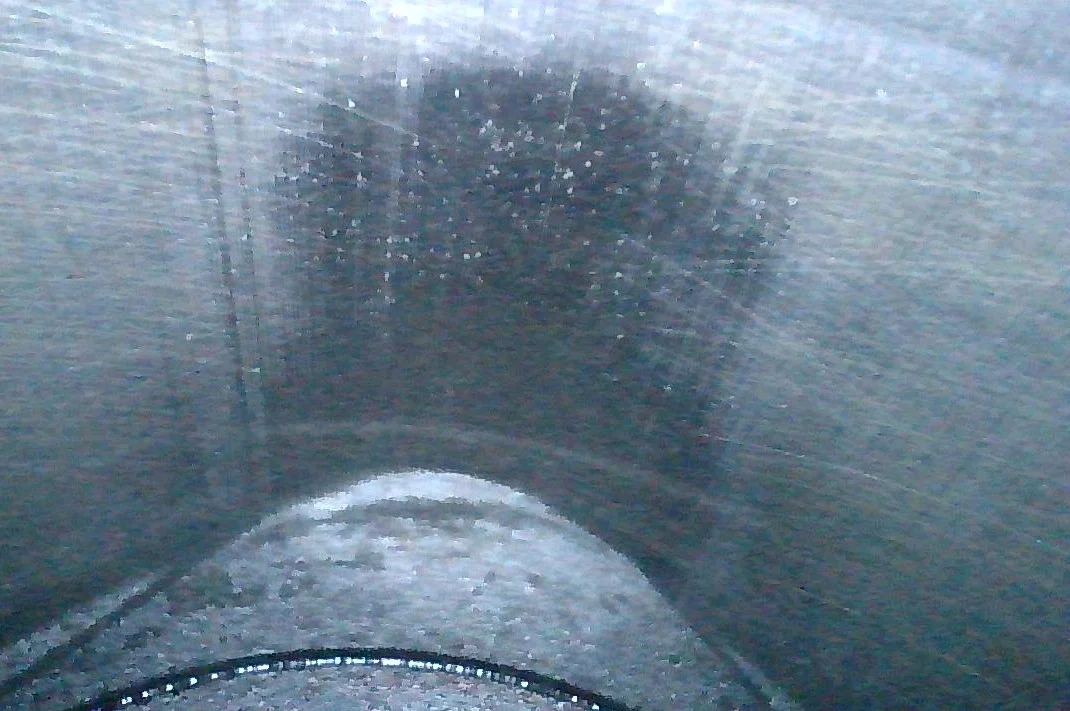

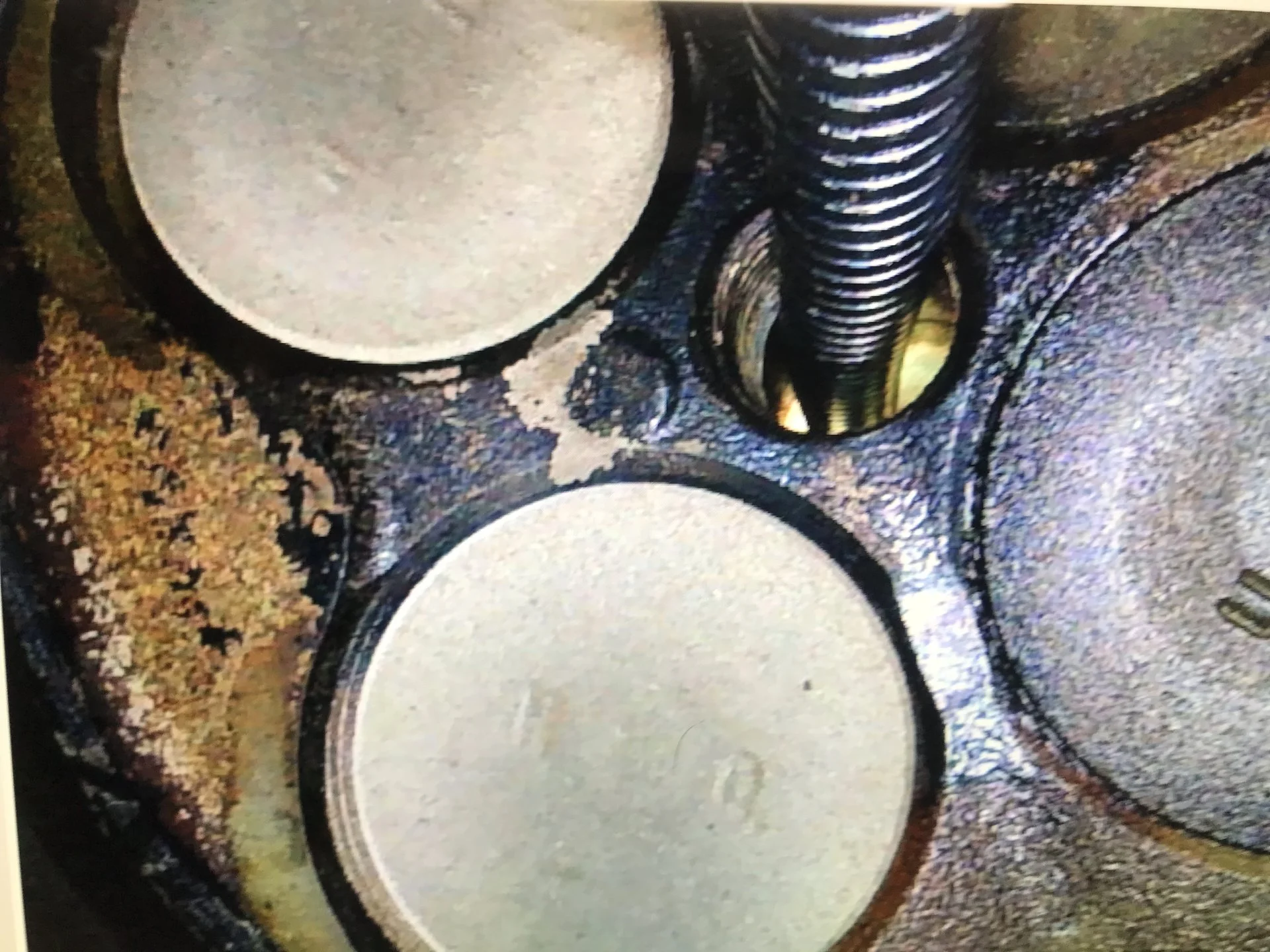

Now for the real treat, cylinder 8, where some real messed up stuff turned up. At first look, the piston appeared cleaner than the others, so at this point I'm assuming the head gasket leaked some coolant into the cylinder and steam cleaned it just a bit, maybe? The valves also looked different from the rest so idk :rolleyes:.
Cylinder 8 Piston Head
Cylinder 8 Valves

Moving on to the leak down test for cylinder 8 I set the cylinder to TDC and pulled the radiator/oil filler caps and pressurized everything to 90 PSI. Surprisingly no bubbles in the radiator neck, but I did hear a ton of noise coming from somewhere. Opening the throttle body valve and noise could be heard there, so maybe a stuck intake valve. But, I still was hearing a ton of noise near the cylinder itself. Feeling around in the area, I believe I found air leaking past the fuel injectors. Pretty sure this makes sense since the fuel injector is inline with the intake valve. At this point there really isn't anything else I can do so I pack up.

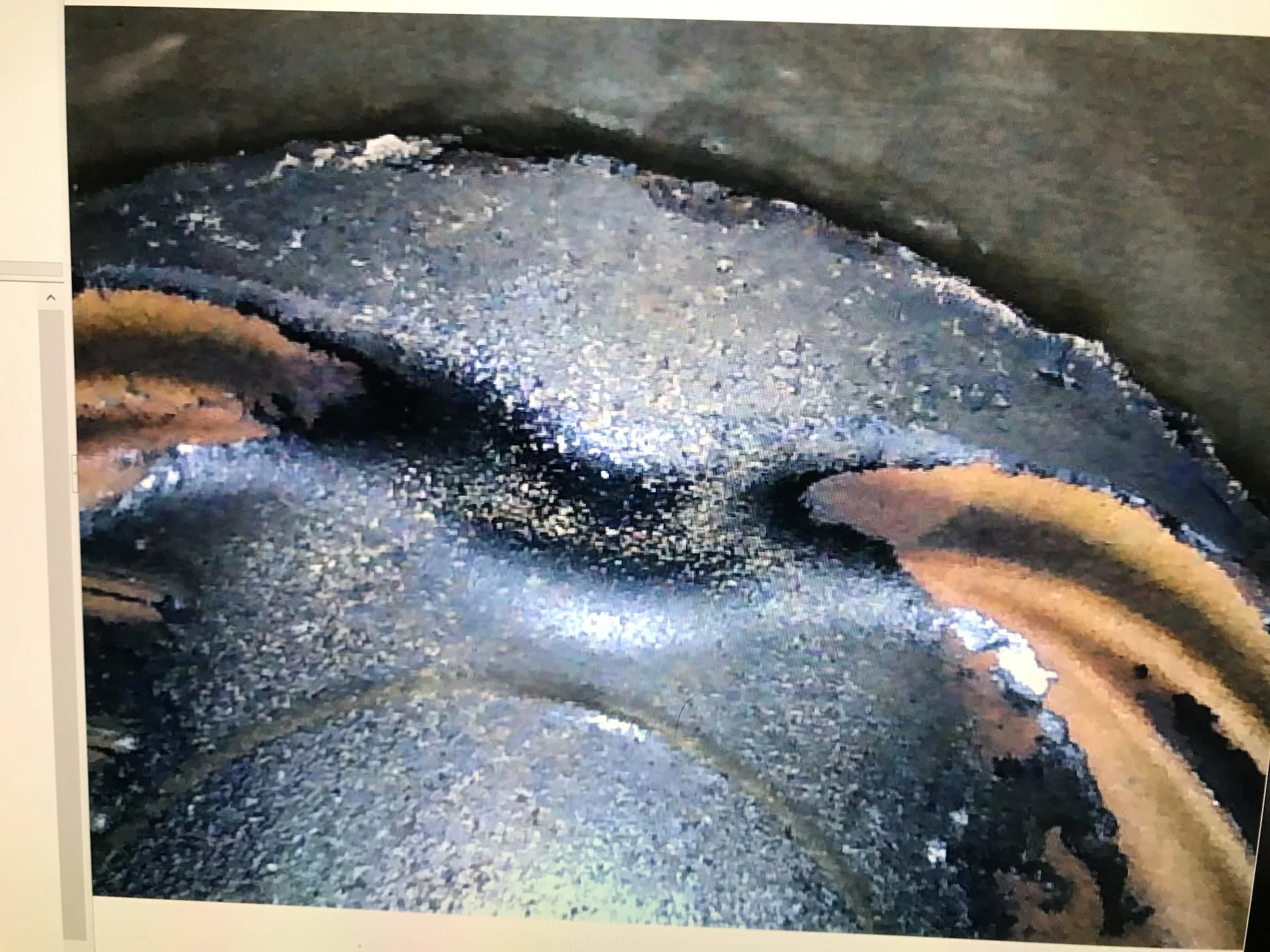

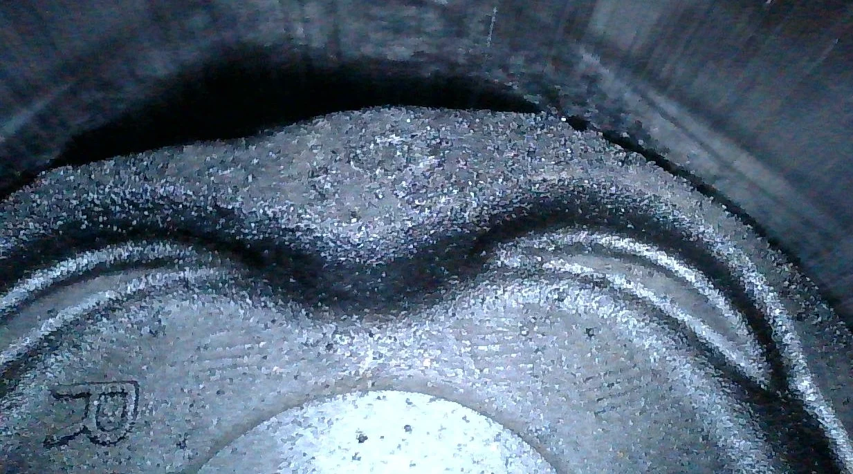

Reviewing the pictures at the end of the day, something just seemed off on cylinder 8... Did you notice anything? Lets try another view:
Cylinder 8 Piston Head Closeup
Well that large black space shouldn't be there! Seems some of my piston head has disappeared.

I did check the oil filler cap tube and did not hear anything escaping from there. I agree that with the chunk missing I would expect to hear some serious air leakage from that. My running assumption for now is that with the intake valve being open and the spark plug tube seals being leaky, all the air is escaping through those two avenues before it makes it to the oil fill cap tube.
If valve burnt (can't see whole valve in above picture), should see with your great articulating camera easily. You may need to be on intake/exhaust stroke, to have their valves open, if minor newer leak of valve or it's seat.
One very difficult part of leak down test. Is setting target cylinder to TDC compression stroke. I do by feel, keeping air pressure lower as I turn crank. Around 30 PSI I can just barley turn crank with 1/2 ratchet, as I come up on TDC compression stroke of a good cylinder. If I stop a little to much before TDC (BTDC) of target cylinder, and kick up pressure to 90 PSI. Crank may turn CCW, as piston pushed back down from pressure. Pasted TDC, crank may turn CW. Hit that just right spot and crank holds as air pressure increased. If I can turn 720 degrees, at 90 PSI with no back pressure on ratchet, I've a bad cylinder. One can turn crank 720 degrees, while just listening at oil fill tube, in that event. I always hear some air sound at oil fill tube, when valves closed even good cylinder in a cold engine. When rings not sealing as they should, a bad cylinder at TDC Compression, I hear much more air sound than I do from the good cylinders.
By looks of piston and cylinder wall of #8. I would have "bet" you'd hear from oil fill tube.
