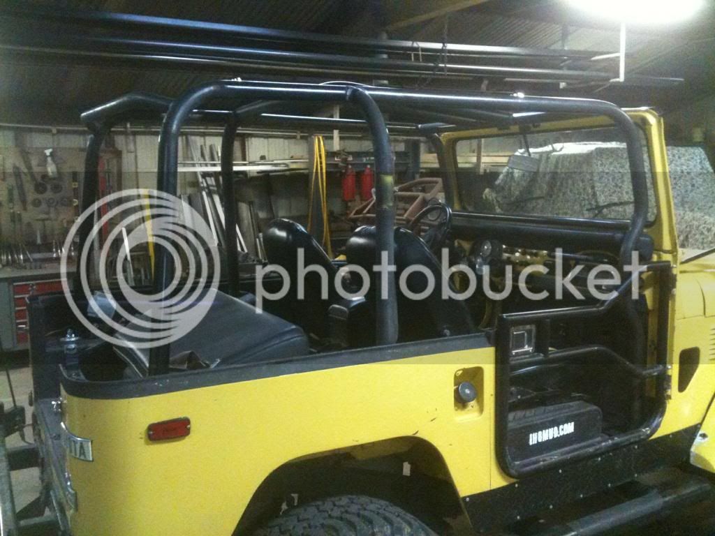

Finally got the 40 to the welder this afternoon. He sent me this pic about 2 hours later.....
Takes him a while to get you in there (he is super busy) but when he gets you in, he doesn't play around. It's just tacked up in the front right now. He was a bit concerned about the bends in the original hoop behind the driver / passenger seats and the hoop I picked up from Larry. They did not match and JD is a perfectionist (maybe that's why it takes soooooo long to get in his shop) so he said he is going to "fix it". I can't wait to see what he comes up with. He is also re-designing my rear bumper with a swing-out and integrated hitch along with some other work. :D
Well, JD, my master welding guru, didn't like the way it looked in the previous picture due to the different radius bends in the two hoops.
In this old picture of Eric's rig, you can see what the two hoops looked like together. I wound up with the rear-most hoop from Eric (thanks Eric :cheers: ).
So, this is what JD came up with.....
It's a little different but I like it. I am going to see it in person tomorrow morning and we will work out the final details.
Yes he does. He builds custom cages for lots of folks. I haven't gotten to talk to him, just traded some text messages but I do believe he fabbed that bar and cut the hoop I brought him in half to make the two rear pieces.
I like the improvement though I question when the rear seat is up will the occupants be outside of the cage because it tilts forward? Most of the family cages seem to go back a little farther towards the back corners. Maybe its just the pic but check it out when you get there. I like the kickout he added in the back wish he was closer I'd send him some work not that he needs it :)
I had the same concern about the rear passengers. That pic plays tricks on you. I can tell you that it is a great fit and I like the fact that it is custom. He builds cages for all manner of 4X4 so he knows how to make it happen. I was stoked when I left his house this morning. :clap:
