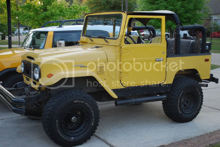

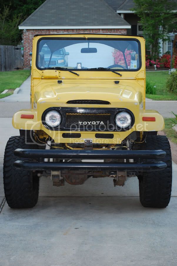

How she sits today 4/18/13:
Her name is Hachi. This is how she looked the day I got her from Brian.

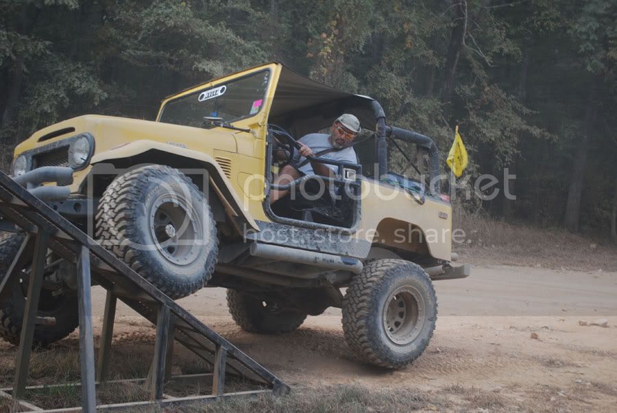

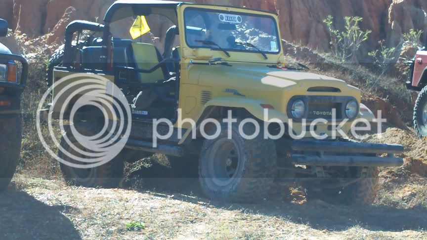

First ride I took her on was at The Devil's Backbone in Crossroads, Ms. Damn, those springs are tight!! That was a rough ride.

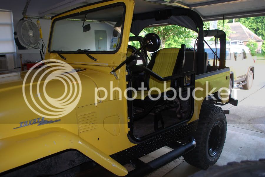

But, as I had told Brian when I bought her, I planned to take her to the next level. So, since this is really going to be a trail-only rig and ride-around-town-on-sunny-days rig, there was no need for the hard doors. I was able to find a set of RedLine tube doors from another MUD member who had them sitting around in his garage. I sanded, primed and painted them satin black. Now I am getting to more of the look I want.

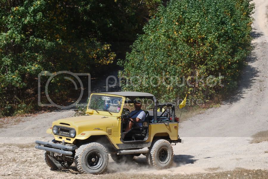

Next up, I had to test things out again and what better place to do that than Superlift for the SCC '10.
Had lots of fun there but just to be sure, I had to test things out again at Sicily Island.....

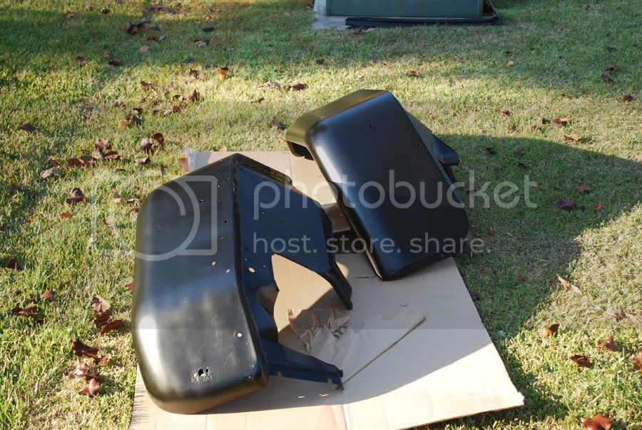

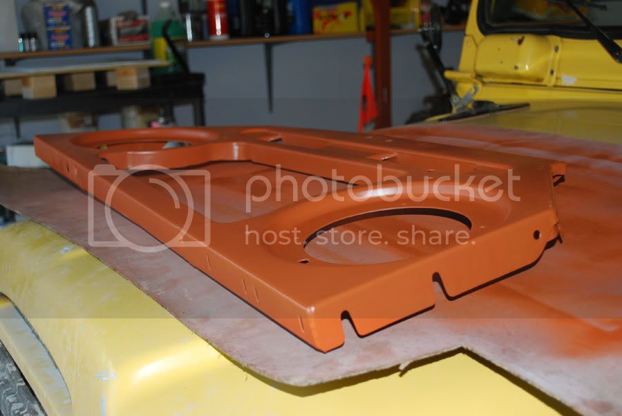

Which brings me to this weekend.....I actually started the process of getting rid of the fiberglass front end and replacing it with sheet metal parts a few weeks ago. I took the parts that came with the rig to Deryl's shop and bead blasted what I could. The rest, I took a palm sander and an air angle die grinder to for prep for paint. Once everything was sanded, I cleaned them up and primed them. Today, I started painting. I got the new parts all painted with one coat. I am going to wet sand and apply a second coat of paint........oh, and I am going to have to paint the rest of the rig to match.........here are some teasers........
The hood is the same color as the bib. The lighting was not that good as the sun was going down when I took this.
Yes, the bib is tweaked......it will be fine once it is all bolted up.
