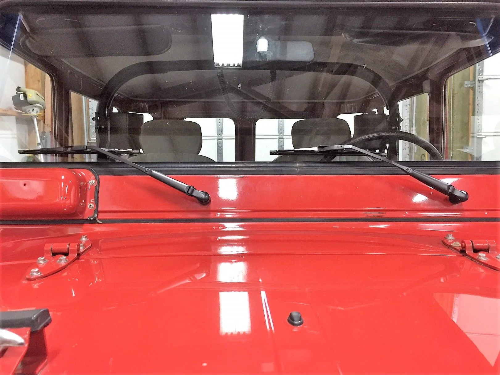

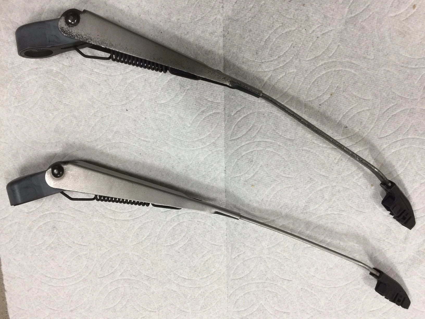

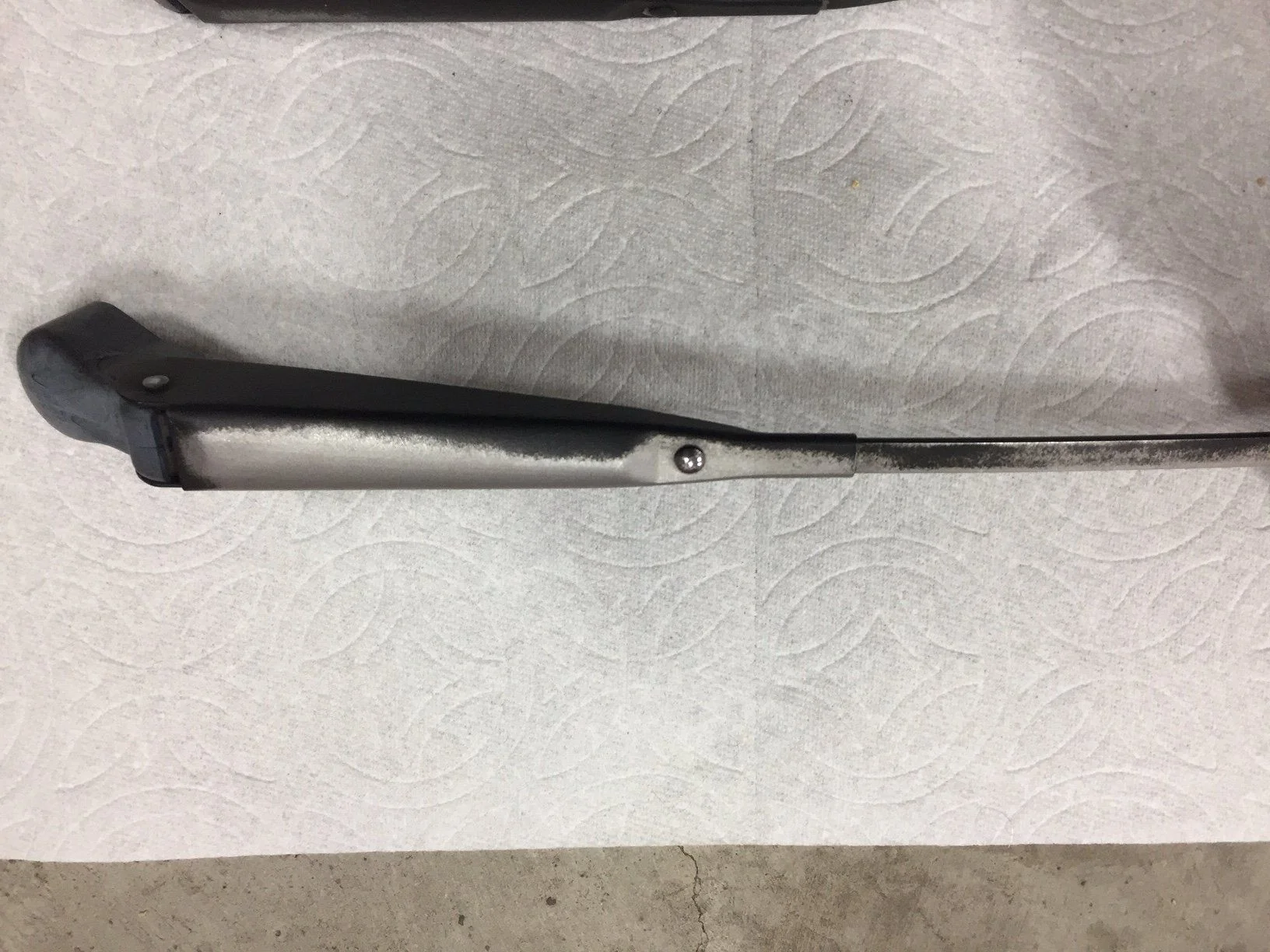

I finally got around to finish painting the windshield wiper arms.
Before:
full
full

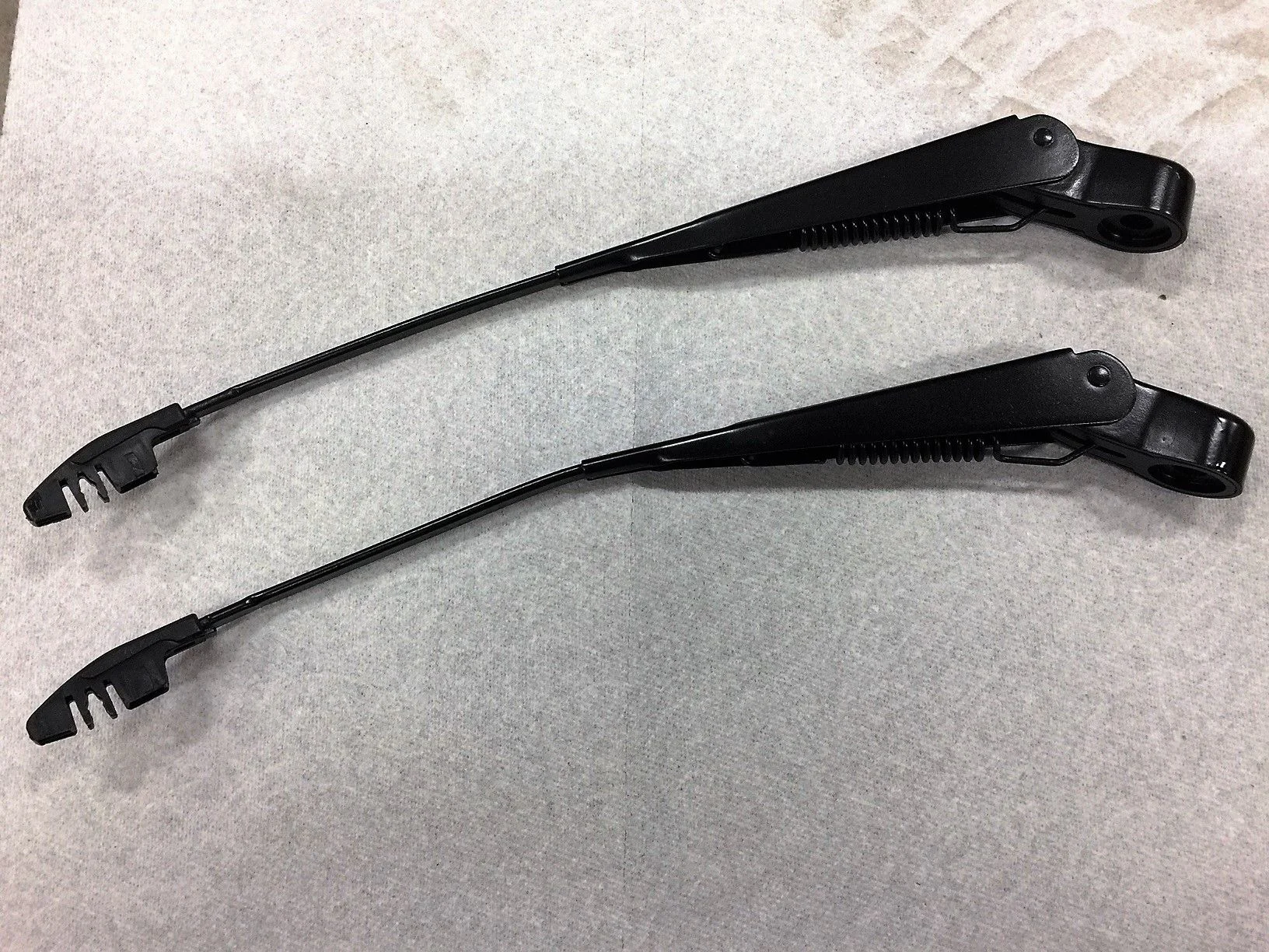

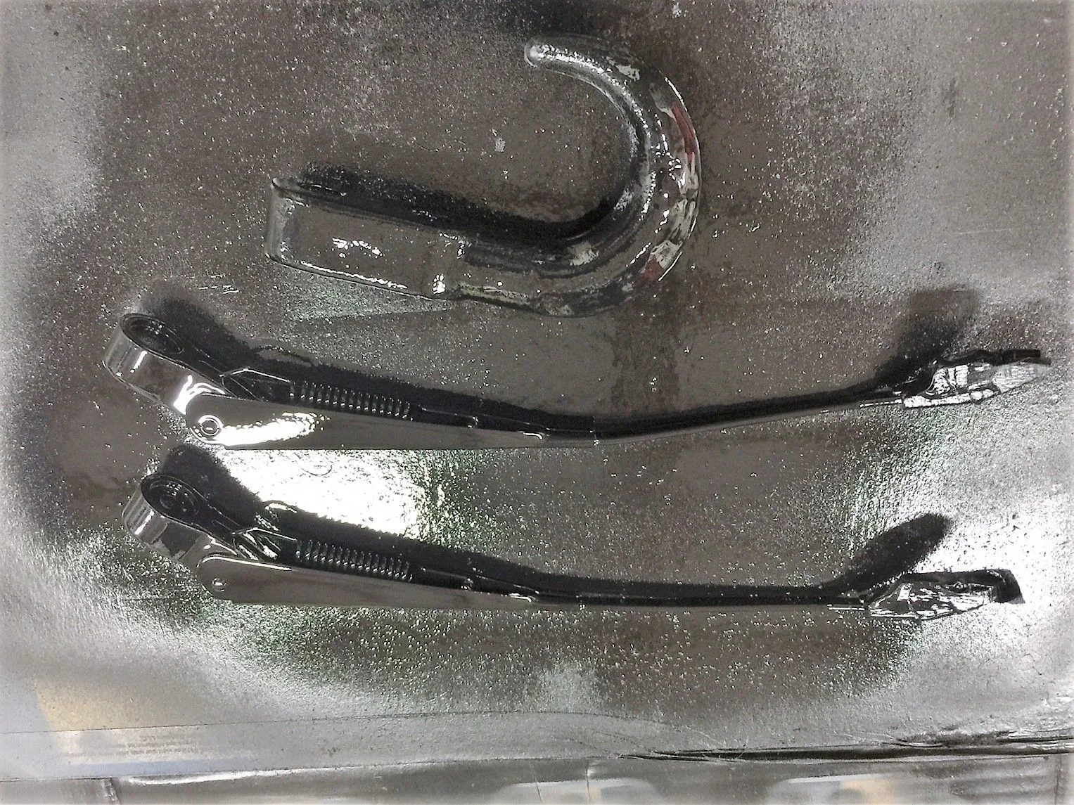

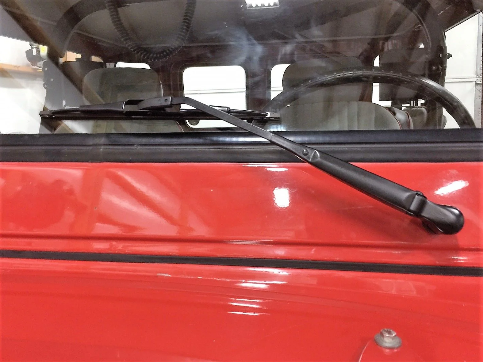

After:
Primed
full
full
full
full
full
full
Nice work Mike-looking great!
