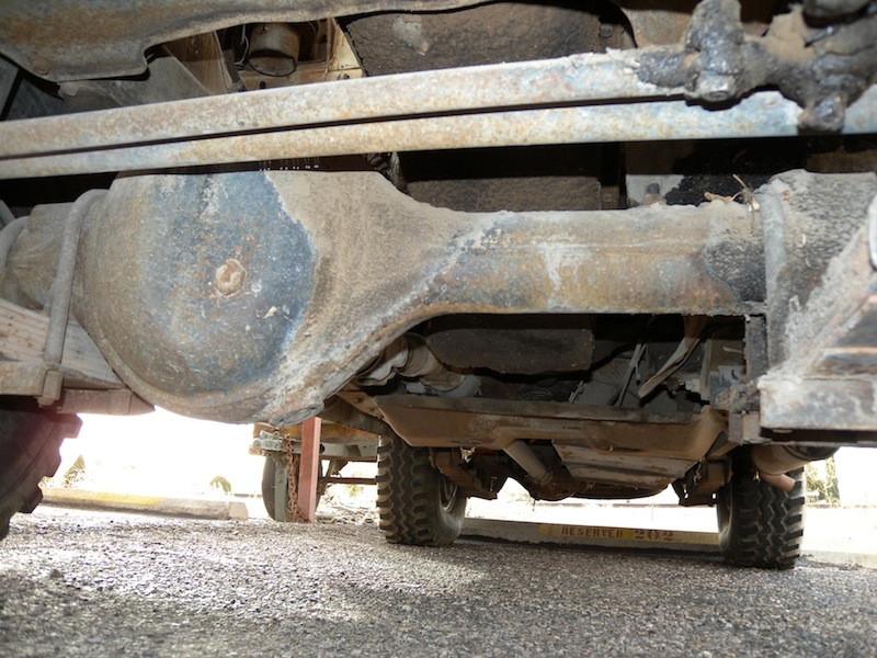

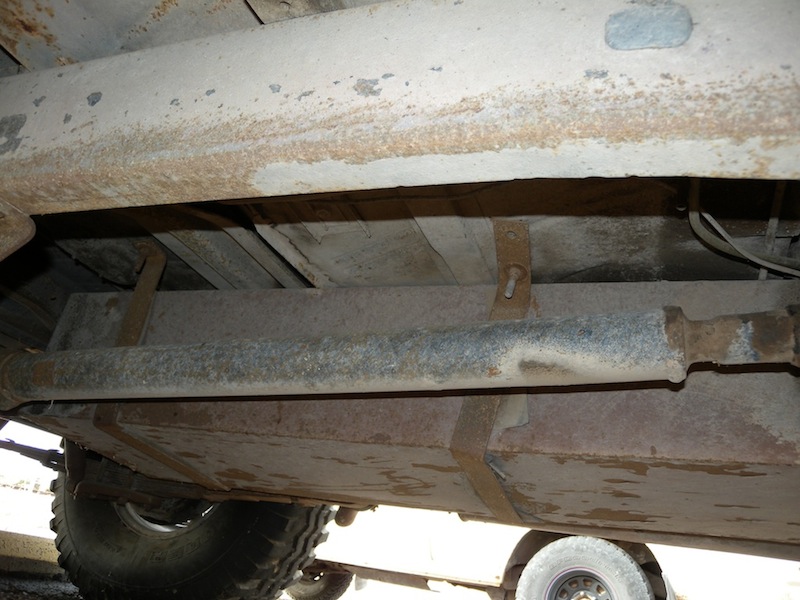

I've wanted a pig for a long time. For a while I've made do with a 60, but nothing is quite a cool as a 55. So I think I found one locally, and while looking it there was a weird box under the truck, next to the read drive shaft. The only think I can think of is it is some kind of secondary gas tank, or a box for smuggling drugs. I just thought I'd post some pice and see what you all think.

great looking pig.........get it; BTW.......looks like a 19 Gal aux tank.......need amy more pix including filler conections; still trying to figure how to get mine to work..........:cheers:

If I get it (the next few days should tell) then I'll take some closer pics of the box to see how it's plumbed. I did see a hose coming out the very front of the box--presumably to the carb. I'm just wondering, would the main tank drain to the aux tank? I didn't see a filler for the aux tank. But if the primary tank drains to aux, that would be very slow to fill up unless the connection was enlarged. I guess I'll fing out if/when I get it.

Geof,
Yes, that is the same tank that I had and I believe Lou has.
Is there a filler tube (2" or so) inside the left front wheel well? This small tube you say you saw is more than likely a vapor tube that would connect to the actual filler neck. There should also be a line coming out of the rear lower corner. That is the sender line. Mine had a switching valve bolted to the inside of the frame rail on the passenger side about mid-ship. this valve had two "ins", 1 for the main tank, 1 for the aux, and an "out to the carb. Simple switch on the dash to control
Starting to make sense, Lou?

On my first examination, I didn't see any secondary fillers, which is why I assumed one drained to the other. With any luck I should own it by the weekend and will be able to look more closely.
The truck hasn't been run since 2004, but presumably is did run with the tank in place...

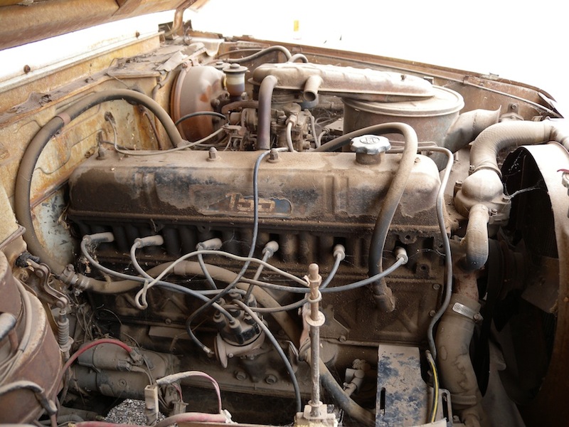

So I started at $1200 because the running of the engine was an unknown to me. She wanted $2500, and claimed the engine runs great, it just needs a battery. I was willing to go to $1500 not knowing the condition of the engine, she was willing to drop the price to $2000. I told her $1500 was the best I could do, unless they could get the truck running and I could actually drive it away, in which case I could probably do $2000. She and her husband are going to get a battery an get it going over the next week.
I tell all this because I'm curious other take on this price. Am I being too intractable? I see these things as low as $700 running and as high as $10k+. Does all this seem reasonable for the condition? Aside from the photos posted, the interior is kind of trashed--headliner shredded, upholstrey pretty bad. The dash is all there, though rough. The only rot is under the driver floorboards.
