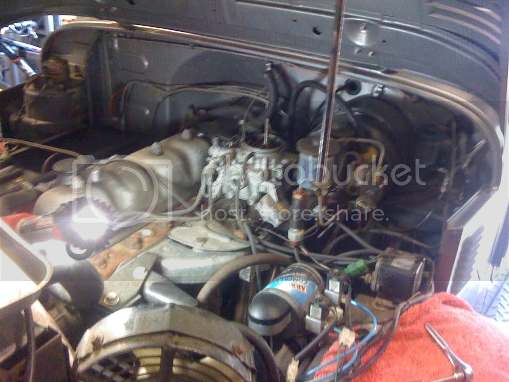

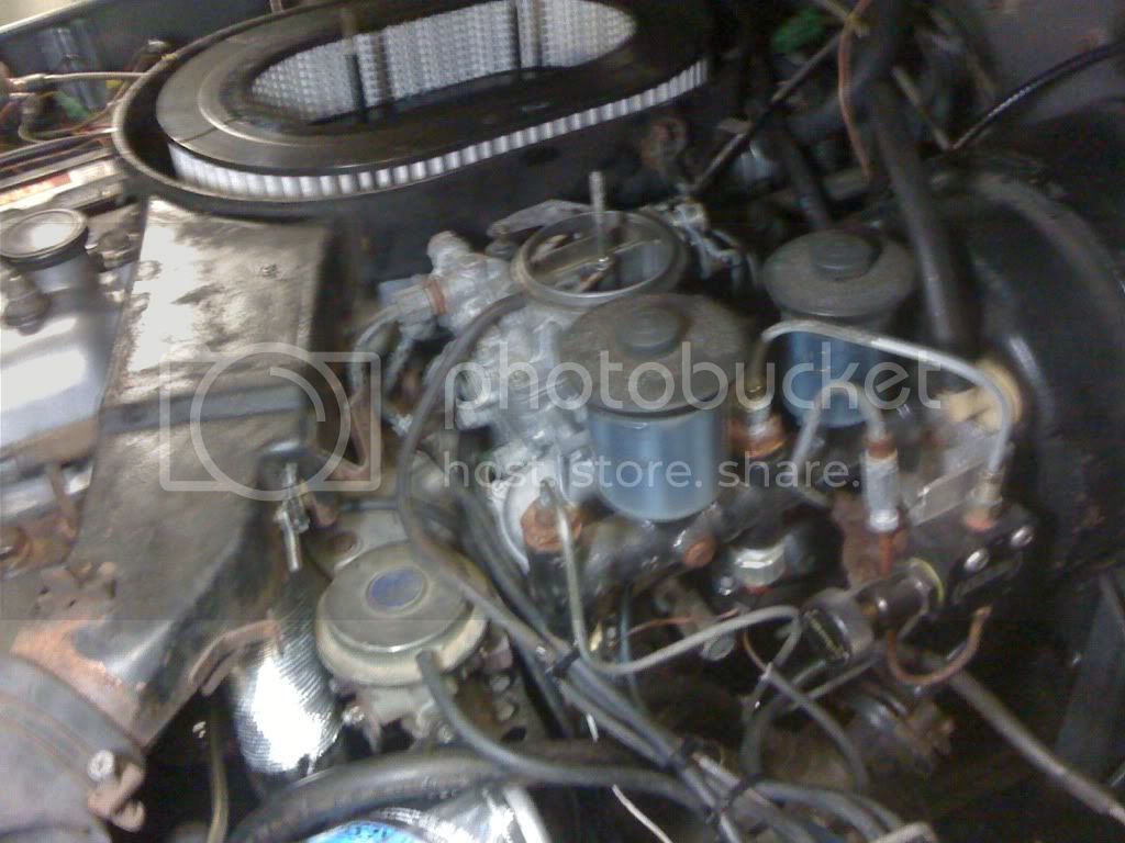

Ready for disassembly.
Air cleaner housing removed.
Carb fan thermo sensor mounting.

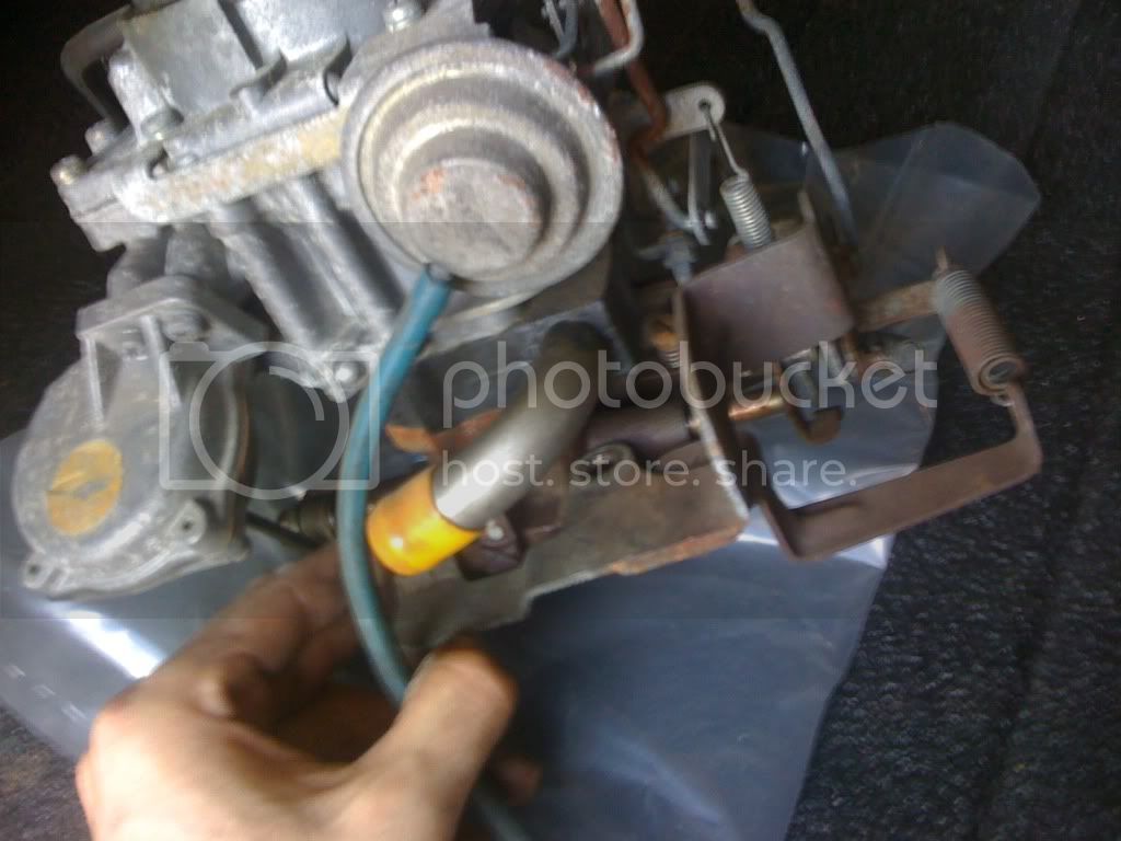

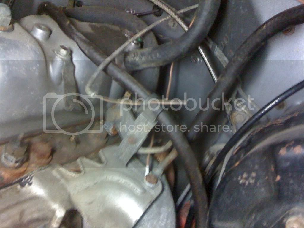

Throttle linkage bracket.

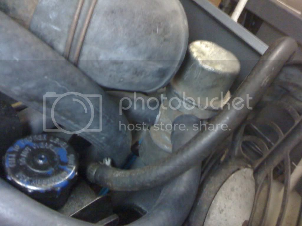

Note the yellow cap is where the EGR hose goes. The vac actuator with the blue hose is the TP (throttle positioner).

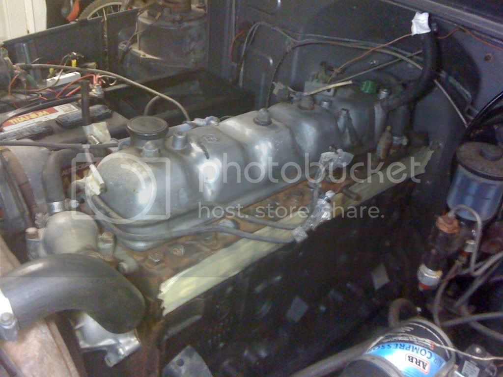

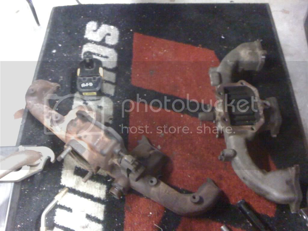

Carb and manifolds removed.
New manifold set disassembled.

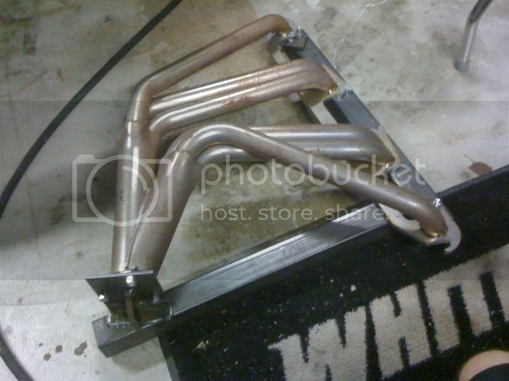

Headers on build fixture.

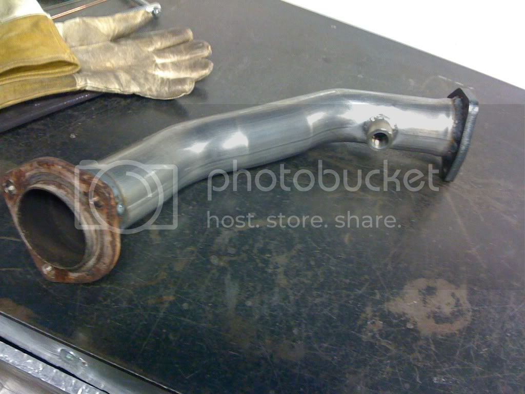

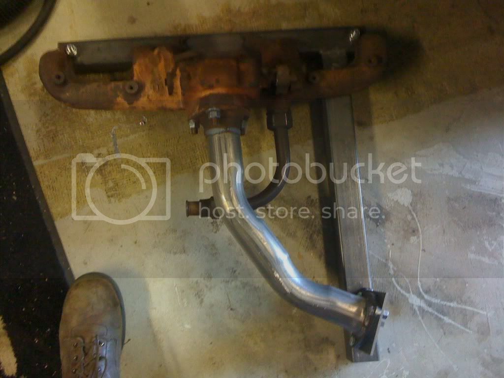

I didn't want to have to come up with an entirely new exhaust system, so I made a quick fixture off the headers picking up the engine mounting studs and the exit flange.
New downpipe on fixture.
Using a stock exhaust stub, I had a local exhaust shop bend up a section of tube and put the flanges on the end. Those bends done without an inside mandrel are kind of rough, but they'll do for now.
Downpipe O2 sensor bung.
Flash forward into the future, I wanted to put an O2 sensor bung on the pipe so I could use my wideband to tune the carb. Note that you need to disconnect the smog pump to get accurate readings. All that extra air pumped in bumps the AFR up a few points.

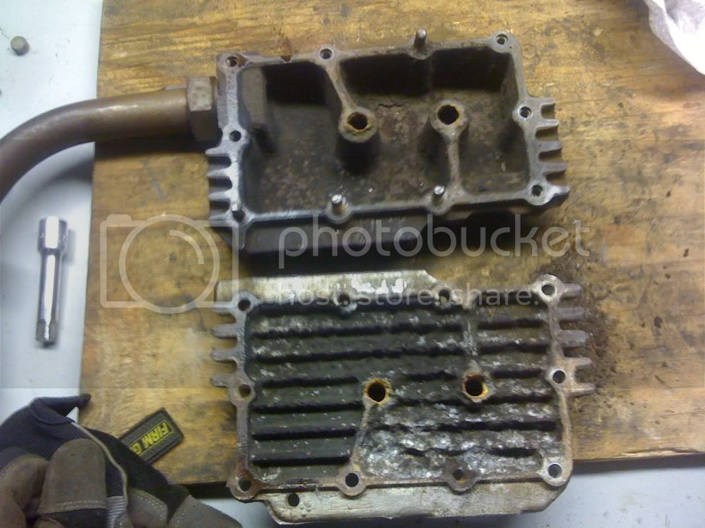

Early '76 EGR cooler.
Recognizable by its boxy shape. Later ones had a cutout on the forward end, still with an aluminum outer plate. Latest ones were that same shape, but all cast iron. All the aluminum plate ones all suffered erosion from exhaust gasses. The one I got looked OK on the outside, but it had eaten through the bolt bosses, and the inside was shot. The one that I passed on with my second batch of parts had visible holes through it. When I went to SOR to look at what they had, the best boxy style one they had also had visible holes.

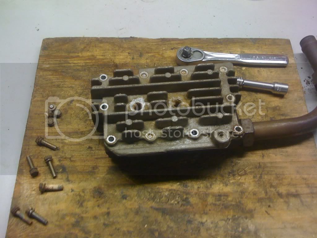

EGR cooler gnarled up innards.

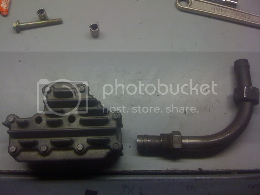

Another major difference between earlier and later EGR systems was the tube fitting type. On the earlier ones, there was a 1" compression fitting on the exhaust manifold. (Don't bother trying to loosen this one in the vehicle, I had to use a 24" crescent wrench). The EGR cooler end had a 1" flare fitting, and a smaller flare fitting, maybe 3/4" for the flex pipe to the valve.
Later systems had a 2-bolt flange on the exhaust manifold, and compression fittings at both ends of the EGR cooler.
I needed to adapt to the newer style cooler, so I cut off the flare and added some extra length to my egr pipe. It needed about 0.70" extra.
Newer style fully cast iron EGR cooler with modified pipe.

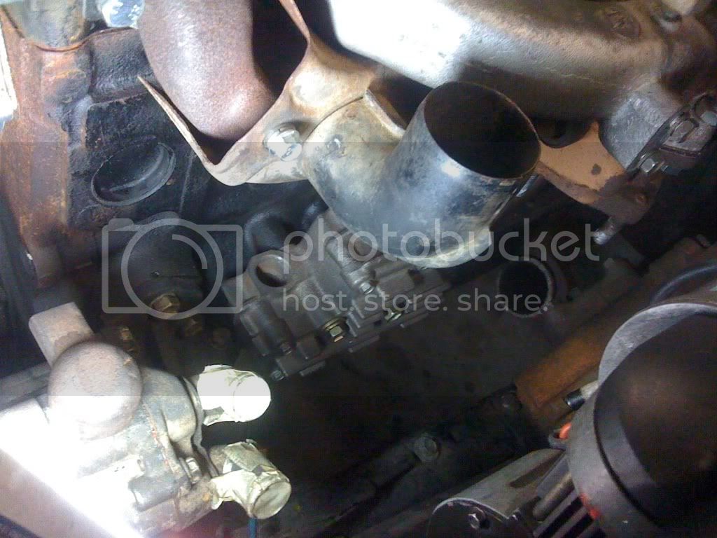

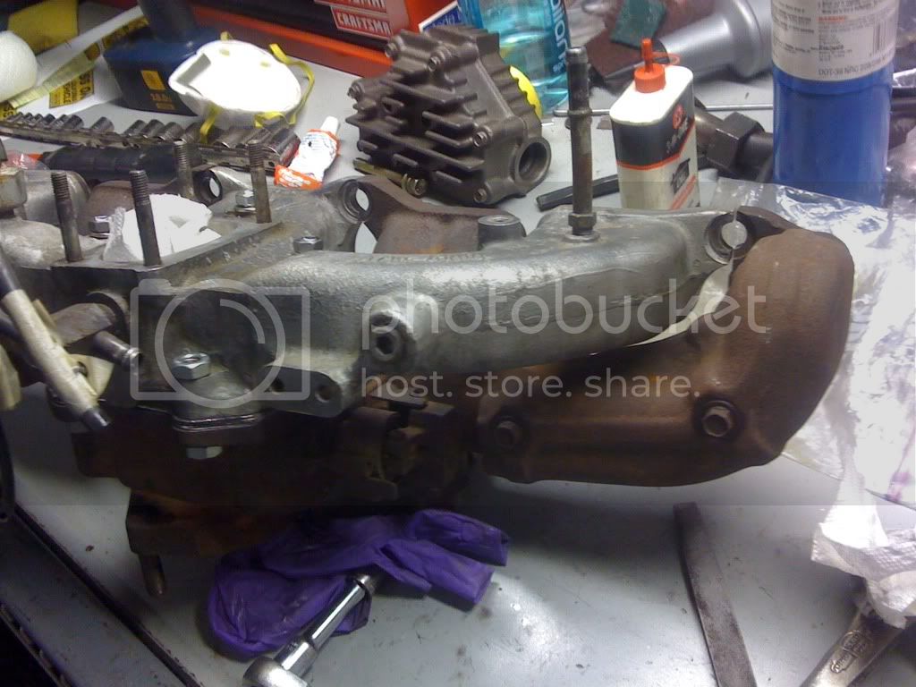

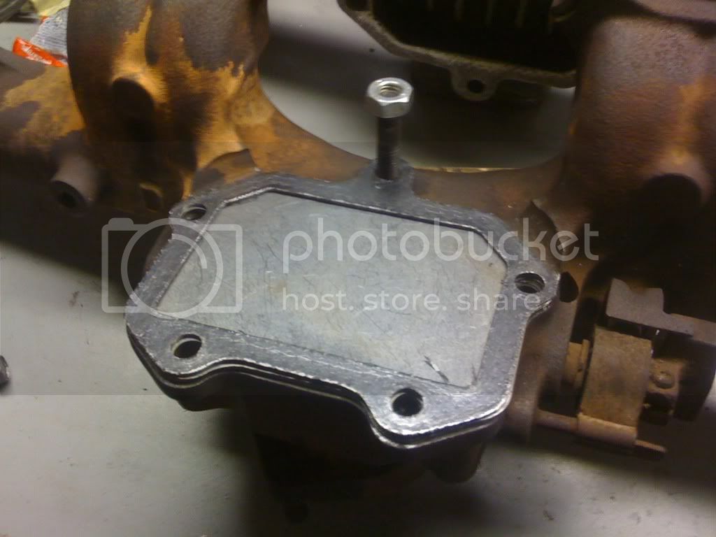

SOR heat riser insulator plate.
The manifold set that I got was missing the heat riser insulator plate, and only had 1 gasket. This caused the sandwich to be the wrong height, and the shared bolt holes were excessively offset. The original insulator plate has a bump in it to accommodate the swing of the butterfly, and the SOR plate is flat, so the butterfly needs about 0.3" trimmed off of it.

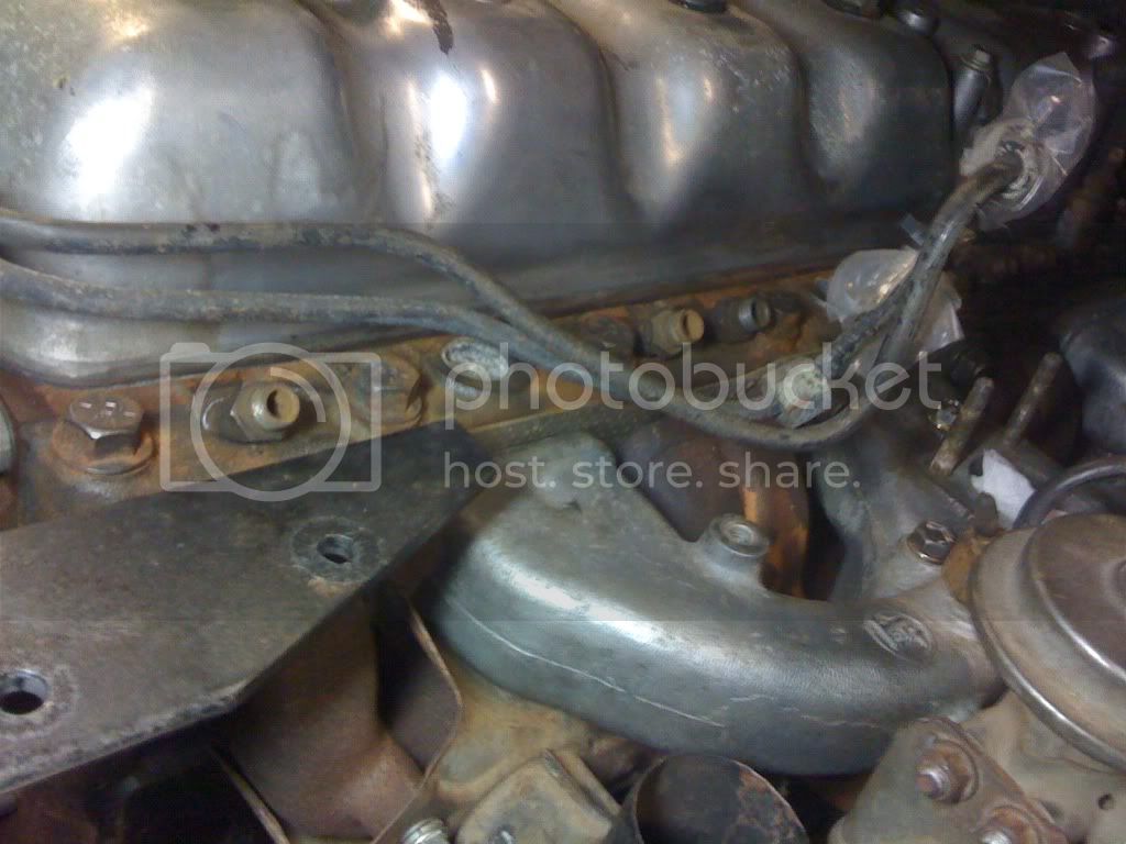

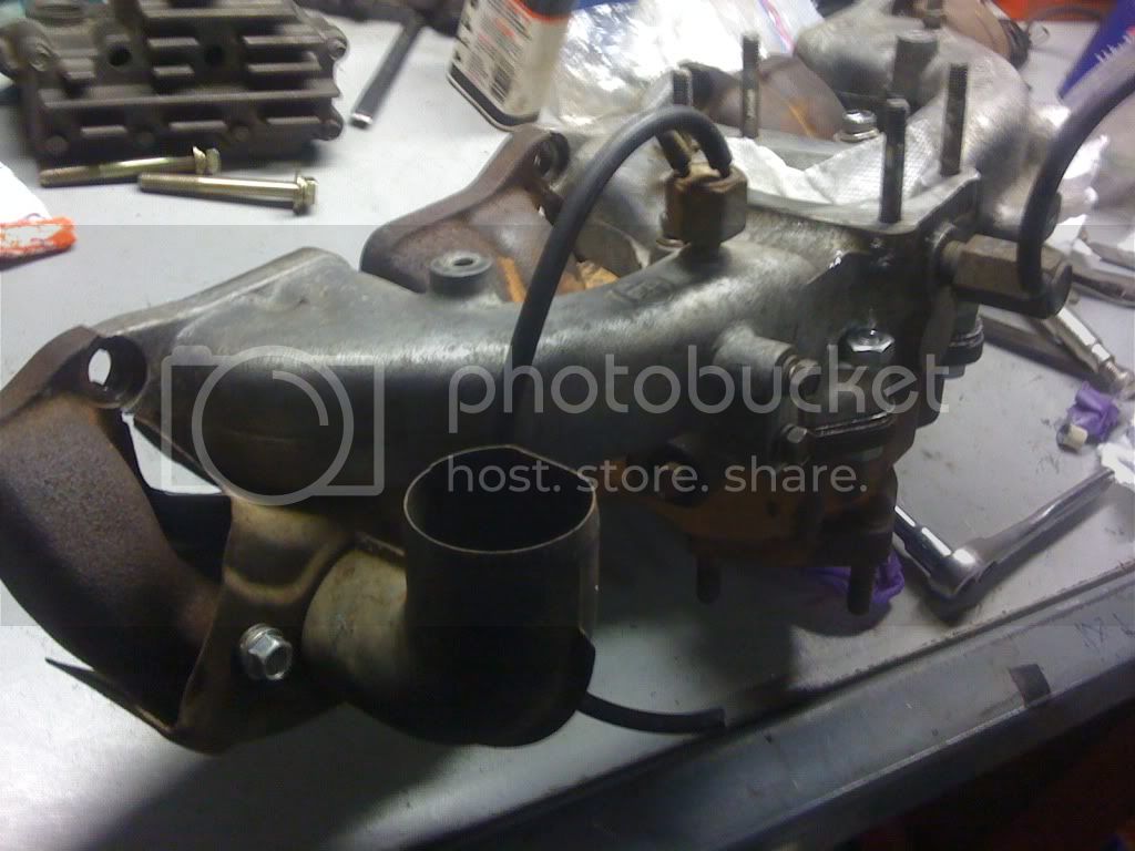

Manifold set with heat shields.
The manifold has a couple of heat shields, and the front one has the hookup for the heated air cleaner. The front one can go on after the manifold is installed. I had to install the rear one before the manifold went in, and then take the bolts out and shift it over to get to the exhaust manifold studs.This may be different on the 3-piece manifolds.

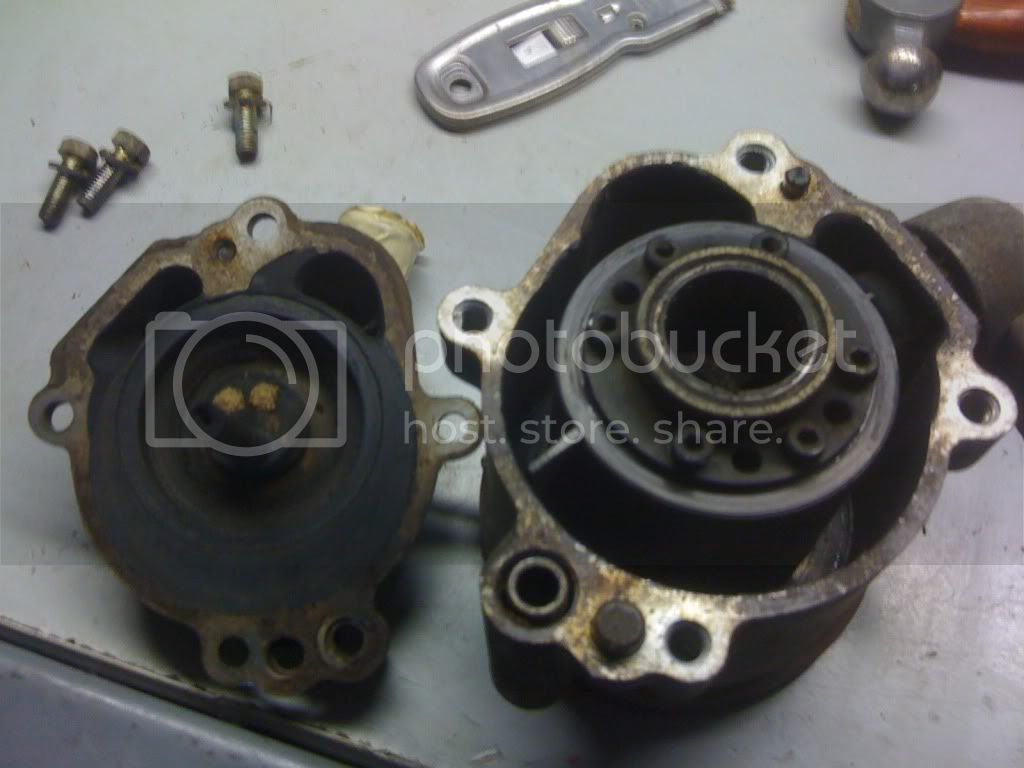

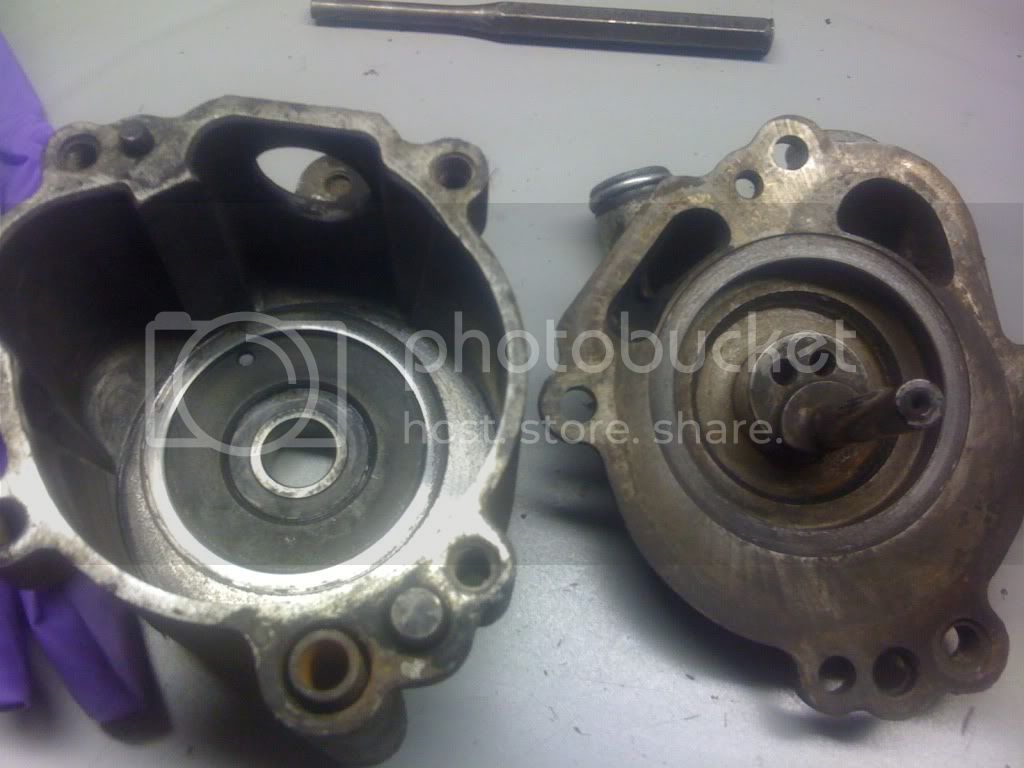

Smog pump

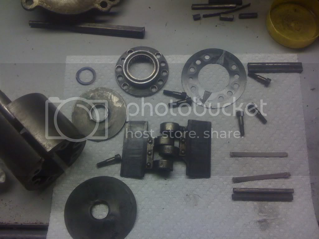

The smog pumps are another gross part of this process. If you're planning on getting a used one, get more than one, and you might have enough parts to make one good one. It has fiberglass blades on an eccentric cam that ride inside of carbon guides. One carbon guides per pair has a spring plate behind it. These break, and get spit out of the pump. They're also nasty with old grease inside. The rotor has a shim or shims on the shaft that are critical. I ended up needing to use the shims from both pumps in the one I rebuilt. Also note that if you have the style with a single nut on the pulley, THE NUT IS A LEFTHAND THREAD!! Now I have a tapped shaft and a custom washer.
Smog pump guts.
Continued in the next post…
Continued…

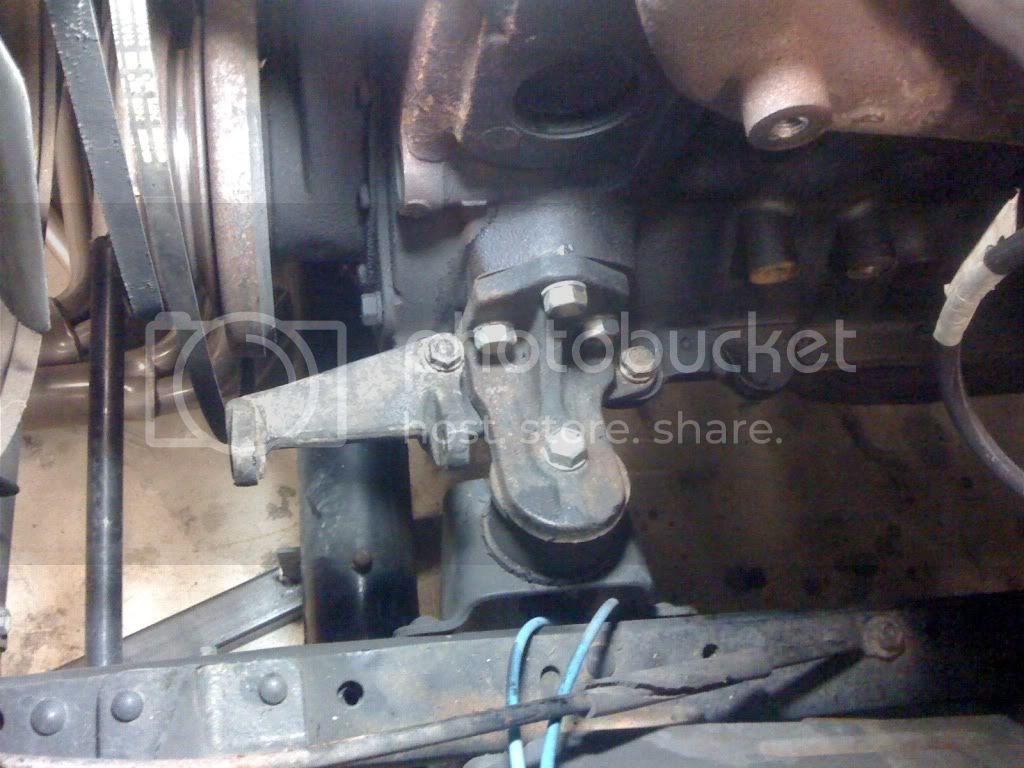

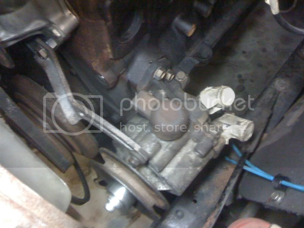

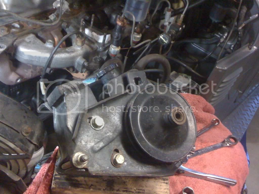

The smog pump mounting bracket mounts underneath the left motor mount. It has its own bosses on the motor, and it can be removed and installed without touching the motor mount.
Bracket mounted.
The smog pump tensioner bracket attaches to one of the lower water pump bolts. If you don't have this, you'll need a longer bolt and a spacer.
I had to work around the crazy PS bracket to make my setup work. I will definitely be replacing it soon. It's a huge chunk of steel that appears to be made partially from another OEM's PS pump bracket. Despite all that beef, it's mounted to the engine with a single piece of steel angle that picks up two of the the exhuast manifold bolts. Needless to say, it's less than rigid. I had to cut some serious metal out of this to make it fit with the smog pump tensioner bracket.

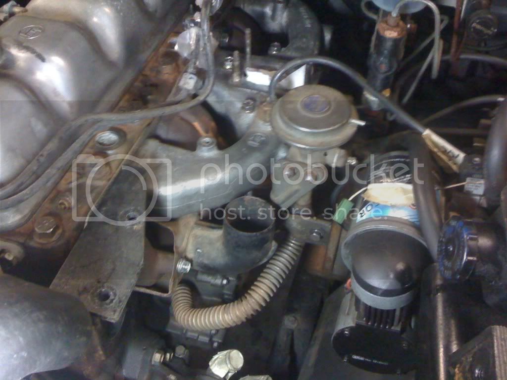

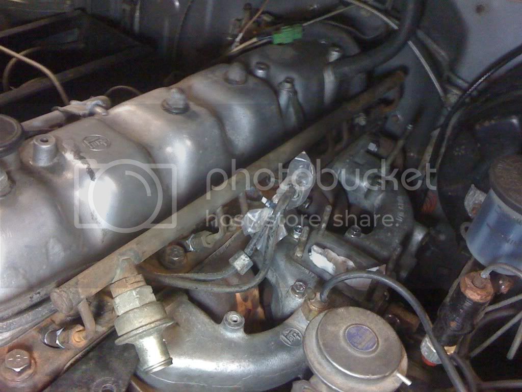

EGR cooler installed.
EGR valve installed.
Air injector tubes installed.

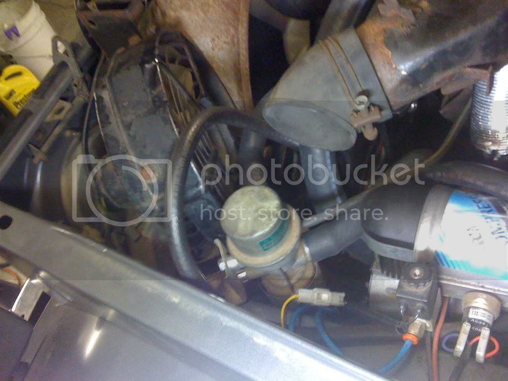

ABV and plumbing. This is the valve that goes inline with the smog pump output. Its actuator port connects directly to the gas filter on the intake manifold.

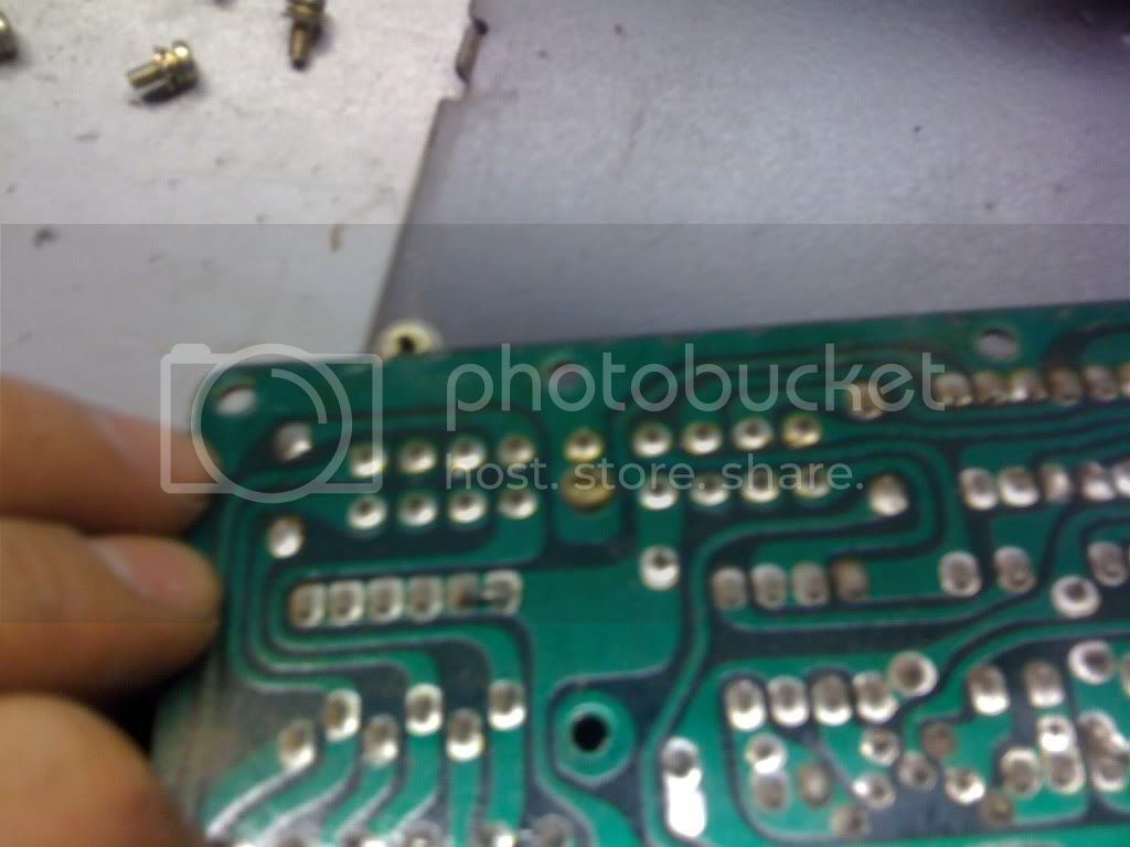

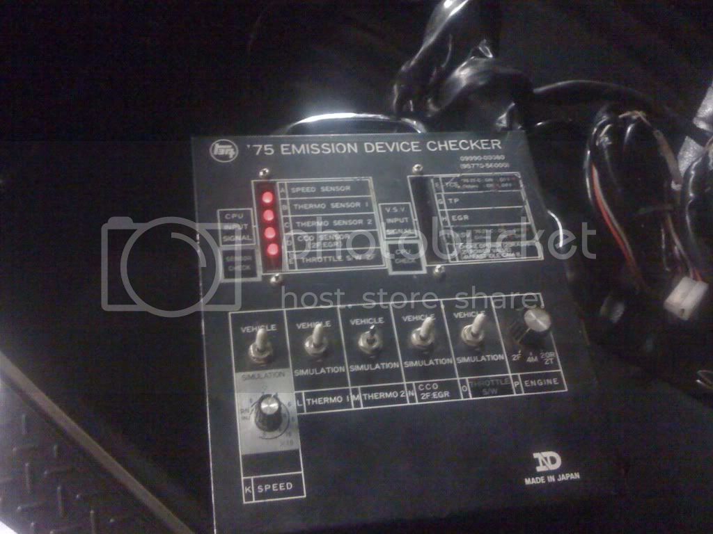

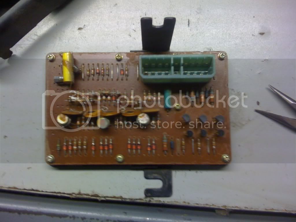

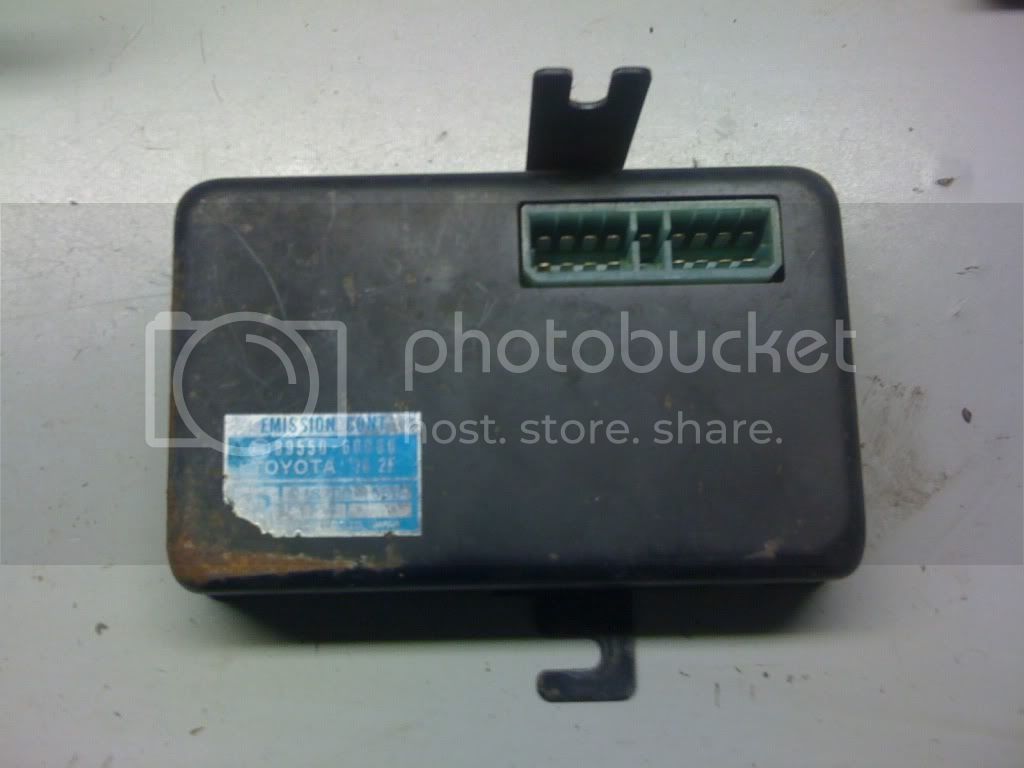

The SST section of the emissions manual lists a diagnostic box (PN 09990-00080). Somehow I was able to locate one of these dinosaur boxes in working condition. It hooks up to the inspection connector in the drivers footwell, and inline with the VSV. The box shows you with LEDs what sensors are registering, what VSV functions are commanded, and lets you simulate vehicle speed and some VSV commands. The service manual has procedures for doing most of the diagnostics without the box as well, but some of them you have to be driving with a vacuum gauge connected.
Using the box, I was able to diagnose that my emission computer wasn't functioning properly. When I simulated speed, the TCS (Transmission Controlled Spark, aka controlled vacuum advance) and TP (throttle positioner) outputs weren't activating. I swapped in another computer, and the TCS worked, but not the TP. When I disassembled the first computer, I noticed that many of the connector solders were cracked. I reflowed them and put the first computer back in, and everything worked. I guess years of vibrations and the occasional foot kick beat up the solder joints. As an aside, I had a heck of a time getting the plug out of the computer. The little tab on the connector was partially broken, and wasn't fully disengaged. I ended up needing to use a small pick to get the clip disconnected.

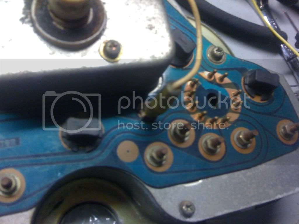

Those speed-related VSV functions get vehicle speed from a 4 pulse per rev sensor built into the speedo assembly. When I finally got out for a road test, my speed readout on the SST box was inconsistent, and the speed-related functions weren't activating.
I took the speedo assembly out, and found that the spade connector from one of the speed sensor wires had inconsistent continuity with the pin on the round speedo cluster plug. I added some solder to these crimped connections, and it solved the problem.

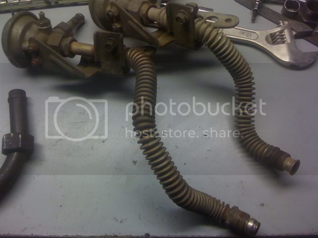

HAC tube
Also known as a thermostatic air cleaner, this system uses a flexible metal duct between the exhaust heat shield and the intake duct on the air cleaner housing. There's a small actuator inside the duct that controls a diverter flap. When the engine is cold, it pulls air past the exhaust manifold. Once the engine is warmed up, it pulls air through the end of the duct. These tubes are commonly available in 2", and the mating connections are closer to 2.125". With enough stretching, pulling, pinching, and squeezing, the 2" will fit, but not the best.

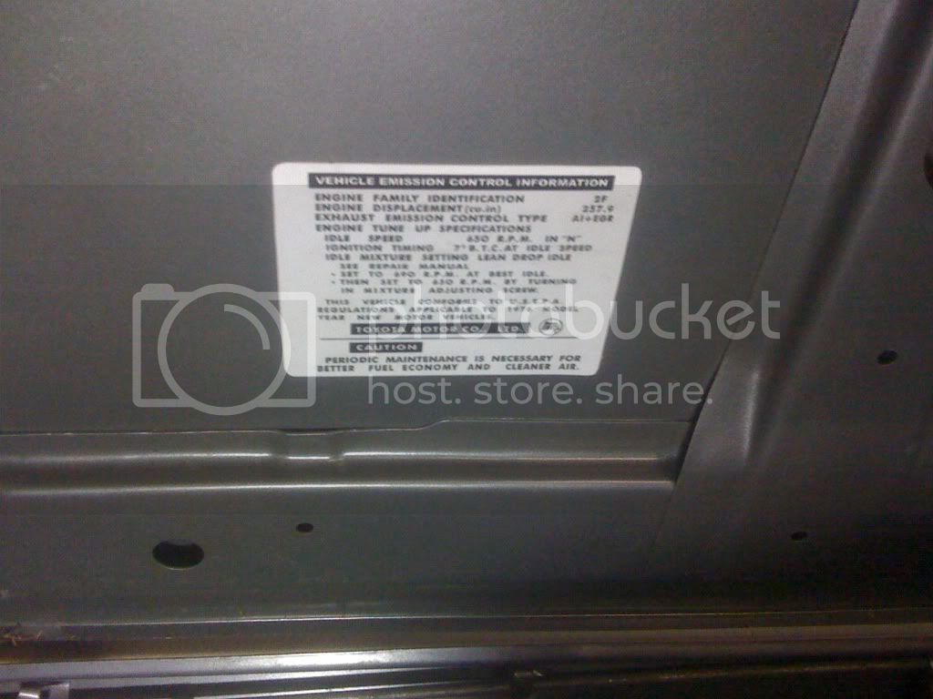

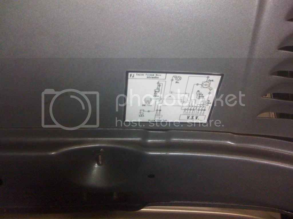

Emission Stickers
These stickers are nice for the smog shop to identify your smog equipment and components. I think they have a book that lists what you're supposed to have, but the stickers don't hurt, especially if you're federal and not CA spec. I put the main sticker where I've seen them (passenger side, under side of hood), and the hose routing sticker on the driver's side, as I haven't seen an example of its factory placement.

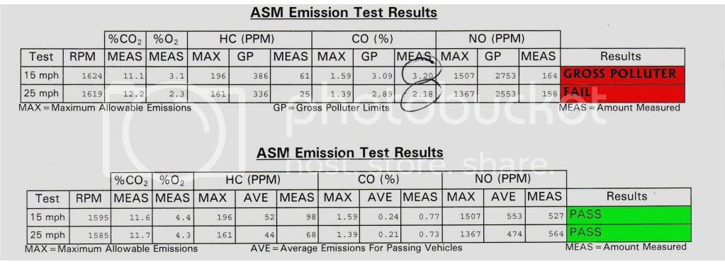

Smog Check Day Zero
I went for my test drive and fixed the speed sensor problem on the morning that I was going to do my smog check. My AFR seemed OK at idle and speed, but I wasn't positive what its limits were to pass.

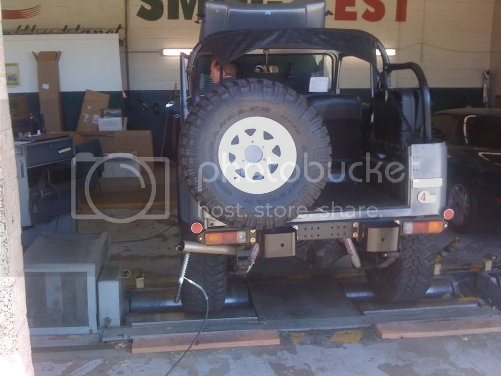

I took the test, and they were extremely thorough. EVAP system tested, gas cap tested, all components visually identified. Just because it's the first year of smog, doesn't mean they're any less strict. You don't get your result until the test is all the way completed. I held my breath, and... Gross Polluter!!! Such a let down. I thought I had been so thorough. My HC and NOx were fine, but I was way over on CO.
Luckily the Test Only shop I went to, did a free retest. I went home, did a quick bit of research, and pinpointed the power valve. I pulled off the top of the carb, disassembled the power valve plunger, and found that it was stuck in the actuated position, and full of gross varnish.
The power valve piston is about 3/8" diameter, and is held in with a lock plate and single screw. It's spring loaded, and should move freely. The power valve gets manifold vacuum from the VSV unless the TP switch on the gas pedal is actuated. It also does a little bit on startup. So, basically I tried my smog check with full throttle enrichment the whole time. I didn't get a chance to take any pics since I was in a bit of a hurry.
There's an easy way to see if your power valve plunger is moving freely. Start the engine, let it warm up for a bit, pull the air filter housing cover off, and look for the forward-facing vacuum port on the carb, near the throat. Pull the hose, and the plunger should drop (but you probably won't notice). Here's the check part, plug the hose back in while listening closely to the top of the carb. You should hear a little "click" when you connect the vacuum line.
Once I got the carb back together, I reconnected my wideband, and disconnected the smog pump hose to the air rail. At smog test RPM (1600 RPM), the power valve makes a huge difference. With the power valve off (under vacuum), AFR was around 13.7-14.0:1. Disconnecting the vacuum line dropped AFR down to around 12.6-12.7. That's a big difference. 12.7 is a max power AFR, and 14.7 is stoichiometric (all fuel consumed).
Back to the smog shop about an hour later, back on the dyno, and I passed! HC and CO levels were a little less than half way between average and max allowable. NOx was about average.
