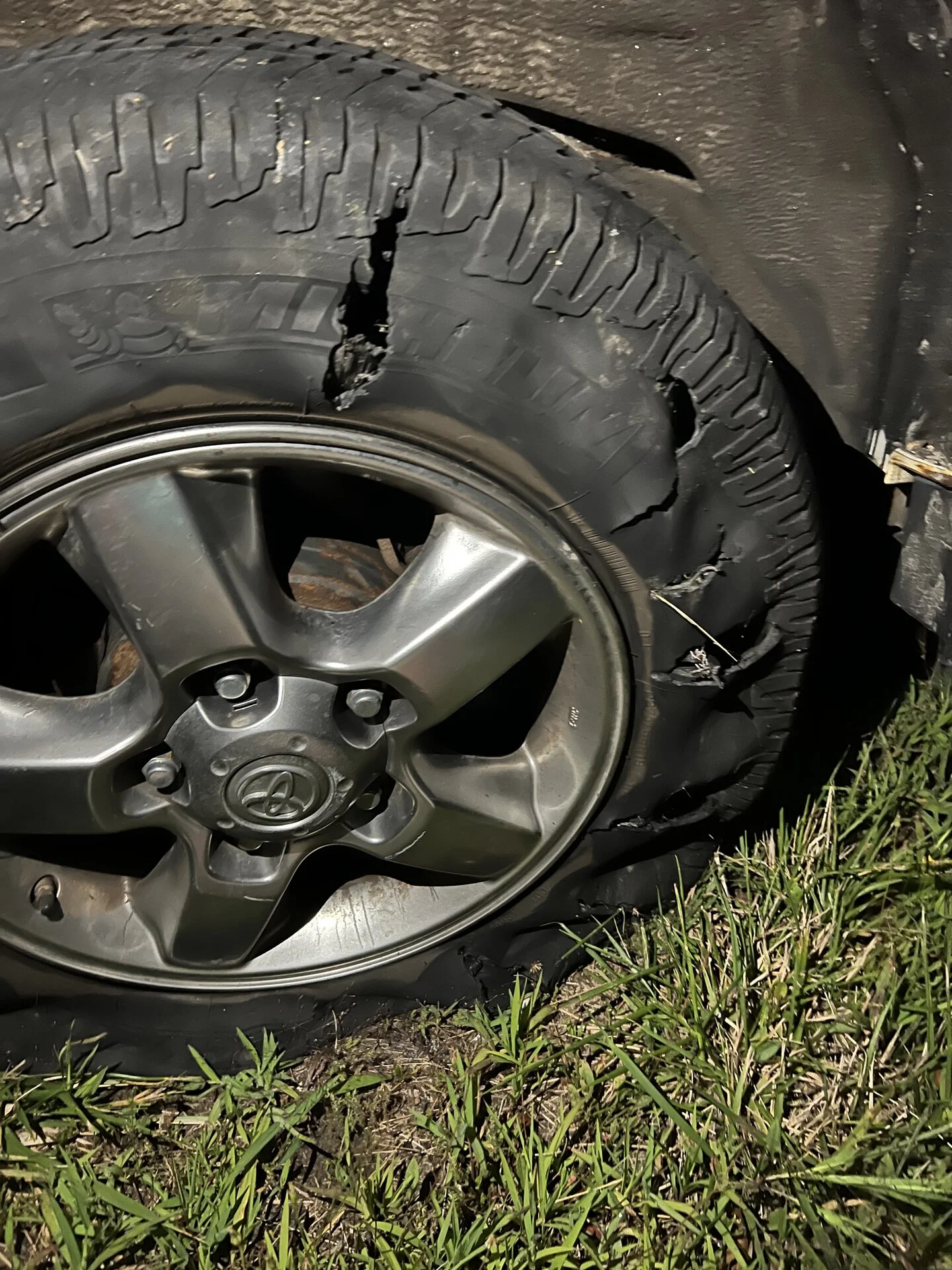

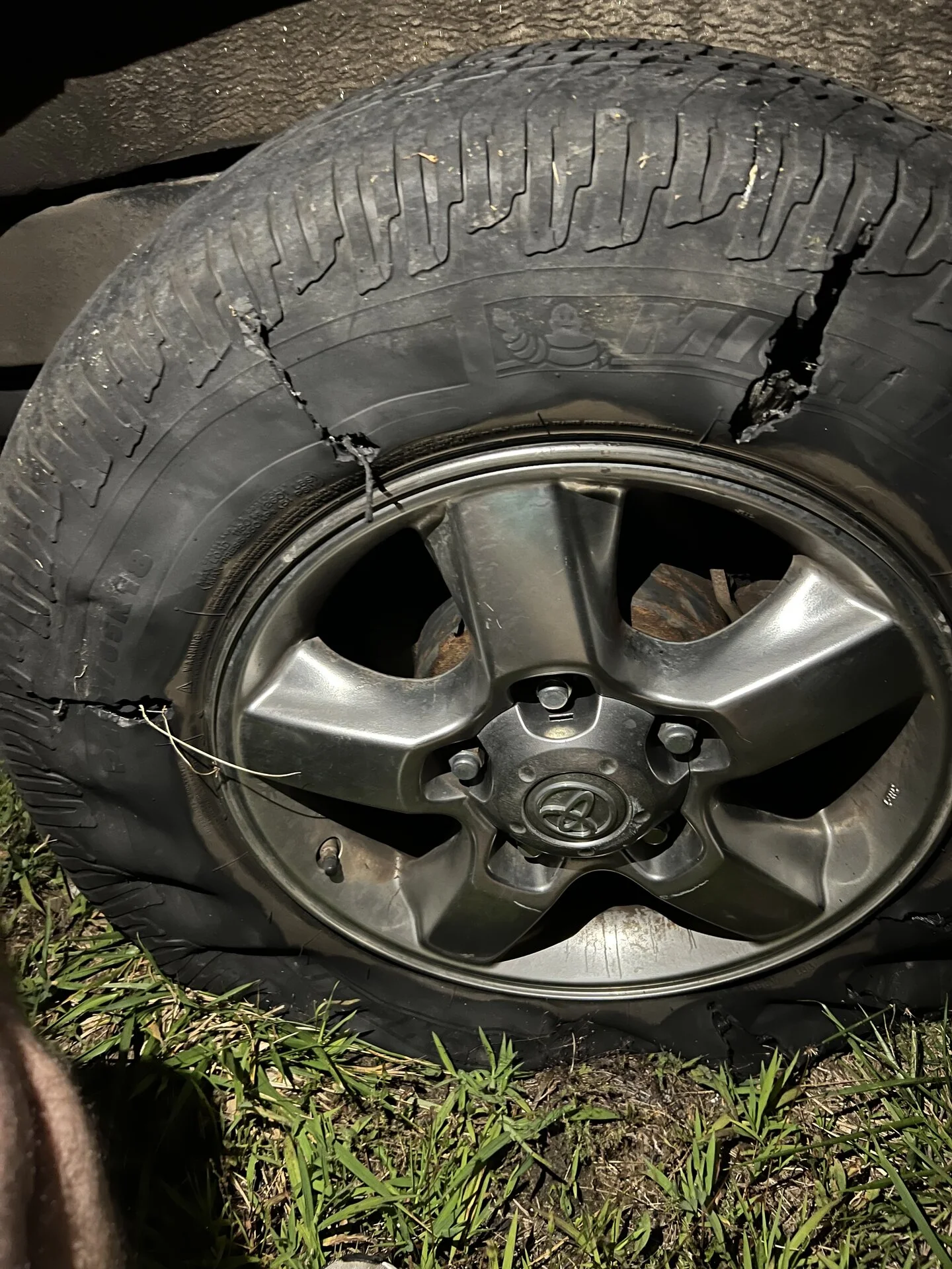

Got blown rear passenger tire on freeway - not fun.
Not sure whether had tire leak as tire sensors are not working or manufacturing defect. Tires are less than four years old.
Is this me or do others have similar issues with these tires?
Thank you!
About 40-50k. Correct about thread Was planning to put new ones on in winter
Curious whether At/2 have an issue blowing up or whether I had a low pressure and tire behaved as expected
You have a huge difference in tread depth between the main tread and the shoulder of the tire. Don't know if it was tire pressure, or another problem, but that tire has been worn out for a while.
Every tire has an issue blowing up when the tred is worn down, the pressures aren't right, and they heat up at highway speeds with a big heavy truck on top of them. Gotta keep an eye on that stuff.
No issues with the tires as they are consistently some of the best performing tires out there. As suggested, the tires were well past their useful safe intended life and when they heated up, didn’t need much to blow out. Always replace tires that are at the wear bar on any part of the tread, or before if you don’t like a chunky ride. If the tread did. Or wear evenly, make sure you get tires changed at the same place you do an alignment so they can see what they are working with, so to speak.
