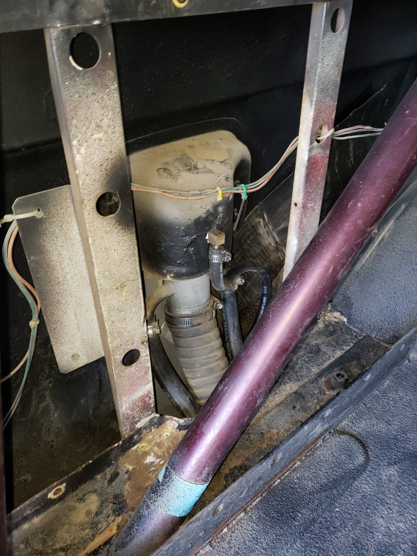

The many mods we needed to were as follows:
1. The fuel pickup being in front of tank meant I would starve with 1/4 tank going up a hill.
2. The vent tube was short and ineffective and would spit fuel out.
3. The overflow tubes were plumbed to the side of the tank and at the same level as the filler. It would shut off the pump at the gas station so much and I never got more than 32 gallons in.
4. Top tank was drooping down restricting volume.
We got some angle alum to support the top and the baffles. You see one here.
We moved the overflow tubes to the top. We did not have the ability to weld new bungs so we made a bulkhead fitting.
1992566
We installed the hydramat close to center of the tank and needed to find a way to plumb to the bottom of the fuel pump. We used a plastic 90 and removed the stock sock.

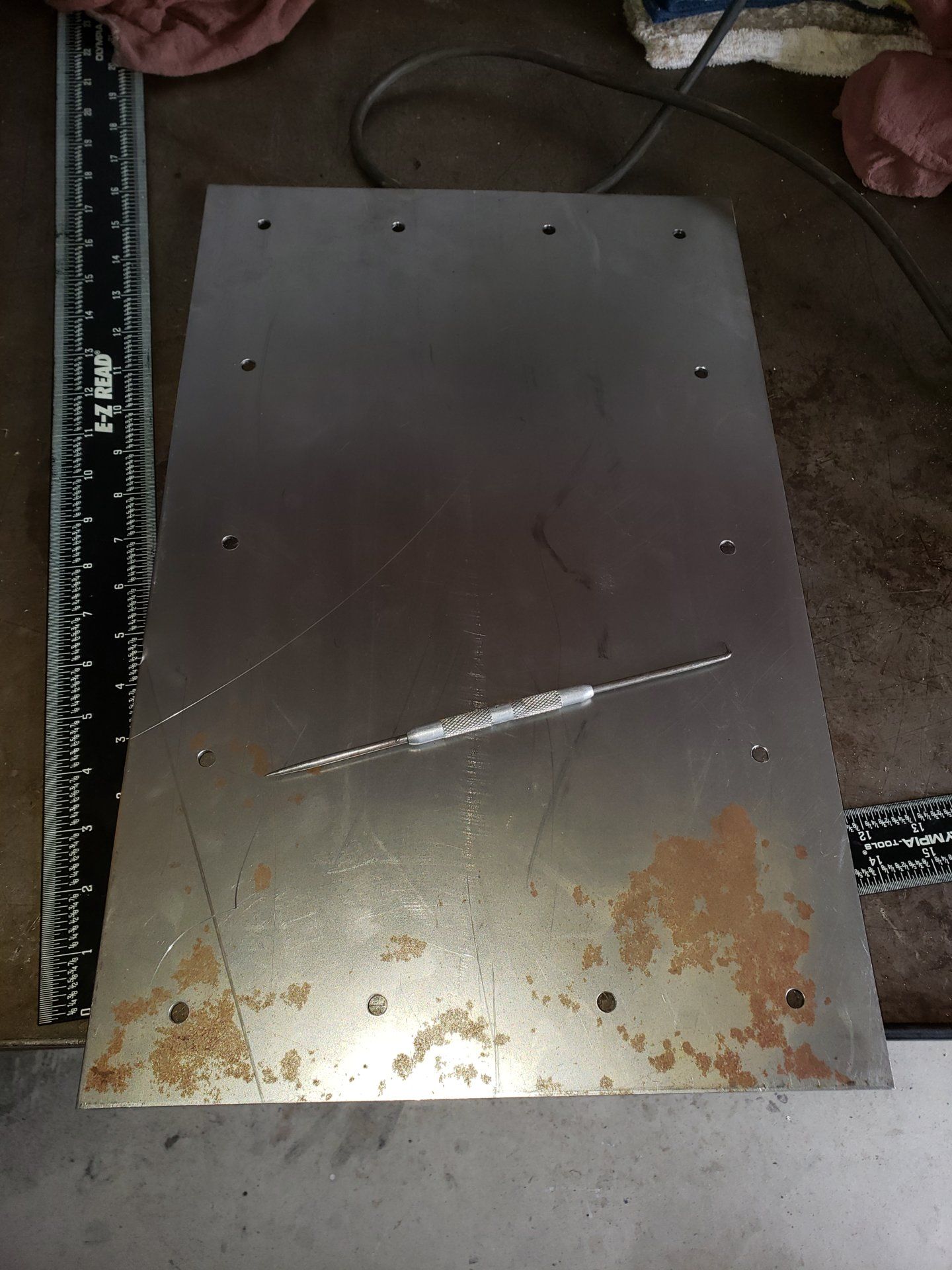

We made the access panel and rubber gasket yesterday. I found some gas proof rubber on Amazon.
We used m6 rivnuts and bolted it through the angle pieces. The top is pretty flat now.
We took a 6 foot 5/16 line and plumbed the vent to the fuel door. @J Mack gave me that idea.
Got tank in and put 5 gallons in and it fired right up. Needed to do the timing but we took it to the gas station. There is a steep hill right near Steve's house that I would sputter on with only 5 gallons and it had no issue.
Filling the tank was amazing. Stuffed in 33 gallons before the pump shut off. Squeaked in another gallon and we were full. Estimate that I got 38-39 gallons in.

Should've hooped rivnuts too. Are they blind rivnuts?
Eyes wide open. I guess I didn't know they had closed ones. @J Mack has been texting me all kinds of info. I will make some changes over the next few days.
We pressurized the tank last night and the second attempt leaked a little from under the gasket. The bolts were solid. Took the access panel off and a rivnut hadn't seated proper. Put in a new one and lathered on the red sticky stuff all over the top per @J Mack and let it set for a little. Pressurized it again and it held up with no leaks. Put the tank back in the pig and it started right up.
