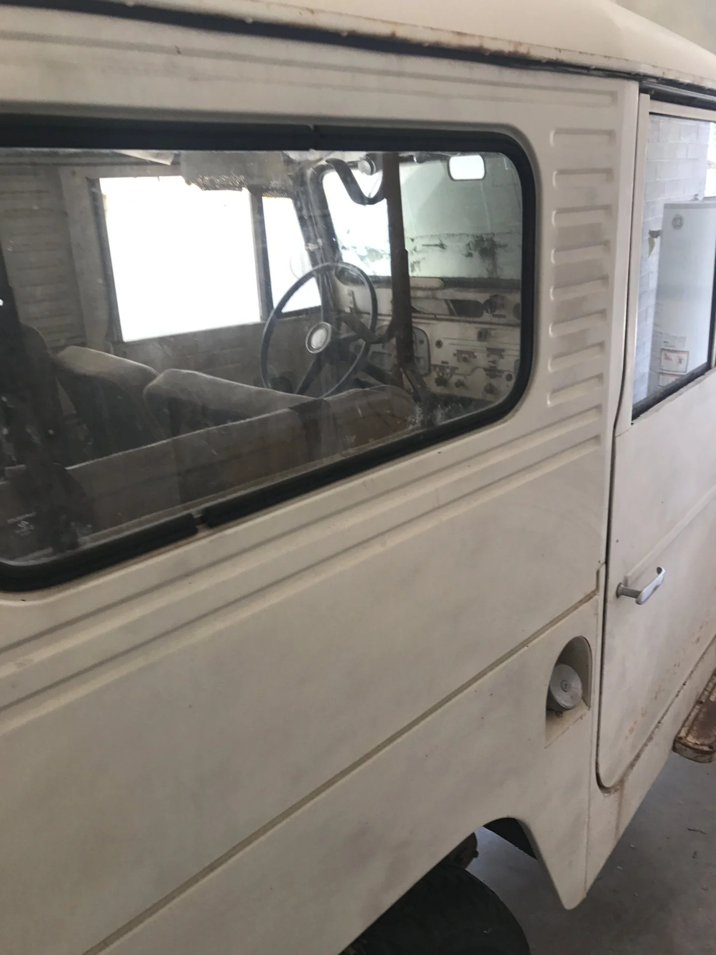

I picked this up because it was very dry and no rust. Arizona Truck its entire life. Bought from second owner that drove it from '67 on. At some point in the '70's he dropped a 350 in it and drove it up to about 10 years ago, removed the small block and left the trans and original transfer case in it. He sealed the big screen with a couple of tubes of sealant and what looks to bo beeswax. Sealed all openings with aluminum duct tape and buried it under a plastic and plywood tomb. It was like peeling an onion to get all the layers off. Before putting it to rest he took rattle cans of white paint to cover any surface rust, the original paint is an off white. Did early 40's engine firewalls come black from the factory? Would like to hear your thoughts on the vin and what's correct and not!

Mostly original. Tranny hump replacement (easy find) and source a period correct drivetrain. Far as I know the firewall what the body color. Remove the ugly, square tail lamps and you’re good.

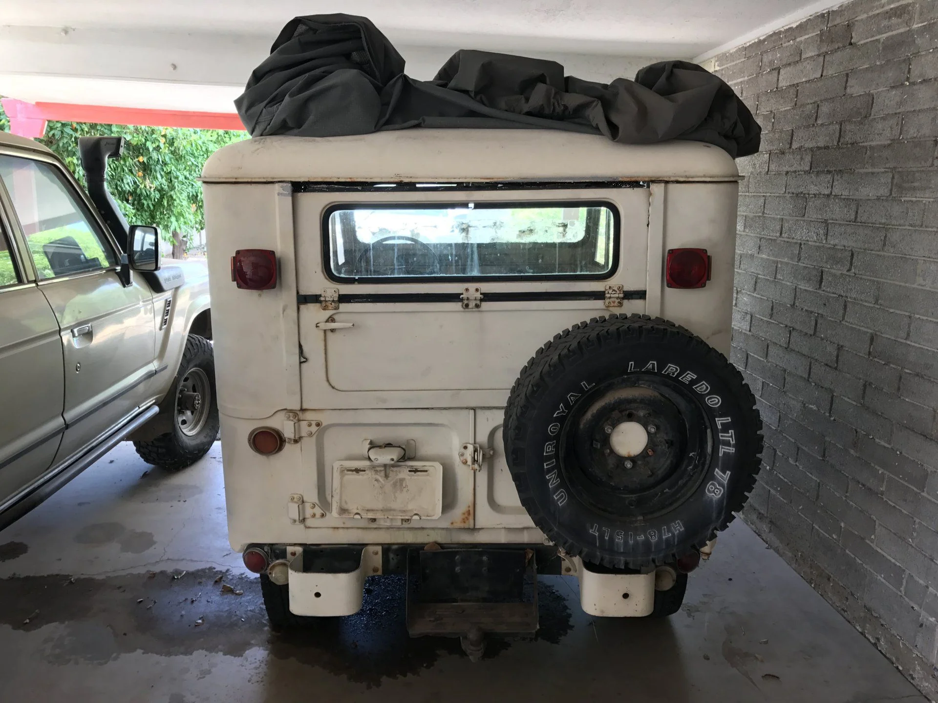

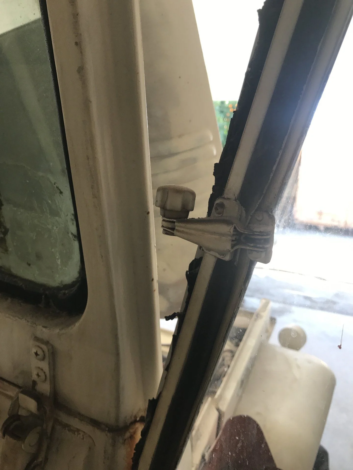

First thought is congratulations on the acquisition. Second thought is how structurally sound and straight it is---remarkable. Third thought is how atypical it is to see a 1964 hardtop model with soft top windshield fold-down latches on the inside paired with the typical hardtop no-rubber-bumper and no windshield tie-down latch hood. But the fourth thought is that the "L" behind the "FJ40" suggests that it was initially manufactured as soft top model.

(Edited to say, I actually don't know what year Toyota started putting a "V" behind the "L" to distinguish between soft top and hard top body types.)
Does have barn doors and I don’t see holes for the FST tailgate. Interesting.

Looks like a factory hardtop. The folding windshield hinges, but lack of hood bumpers would be correct.

What year-model did the interior windshield latch & hook mechanism show up on hard top models, as opposed to the earlier windshield-to-dash stud & nut set up?

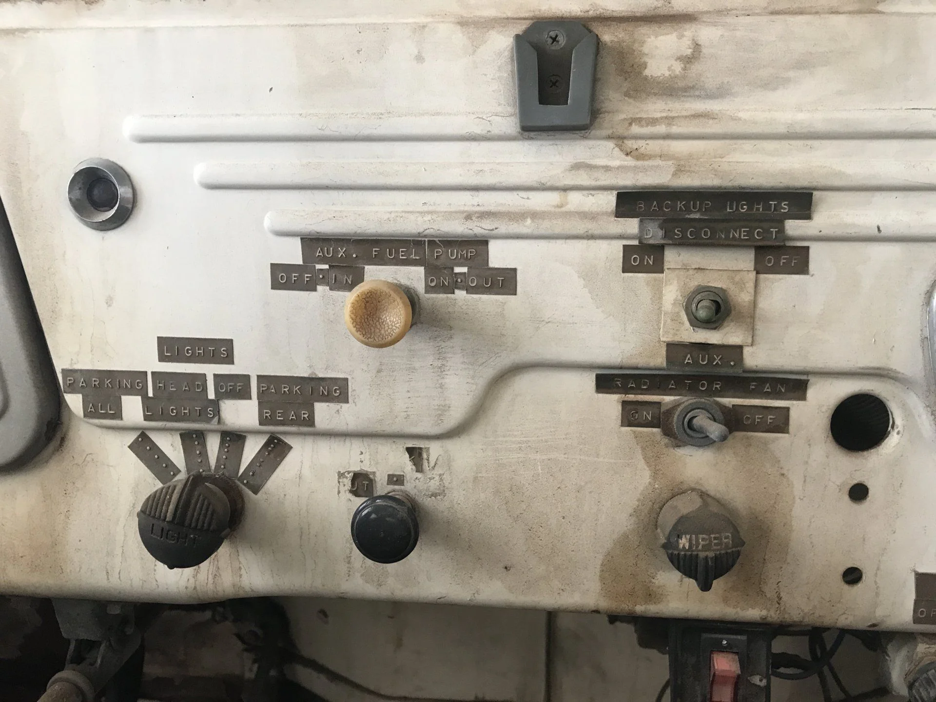

Label makers must have been OEM;)

Just curious, if you fold the windshield down on these, how do you keep it in place ?
Bungee cords?
Ha , Ha, I suppose I should elaborate the true question. Was it a design flaw to have a fold down windshield and have no way of securing it ? My 1969 has hood hooks and rubber stops on the hood so somewhere they had to figure it out.
It’s an oddity that Toyota made them this way. The hardtop FJ25’s and early hardtop 40’s were like this for some reason.
