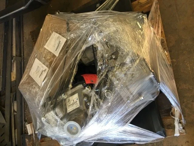

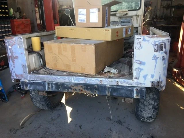

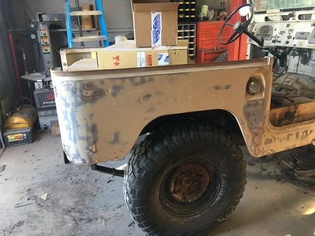

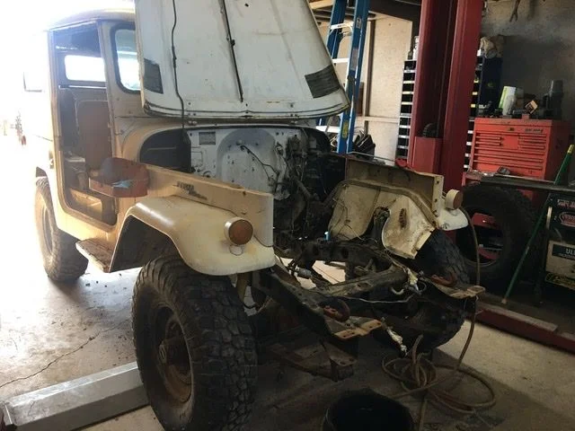

Here are a few progress shots, engine and trans get fitted this week as well as 60 power steering.
