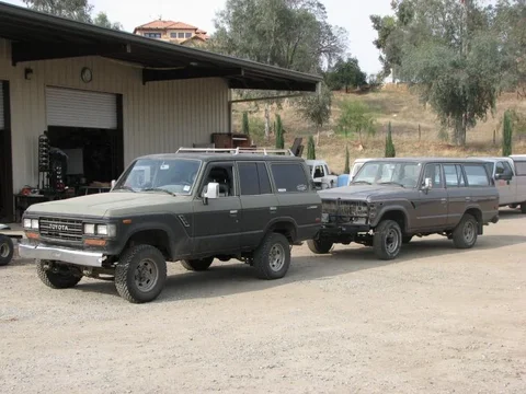

Meet Spot

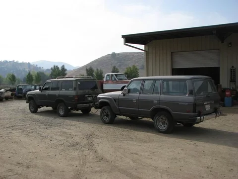

Well Spot has a date with the Sweetgrass/Coots border crossing this weekend, then off to the family farm back east about a week later. :)

So she runs now?
:doh: Nope, something like this.

So she runs now?
We need some current pictures dude!
no, not running, it's engine less currently.
:Confused: I thought Spot was your 55?
it will be rockdoc's this weekend.
i dont see a pig anywhere...just a couple of wanna be's
I think rockdoc was showing how he will get the piggie home across the border.
He is delayed 1 day to a screwup on my part in getting the paperwork to the border.
