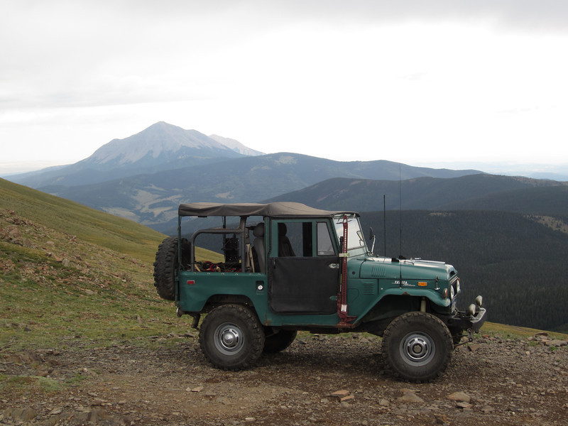

Here's my old 40 in the hills up above Cuchara. Some great old roads in those parts, and a great place to have an old cruiser. Good memories.
