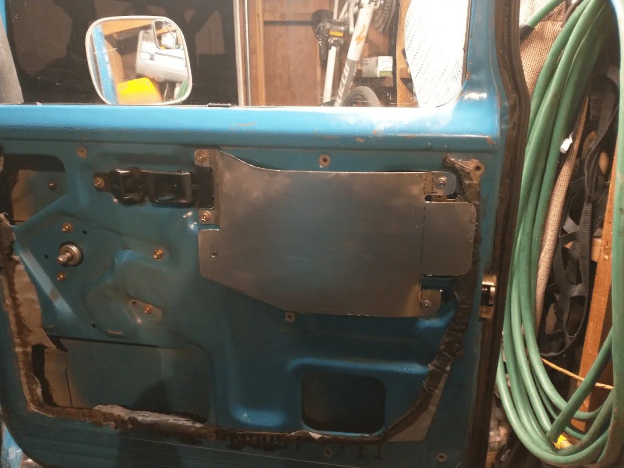

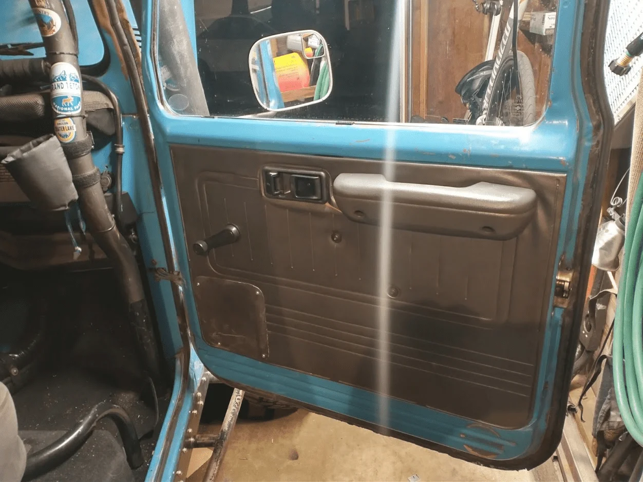

Here are some quick and dirty door handles:
I got sick of the stupid little straps ripping off, and the lack of an armrest when the windows were up.
They are from a 90s Toyota minitruck.
After making the mounting plates I put M6 rivenuts (not shown yet) in the plate to hold the handles in the desired location. They are very sturdy and a nice arm rest. They also have a little pocket to put Chapstick or whatever.
Not sure if they will work with your doors, but this is just an idea!
Mike
View attachment 2622665View attachment 2622666
Mike
Mike, thanks for the pics. I will show my better half. I think she would like the idea of an arm rest as well. Thanks. :)
