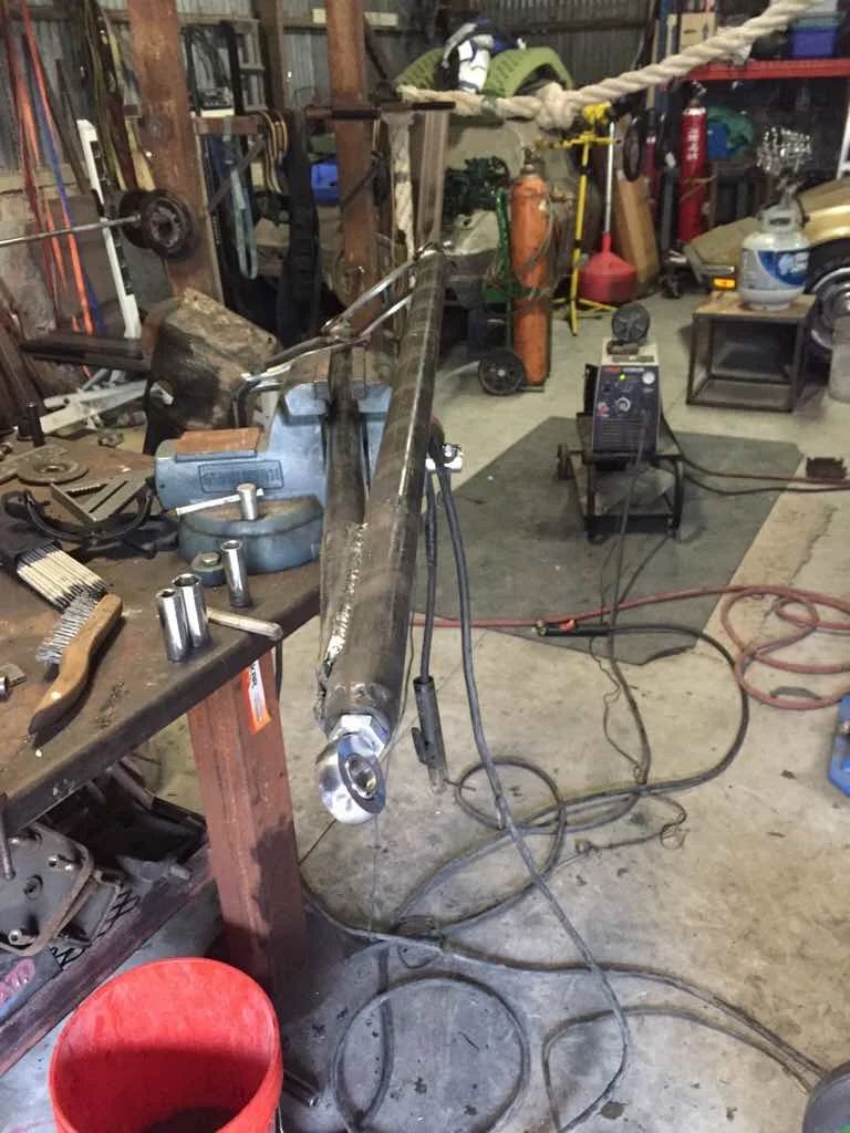

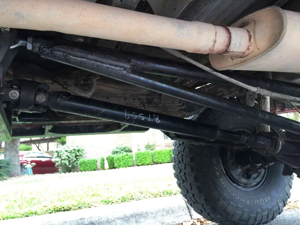

Quick update. Finished my traction bar this weekend. Still need to clean it up and paint it, but it's bolted up and working right now. Had to use the generator welder since my mig has a broken trigger. It felt good to burn some rods though.
I could tell a difference in first and second gear. There was more grab, and no pinion movement. I had my dad get down and check the movement while I was in 1st gear and he said there was no movement on the pinion. The only negative thing that I have noticed so far is the rear is stiffer whenever I hit a bump, but I will take that over blown u-joints any day.
Also took the second leaf out of my rear packs and put them in the front to reduce body roll in corners, and a also to level it out a bit more. Turned out nice.

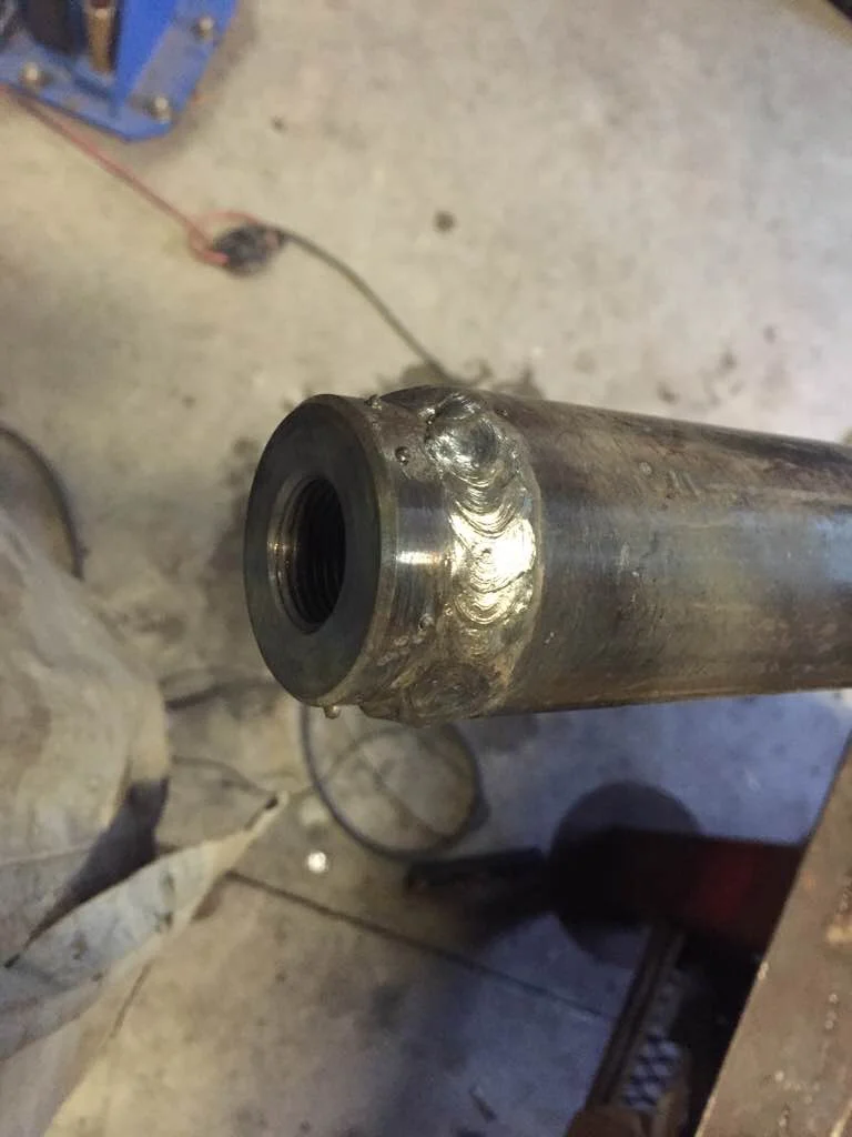

Threaded sleeve for the 2" .25 DOM tubing:
Getting the ladder bar all welded up:

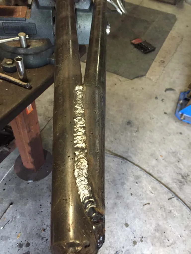

Added a gusset where the two tubes join for extra strength. Ran 1 bead w/ 6011 and a 7014 pass on top to make it look pretty:
Mounted up:
Axle mount:

Looking good man! I think I will be doing one soon and yours is a good one to work off
Thanks Ty!
Ya I definitely would if your gonna be playing in the rocks. I tried to document it as much as possible because when I was researching how to build one, I could never really find a good picture/ explanation on how to get it done.
Shoot me a PM if you want anymore pics or measurements!
