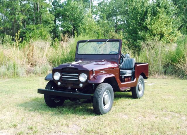

So here we go, "Sheriff" had electric wipers from factory. There are 2 toggle switches on exact location what we have seen on Sean's and Steves. Looks like PO replaced OEM switches with toggle switches, wires can be seen running through the hose and metal bits and pieces boys pulled through. Metal pieces appears to be brass or bronze.

Definately a market thing , yours must be tropical where wipers need to perform and dust was not a problem?
Let's call them luxury versions with some convenience upgrades, it makes me feel a little better.:flipoff2: And oh yes that explains my windshield latch system also. ;)
Interesting. Got pics of the wipers or the holes where they were?
