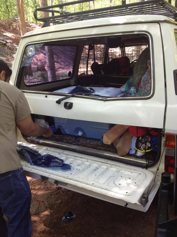

So I shattered my back glass and put a huge dent into my upper liftgate on Saturday when I came down hard off a ledge and my hi-lift (mounted to my 4+ rear bumper) sheared off the lower mounting bolt and swung into my hatch and basically kicked its ass.
Got an estimate to repair the hatch alone for $300 for just the sheet metal, no paint, no glass or glass install. Got a quote for $100 for labor to install the glass (once I found it), and estimated about $100 for the glass (minimum). Don't forget taxes, shop fees, and hidden surprises.
So, decided to check cruiserparts.net, and ordered the whole assembly for $531 shipped.They said no promises if it will come assembled, but I asked them to put a note in to send it whole, so I can paint it and bolt it on myself. I was really hoping to spend that $$$ on a locker... :-(

Holy cow! Love that the sticker is holding that corner of glass together
I've helped installed a rear window before. String inside the gasket. Soapy water. Screw driver to wrap the string around the handle and two people can get the job done. By pulling the string at the correct angle it pulls the gasket over the metal lip. Once that's done you're done.
