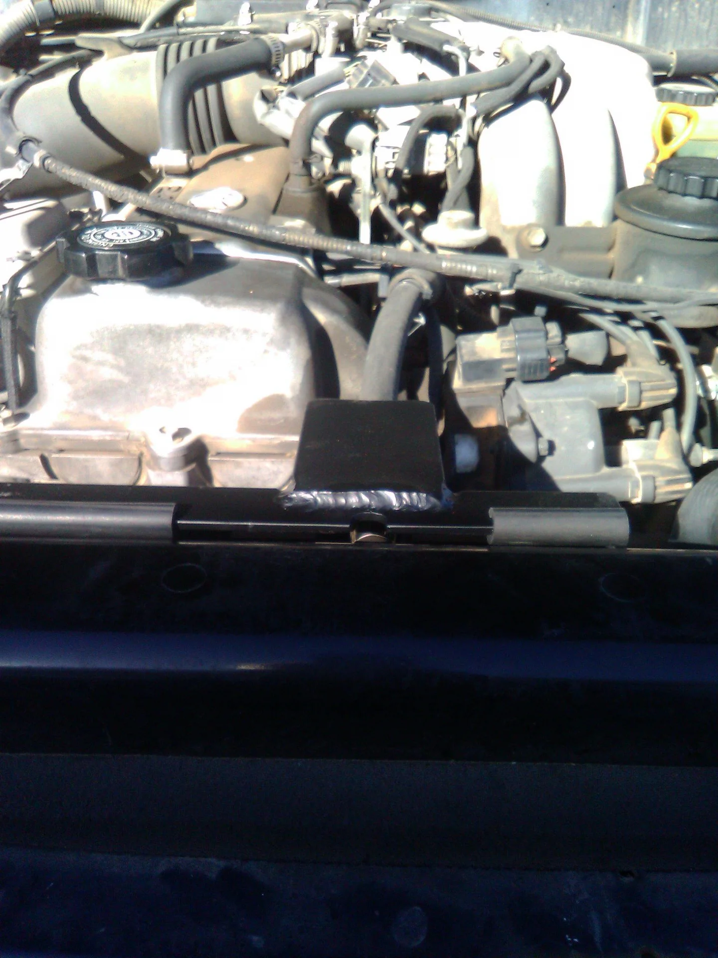

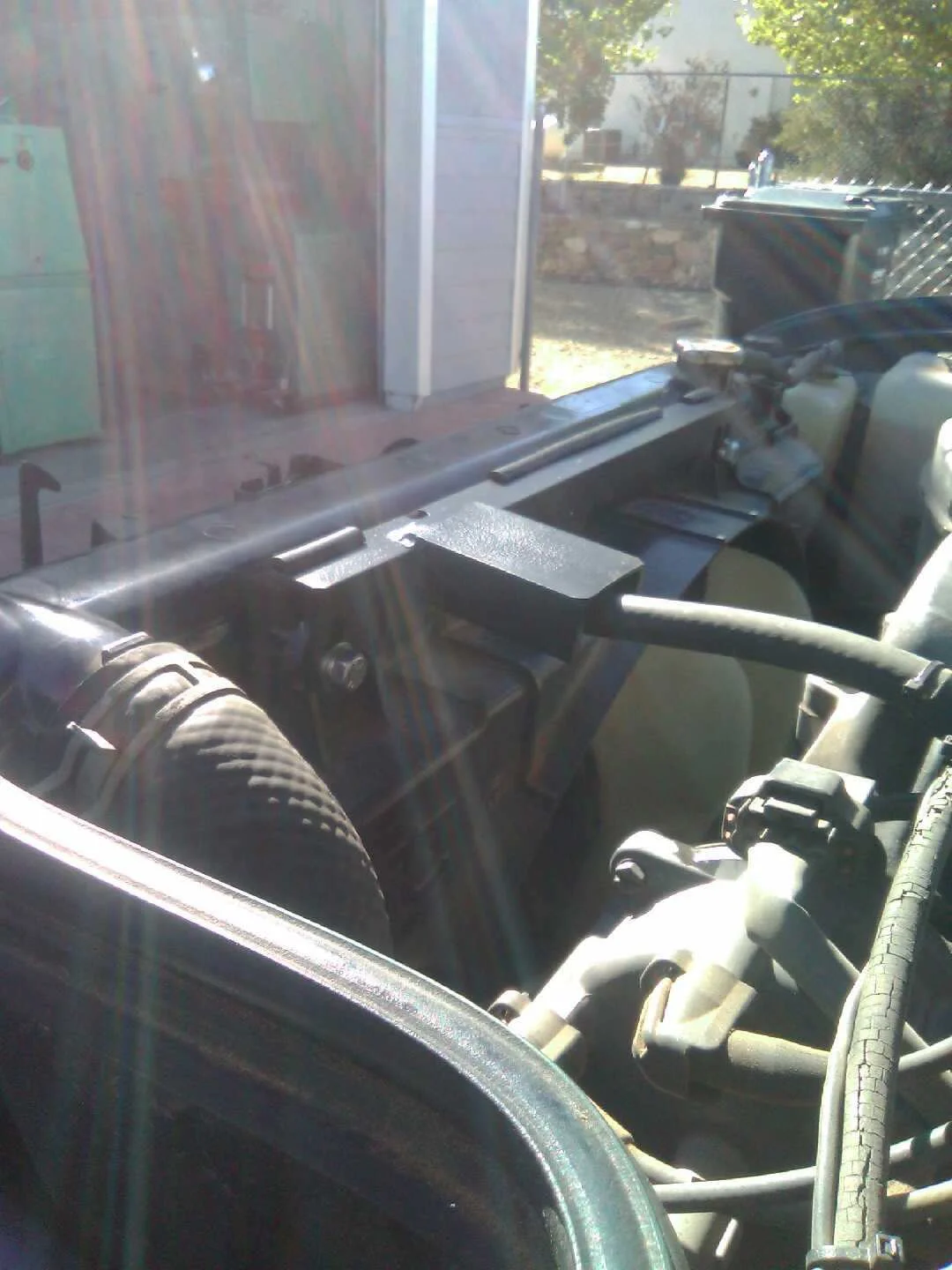

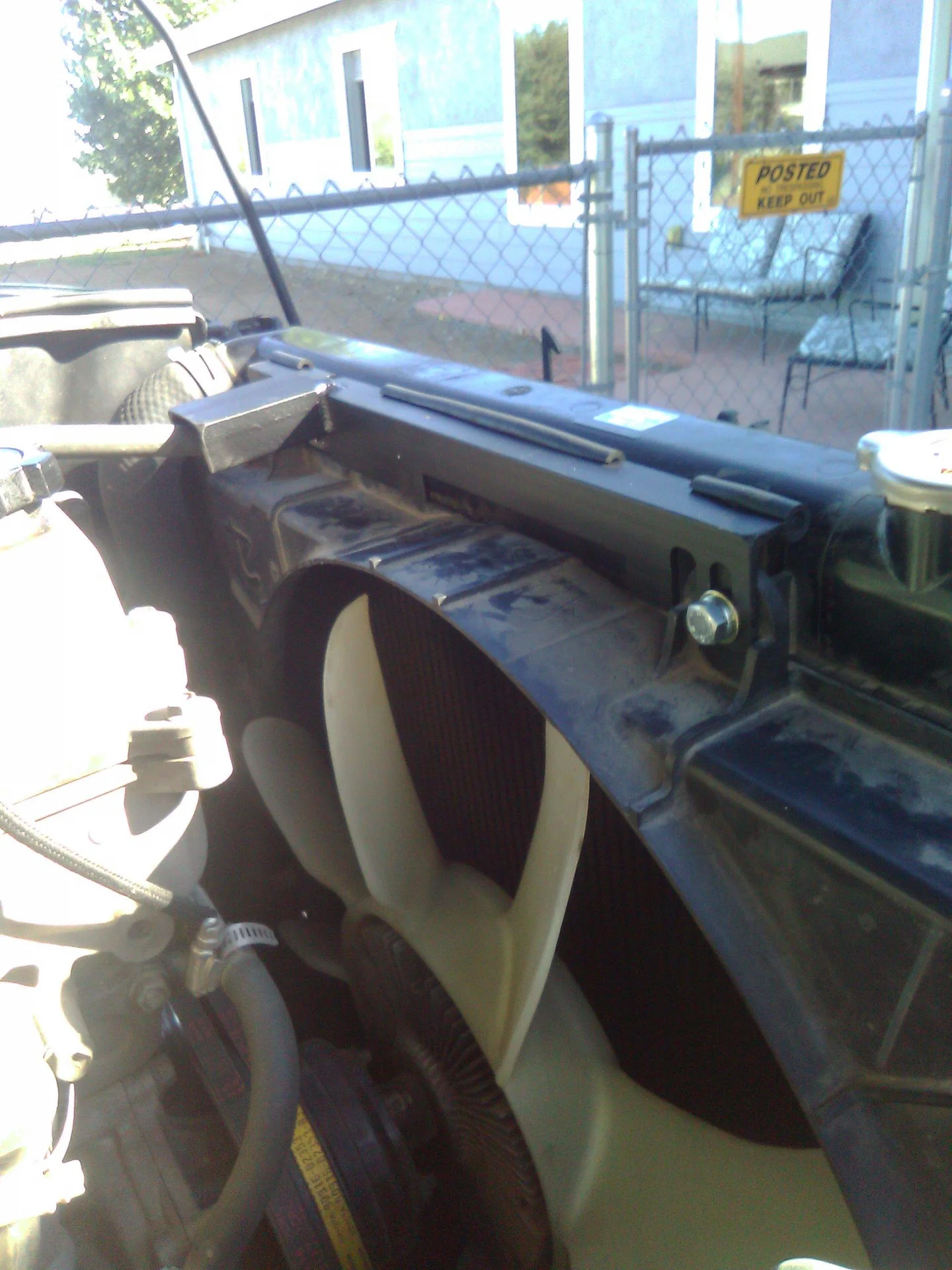

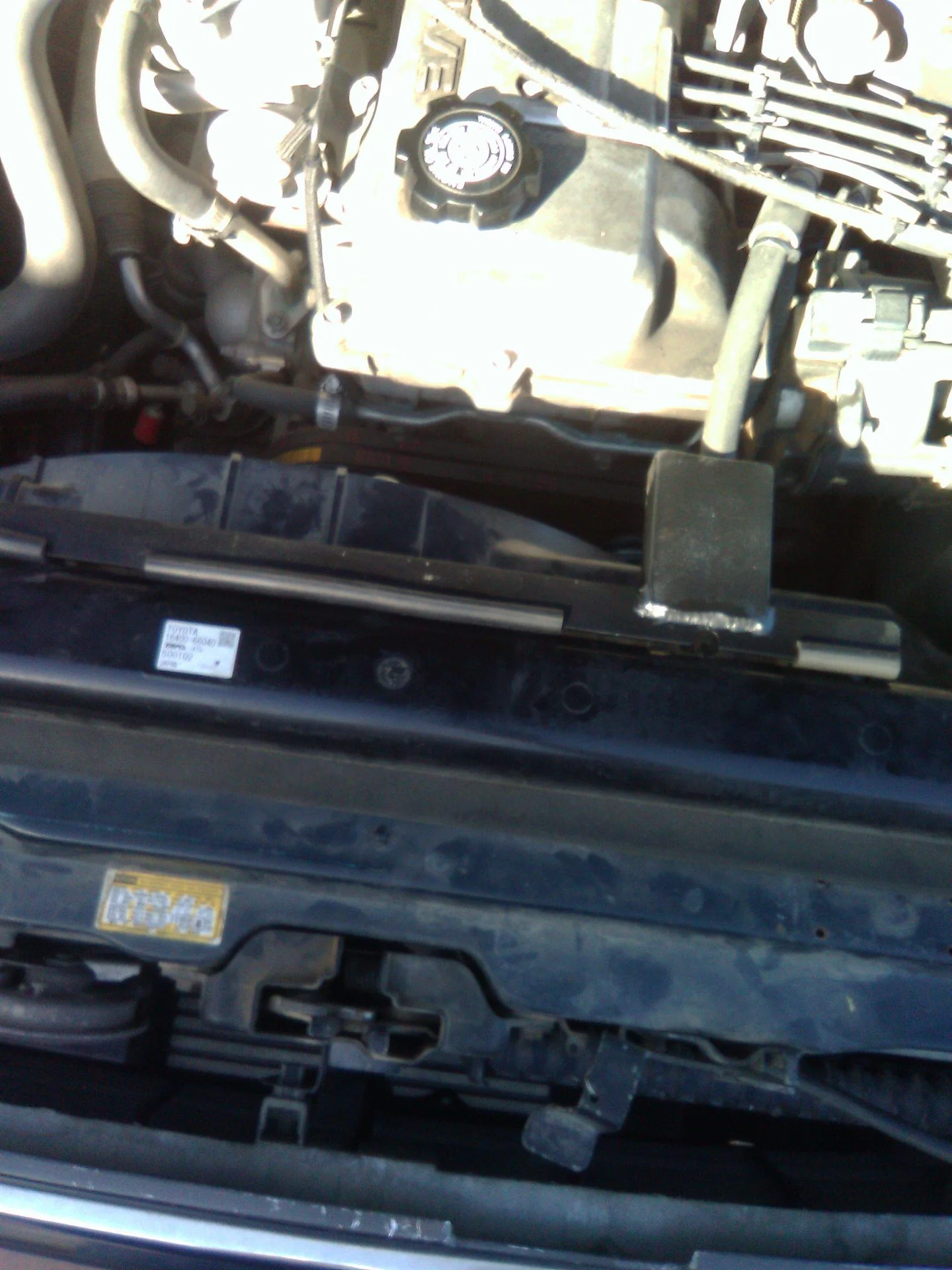

Well i was working on my truck today, and almost snapped off that plastic bypass nipple coming out of my radiator! This is a known problem that i have been meaning to make some type of protective guard for, but like most things i have been putting it off,
Well not anymore, i made a bridge piece that spans the distance between both the upper fan shroud bolts out of 1 1/2 by 1 1/2 inch angle iron, I then welded a piece of 2 inch wide channel to the angle iron to cover that nipple so there is no way i can now accidentally place my hand on that nipple and snap it off,
I've posted a few photos of my guard, and before anyone says anything about it being over kill, i use to work with people who could break an anvil, so that experience taught me there is no such thing as over kill

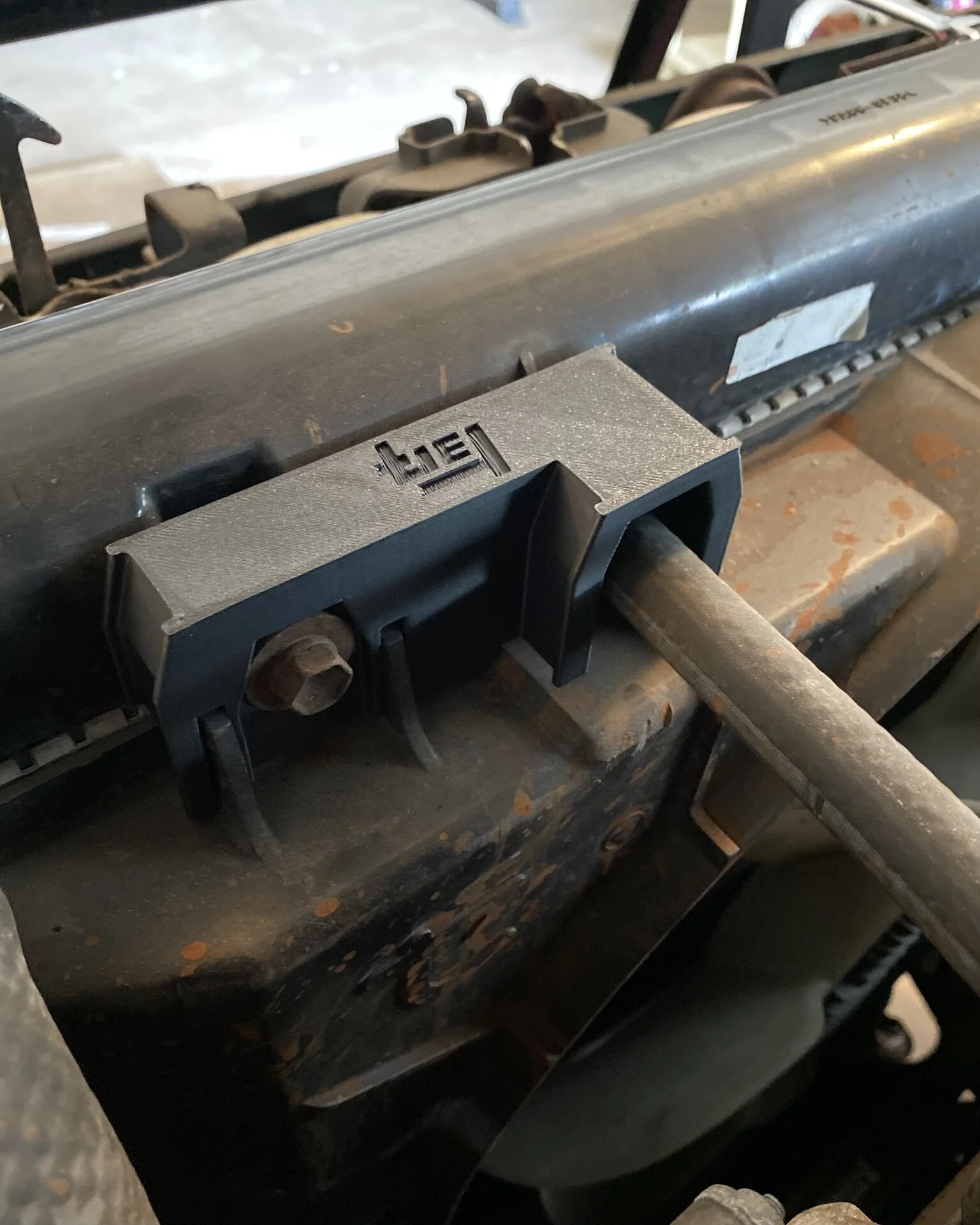

Looks pretty sturdy. I got this 3D printed one a couple years back. Definitely not as heavy duty as yours, but pretty strong and kind of blends in well.

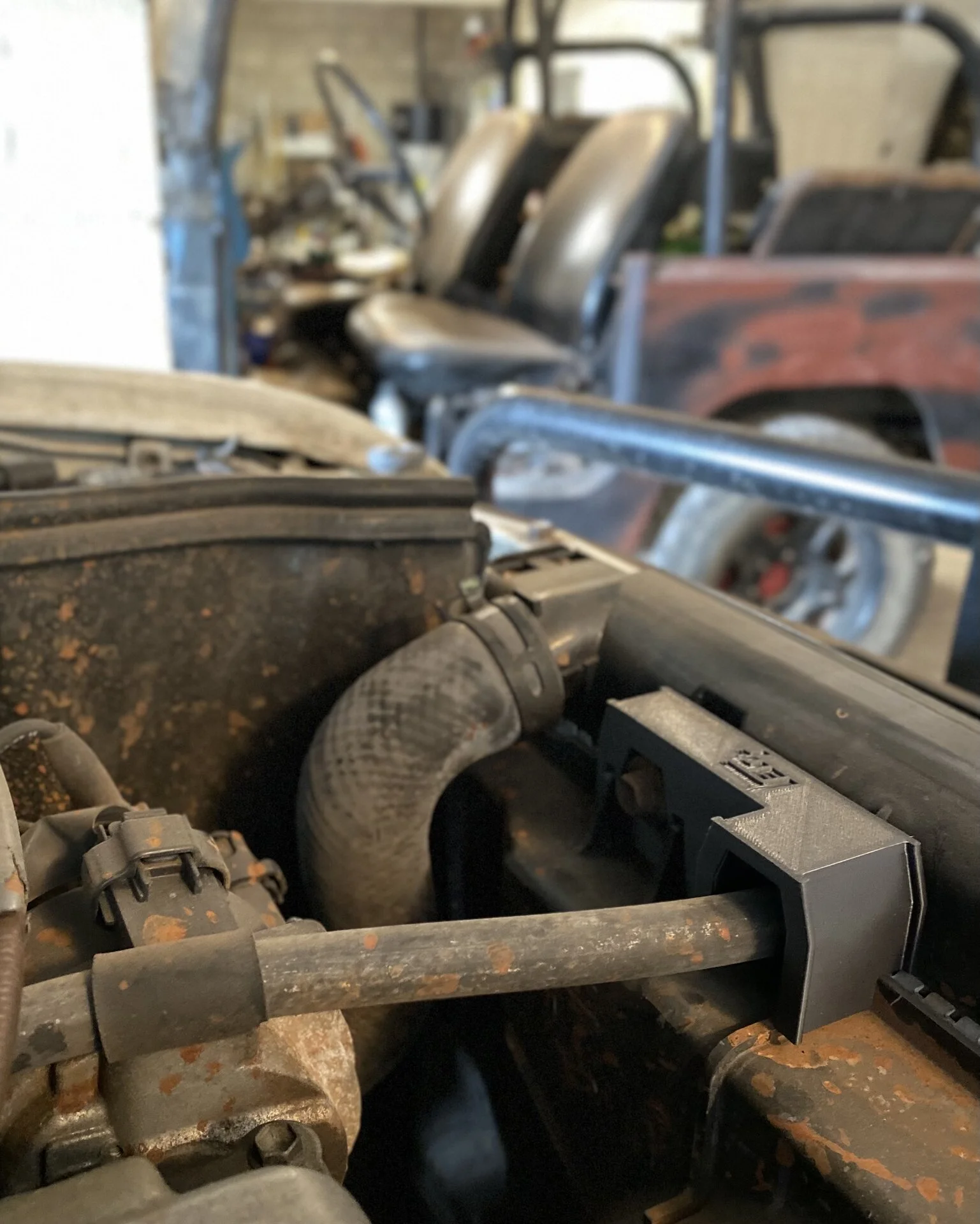

I lost my balance perched above the engine reaching for something and the Solvefunction protector performed as designed. Worked perfectly.
