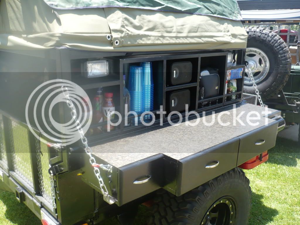

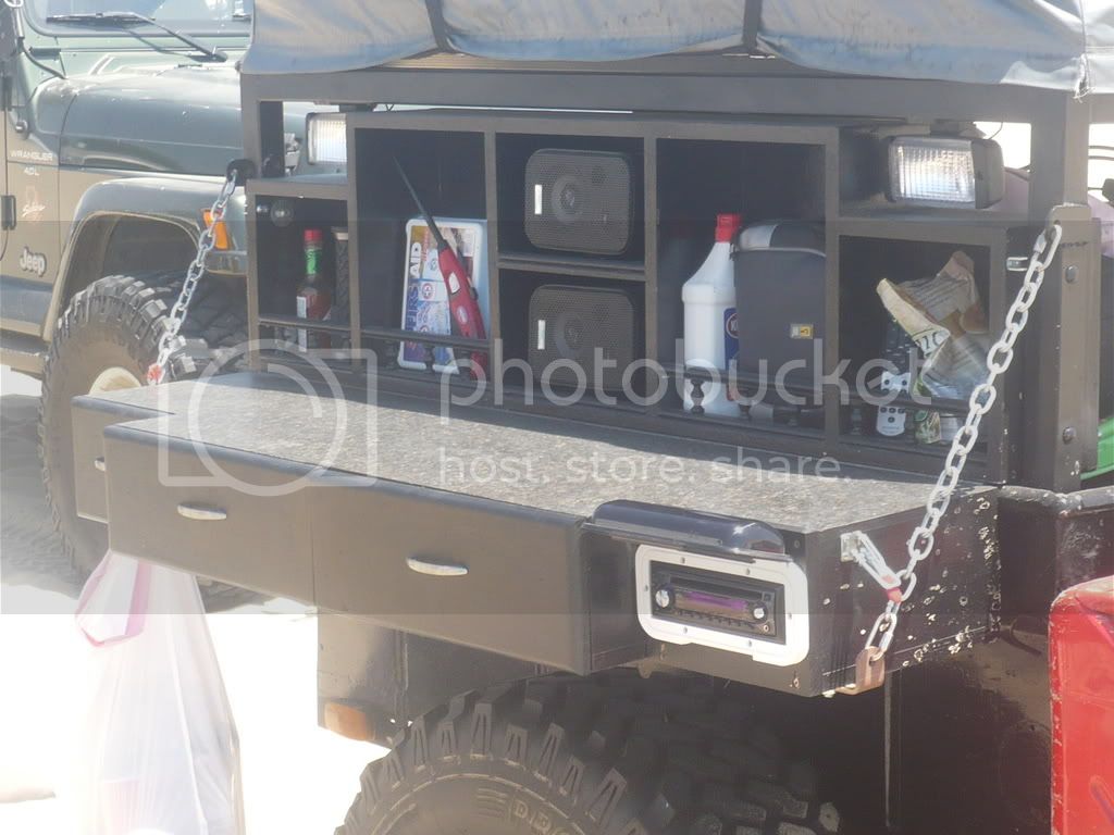

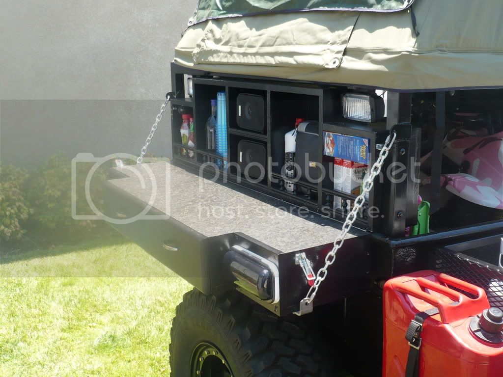

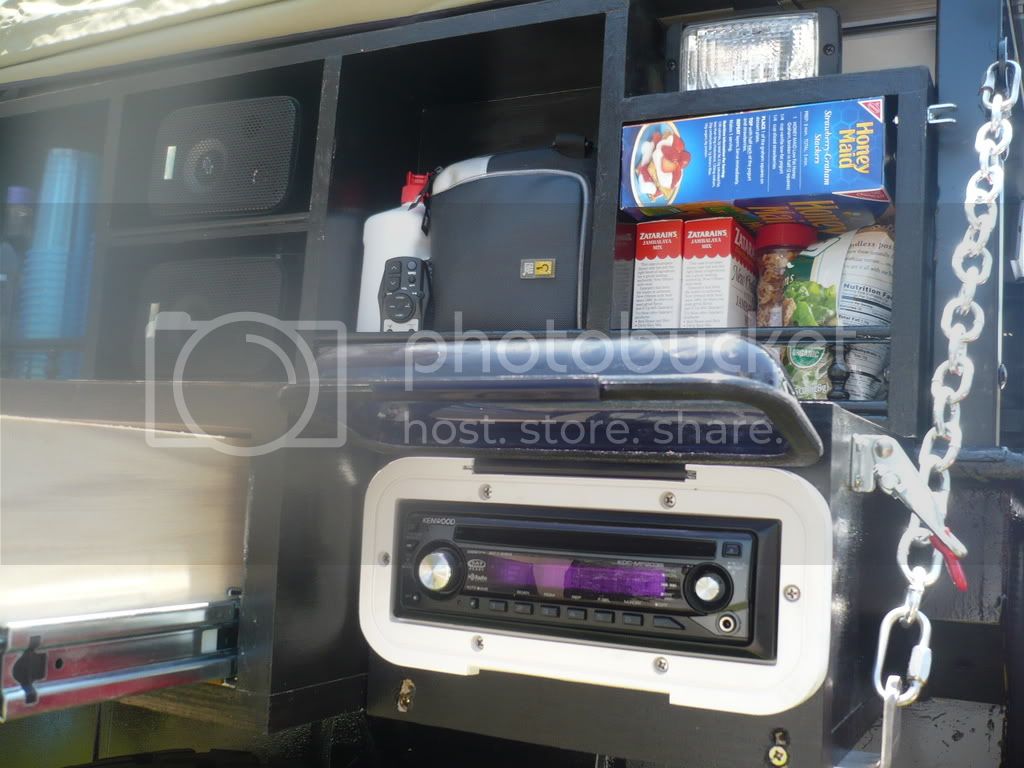

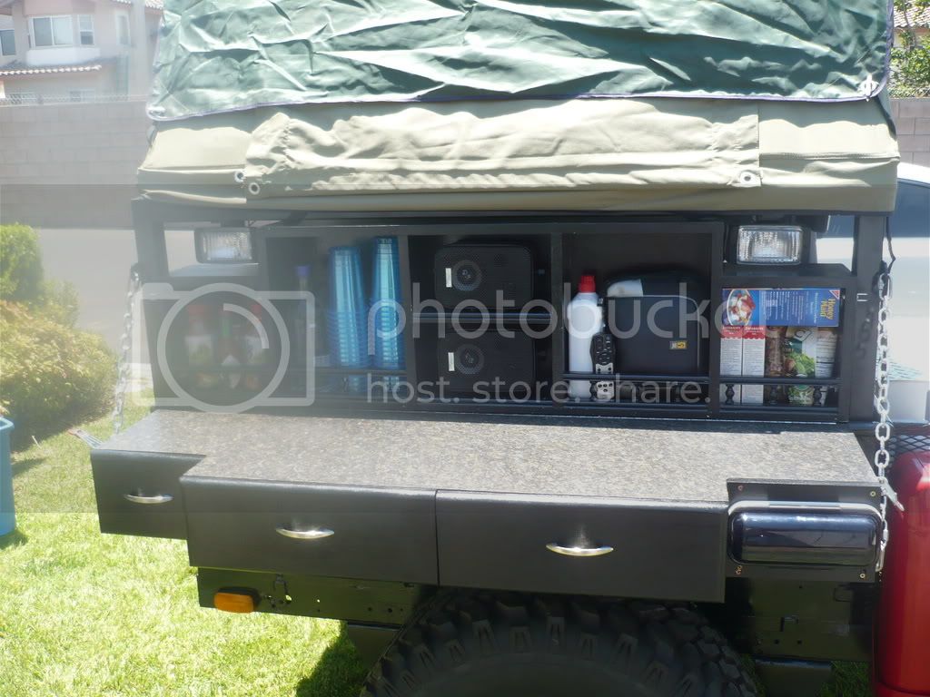

Here is how it came out. I used this last weekend in Pismo and it was really nice to have stuff organized and easy to access. I put in a stereo with a remote and aux output for the mp3 player. Total width turned out to be 12", so it is set 6" in the tub and it sticks out 6". I will post some picks with it folded up later.
That's freaking awesome!
dude i love it, im going to steal all your ideas if you dont mind
Looks Great !! How do you plan to keep the rain water from getting into the shelf area when it is folded up ?
Mark
Mark
Well, good question. It has a pretty tight fit when it is folded up. So I was going to try to put some weather striping around the edges of the shelving and see how that does.
Wow, so it just lifts up and clamps tight for travel?
How many hours you got in that?
Impressive, to say the least.
Yes, it is hinged at the top of the tub, folds up, and two clamps on each side secure it. It took about 24 hours or so.
SOmebody is drinking bloody marys :cheers: Nice work.
What other goodies you have on that thing? I see a hose nozzle, propane, are those 110 outlets?
Good eye on the cocktail. Those are 12 volt acc. plugs and a battery charger inside the box as well. 16 gal tank with a Shurflo pump, lights, faucet, hose. Just put in a reciever on the back bumper for a recovery point. Thats about it. I think I am done with it!
Does your truck charge the batteries in the trailer while you drive? I have trailer envy.
pretty sweet, is it heavy enough to effect balance?
Im sure it will tip easier with the extra weight at that height and location. I mostly do expedition style off roading 90% of the time, so nothing too serious. I got a trip planned next month that will fit into that other 10% category, so we shall see.
