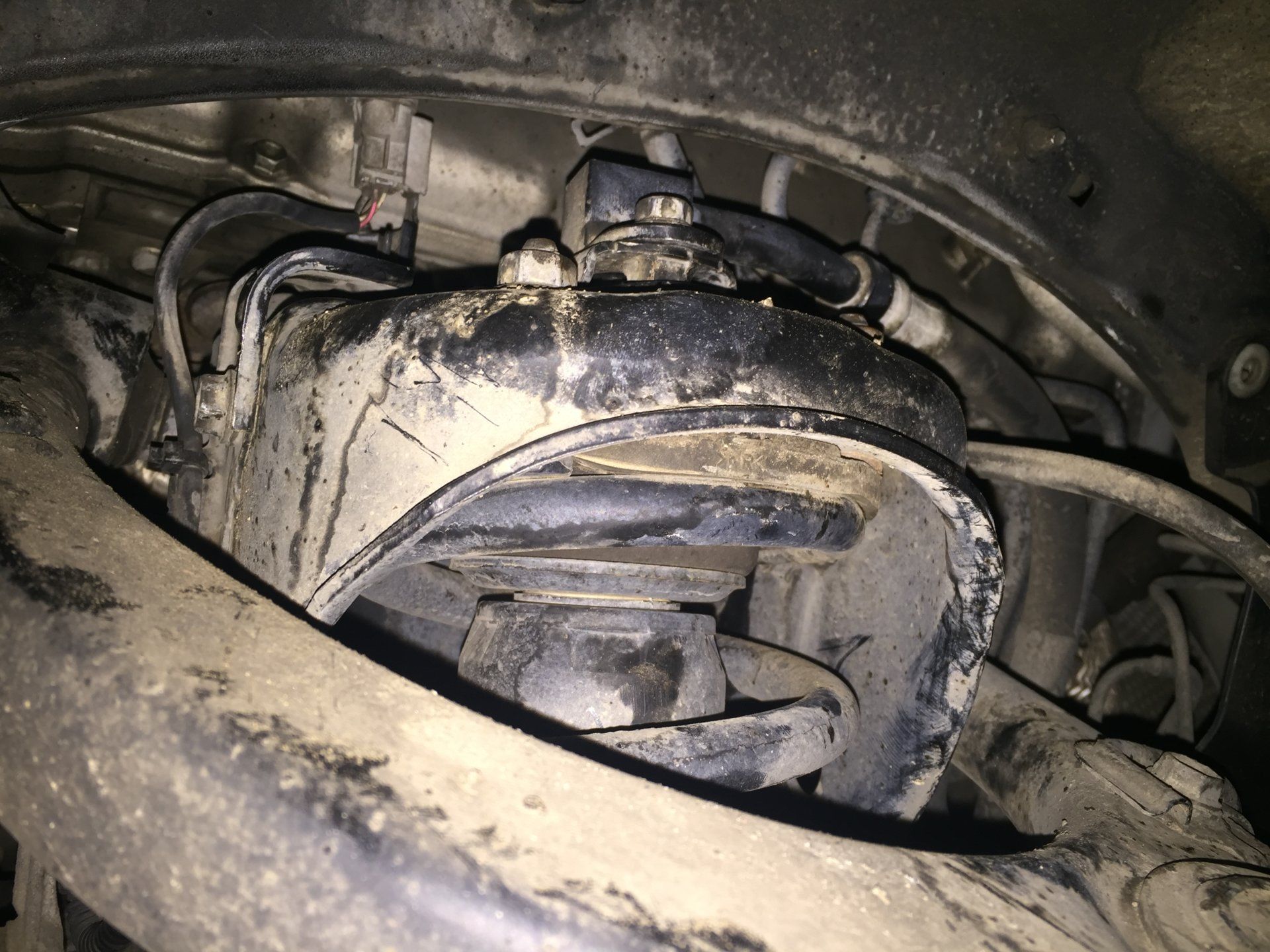

The part # for the front spacer is
43136-60020 from Toyota and I just used a 1” (30mm, technically) coil spacer for the 80, 100, 200 rear coil on mine, replacing the coil bumpstop at the top with it.

No more height. The AHC sensors determine the height your LX will sit at. I adjusted my sensors (per this thread) and @TeCKis300 (or whoever mentioned this idea first) reasoning seemed valid to me so I ordered and installed these to get the pressures somewhere closer to stock with the system.
Just installed yesterday and bled the system. No real difference except maybe those associated with the AHC flush (slightly smoother ride, if it isn’t my imagination).

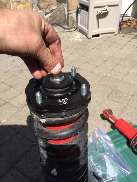

^^^Whoa, nice! Is that front spacers I see? What did you use, and do they just slide in without taking the coilover apart?

Lol! I didn’t unlock anything. Just maybe the first to do it. I used the Toyota spacer part # I posted above. It’s kinda hiding above the shock inside that top mount in the photo. No, they don’t just slide in.
I wanted to do the AHC flush as recommended and figured since I’d have to disconnect the line from the top of the shock to install this spacer, I’d do this before the bleed.
Warning: the shock is difficult to reinstall being longer after the spacer goes in at the top. We disconnected the sway bar and also used a long pry bar to flex the suspension down enough.

That could be a concern. Here are a couple of previously posted photos of the spacers...
I hope the small thickness of this is close to the amount needed to preload the coil & return the system to proper pressure but not too long to cause the shock to bottom out before the bump stop.

I don't see how this will impact shock travel. If anything this would limit up travel. Since this is a strut spacer vs a spring preload spacer. You effectively made your shock/strut longer while keeping the travel length the same. This will have no impact on spring rate from how I see it. This also means that it will have no impact on ahc pressure. That is unless the ahc height sensor is returned to stock, then I guess it is preloading the spring, since it's more compressed than before.
So all this does is give you a lift the difficult way, and limits your compression possibly but gives more down travel.
This will definitely impact ahc pressure. Remember that you don't gain any height increase if you just install the spacer. You'd just reduce the pressure (more compressed spring). If he hadn't adjusted the sensor, there would be less pressure. Since he adjusted the sensor to get the lift, he should be closer to normal pressure.

MTKID,
Thank you for your help yesterday. I was able to finish both sides. Just needed a LONGER pry bar AND loosening (NOT removing) the sway bar bolts (17mm) that is on the frame. This allowed it to droop that much more and it was so much easier!

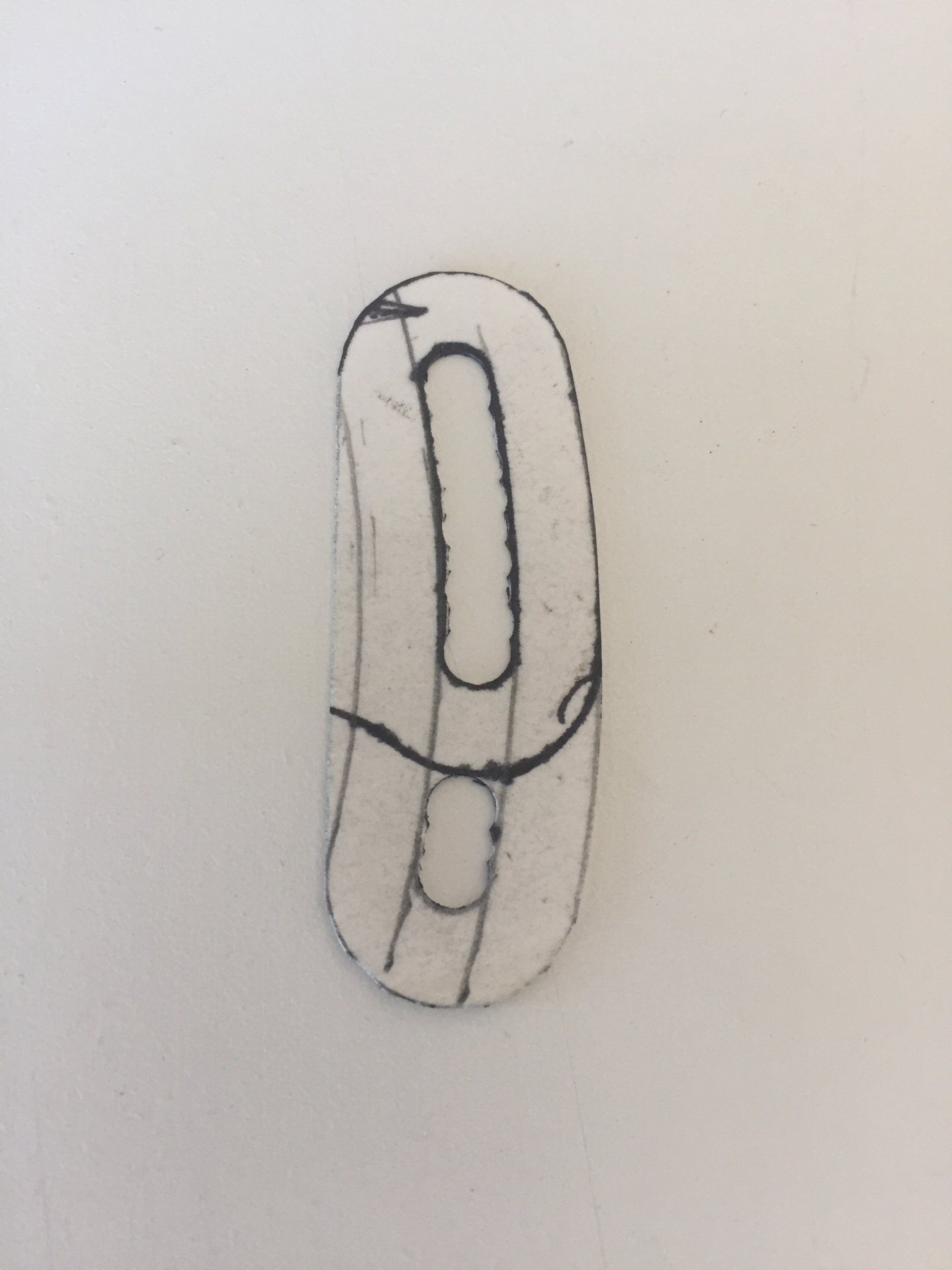

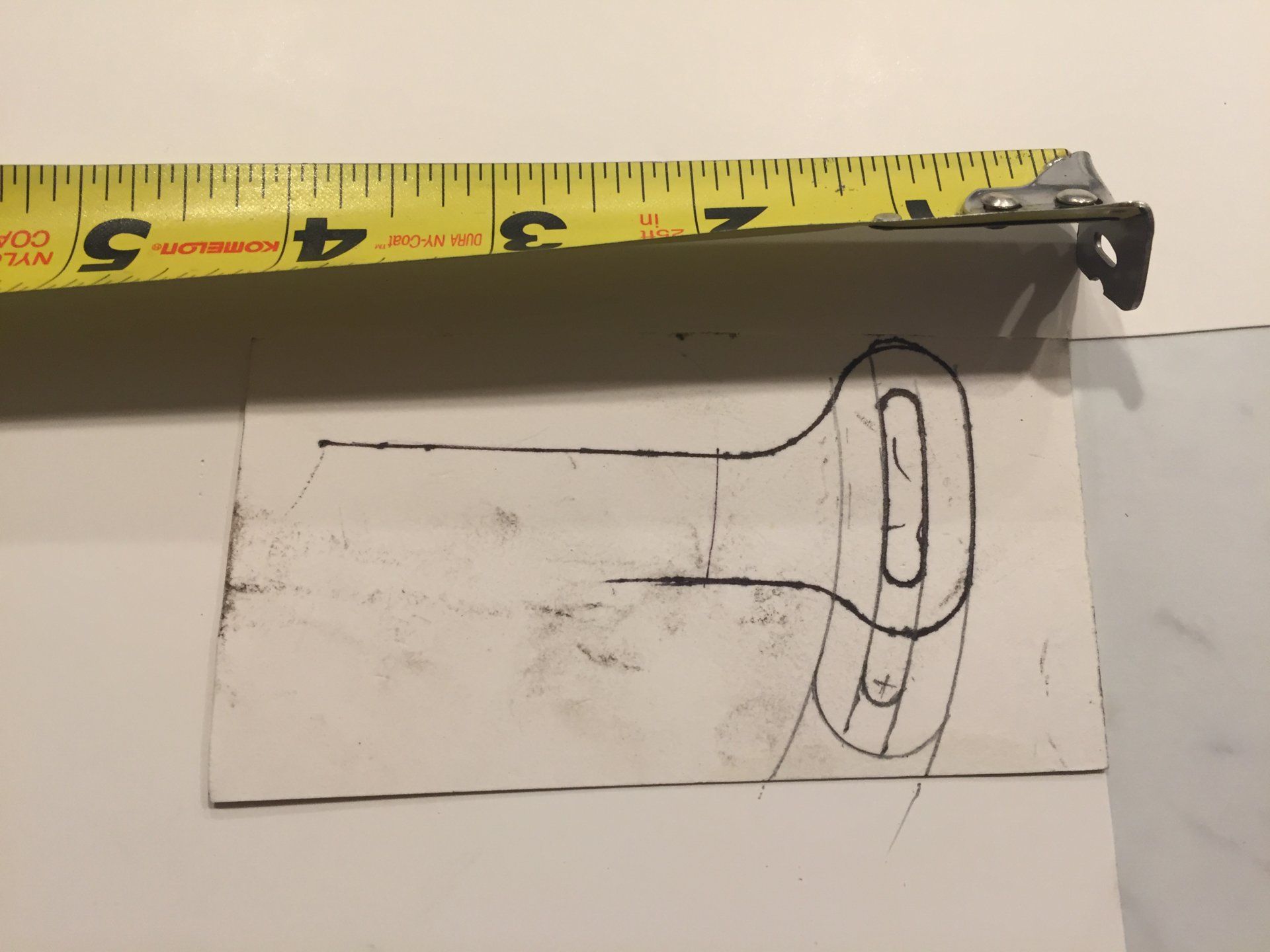

I got a wild hair to see how far up I could raise the suspension with only the sensors and I tried to make a small extension to adjust it further.
I started by tracing the existing bracket.
Then I extended it further down on paper and cut it out.
Then I made a couple of crude test brackets out of aluminum and attached them with the bolt at the highest point in the lower slot.
Hopping in and trying to activate HI would have it flashing & trying to raise into position but unsuccessfully indicating HI. It would say N but it wouldn’t drop back down. It would stay up higher than previous by about 1/2” to 5/8” but the display would say N, so it didn’t like it. Not sure if the safety limit is based on pressure or something else but this was a fail.
I may try another bracket bent back to allow the bolt to sit behind the bracket a little lower but not as low as test #1.
Fun tests.

Because the entire bracket is attached at the other end and has some more complicated shapes at the other end and I was trying to do it quickly so I left the bracket attached to the truck and only traced the end. If it did work well to slide it down just another 1/4” or so then maybe it would be worth it to take it off and trace it and do exactly that. Make a new one with the slot a little longer. The way I did it, I bolted two bolts through the stock upper slot to secure my test plate and attached the sensor bolt through the lower slot. It was the simplest way I could think of.
I did just do the fronts. I figured if it worked then I could easily do the rear sensors. And I did both fronts to make sure it wouldn’t fail because one side was higher than the other. On the other hand, I wonder if it could have failed because I didn’t do all of them at the same time. I suppose this is possible but I don’t think likely.
