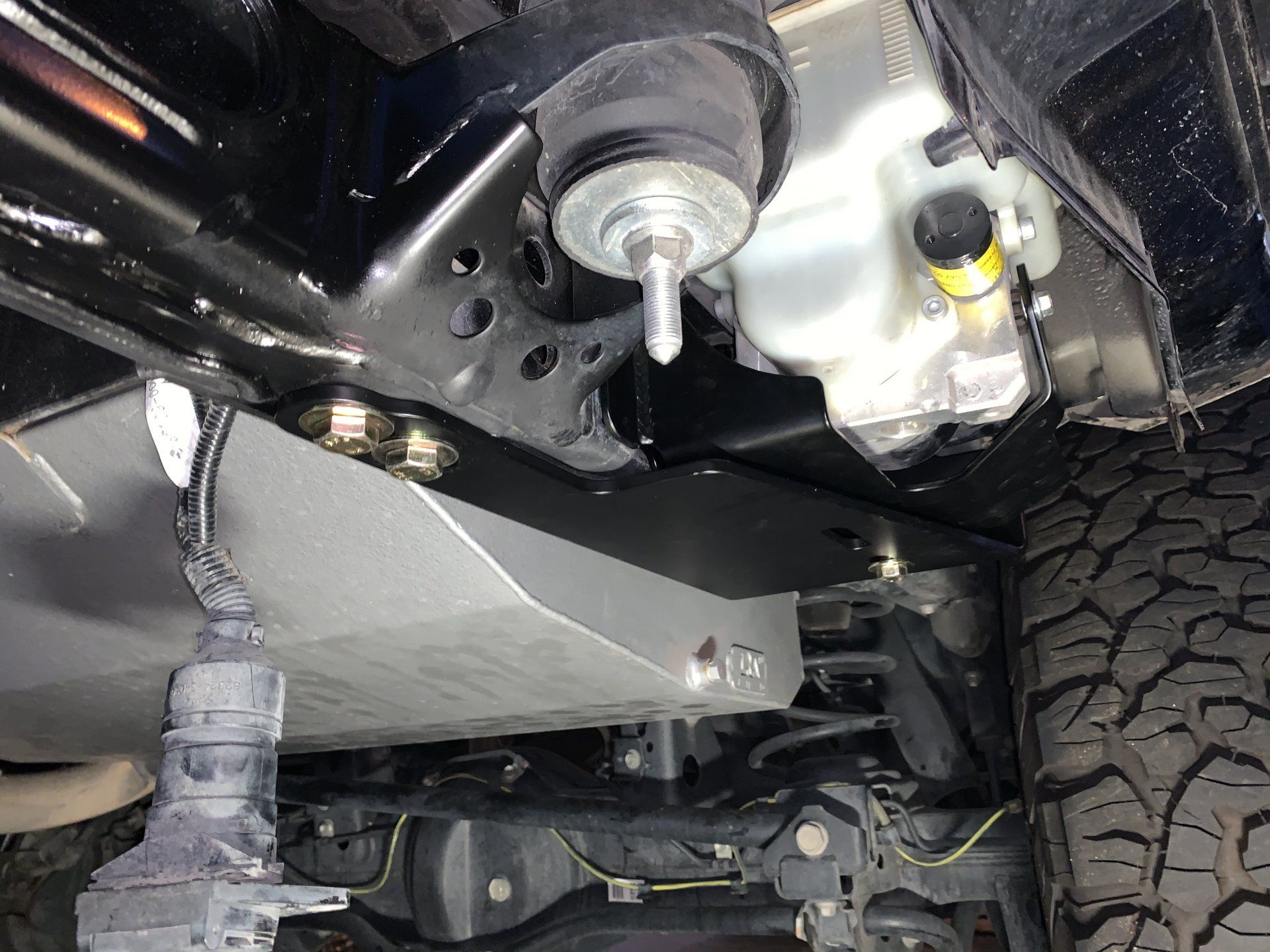

Tools -
12 mm socket on a 2" extension to remove all the skid bars. As I didn't pull the brackets I didn't need any weeble wobbles. I already had removed side steps a couple years ago.
The globes use 21mm socket. I used a 12 point mainly, but I did round one trying to get it off and had to resort to a 21mm 6 sided impact socket for that one.
For three of the four globes I needed an 18" breaker bar + 18" pipe. I used about 12" of the pipe, so around 24" of lever.
The plastic pry tool to mess about with the washers.
A qt size manual transfer pump.
3/16" id x 5/16" od pvc tubing
10mm open end for the bleed valves
1 gallon water bottle for waste fluid
Oil drain pan for sphere fluid (only got maybe four oz out of the spheres)
Torque is 111 ft lbs on the spheres
49156-60030 is the backup washer part. one per accumulator is required.

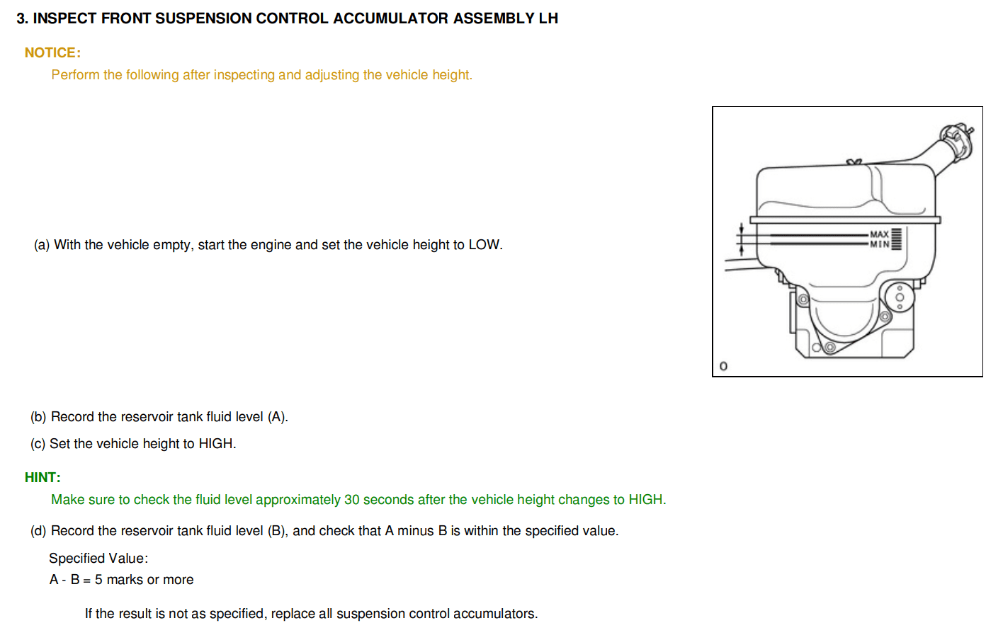

Saw this while I was scrolling thru. Similar to the marks count that can be done on the 100 series.
That's from a LX570 2009 manual, so I guess maybe? My reservoir is too dirty to see those marks. First time I've seen that section in the manual.
Just did a full flush and no marks on my reservoir. I did clean it up with some simple green and snapped a photo for reference [emptied]. Interesting though, does that photo show the backside of the reservoir as the neck is on the right?
Yeah, I think it's the back side of the reservoir. Earlier step was 'remove fuel filler pipe protector' . . . we just need to know how far apart five marks are . . .
