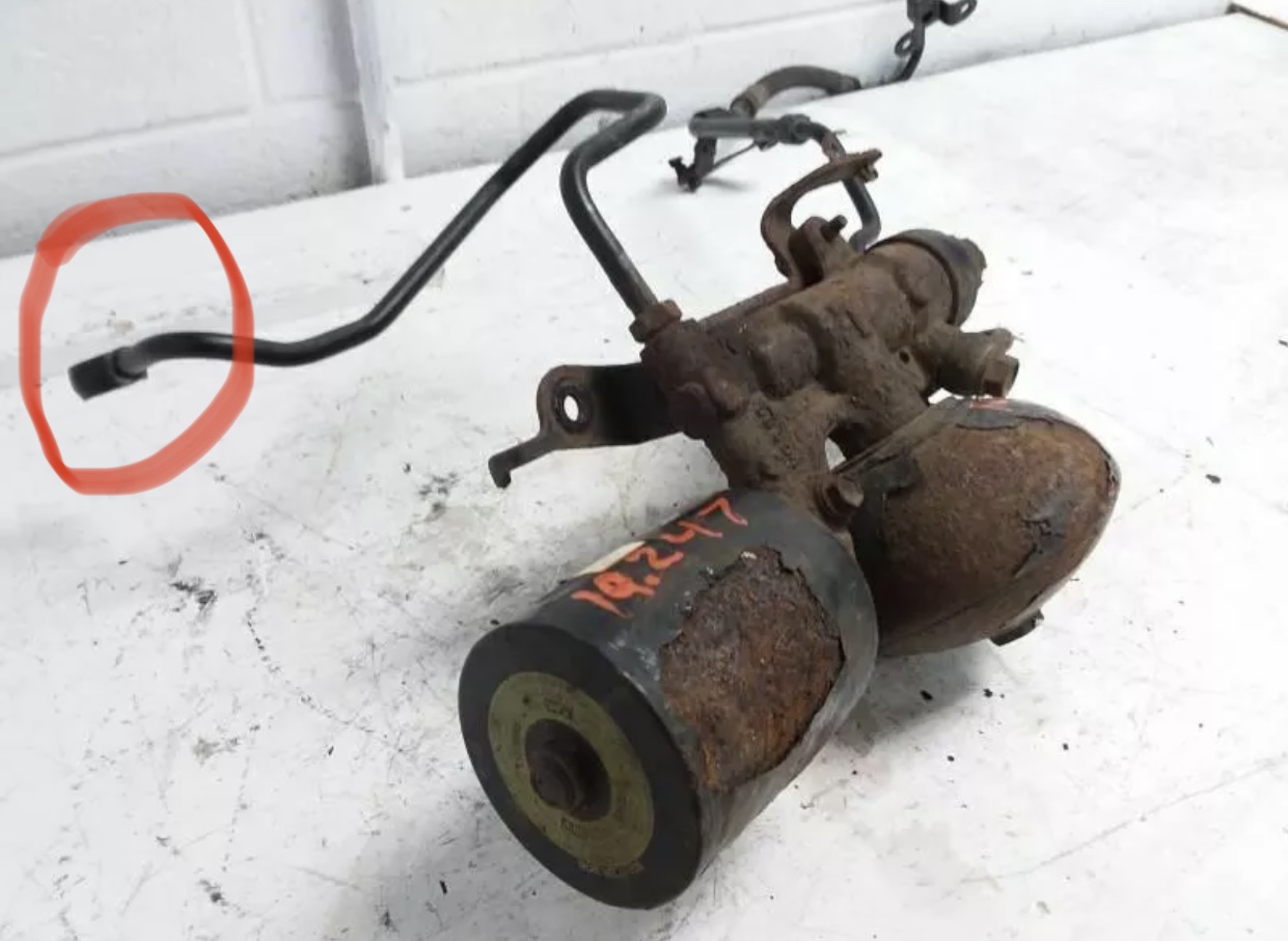

Anyone know where the end of this tube is (circled)? Another option I can see would be to disconnect the circled area (leaving the part connected that I can’t remove) and replacing that tube as well as the actuator assembly.
I’ve reached a “I think I’m screwed” place and could use some thoughts.

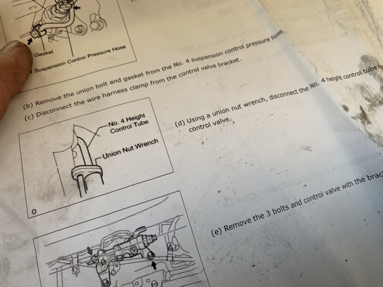

I can’t get this nut loose to save my life and think it’s pretty rounded at this point. Here’s the FSM step:
It’s this connection (pictured is my replacement assembly):
Of course this is right up against the gas tank so I don’t really want to take flame to it. I’ve doused it in penetrating oil and have let it sit for hours but still nothing.
Any suggestions? Other than this one nut it would be a pretty easy install.

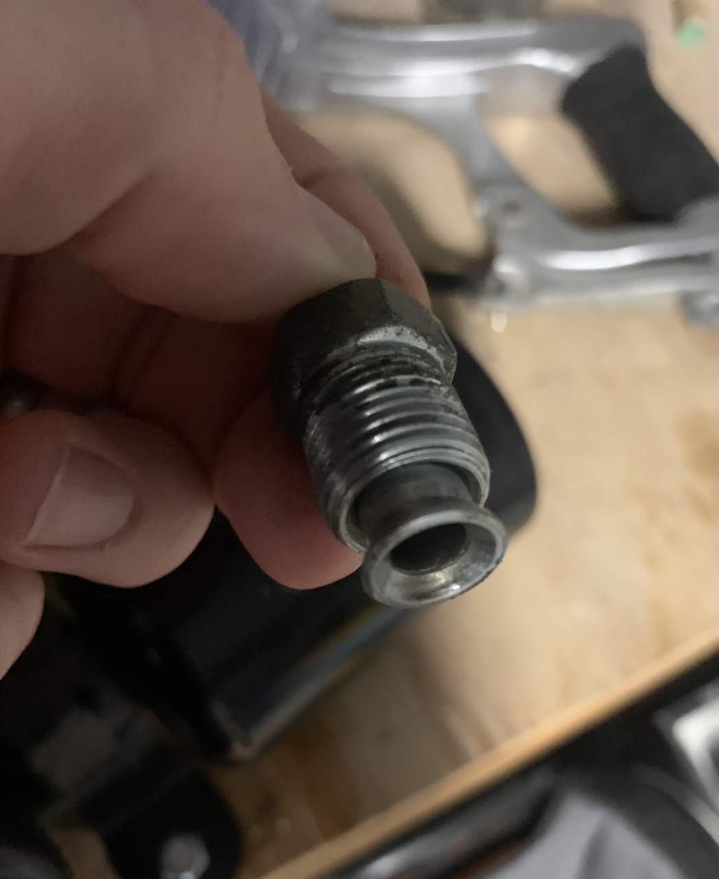

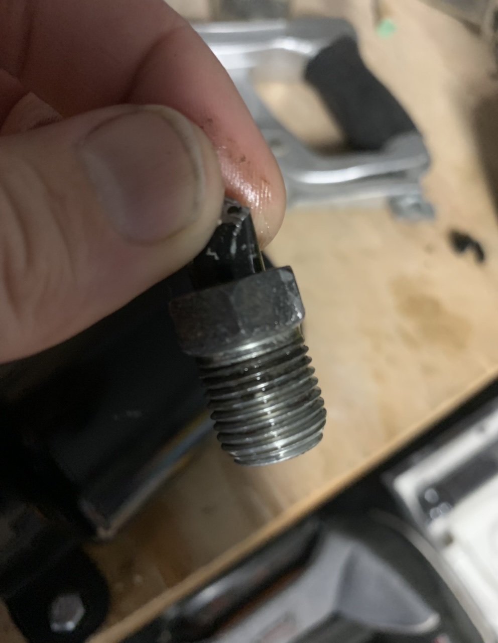

The nut I’m having trouble with is actually a bolt, this one is from my replacement assembly. I’m holding it by the pipe that was cut to remove it from the donor vehicle.
Once unscrewed from the actuator it slides up the pipe but can’t be removed as the pipe has a flange at the end:
So if by some miracle I’m able to release the stuck bolt it’s already so rounded that it’s likely unusable with the replacement actuator. But since the pipe is flanged I see no way to replace it with another pipe bolt (or whatever it’s called).
Thoughts?
Thoughts?
From this angle, it appears to be some sort of a "banjo" bolt type fitting. This type of hydraulic system is typically most used in brake applications.
Sorry, looking at your pictures more, you are more than likely going to have to source a new tube(metal hydraulic line) from Lexus.
Assuming the other end of your spare part isn’t trashed, it seems like your plan of separating at the next junction up should work, and would replace that nut. I’m guessing since you haven’t done it, that the pipe is inaccessible.
I agree with bwel, that I suspect for a shop that specializes in hydraulic lines, coming up with some solution would be possible, whether that’s replacing the entire tube, or cutting that end off, then having a shop create a union fitting for the old pipe and an extension to replace the cut piece. Assuming the pipe isn’t some real oddball size.
That's kind of what I was originally thinking, but if you think about how small the passage ways are in typical banjo bolt fittings. I just don't see many or any "off the shelf" aftermarket solutions being able to handle the volume that the ahc system uses. But I have no idea what that fitting looks like, fortunately mine isn't in that shape. Then again it might not be that "special."

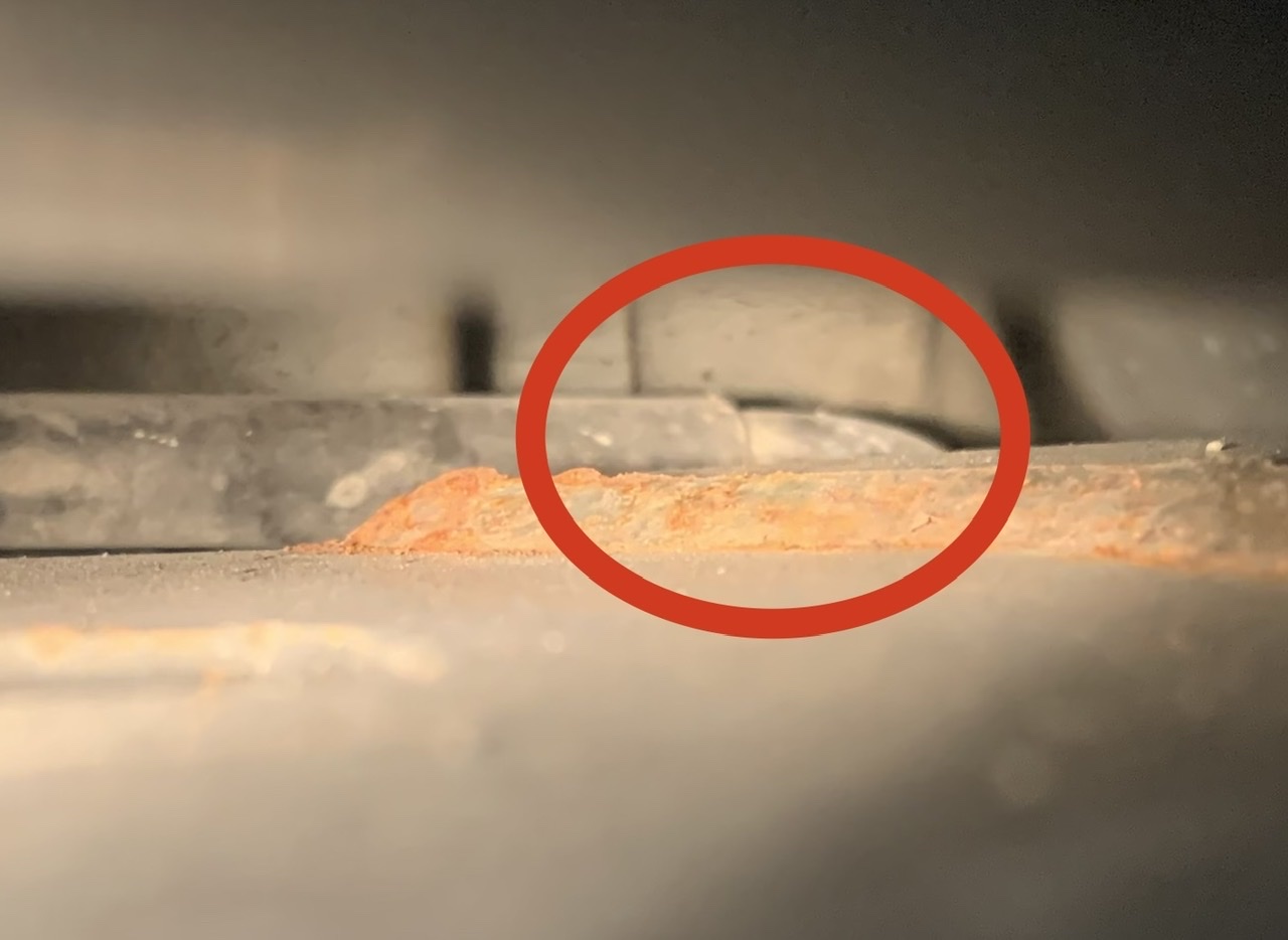

Trying to find where that pipe goes, as based on the picture I found above it’s not a long travel (though with quite a few bends), in case I need to replace it entirely.
I found it, running between the frame and gas tank, looks like that banjo connection is somewhere right above the tank.
So, a potential drop of the gas tank might provide access. Not something I’m interested in, at least not doing it myself.
But along that pipe it looks like there’s a connection point, which looks like it could be accessible once the assembly is removed.
If so, maybe a new pipe can be attached at this location.
As best I can tell everything is directly under the rear passenger foot well.

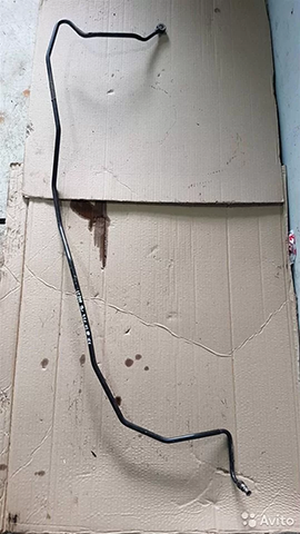

At this point I might not be helping anyone but I figure I'll keep posting my findings in case anyone else ever deals with this. As it turns out, the image I found above that shows the tube still connected to the assembly is for the left rear ACH assembly. Here's the one I'm dealing with from the right rear actuator assembly:
A little different. :O. According to the schematics there are 4 places it's clipped in as it snakes through the body from the right back to the valve control unit over on the driver's side. So that's not going to be replaced. (Nevermind the fact that it's a $600 tube!)
I'm hopeful the shop I take it to in a couple of weeks is able to come up with a solution.
I noticed and thought your example was probably from the other side, but didn’t want to be a Debbie downer (or be wrong). The left rear actuator doesn’t have far to go to get to the height control valve, hence the short pipe in the other image.

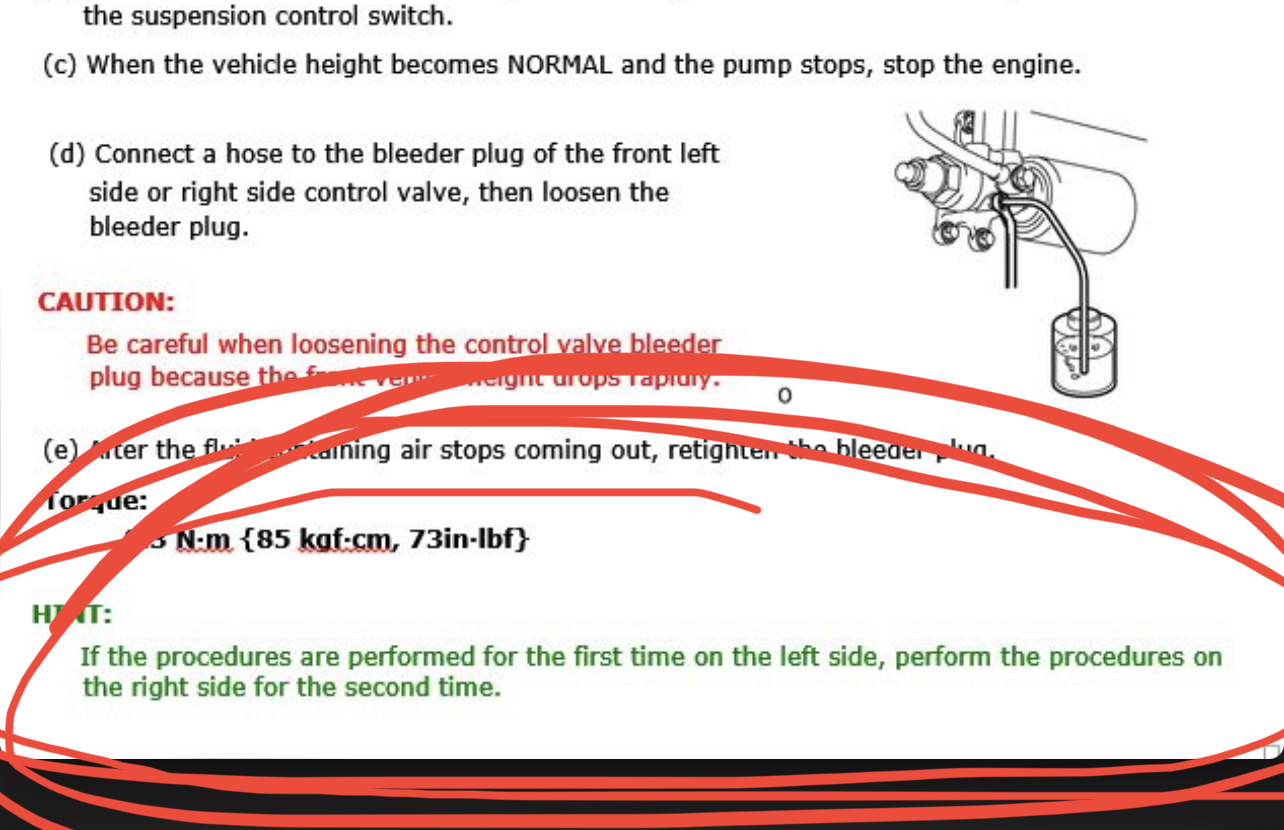

Have you seen this hint?
“If you perform the left first, then perform the right again.”
Which means if you bleed passenger side first, you don’t have to bleed driver?
This would also suggest LF-RF-LR-RR
