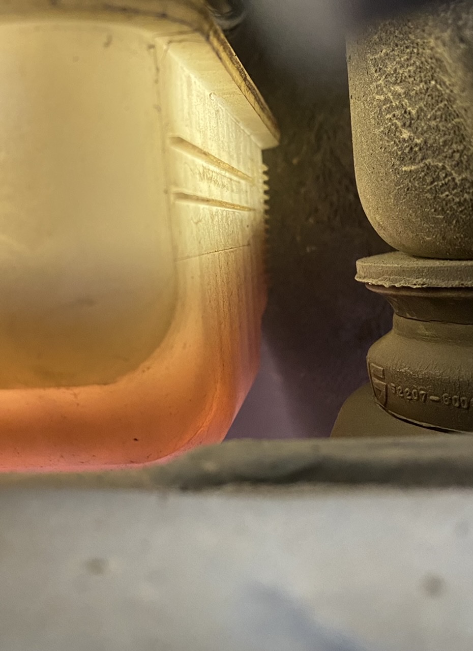

Am I not seeing this right, or is your fluid really low.
You can shove you camera in the fill/inspection hole to see the front marks as well as a decent shot of the rears by climbing underneath and working from the spare tire area.
I’m not sure if this test is a useful as in the 100… with 7-14 (?) marks being the your are still okay, only having 5 to work with on the 200 makes the test harder to compute.
I never had a 100, but the manual for AHC in the 100 is more detailed and Techstream has more tshooting values, as well as the easier to compute graduation marks really makes it seem like Toyota purposefully made AHC harder to work on.
Here’s a picture of the rear.
It very well could be low. As stated, my driveway is far from level. In N, the fluid level is just under the max line. A flush is definitely needed as the fluid appears very dark. I'll get some ordered this week. This LX has 110k miles and no apparent history of an AHC flush. I have no complaints with the system and everything functions as it should and the ride feels great, so I'll just stick to a flush for now.

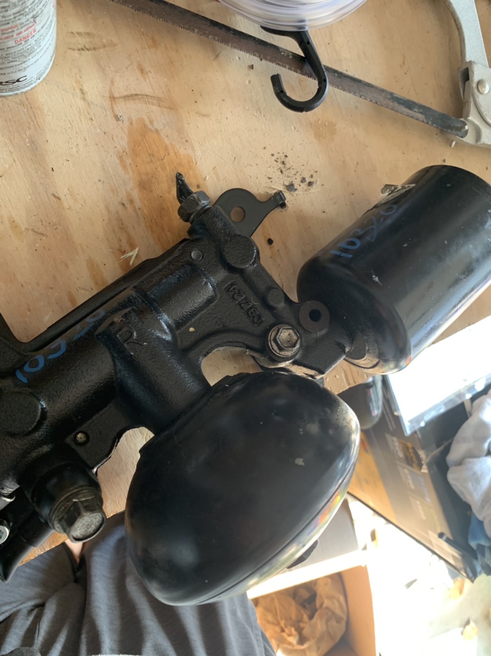

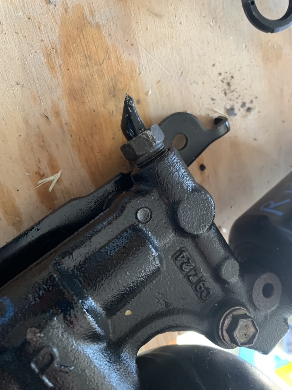

I’ve reached a “I think I’m screwed” place and could use some thoughts.
I can’t get this nut loose to save my life and think it’s pretty rounded at this point. Here’s the FSM step:
It’s this connection (pictured is my replacement assembly):
Of course this is right up against the gas tank so I don’t really want to take flame to it. I’ve doused it in penetrating oil and have let it sit for hours but still nothing.
Any suggestions? Other than this one nut it would be a pretty easy install.
So you’ve put a closed end wrench on it? And Put a pipe on the wrench and given it some extra leverage?
This has got me so pissed. My entire AHC doesn’t work because of this one unbelievably inaccessible nut.
It’s sitting directly under the right edge of the backseat passenger side. My only thought now is to try and come at it from above by going through the floor. I have no idea what that would look like.
I don’t have much help on the nut, but just wondered. Did you test the new to you accumulator. Does it pass the FSM tests?
Yes, passed the tests! Was hopeful to have a repaired system today.
I put everything back together, not sure what my next options will be. There’s an independent Lexus shop nearby, might take it there and see if they can get the assembly out.
