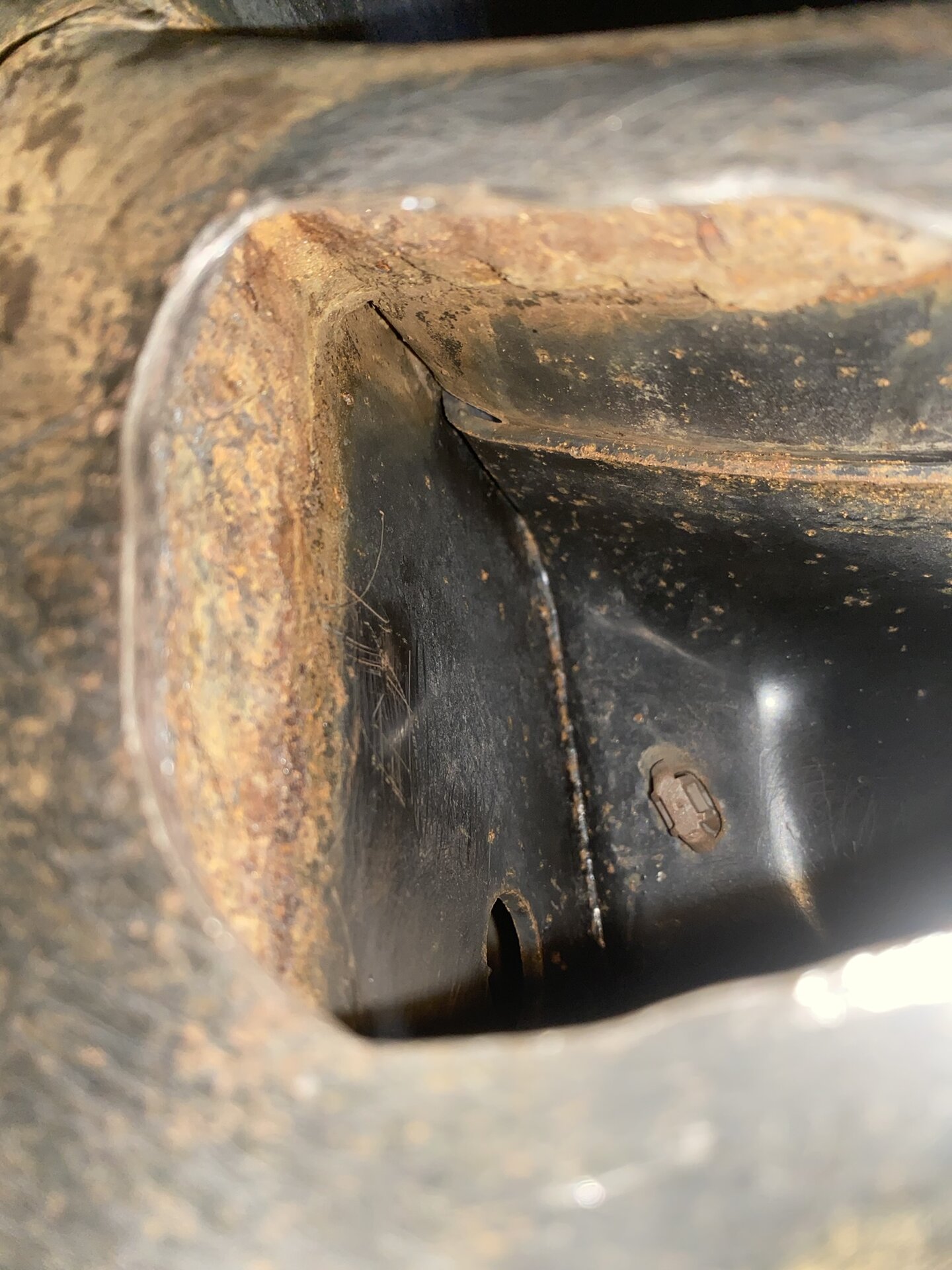

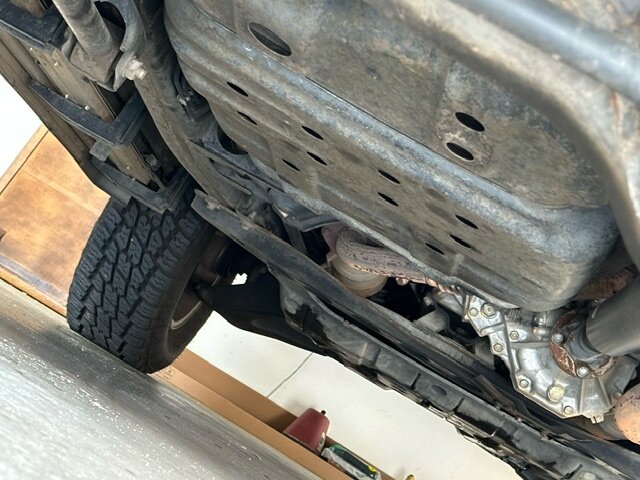

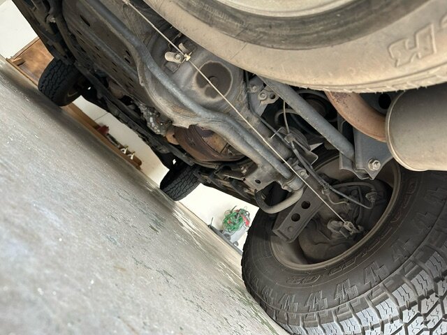

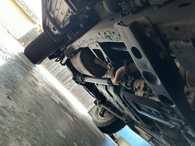

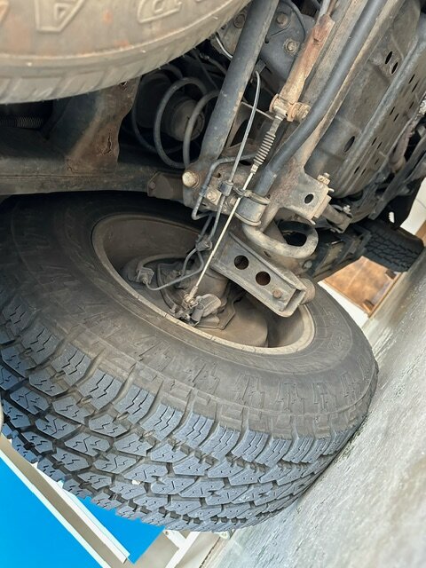

looking at 2004 lx470 several hours from me, price is pretty great honestly. body and interior look clean. I asked for frame pics. I thought it looked okay, except for the first. What do Ya'll think? 250k miles
Looks pretty decent to me. Not the greatest pics but at least there's not a bunch of black paint or undercoating hiding things.
I think I’m going to get it with the assumption that it needs some frame work. I’ll post if it works out
Literally 9 out of the 10 I looked at in my area of the Mid-Atlantic had the same rust in that rear crossmember with barely any rust elsewhere on the chassis. Have never investigated the cause.
I would't be surprised if you had to do very little rust prep. Actually looks really good.
I too had to go 8 hours drive to find a rust free chassis. Everything affordable was cruchy

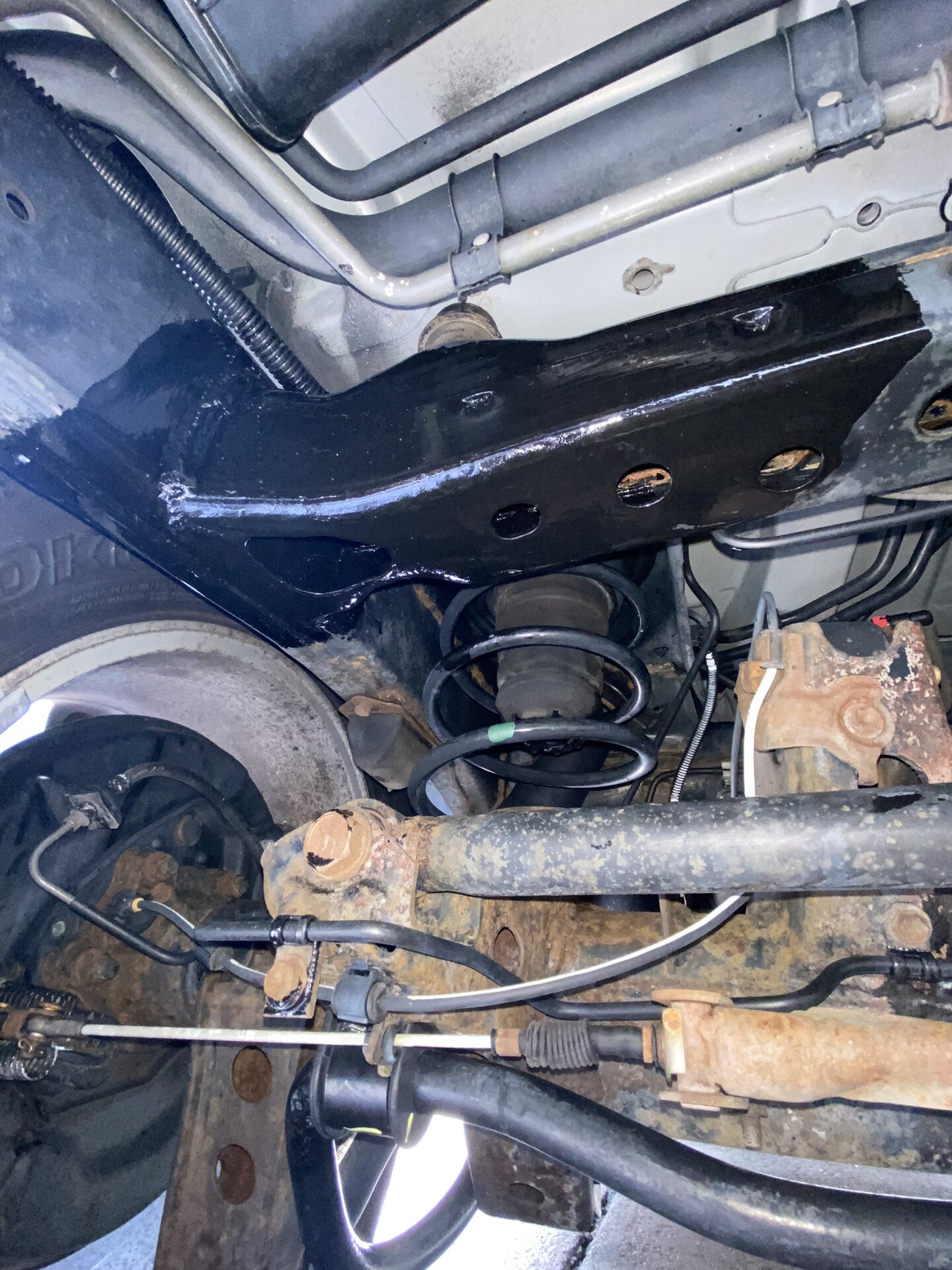

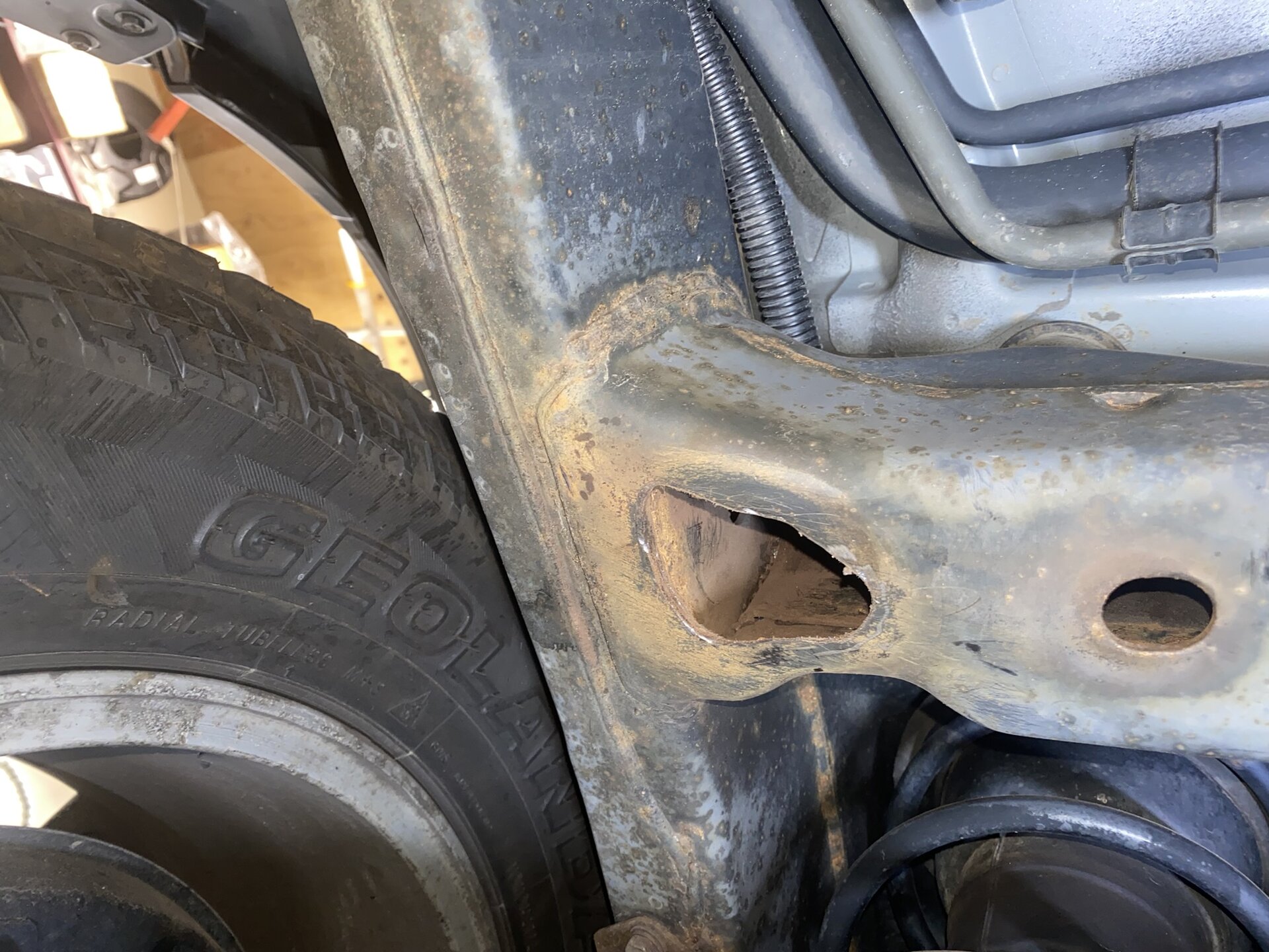

Rust in crossmember, that a screw driver will poke through easily. Likely fixable. like seen below.
Here's rust cut out, ground down, chisel & POR-15
intersesting that it was on the same spot in all of them
Yeah it's a design error. There's a small weep hole at CM to frame weld. It's, to small and clogs with dust. Which then retains moisture in the dust. Most are very fixable. Some just need to be kept clean.
I'd say it looks pretty close to identical, I have chisels, grinder and some por15. I think i'm going to go for it
