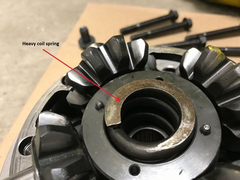

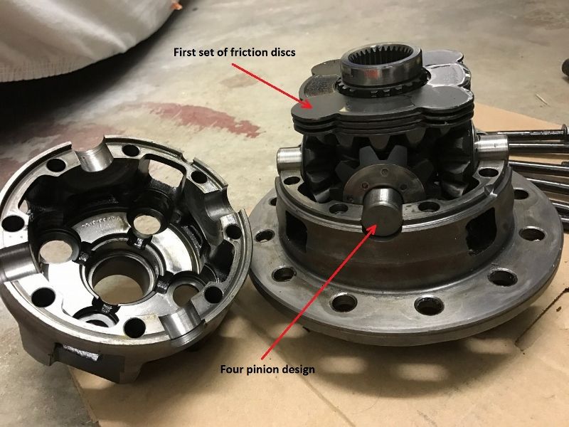

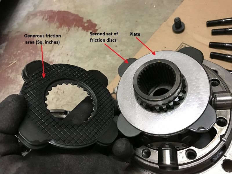

It's nice to see the inside of the diff. If that is correct it's a positraction/clutch style. I do not understand why the owner's manual doesn't discuss friction modifier though. Based on the lack of a mention of it I was thinking this was a torsen/trutrac/gear style LSD.
It is correct....and is a classic friction disc, plate and spring set up.
