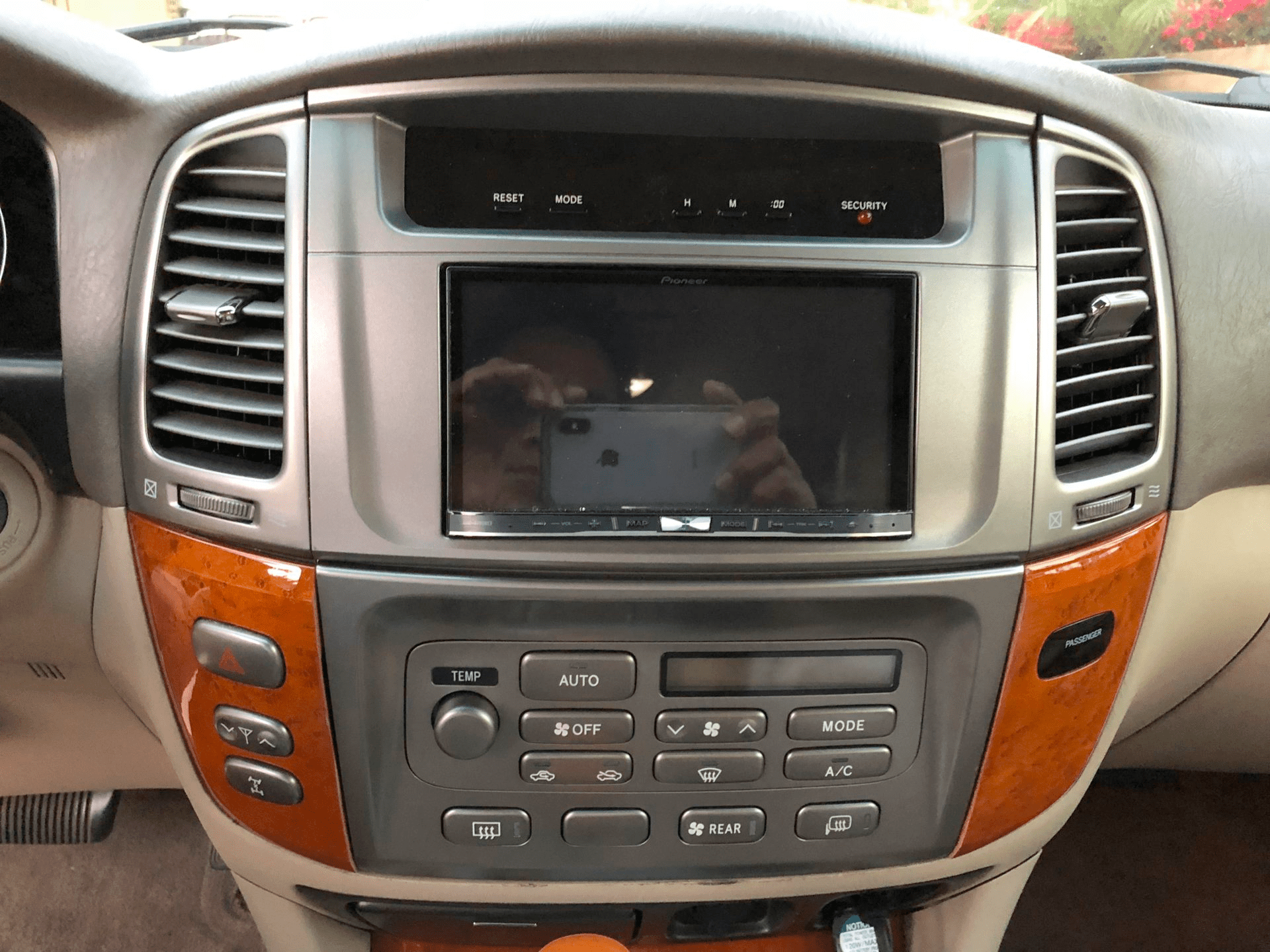

You don’t have the cd changer so clearly you’re not using factory Nav anymore so you’re all good. Read this link. You grab a 68 ohm resistor and youre all good. Also, space you have to work with is shallow so you’ll need to go shallow din mechless Receiver (no cd) or modular with the back brains that can be relocated. I made a little cover around the din slot out of black plastic.
I liked the simplicity of a single din that doesn’t scream steal me and for me signal strength, active network capability and tuning/eq capability were king
this receiver Is tough to beat for the cost to capability and quality elements
