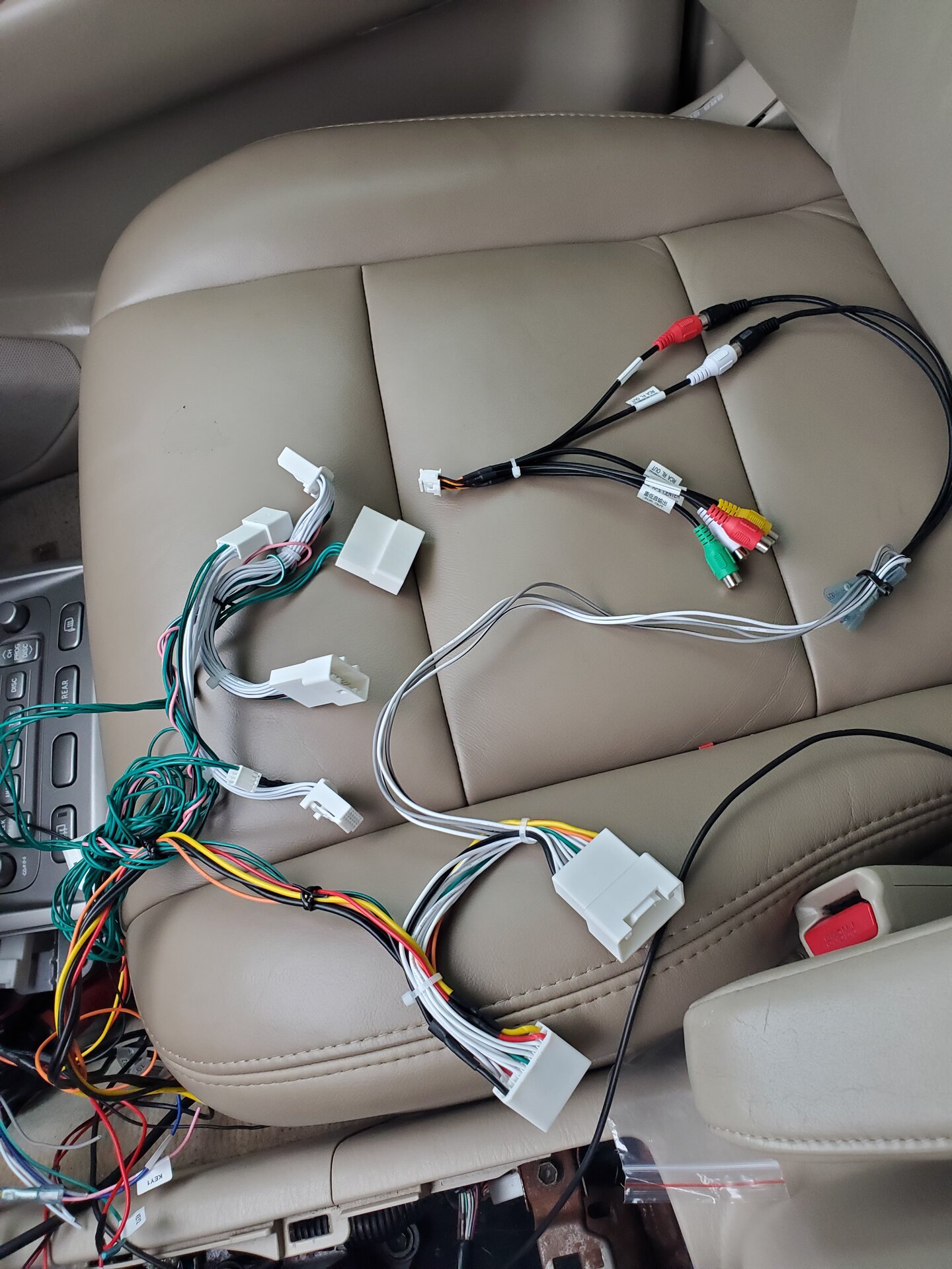

@cryptyk I spliced RCA's into the FL, FR, RR, RL audio output that connected into the teyes, and connected them to the RCA's that came with the teyes. I'll try the aux input tnrw as well as the noise filter and report back.

Here is a picture of my handwork.

Oh I see what you mean now. Nice work . I assume plugging another source into the rcas on the harness would cause the same distortion.
