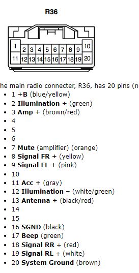

Just to run by this one again - you were at one point suggesting to ground the empty pins on the G connector to the #20 pin on the R36 vehicle harness connector?
Just to run by this one again - you were at one point suggesting to ground the empty pins on the G connector to the #20 pin on the R36 vehicle harness connector? View attachment 3272252
I would try pin 16 first, then 20.
I would also check continuity between pin 20 on R36 and pin 10 on the amplifier to make sure those are connected (as they shield the other wires)

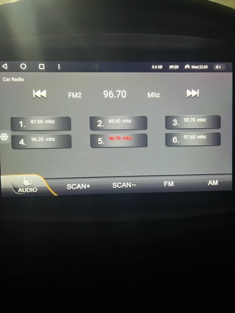

hmm, with your theory perhaps you can switch to a known good radio channel to test if the hiss turns to music. I think in the TEYES if you hit any of the tape deck radio button, the radio app that seems to control factory radio will come up to let you switch channels
Is your antennae connected to the TEYES?
Even on the LX, when I connected the factory radio antennae it will give some distortion and so I have since disconnected it and not use radio on the TEYES
also any luck with grounding #20 pin and 16 on the R36 vehicle harness connector?
@JJ_SC
I tried it with both the antenna connected and not connected. The Teyes radio controls didn't change the hiss. If the radio was searching for a channel, the hiss would go silent. Once it found a channel, regardless of the reception, the hiss would be back. So, for example, if I tuned in NPR, which I know is a good strong signal, the hiss would be there as soon as it picked up. However, the hiss was gone as it was searching for the channel. Hope that makes sense.
Finally got a few free minutes. Tried grounding pin 16 on the vehicle harness to the 4 empty spots on the Teyes connector. Same thing as grounding pin 20 - static and no more audio.

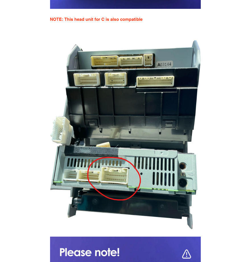

By the way, folks with '03 Land Cruisers - have you found a home for this guy? I can't seem to figure out what this one connects to. Everything works though.. No other vehicle harness connector seems to match up to this one.
Following as I have a slightly different issue ... 2005 UK spec LC100VX 1HD-FTE, Teyes CC3 installed. All speakers work, no hum, hiss or other noise issues thank goodness. Aircon works, steering wheel controls work, DAB works, Spotify, Google maps etc all good. Very happy but for one niggle - when locking the Cruiser using the key fob the alarm sounds pretty much as soon as it's armed. Every single time. Locking via the door lock is fine.
I have pulled the cables for the rear camera but not connected them to a camera (they are connected to the head unit) and am wondering if that's the culprit?? Any thoughts most welcome!
Does that not connect to the canbus box? Memory says it does....
not sure on LC, but on LX The TEYES harness plug with only 4 green wires is plugged into one of the factory nav plugs, these are the three plugs at the top most when looking from the back
