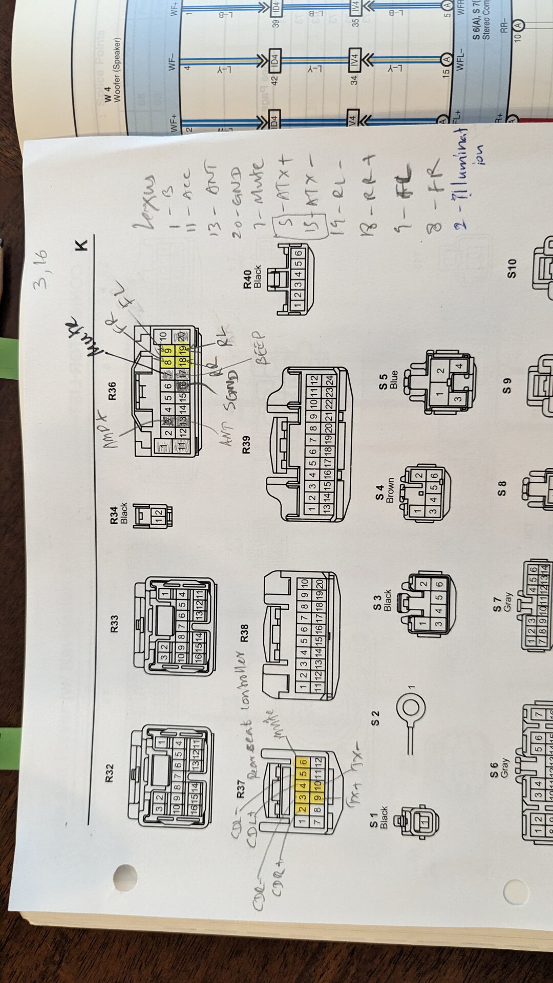

I give up.
Bought an additional harness to connect the 4 individual speaker grounds to the ground pins on the G connector. The staitc noise is even worse now.
I'm about to rip this thing out and send it back. Driving around with this noise is a form of torture.
Well, that's disappointing.
I’ve got a feeling I’ve got other contributing factors, such as antenna delete (replaced with stationary type), HID retrofit, and other BS that could be adding to this. I wouldn’t rule this mod out as a solution.

Clearly the teyes is putting out audio from it's pins correctly. It's bizarre that wiring those pins directly to the LC amp doesn't work.
The only other thing I can think of is that the amp isn't grounded, but I'd be surprised if the teyes harness somehow messed that up.
Man what a bummer. Thanks for testing it out.
The only other surefire option I can think of is to replace the amp and run the teyes rcas to it. I'm going that in a couple of weeks and will report back
