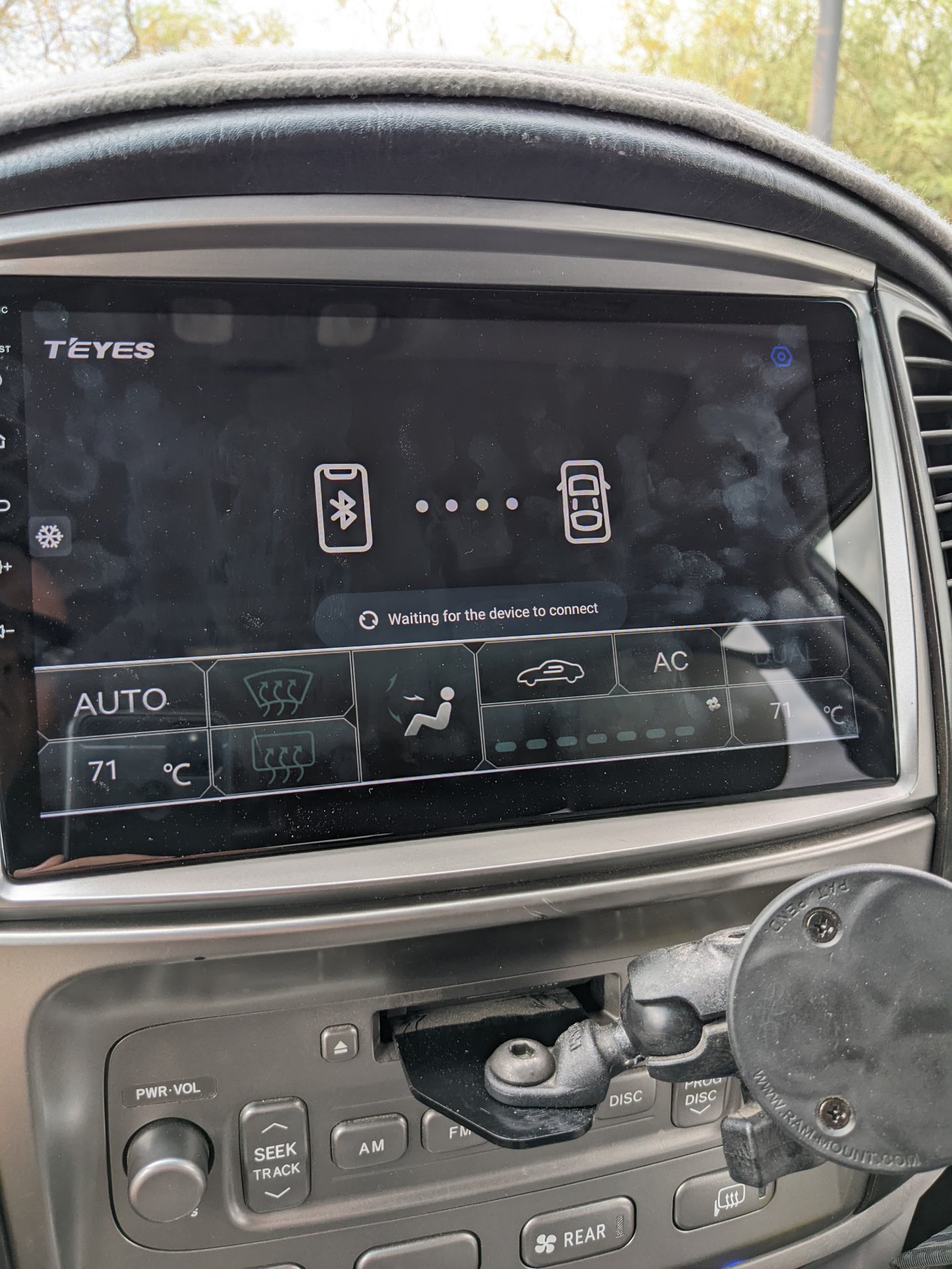

Congrats on the successful install? Not sure about the failure message. Have you connected the unit itself to the Internet via WiFi, tethering, or a SIM card? Maybe connected to your Google account?

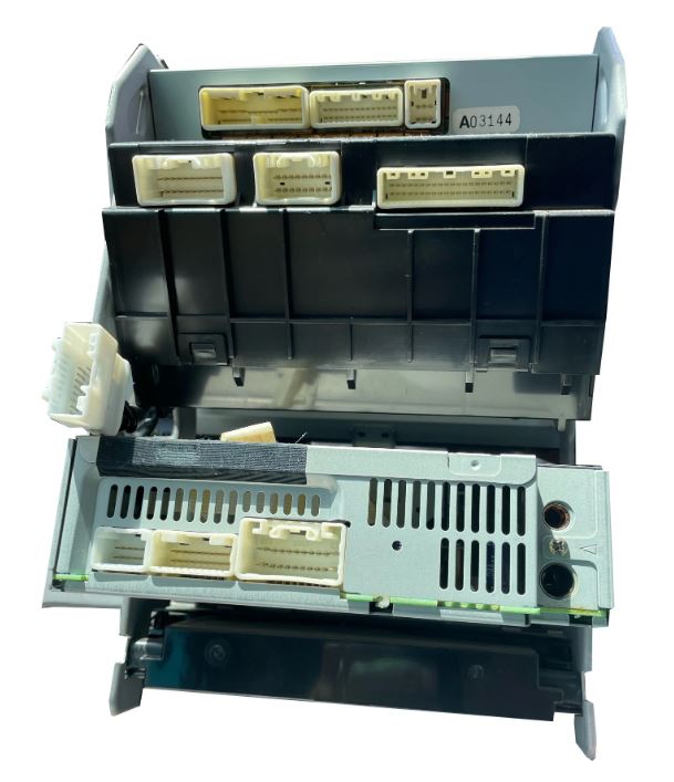

What year is your LX? Any unused harness connectors? Did everything work the first time, or did you have to update canbus, reboot, etc? You've confirmed volume knob and tuning knob, steering controls, AC controls, and antenna all work?
Also curious, what did the back of your MFD and radio look like? This one or the other?
I have connected to Wi-Fi, signed into play store, and used hotspot from my phone. It seems to turn Wi-Fi off every boot so it must be switched back on.
Mine is an 03 and I had a couple unused connectors. I had to reset and reboot several times for the touch assistant button to turn into the climate button.
Radio works well through the unit, volume knob works but tuning knob and antenna up/down only work if in the car function radio app (of course radio is static unless I switch antenna plugs).
It seems it’s trying to activate the sim or something.

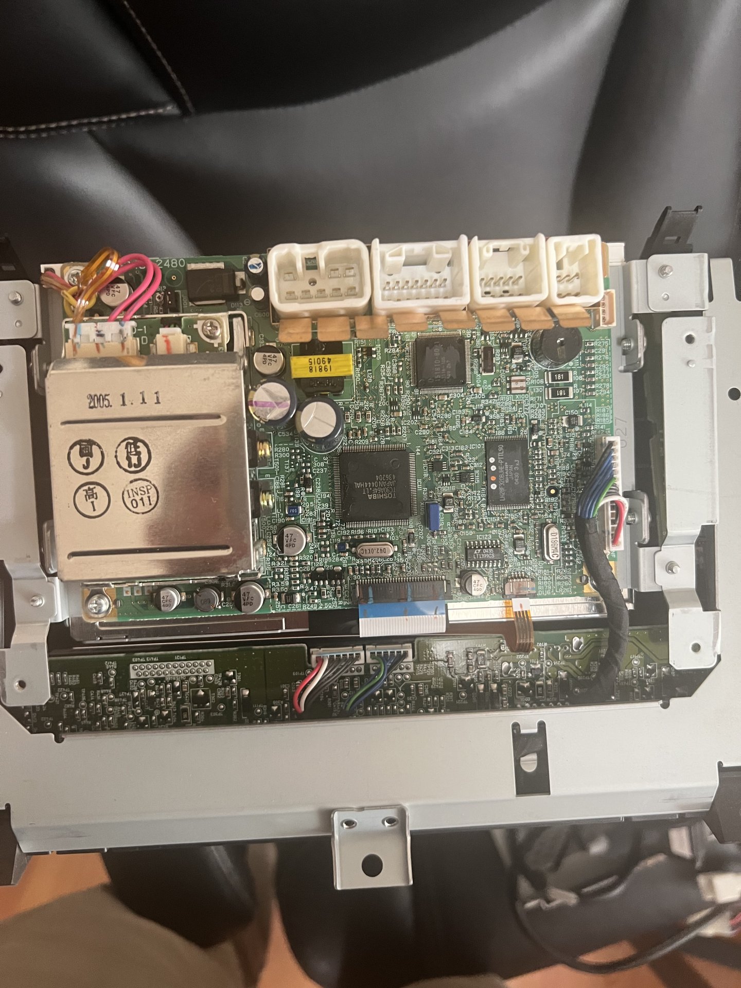

My old screen.

My old screen.
Looks like you have a different option than the one I posted. Was there no back on your display?

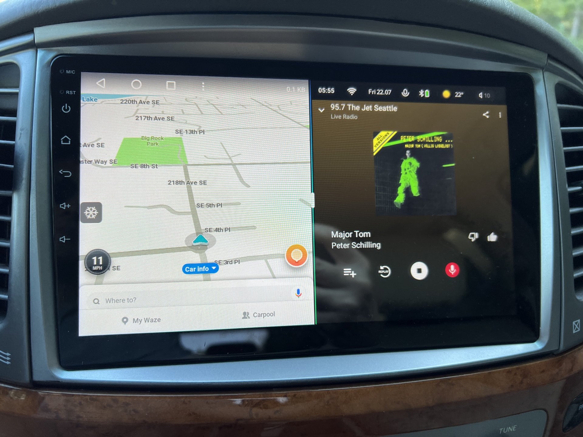

I'm not normally an Android user so this was a surprise to me today. Was messing with the UI while waiting for my turn in a drive through. I decided to touch the 3 dots on the top and apparently it allows you to split the screen between two apps. This makes it much more useful as now I can have Waze and my music app side-by-side rather than switching between the two. The screen is so big that when I do have Waze up it shows the route on the right side of the screen and the left side is wasted so now it's making better use of the space.
One thing I haven't figured out is how to put different apps in the home screen. If you go into the apps menu, you can long press an app and it switches showing the home screen, but anything I try to drag says there's no room on the home screen. But I can't figure out a way to remove what is already there. For example, I want to replace the default music app on the home screen with something else.
Just long press the apps you want to delete.
