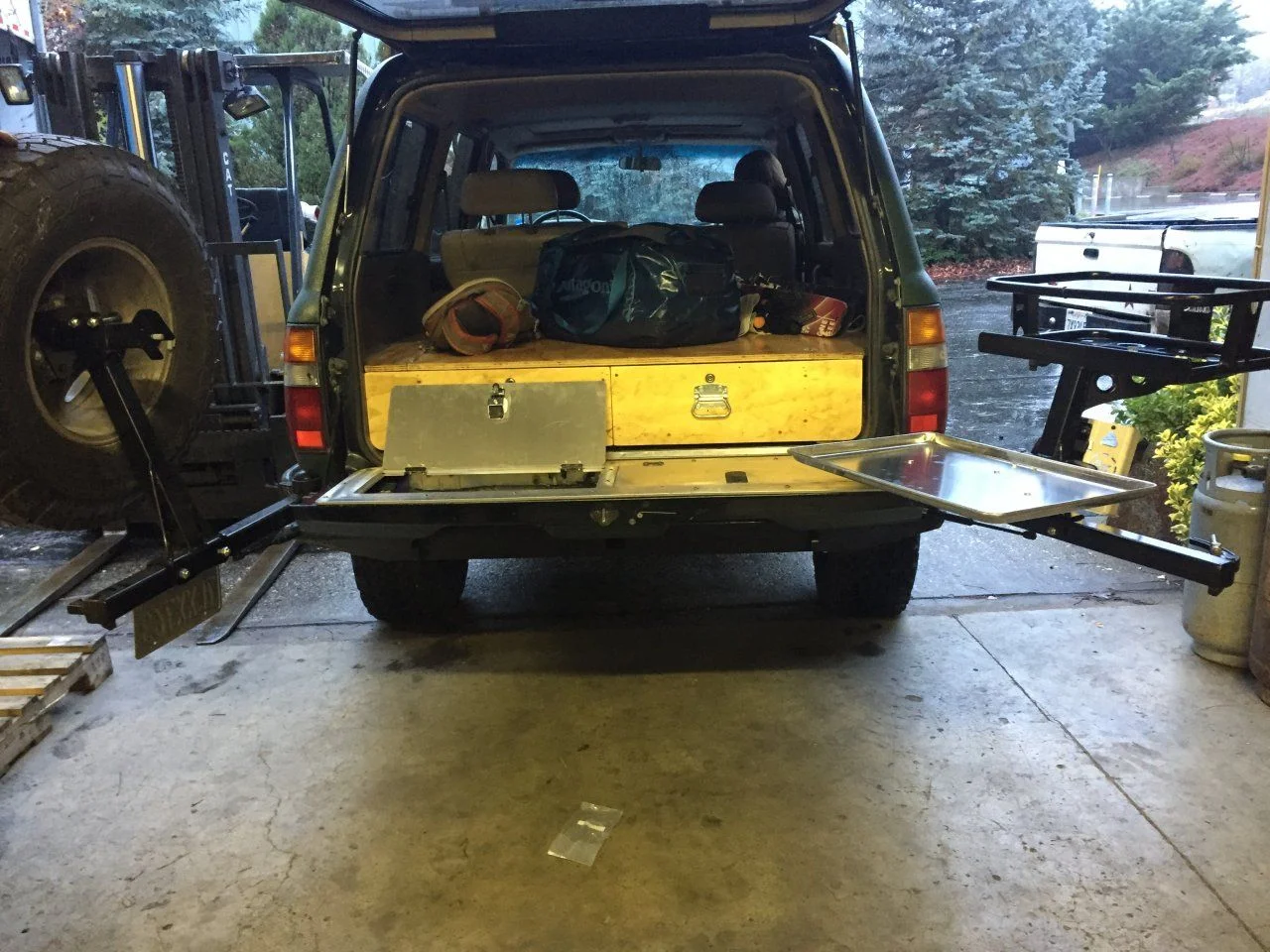

I stopped by 4x4 labs again and had my new can carrier installed. It now has an flip down table that is removable. Will use this tray to cook with my two burner propane stove. Here is a photo of my completed rear storage

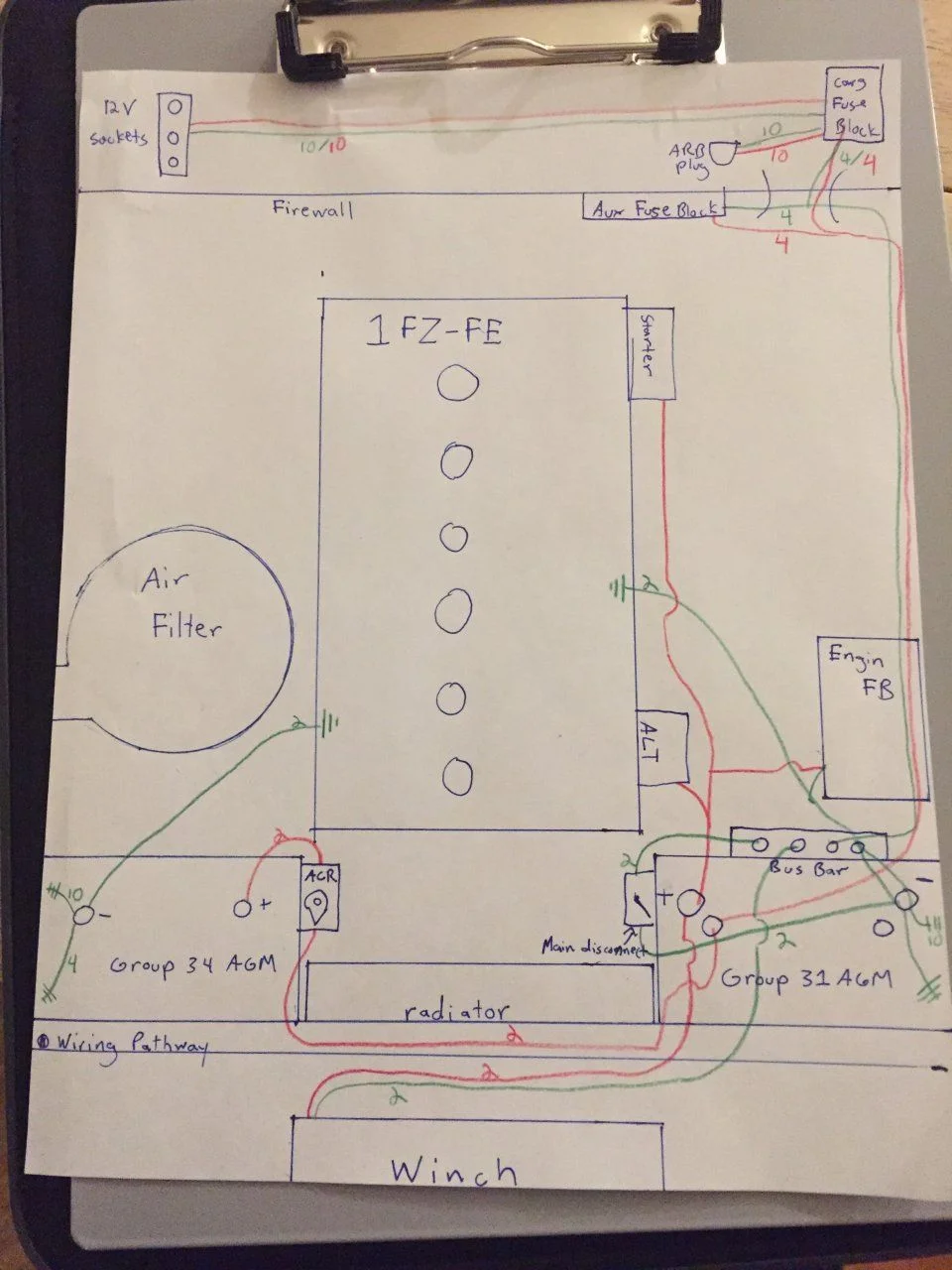

Next big project is to get my dual battery system wired up. I never have done anything like this before so I spent hours and hours reading threads and bought a book on marine wiring. Anyway here is what i am planning
Would greatly appreciate any feedback on this. Have a few questions:
  1. Do I need to fuse the wires leading to the Blue Seas ACR
  2. What Amp rating should the bus bar be?
  3. I need to ground the 2nd battery to the fender, body, and block right? Alternatively can I just run a negative wire to the main battery?
You do not need to run -ve wires for the winch and the aux fuse box. The winch should ground to the frame when it is bolted in. For the aux fuse box, just run a wire to the closest ground point or ground each item run from the aux fuse box separately. You can then use the main disconnect on the positive wires.
I did add a 200A fuse between the ACR and the main battery for safety's sake.
I do have a question on the whole setup. As configured, everything will run off the starting battery and the aux battery will just sit there with the engine off until main battery runs down. Why not run the aux fuse panel and winch off the aux battery and leave the main battery for starting and normal running operations? That way the aux battery can be drained knowing that the main starting battery will be always available.
I can do a sketch if you want.
- Yes. Use ~150amp circuit breakers within 12" (along the length of the cable) from the battery. I mounted my breakers right on the battery boxes.
- What is the highest amp component attached to it?
- More grounds the better. I grounded mine to frame and primary battery.
Another note: I'd skip spending the money on the AGM batteries. Mine started failing after a few months of use. I brought it back and the guy at Sears said that the AGM batteries were being returned way faster than usual. I also talked to my buddy who is a mechanic and he also said the same. I started buying flooded cell batteries again (I never had an issue with Interstate).
I'd get a deep cycle battery for your 2nd battery and hook it up to your fridge and accessories. Use a starter battery for your primary battery.

In regards to the battery stuff I had a few follow up questions:
  • I want to run all the engine grounds off the bus bar so that I can have a big battery disconnect switch. I know the starter draws a ton of current. Do I need a 500amp bus bar?
  • Thanks for advice on batteries. I've heard lots of conflicting info on this. I wonder if its not the brand or something. Would love to go a cheeper route as AGM is pricy!!

Thanks for the help. Good point about which battery accessories are wired up too. I planned it out this way because I know I can get a group 31 battery in the starter battery tray and wanted 100amp hours. I haven't received my 2nd tray yet. if you can fit a 31 in their could change it up. I also have some existing lights that run off the starter battery and it would be a pain to change. I was also wondering if their is a pathway through the firewall on the passenger side. Seemed harder to get wires to the back of the truck from that side. Another friend has his setup wired the same way as he wanted his backup battery never to have a load on it....
Not sure which way to go
