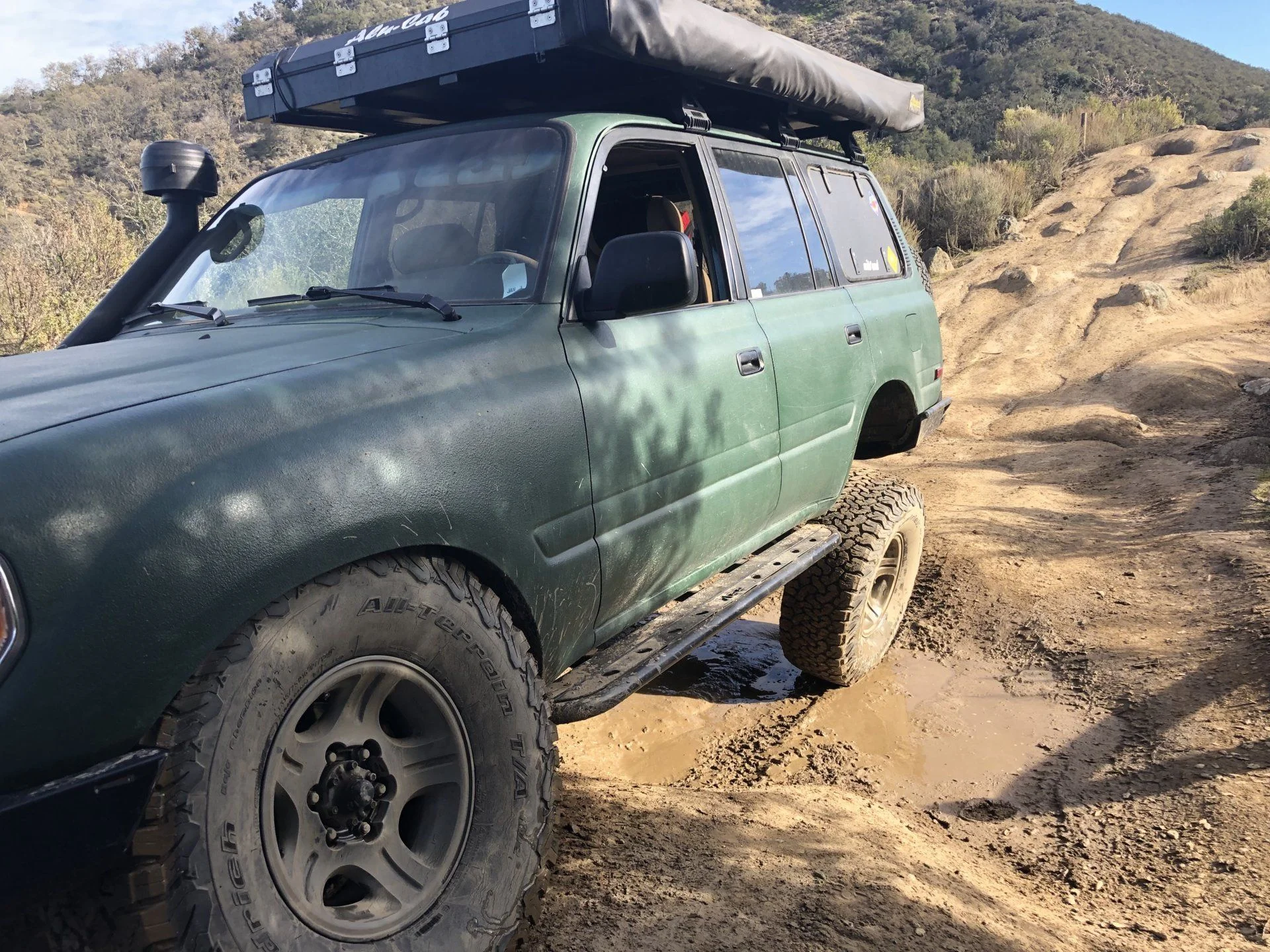

I got my LX wheels back from powder coat. Look almost brand new! This means I can buy tires today. I'm looking for 2 LX wheel caps if anybody has some.

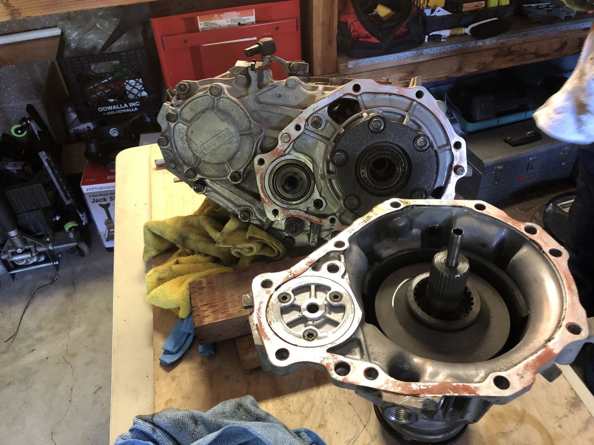

Still making slow progress on my suspension rebuild. @Shoredreamer is amazing! Here helped me tear into a spare tase this past week. Took about an hour to get it all apart. New dewalt impact wrench made it easy peasy. Now just need to press on the new gears and get it installed :frown:

Rebuilt Case with 10% under drive gears and 3:1 low range installed today. What an amazing difference!!!!!!! Truck feels 1000lbs lighter and shifts so much better. Much easier to keep up with traffic on the freeway. Thanks so much to @Shoredreamer for making this happen. If anybody wants a rebuilt case hit him up. He has the hang of it now and has two cores to rebuild.
1901992
I'm curious on underdrive gears, I've seen plenty about the 3:1 gear but not much about the underdrive gears... curious why change them vs gearing the diffs?
