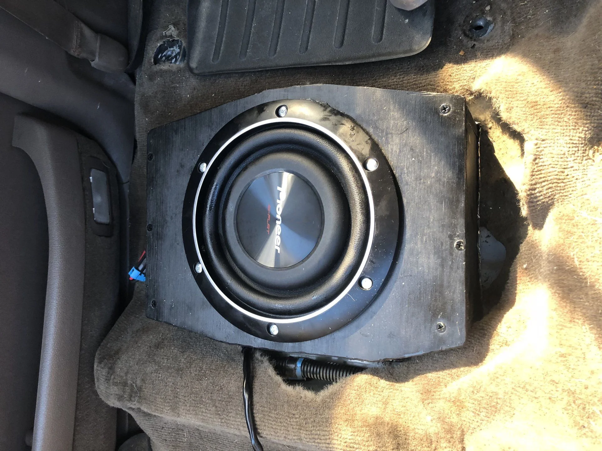

I also finally finished up my Wit's end quarter panel mount build and installed a subwoofer under the passenger seat. Here is a link to that thread and a few pics. underseat sub build

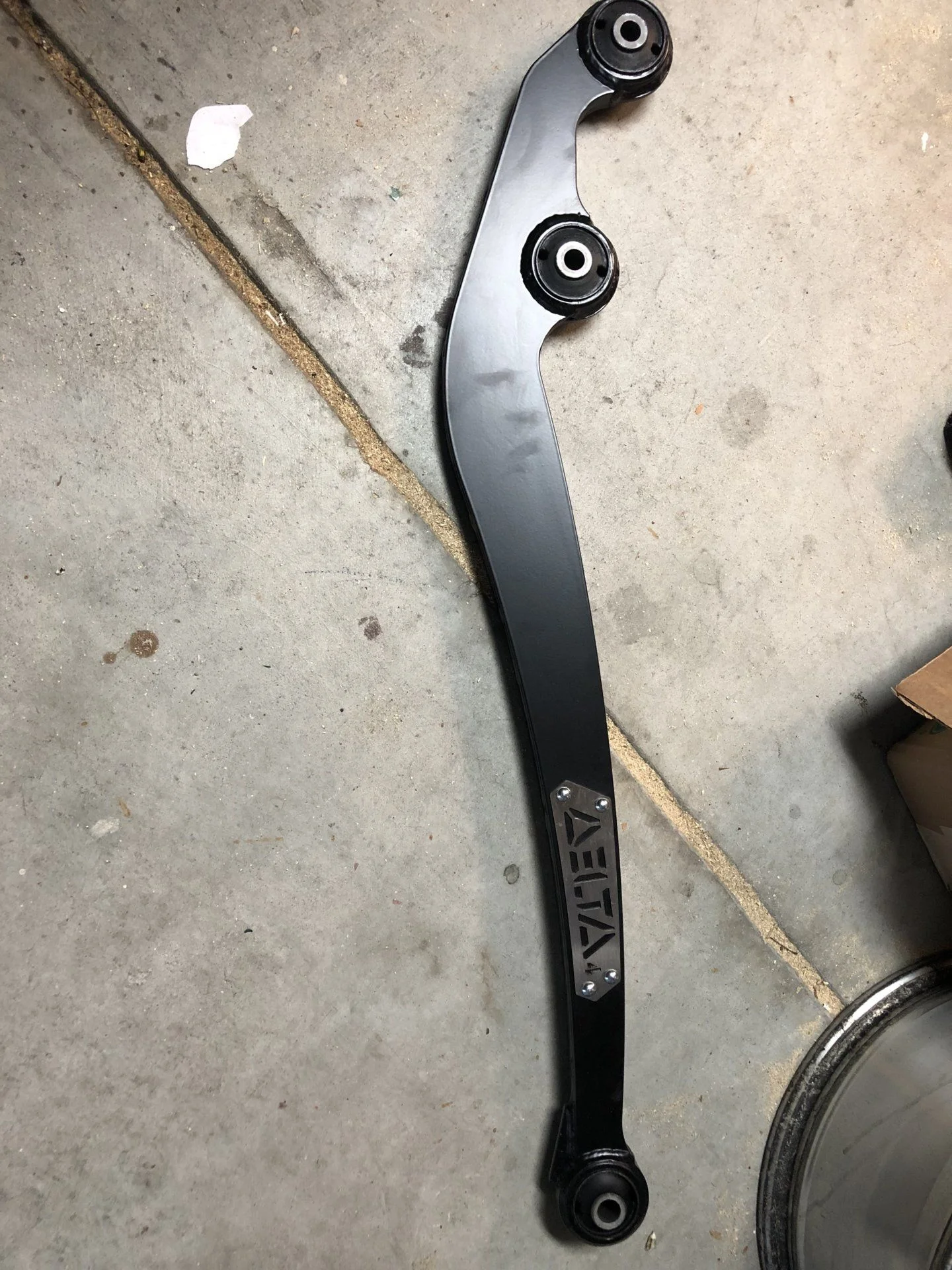

Just received 4 inch radius arms from Delta. They look pretty rad. Excited to put all of this together. So far I got a DC shaft, T-case gears, new set of old wheels, and these arms from @Delta VS . Waiting on panhard bracket, springs, and adjustable upper arms from dobinsons. It's getting hard to hide all these parts around the garage :poof:

Those front arms are sweet! :bounce:

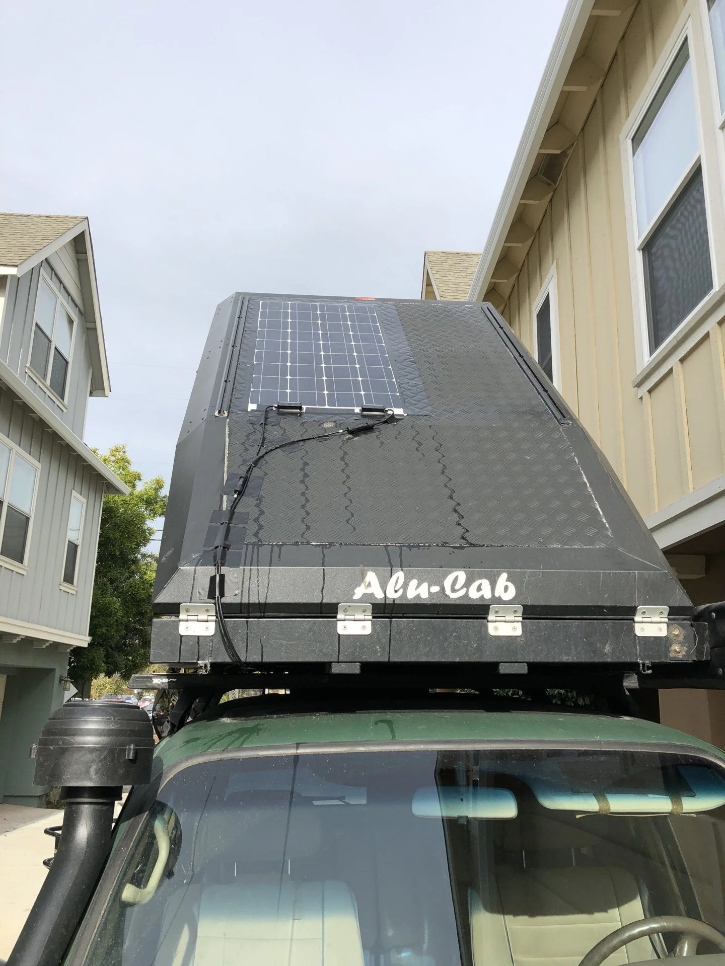

My parents are in town so I was able to get them to watch my 6-month old! I tried to make the most of it, got two surf sessions in and finally finished my solar project. I have had these parts in my garage for over 6 months:bang:
I purchased this panel. A hard panel is more efficient and cheaper but that would add more height to my already ridiculous tent and require me to run my crossbars constantly. I ended up going with this panel from renogy Renogy 100 Watt 12 Volt Flexible Monocrystalline Solar Panel
Install looks a little getto but I'm quite pleased with the result. Only a cloudy December day with the tent closed the panel was putting out 2 amps. With the tent open it just to 3.5

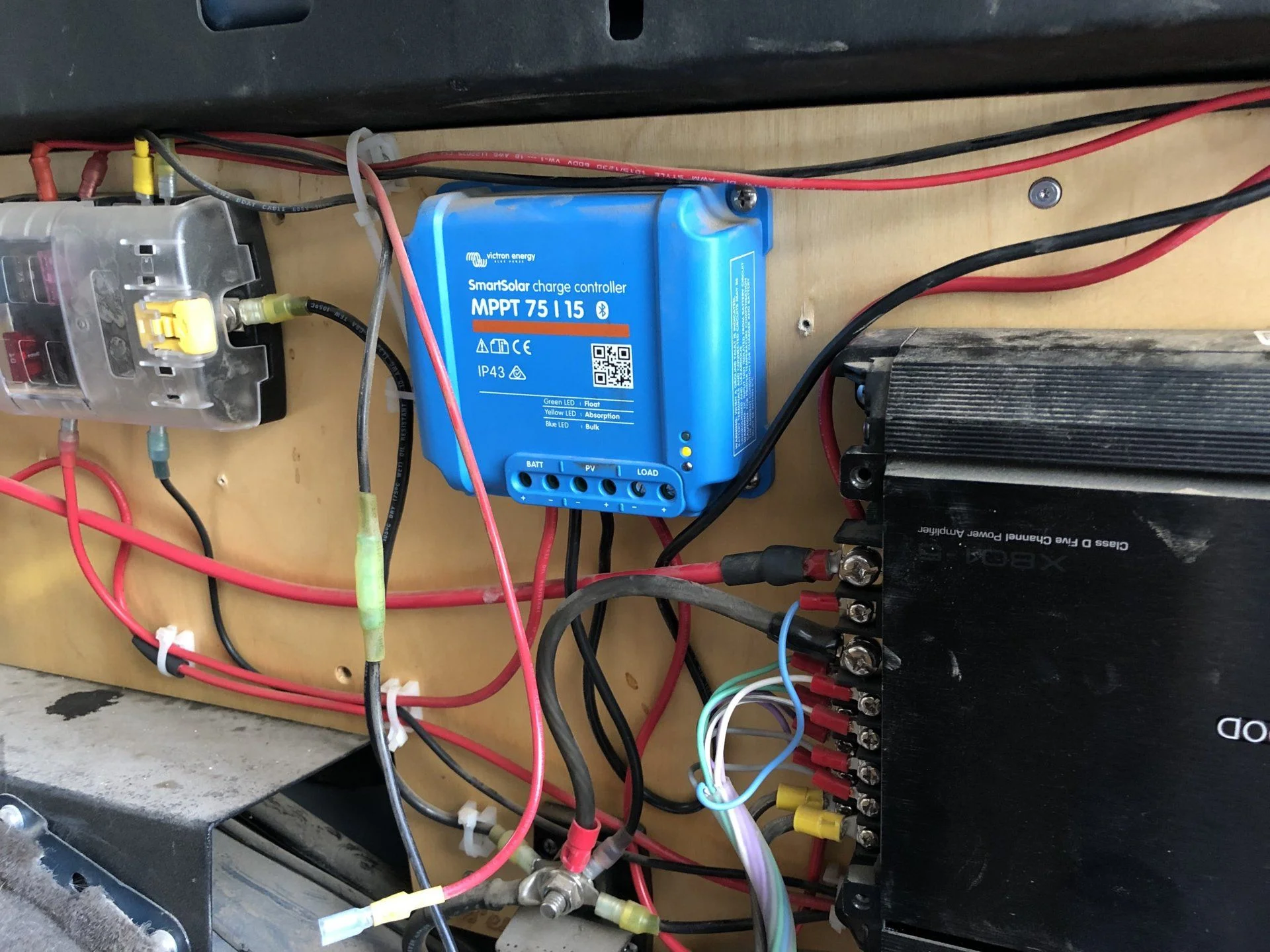

I used this cool Victron smart mppt charger. It is bluetooth computable so you can change the settings and monitor the power output from your smart phone.

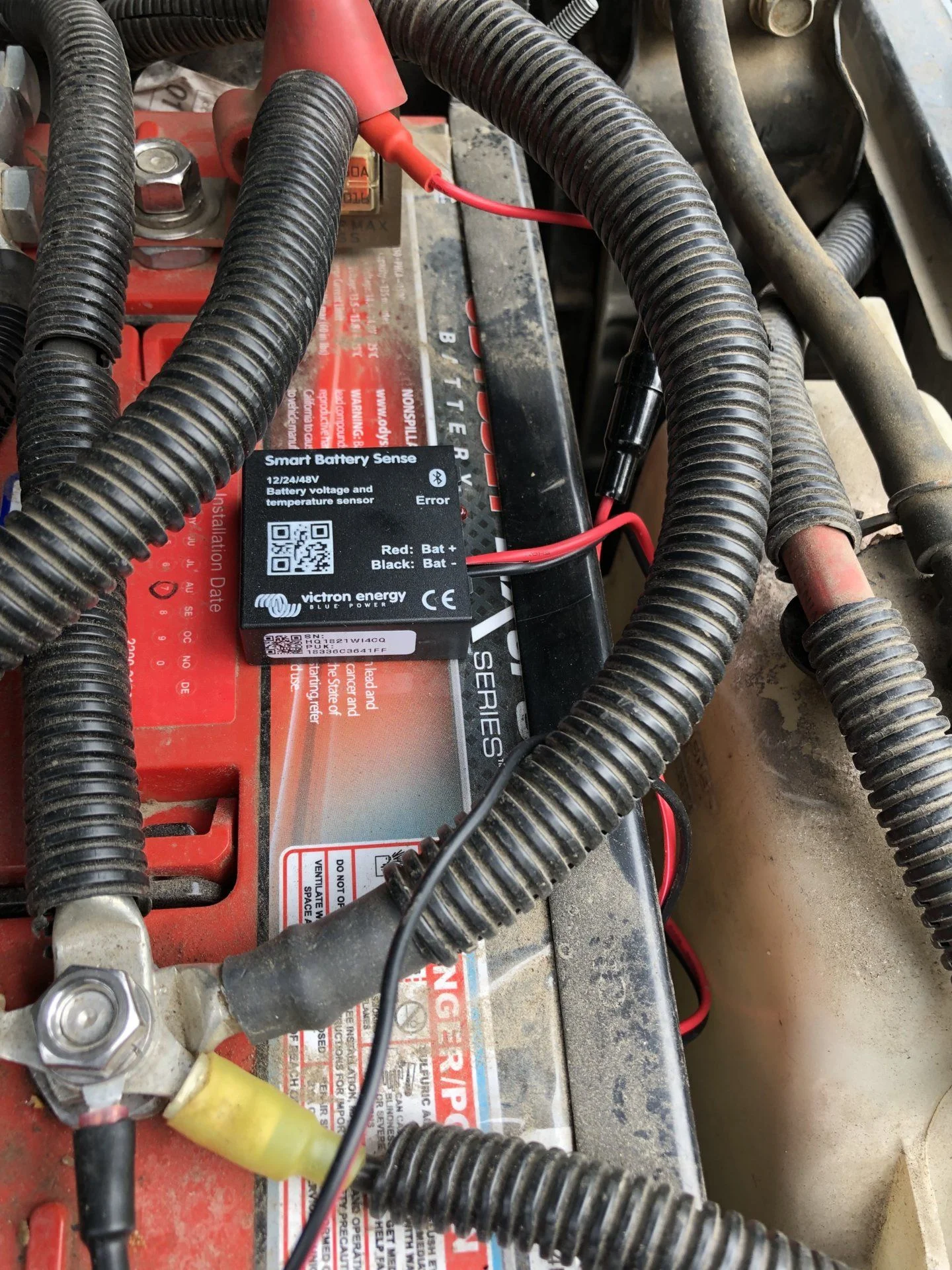

The controller also uses this remote temp voltage sensor which supposedly helps the charger condition the batteries better. Smart Battery Sense - Victron Energy
Below is a photo of my quarter panel m mount from @NLXTACY with the solar controller wired up and another photo with the temp sensor installed. The temp sensor communicates with the controller via bluetooth.
