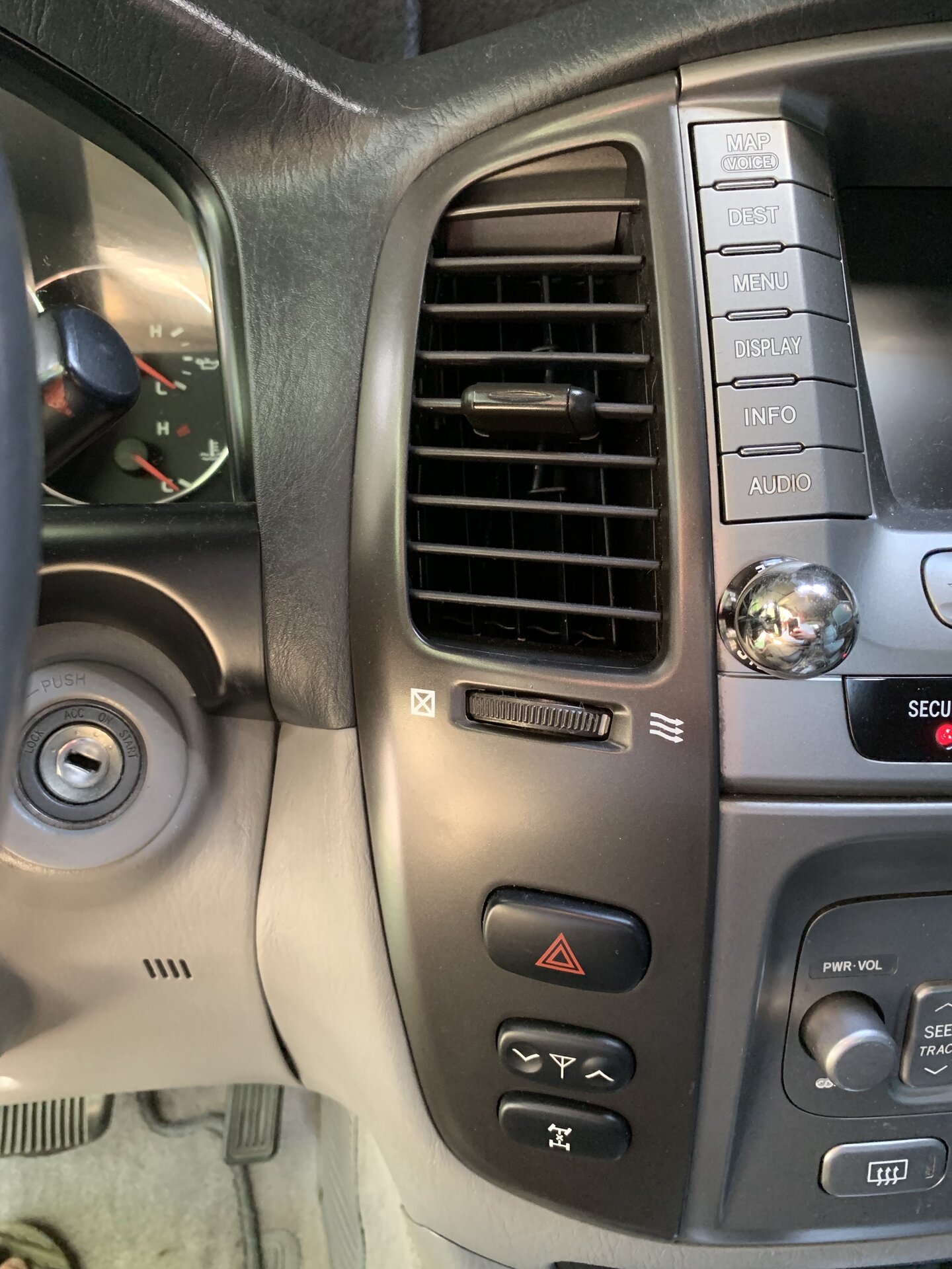

Does anyone have any experience with the Chinese reproduction A/C vent assemblies? I am normally a 100% OEM parts guy, but these are cheap $. I just want to see if anyone has real world experience with the part, and make sure the the part is not a "cheap" junkie Chinese part. No offence to the Chinese. My left side vent is toast and feel apart.
I bought these and they're snug, but I'm happy with them.

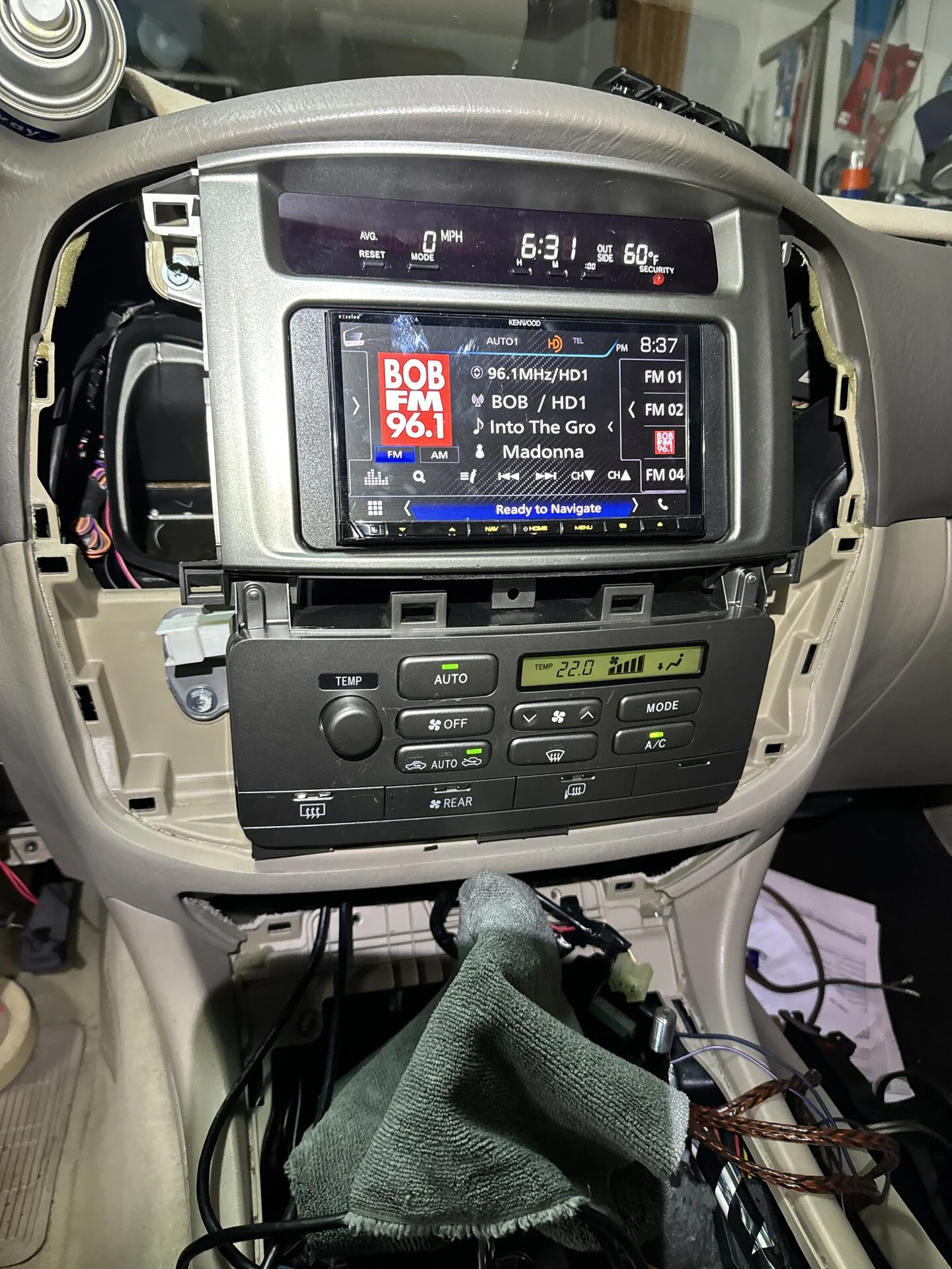

Has any used the Kenwood 200mm specific double din from Australia?
Any issues with getting radio (FM) frequencies?
It looks like the FM freq range is 87.5MHz - 108.0MHz. Shouldn't have any problems. I don't the the DABS will do you much good CONUS.

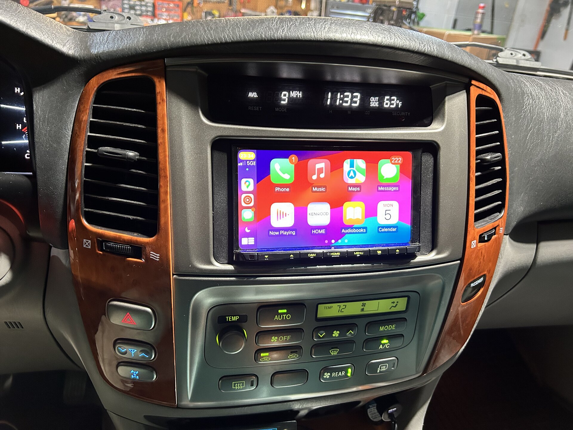

Made for the 200 mm Toyota oem face plate. Helps my ocd lol.

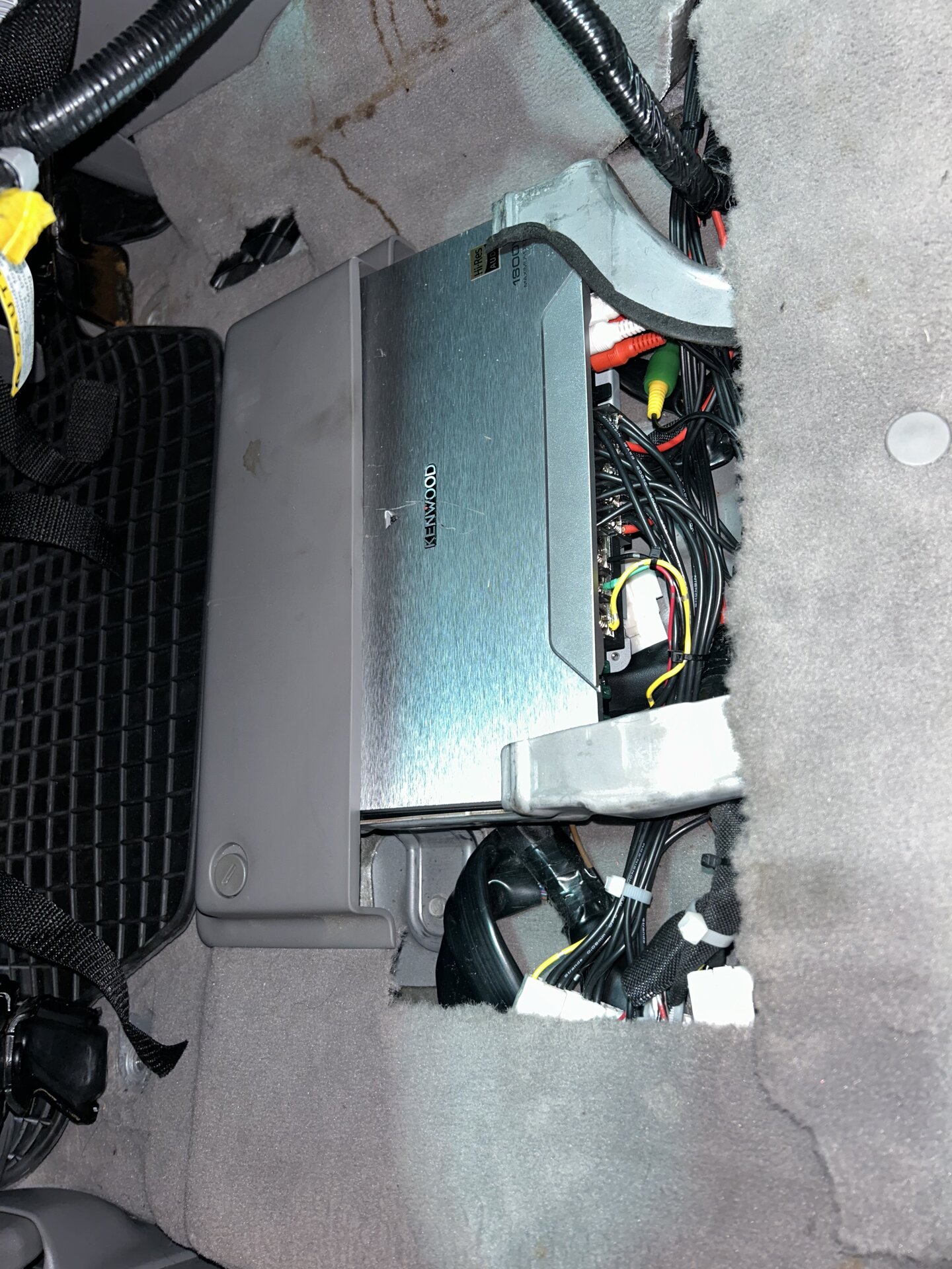

Kenwood X802-5 or XM802-5 is the perfect selection for the aftermarket amp. It can fit to factory navigation brackets. You can even reuse the cover for it.
