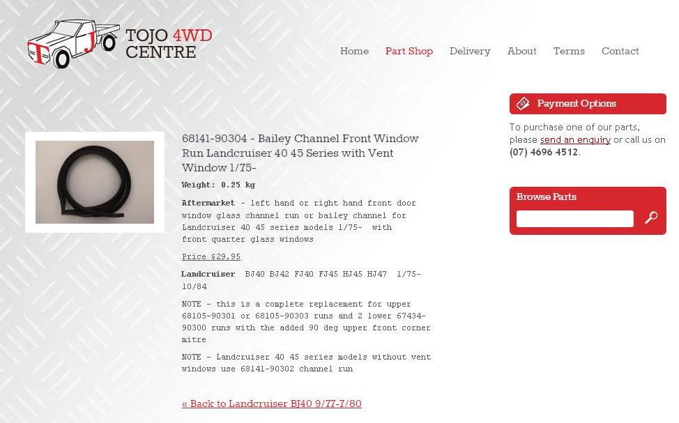

I've been able to source and acquire a pair of late model doors with 1/4 vent glass. They're in fairly good condition, however they'll need to be stripped down and cleaned up. I've found Tom's (lostmarbles) thread on his doors, so I'll be following that tonight as I find time to remove all the door trimmings and window hardware.
https://forum.ih8mud.com/threads/tackling-the-doors.370889/
Before reading that thread, I never knew that the OEM weatherstripping for the upper run was chrome plated. I've only seen the flexible bailey channel/flocking.
I'm going to have to start paying more attention.
Once I've done that, I'll send them down with the tub (I collect that next week) to the blaster. Hopefully when I get them back, there'll be time for filling holes and rust repairs.

I think I've found the correct reference for my year.
Correct. And 68141 leads to part number 68105-90303..

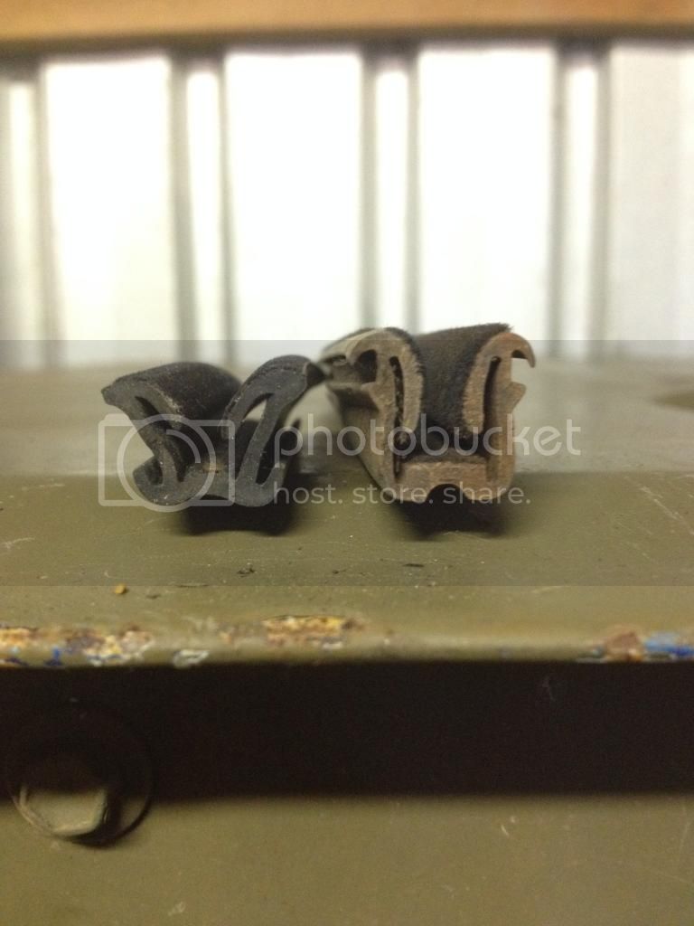

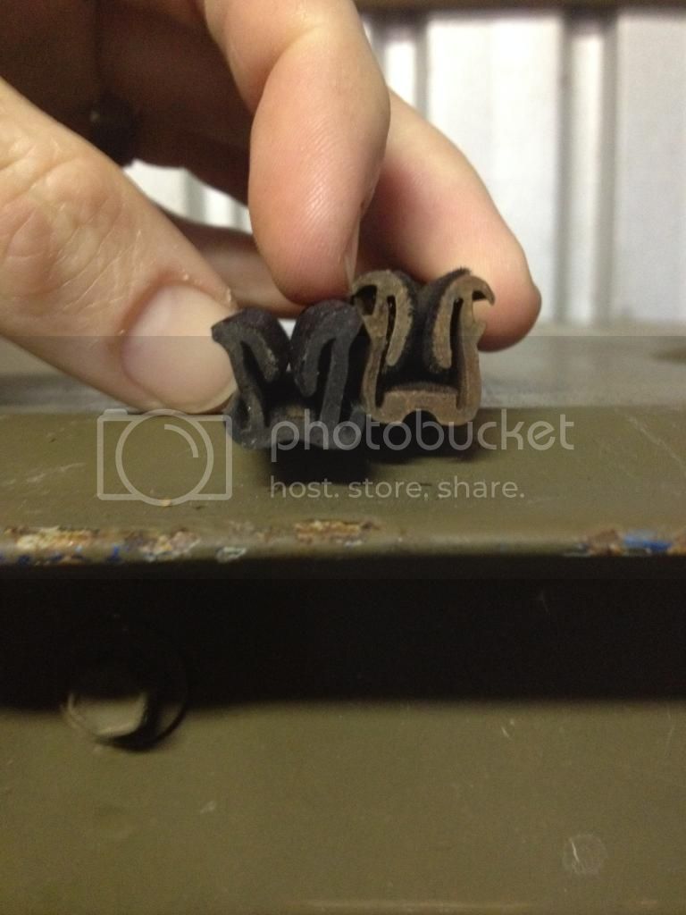

I took off down to our local rubber shop (supplier for RS I believe) with an off cut. We were able to closely match the bailey channel with some they had in stock. I was given a sample and have tried it at home, it may be slightly on the small side (depth) but it has the correct wall thickness.
The PO of the 55 gave me the weatherstrip kit he purchased (and had started replacing) only to find that the window would not slide up and down the channels.
A visual inspection of the original 42 and 55 bailey channel confirms that they are very similar. I'm hoping to confirm the sizing and then purchase enough to replace all bailey channels across both vehicles - I wonder if I'll get a discount?

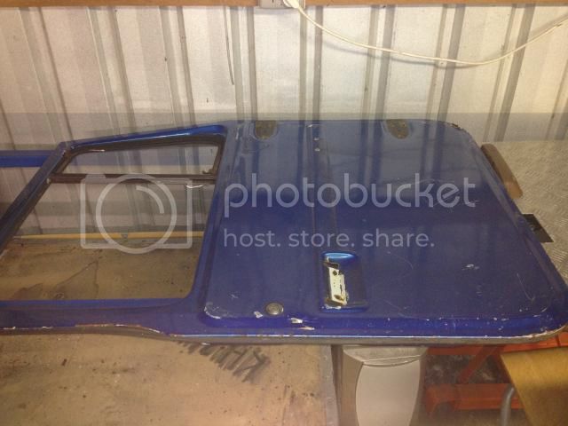

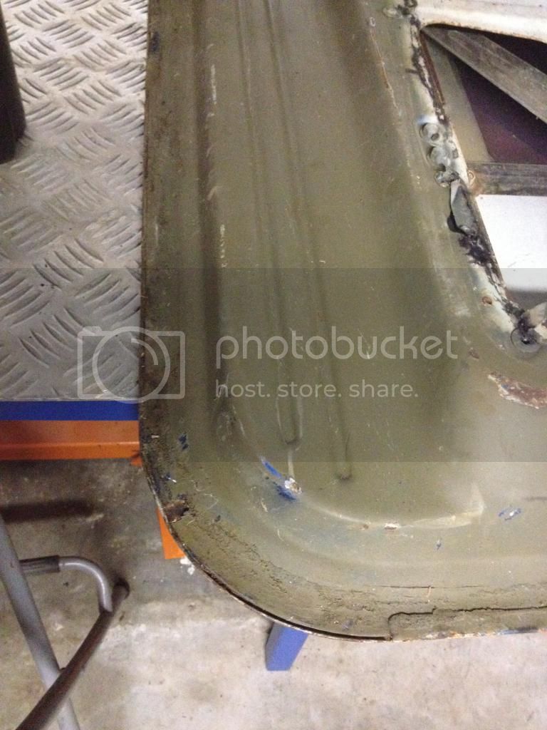

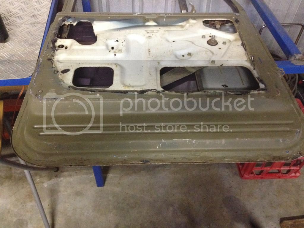

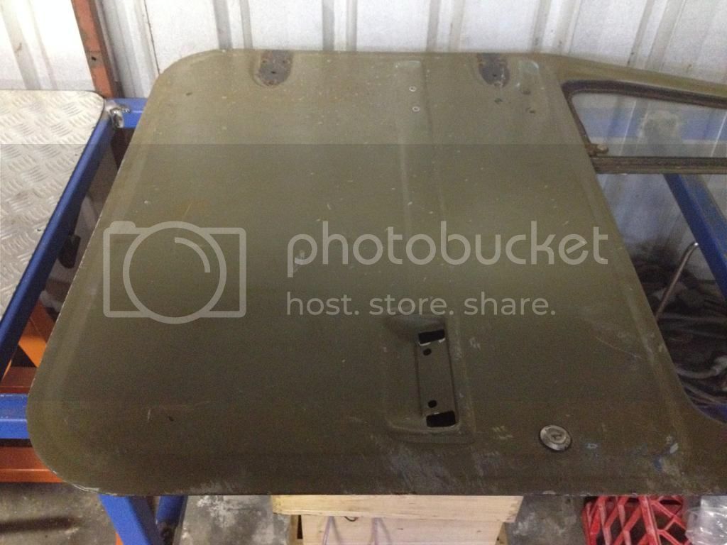

Some photos of the worst replacement door - lots of screw holes to fill thanks to the check plate. Little bit of rust to repair on the bottom corner, will have a better look once it is back from the blaster.
Some photos of the worst replacement door - lots of screw holes to fill thanks to the check plate. Little bit of rust to repair on the bottom corner, will have a better look once it is back from the blaster.......
If that's the worst of the rust then you've done extremely well in finding doors in such great condition Dan!!!
Bailey channel - comparison
Original on the right:
Showing wall thickness:
I'd like to see if the OEM is available, as it is a little taller then the aftermarket, however, the shorter channel fits really good inside the frame, so it may be a good compromise.
