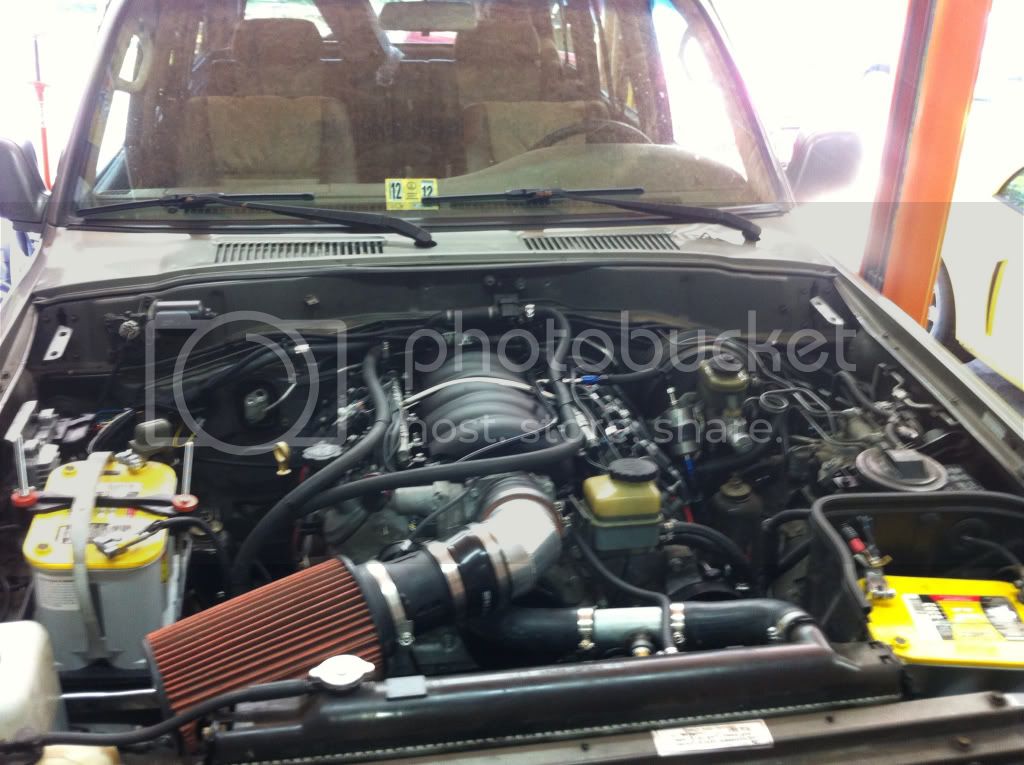

Welcome to the forum and the bowtie V8 club. I did the conversion about two years ago, and could not be happier. While mine is not quite the LS3, I am perfectly happy with the power for the LQ9 (truck version with the LS2). I have talked to a lot of guys about this, and if you are feeling low on torque, I you can always swap in a truck intake for a noticable increase.
Here is (blair witch-like production) video I made after I finished the conversion.
Audi A4 :: LQ9Swap.mp4 video by dimasokolov - Photobucket
Best of luck with the project and let me know if you run into any issues. Between everyone in this community, there are endless answers.

Thanks! I will definitely keep that in mind. Sweet rig you have! I actually googled V8 swaps prior to doing mine (and joining ih8mud) and your video came up. It was one of the things that inspired my build! Nice work!!!
Thanks! I'll tell you what...just keep in mind the fuel economy. I swapped mine expecting vast improvement, but I average 11-12 MPG in the city...maybe 16 on the freeway going long distances. Maybe you'll do much better with the fuel/cylinder management technology.
